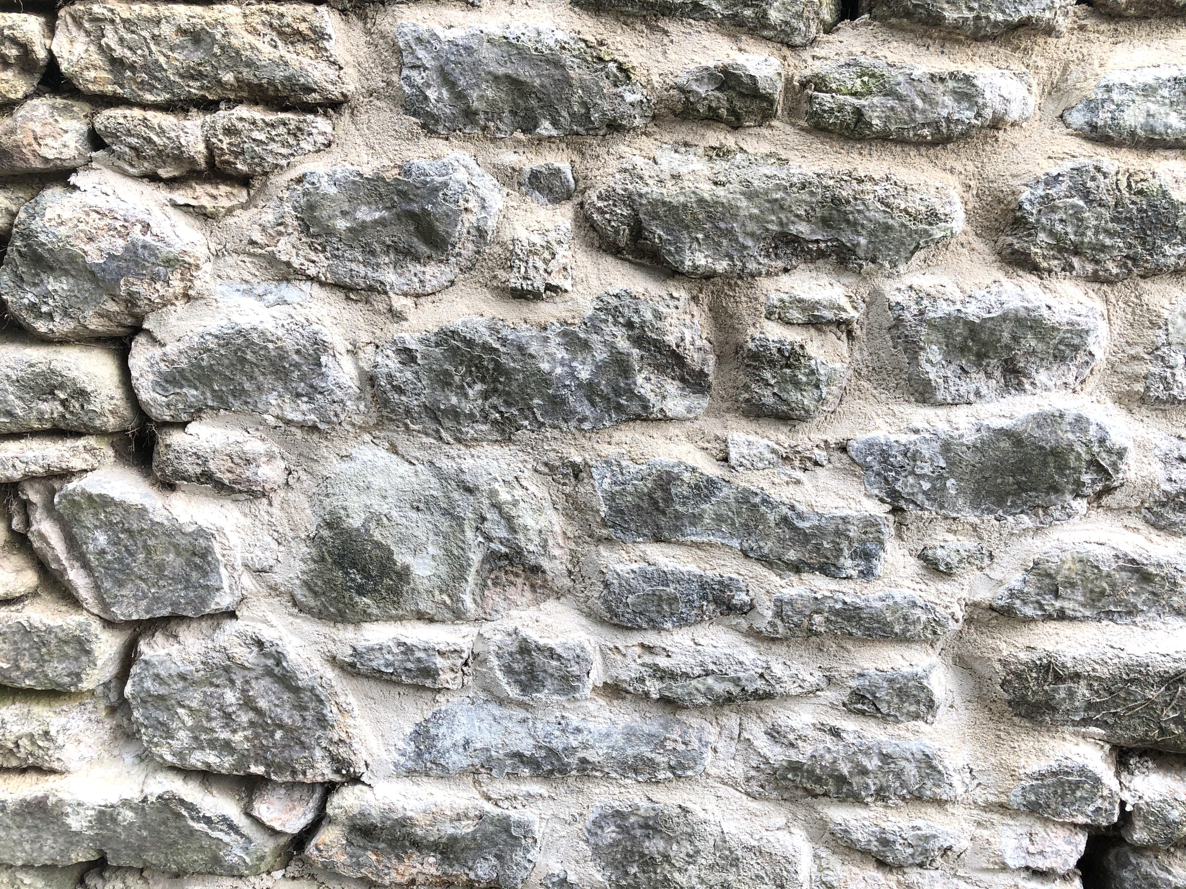

Roz Posted November 19, 2019 Share Posted November 19, 2019 Anyone got any close up photos of their lime pointing - preferably on stone, that they can show me so I can see what I am aspiring to? I started yesterday and think it looks pretty messy, but am following guidance online. I realise it's a skill, but not one I think we can afford to outsource. Tips please! Link to comment Share on other sites More sharing options...
Onoff Posted November 19, 2019 Share Posted November 19, 2019 Got any photos (even of your screw ups ? ). I'm on the brink of doing some flint panels using lime mortar. Link to comment Share on other sites More sharing options...
Roz Posted November 19, 2019 Author Share Posted November 19, 2019 17 minutes ago, Onoff said: Got any photos (even of your screw ups ? ). I'm on the brink of doing some flint panels using lime mortar. ??? go easy ? I bought ready mixed stuff from Cornish lime. We are going to take a needle gun to the face of the granite later, as it’s got an ugly concrete wash over it Link to comment Share on other sites More sharing options...

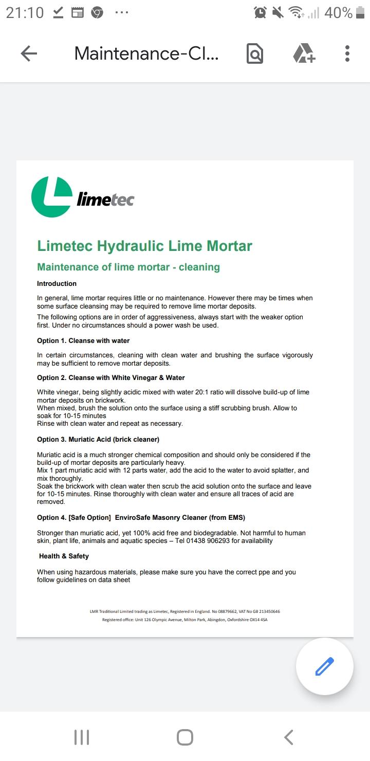

Onoff Posted November 19, 2019 Share Posted November 19, 2019 11 minutes ago, Roz said: ??? go easy ? I bought ready mixed stuff from Cornish lime. We are going to take a needle gun to the face of the granite later, as it’s got an ugly concrete wash over it Bits look alright to me. I wonder if you could Disclean the stones and not affect the lime mortar? Link to comment Share on other sites More sharing options...
Cpd Posted November 19, 2019 Share Posted November 19, 2019 You could try and brush it back a bit with a stiff brush before the mortar sets to expose a bit more of the stone, this will also help to get rid of any snots and give a consistent finish, but it looks good for a first attempt. Link to comment Share on other sites More sharing options...
Roz Posted November 19, 2019 Author Share Posted November 19, 2019 1 hour ago, Cpd said: You could try and brush it back a bit with a stiff brush before the mortar sets to expose a bit more of the stone, this will also help to get rid of any snots and give a consistent finish, but it looks good for a first attempt. I did do this, but 24 hours and 30 hours afterwards it was still too wet, but 48 hours after I think maybe it was too dry. I'll try to catch it in between next time and maybe I'll get a smoother finish! Thanks a lot Maybe I'll get better as I go! Link to comment Share on other sites More sharing options...
Roz Posted November 19, 2019 Author Share Posted November 19, 2019 1 hour ago, Onoff said: Bits look alright to me. I wonder if you could Disclean the stones and not affect the lime mortar? I hadnt heard of this before! Link to comment Share on other sites More sharing options...
Onoff Posted November 19, 2019 Share Posted November 19, 2019 Looks like white vinegar and water is the first thing to try before Disvlean which is muriatic aka hydrochloric acid: Link to comment Share on other sites More sharing options...

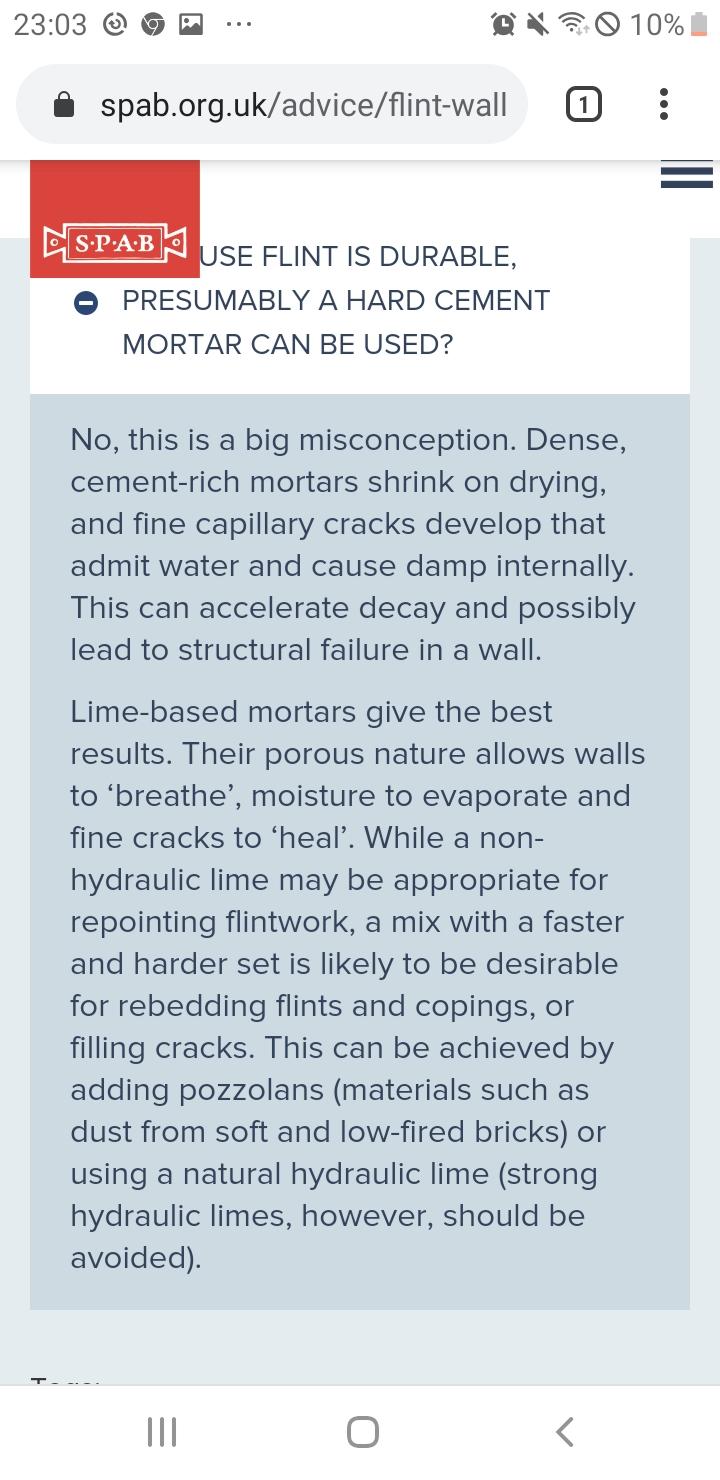

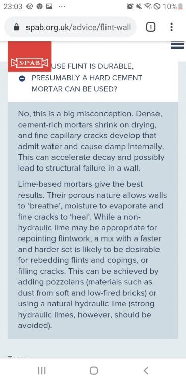

mm289 Posted November 23, 2019 Share Posted November 23, 2019 The addition of hydrated lime won't help in that regard as the set is still a chemical set based on the use of portland cement. Having said all that, flint is very inert, I am not sure that you would need a mortar that flex'd around the flint - we used lime as it was in keeping with our property but not sure I can see a reason not to use portland cement based mortar...... looking at @mvincentd post, he seemed to imply his flint walls were made with portland cement based mortar? Cheers, MM 2 Link to comment Share on other sites More sharing options...
Simplysimon Posted November 23, 2019 Share Posted November 23, 2019 go to the nearest college which does courses in brickwork and ask the technician for your mortar, a nice xmas present should suffice Link to comment Share on other sites More sharing options...
mvincentd Posted November 23, 2019 Share Posted November 23, 2019 2 hours ago, mm289 said: looking at @mvincentd post, he seemed to imply his flint walls were made with portland cement based mortar? Yes. Link to comment Share on other sites More sharing options...
Onoff Posted November 23, 2019 Share Posted November 23, 2019 Link to comment Share on other sites More sharing options...
