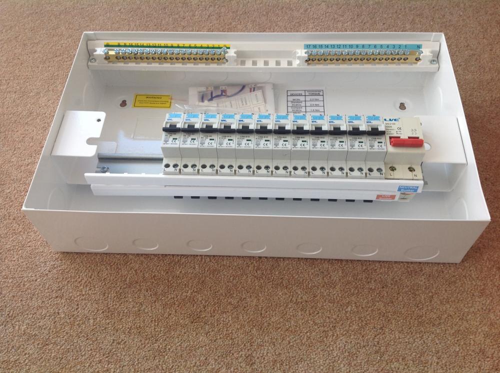

Jeremy Harris Posted November 20, 2019 Share Posted November 20, 2019 If I were doing a build again, I'd forget about ring finals, and run radials for all power outlets, probably grouped as one radial per room (subject to the limit on the number of outlets), maybe two or three radials for the kitchen (just because kitchens need a lot of outlets and may well have several fairly high peak load appliances in use). I'd go for the biggest physical CU I could fit in the available space, as there is nothing worse than trying to work in a CU that's packed full of wires. I'd also fit compact DP RCBOs on every circuit, rather than a split board. I've recently made up a sub-board using these single module DP RCBOs, and, apart from the need to loop in the L and N supplies, rather than use bus bars, they make for a neat installation: https://www.electricalcomponentsdirect.co.uk/acatalog/Compact_Mini_RCBO_Circuit_Breakers.html Link to comment Share on other sites More sharing options...
ProDave Posted November 20, 2019 Share Posted November 20, 2019 1 hour ago, Jeremy Harris said: II'd also fit compact DP RCBOs on every circuit, rather than a split board. I've recently made up a sub-board using these single module DP RCBOs, and, apart from the need to loop in the L and N supplies, rather than use bus bars, they make for a neat installation: https://www.electricalcomponentsdirect.co.uk/acatalog/Compact_Mini_RCBO_Circuit_Breakers.html Why did you not use dual busbars? Link to comment Share on other sites More sharing options...
Jeremy Harris Posted November 20, 2019 Share Posted November 20, 2019 45 minutes ago, ProDave said: Why did you not use dual busbars? Bugger.... Didn't know about them. It's only a small board, though, so wiring them wasn't really a problem. Those dual busbars would have made thing neater, though. Link to comment Share on other sites More sharing options...
Onoff Posted November 20, 2019 Share Posted November 20, 2019 7 minutes ago, Jeremy Harris said: Bugger.... Didn't know about them. It's only a small board, though, so wiring them wasn't really a problem. Those dual busbars would have made thing neater, though. Only 40p per module: PRICES 2019 - JULY (1).pdf Link to comment Share on other sites More sharing options...

Raks Posted November 20, 2019 Author Share Posted November 20, 2019 1 hour ago, ProDave said: Why did you not use dual busbars? that makes the board neater. Is there any modules to repeat the dual bus-bar on multi-row boxes ? I was thinking to install a 3 row din rail, 36 module box. Link to comment Share on other sites More sharing options...
