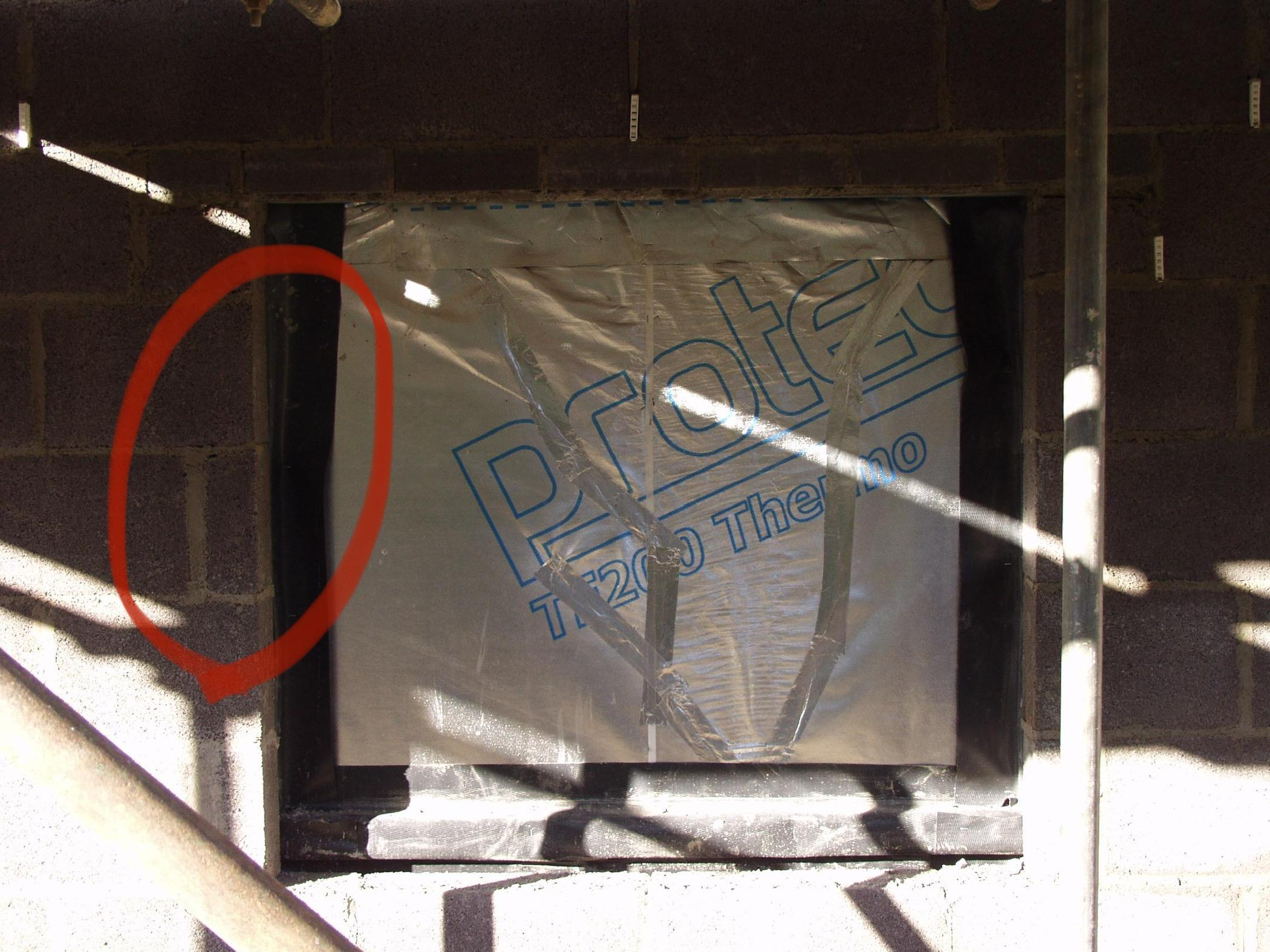

zoothorn Posted November 19, 2019 Author Share Posted November 19, 2019 14 hours ago, PeterW said: Ok - you need to ask the builder to use concrete bricks or cut down blocks to slim down BOTH SIDES OF THE OPENING, as I have a cunning plan.. No.1, you cannot render over timber, or it will crack. No.2, if you just get them to slim the opening by 120mm each side, then you can create an inside “splay” so that the window is equally wider both sides and it looks correct by just joining the edge of the frame to the edge of the blockwork. This will look like it was meant to be done this way. Hi Peter- just going over the replies, I saw this & roughly understand. So the cunning plan is 'creating an inside splay'? I don't quite follow sorry.. I do see what a splay is, a recessed window (& this would be good/ might actually match my orig slightly recessed window its meant to ~look like). What I was told is you cannot use block to 'pack' because the block has nothing to fix to/ cannot interlock into anything as its a block sheer face both opening sides: so the only option is timber to pack the gap. Can you just explain 1st why you think this can be refuted? Then I'll try & understand the splay idea. Thanks- zoot. Link to comment Share on other sites More sharing options...

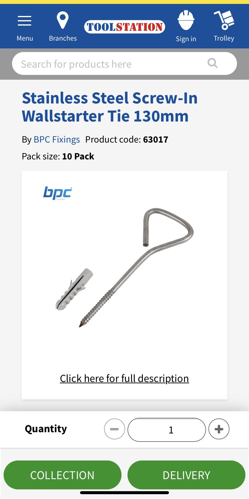

Gone West Posted November 19, 2019 Share Posted November 19, 2019 9 minutes ago, zoothorn said: What I was told is you cannot use block to 'pack' because the block has nothing to fix to/ cannot interlock into anything as its a block sheer face both opening sides: so the only option is timber to pack the gap. I have never understood why your builder said that. Why can't he screw some ties onto the side of the window opening blocks if he feels it's really necessary to tie them in. Link to comment Share on other sites More sharing options...
PeterW Posted November 19, 2019 Share Posted November 19, 2019 4 minutes ago, PeterStarck said: I have never understood why your builder said that. Why can't he screw some ties onto the side of the window opening blocks if he feels it's really necessary to tie them in. +1 to this ... Pack of 10 is £11 delivered tomorrow from Toolstation Even if he puts them in every joint it’s better than nothing. What he could also do is cut this nib out and replace with a half block that would tie the lot in - not exactly difficult with a Stihl saw ... Link to comment Share on other sites More sharing options...
zoothorn Posted November 19, 2019 Author Share Posted November 19, 2019 Just now, PeterStarck said: I have never understood why your builder said that. Why can't he screw some ties onto the side of the window opening blocks if he feels it's really necessary to tie them in. Probably because its BS Peter, he just can't be bothered. He's told me lie after lie successfully hoodwinking me along (re. the wretched H issue continuing to c*ck everything up now I know he is responsible, not the collar position via a Timber Frame computer) so why would he stop now & be truthful? Unless I have a concise, formed alternative plan to 'timber' in one 2 minute sentence.. he just walks off. I'm trying to form this plan. So here I'm trying to understand 'screw some ties' (?).. 'side of the window opening blocks'(? this is what I'm 1st trying to establish whether possible to do, before thinking of fitting the window in).. and 'tie them in'(?). Link to comment Share on other sites More sharing options...
zoothorn Posted November 19, 2019 Author Share Posted November 19, 2019 @PeterW ok thanks that's a start. So these are ties.. to join new 120mm cut sections of block, to the built block-? Link to comment Share on other sites More sharing options...

Danny68 Posted November 19, 2019 Share Posted November 19, 2019 Ok I'm going to muddy the waters ? , I'm not a brickie and would be interested in anyone else opinion . Would it not be possible to cut existing blocks out on the window ( to make a proper bond ) then rebuild up the required 230mm ? It doesn't seem to be that big a job imho. 1 Link to comment Share on other sites More sharing options...

PeterW Posted November 19, 2019 Share Posted November 19, 2019 58 minutes ago, Danny68 said: Ok I'm going to muddy the waters ? , I'm not a brickie and would be interested in anyone else opinion . Would it not be possible to cut existing blocks out on the window ( to make a proper bond ) then rebuild up the required 230mm ? It doesn't seem to be that big a job imho. that’s what I sort of suggested as there are a couple of splits that are only 100mm or so wide that could be removed. Link to comment Share on other sites More sharing options...
Danny68 Posted November 19, 2019 Share Posted November 19, 2019 16 minutes ago, PeterW said: that’s what I sort of suggested as there are a couple of splits that are only 100mm or so wide that could be removed. Apologies PeterW, there you go Zoothorn get the builder to quote you for that then use the discrepancy in the 100mm floor insulation cost as a bargaining chip to get the price down ,say it with a smile then let the builder get on and do it . Link to comment Share on other sites More sharing options...

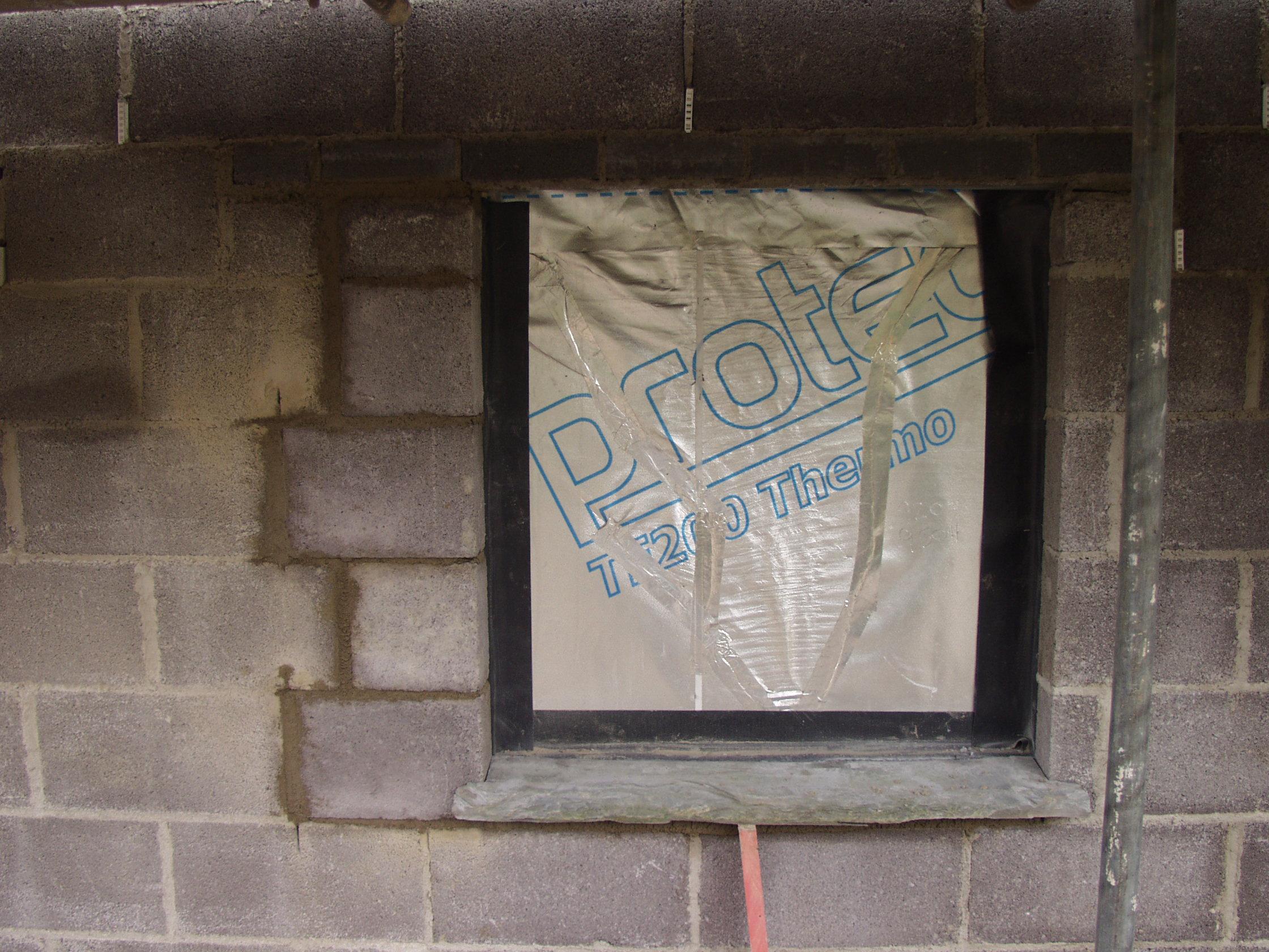

zoothorn Posted November 22, 2019 Author Share Posted November 22, 2019 Builder put a nice bit of slate sill on for me, & window will be set back ~level with the start of block. Good suggestion re. ties/ blocking the side to narrow.. 1 Link to comment Share on other sites More sharing options...

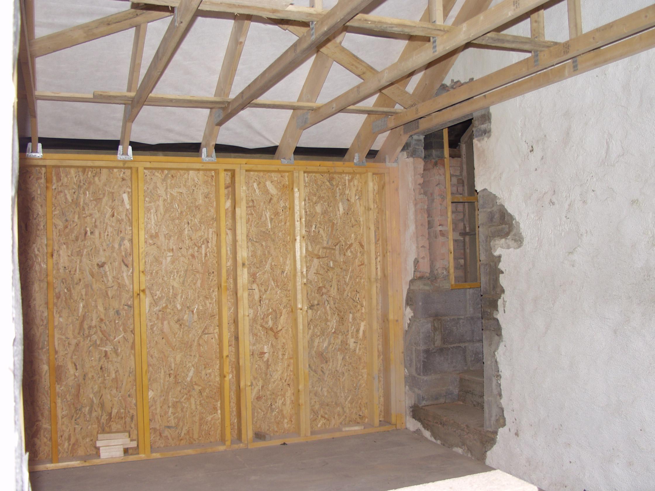

zoothorn Posted November 22, 2019 Author Share Posted November 22, 2019 Inside roof etc. You can see two big 9.5" steps that had to be as compromise due to the low H 'discrepency'. H here will be ok.. but the width 850mm on the plan, is made 820mm block to block (so will need ? on the surface as a finish narrowing it to ?). Nothing I can do about it/ I've only just been able to get in here & measure. You can see the existing roof felt: this area is as the rest of house is/ 2 brick courses with no insulation then roof air in the big voids between inner brick & pB.. hence freezing cold bedrooms. Will be a great sized room. If only floor & ceiling were this damn 1ft higher they should be tho.. 1 Link to comment Share on other sites More sharing options...

PeterW Posted November 22, 2019 Share Posted November 22, 2019 Before he closes it up, get some insulation stuffed in that void to the side of the steps. Cheapo rockwool will do. Link to comment Share on other sites More sharing options...
zoothorn Posted November 22, 2019 Author Share Posted November 22, 2019 1 minute ago, PeterW said: Before he closes it up,get some insulation stuffed in that void to the side of the steps. Cheapo rockwool will do. Yup- I got a whole rockwool spare, asked him to put right up there. The plan is rigid stuff here/ offcuts of his etc.. but more the merrier I guess. Can rockwool go right up to the roof felt? this 'tunnel' will be the cold weak point (not sure what's happening for a ceiling here yet).. just as the adjacent void behind all existing bedroom pB is the houses weak point. Link to comment Share on other sites More sharing options...
PeterW Posted November 22, 2019 Share Posted November 22, 2019 Yep just leave a small ish gap so it doesn’t touch the felt. But would be using Rockwool everywhere including in then brick cavity. If the whole house is twin skin brick (and not solid) you can get a grant to get blown in insulation. Will only cost you £2/300 I expect to have the whole house done. Link to comment Share on other sites More sharing options...
