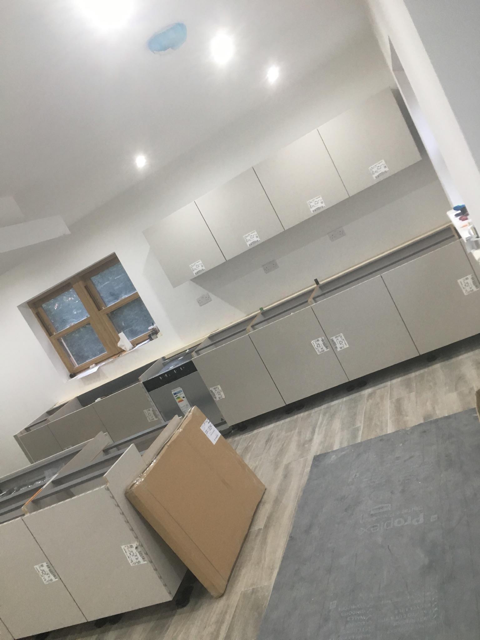

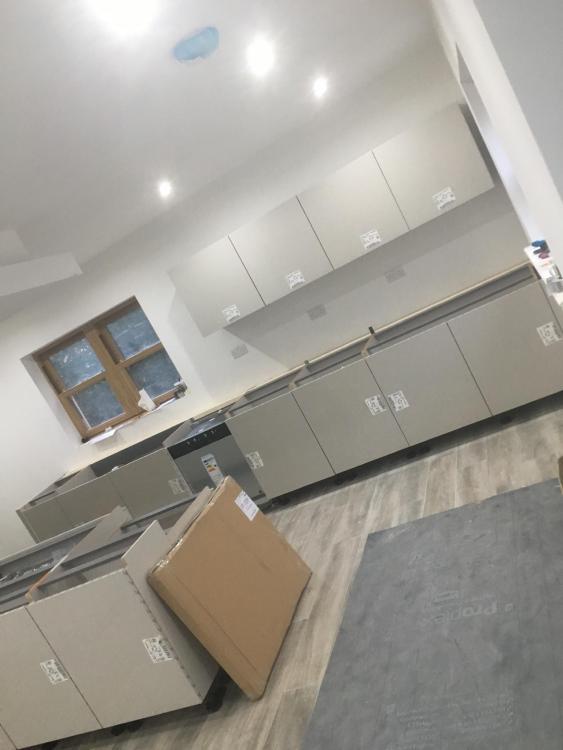

We have waste pipe that would be very difficult to re-locate along a wall where we have a run of new base units, there are also heating pipes which is making the whole thing protrude from the wall around 80mm, my fear is that we will struggle to fit in the integrated oven that is 550mm deep, has anyone got over a similar issue?
Can you move the base units a little further from the wall? There is no hard/fast rule about where you position them as long as this works in the room layout and you can get a worktop deep enough to accommodate.
Thats possibly my best option, we are having quartz worktops which will be cut to suit so would just mean that that worktop would be slightly deeper.

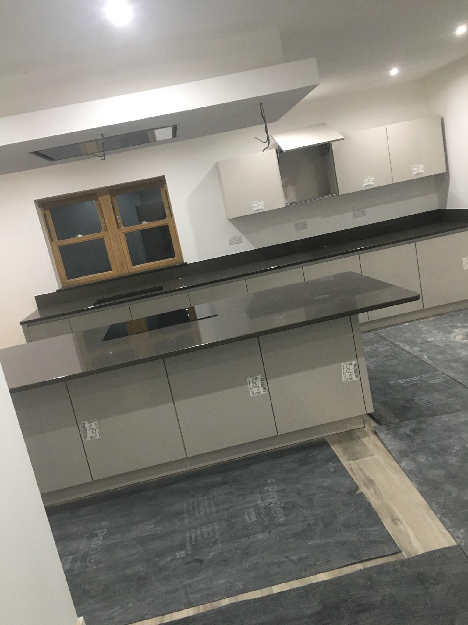

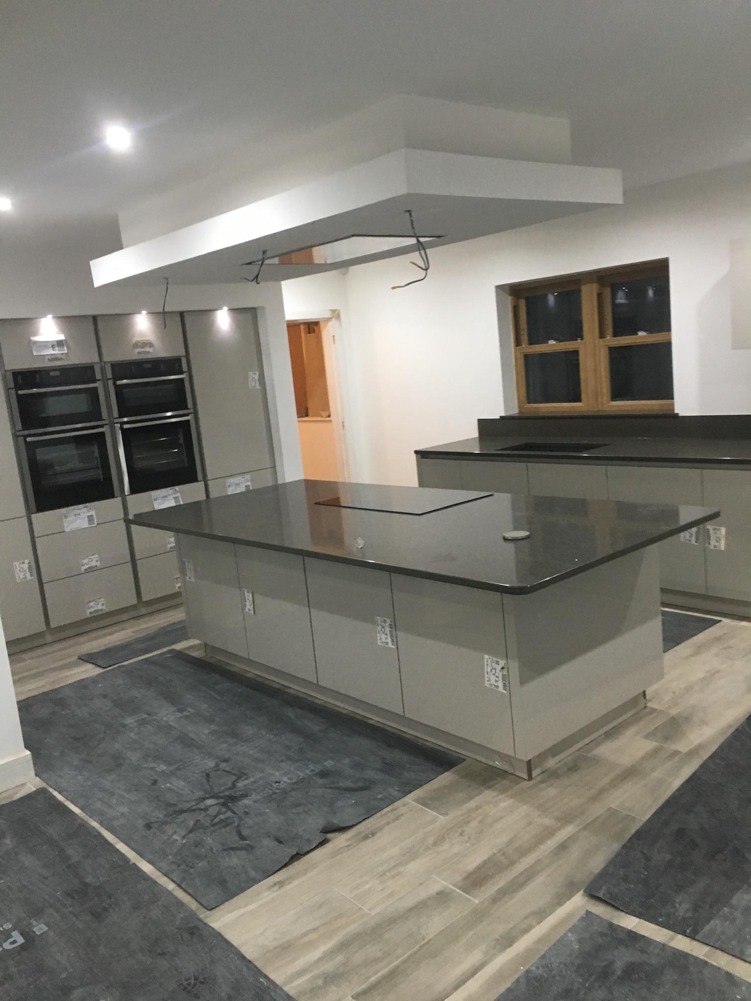

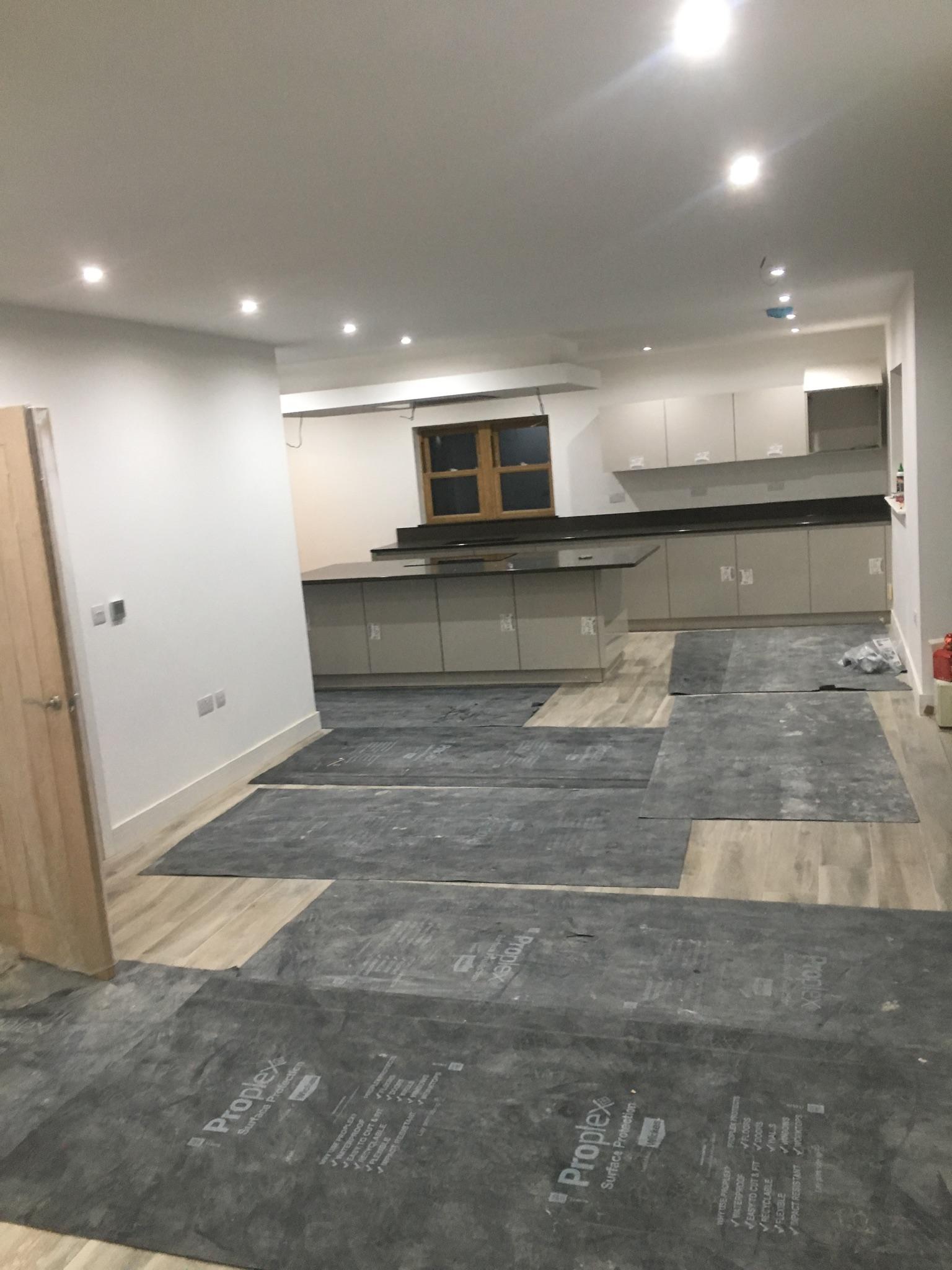

My wife had already decided she wanted 750 deep quarts worktops
Which helped me with the fitting I simply ran the wastes a pipes on the surface and fixed two 50 mil timbers to the wall
Which gave me a 100 mil service void
As pictured
As pictured
That looks pretty good to be fair, you didn't get your units from DIY-Kitchens by any chance did you?
