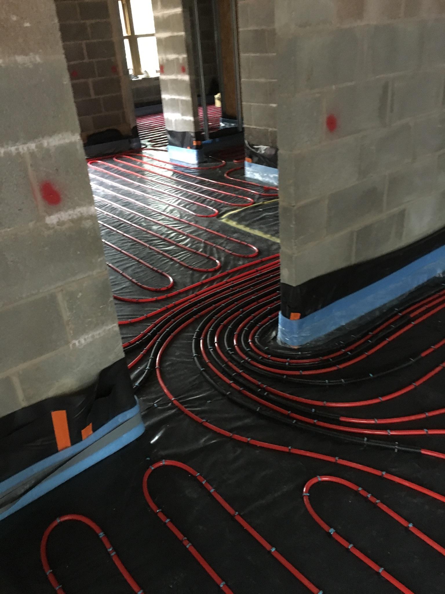

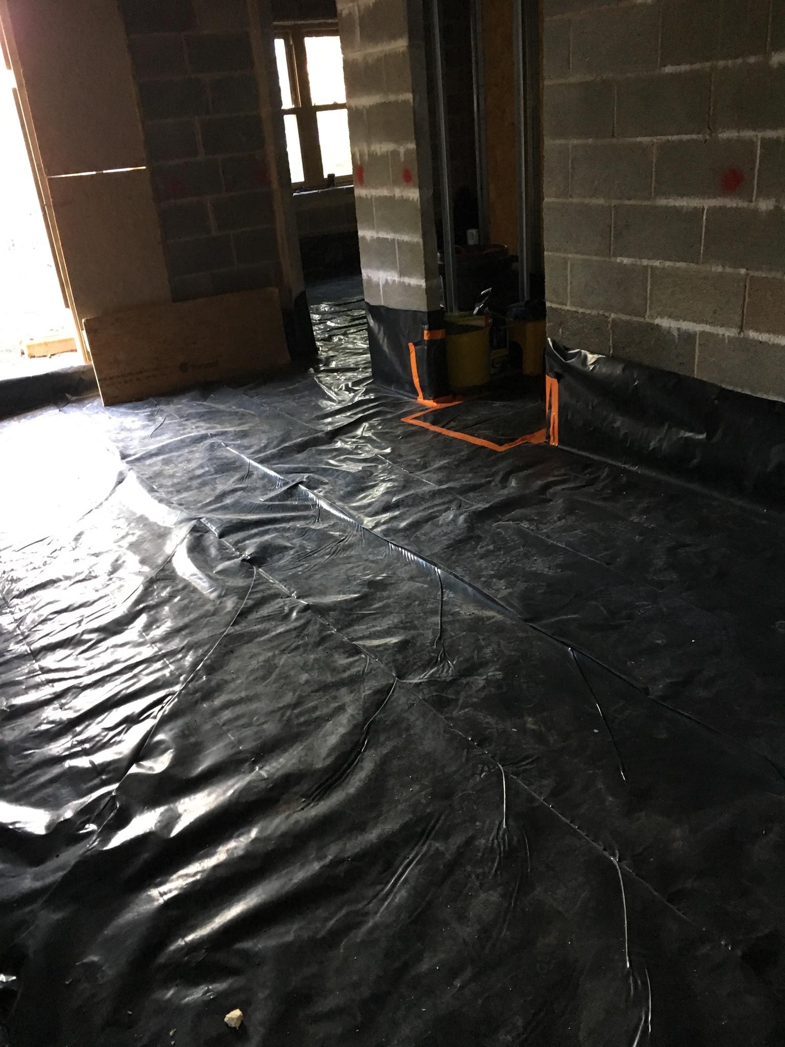

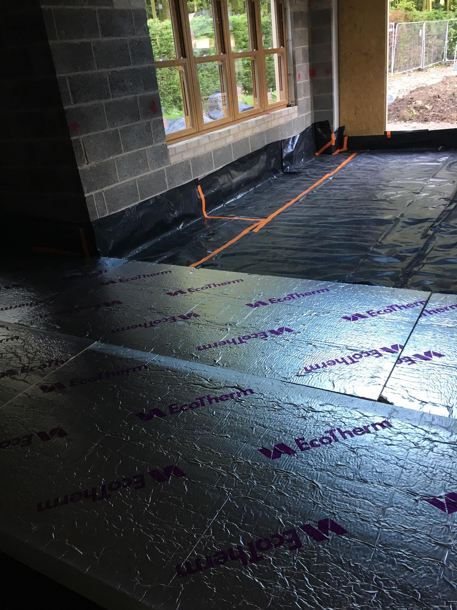

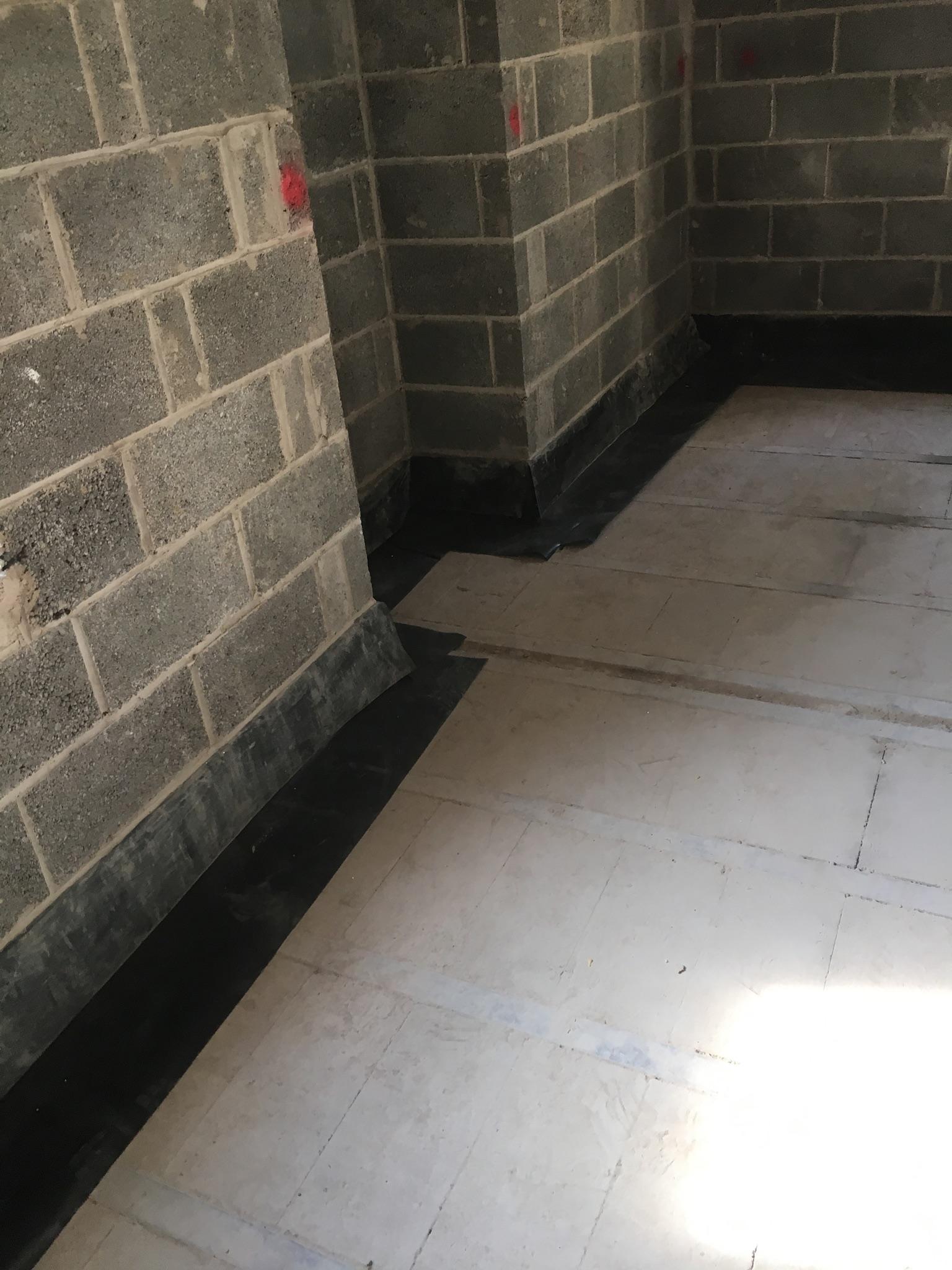

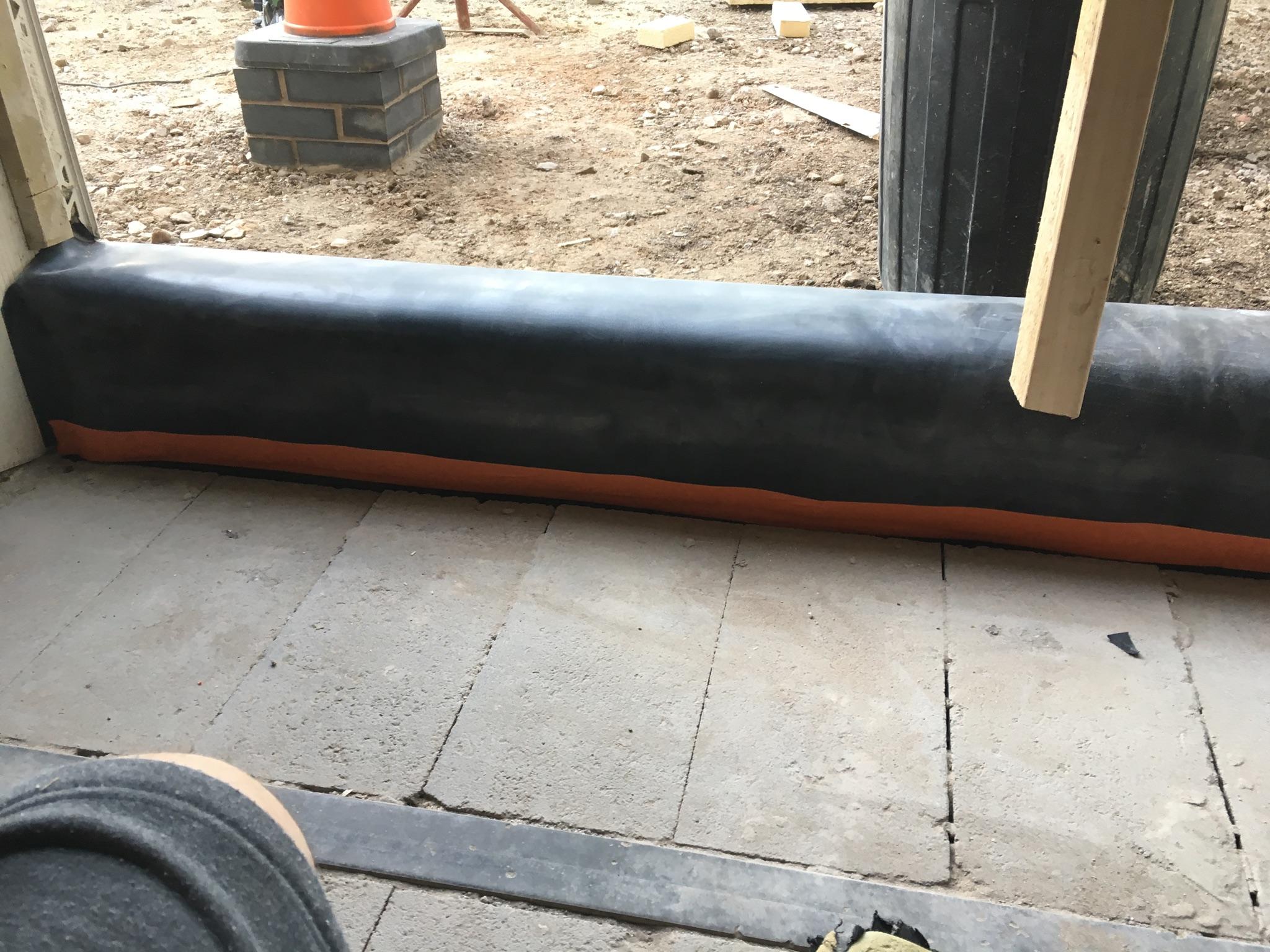

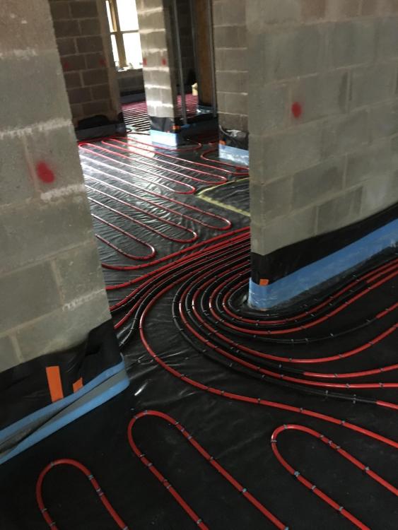

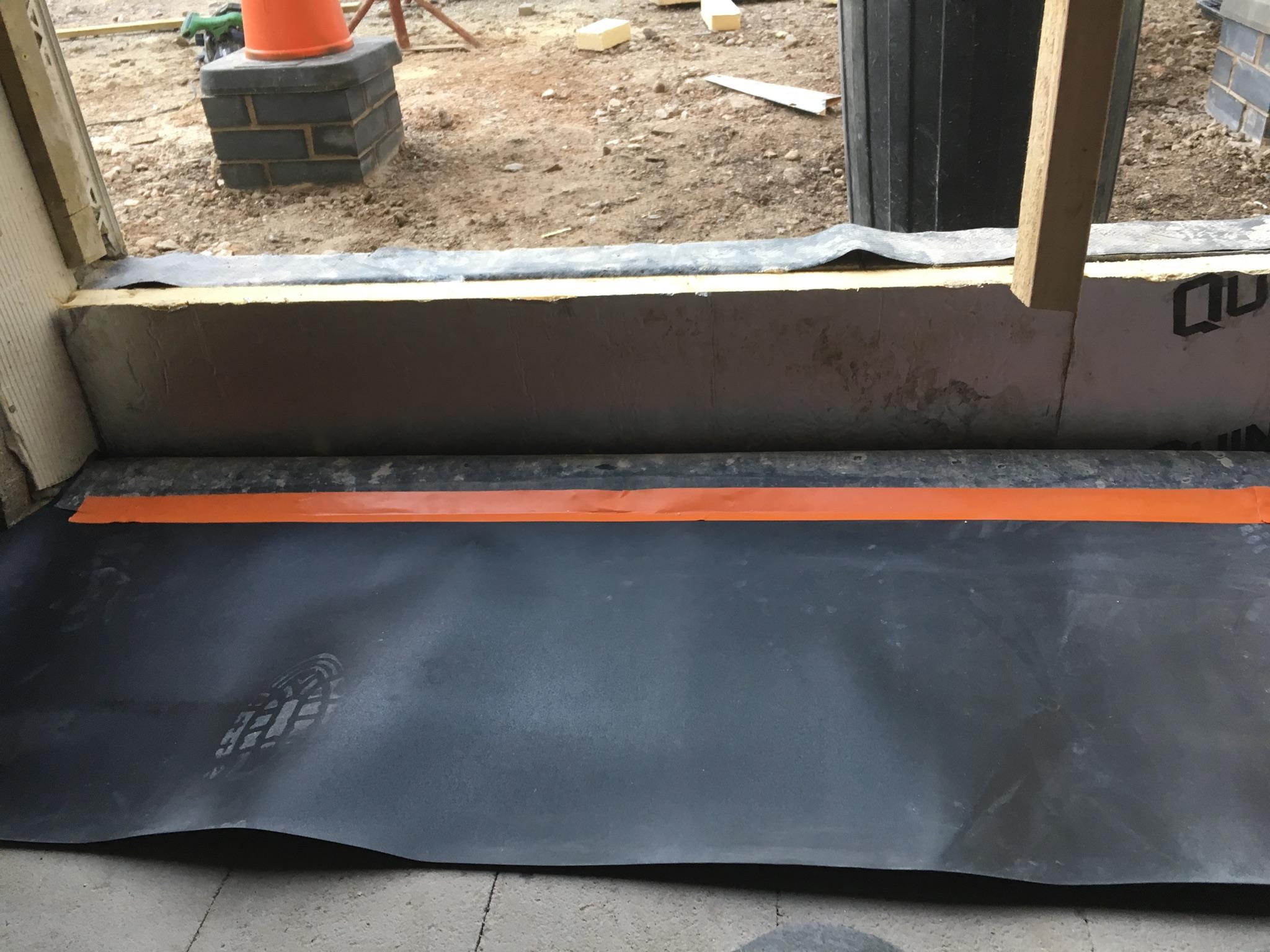

You would normally lay a membrane over the whole floor taping any joints and Attaching the edges to the high load dpc hanging from the block work
Then the insulation is laid with another membrane (slip) on the top

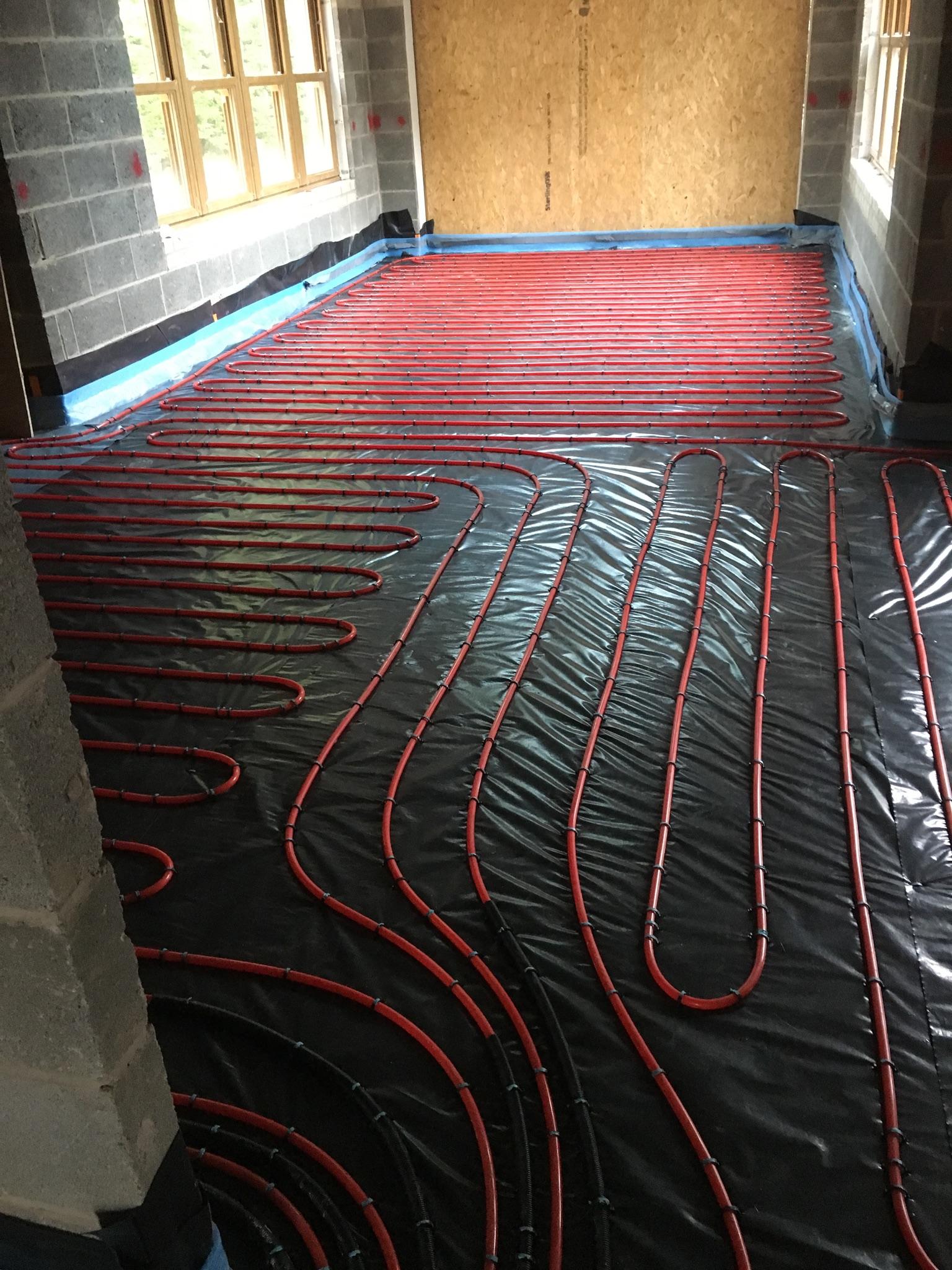

Pipes clipped through that
Some  clip the pipes directly to the insulation
Posted

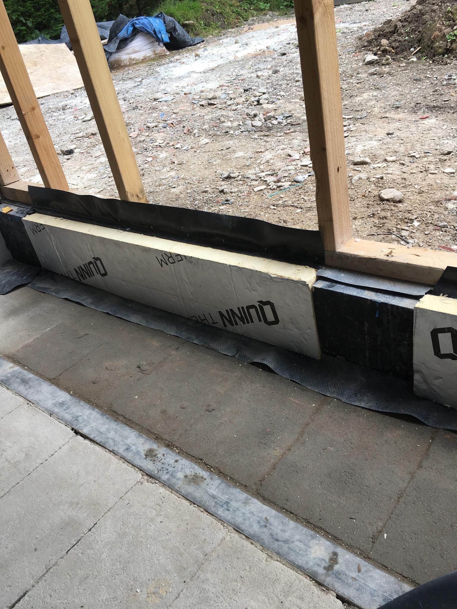

Here’s some I took for BC

As nod mentioned, your DPC will actually be the first layer of DPM you put down before the insulation. Generally fairly high grade stuff too. The clips only pierce the thinner layer above the insulation, which is only really there to ensure an unbonded concrete/screed above

No problem at all
Overload of pics
But shows the process
  • Thanks 1
Posted
Probably helps to point out: The DPM layer (below the insulation) is quite thick and hard(ish). The top layer (above the insulation) is almost as thick as a garbage bag, if maybe just a bit thicker.

For us the lower membrane below the insulation was our radon barrier (Cornwall)  so much thicker. The slip membrane on top of insulation was a very thin DPM, pierced a lot of times for the UFH but no issues whatsoever. This was just taped up the walls whereas the lower radon membrane was fully lapped and taped to the DPC as @nod mentioned.
Worth also thinking about how your might link your wall airtightness layer (not sure of construction) to the floor? Our wall membrane is lapped and taped to the lower radon membrane to ensuite continuity in the airtight layer.

@Patrick you need some clarification on this, piercing the DPM is a big problem.
In @nod pictures he hasn’t pierced the DPM, this is covered by the insulation, the black plastic you can see with the clips pierced through is a second layer called a slip layer, this is there to stop the screed getting between the insulation and lifting it up.
