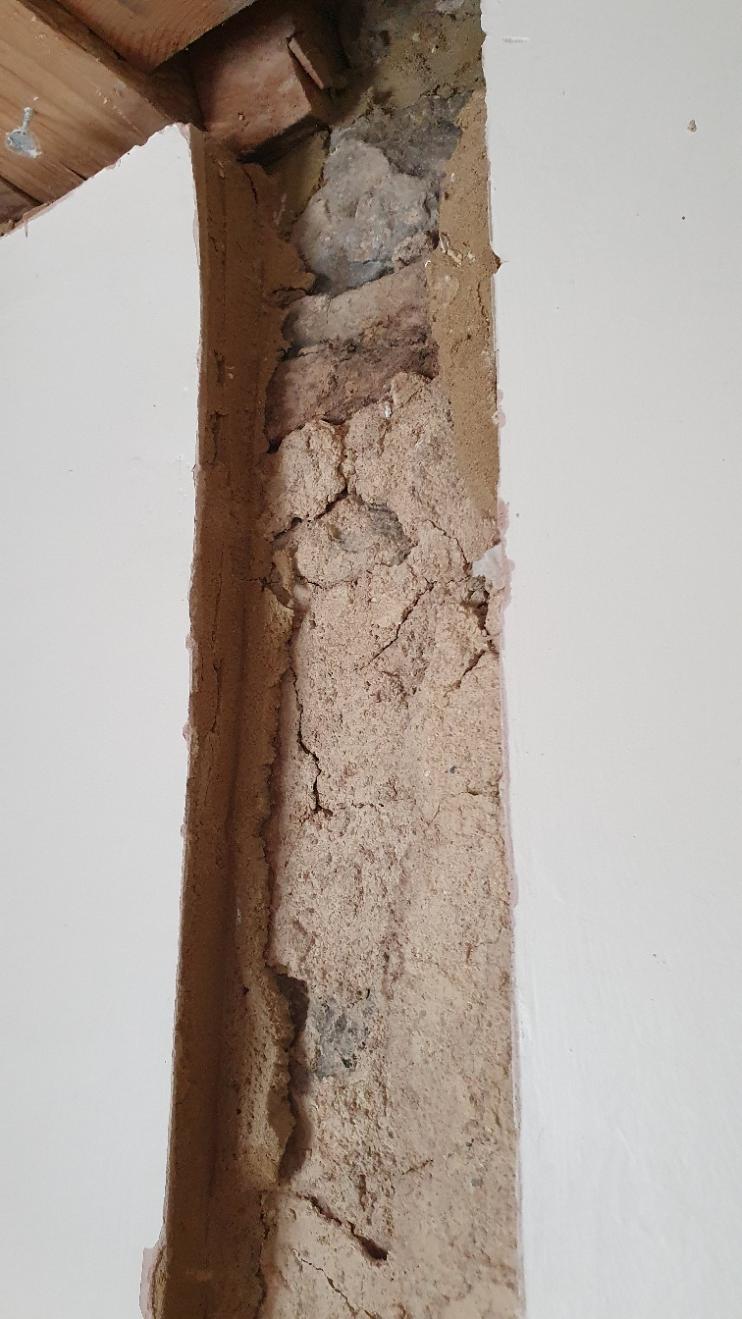

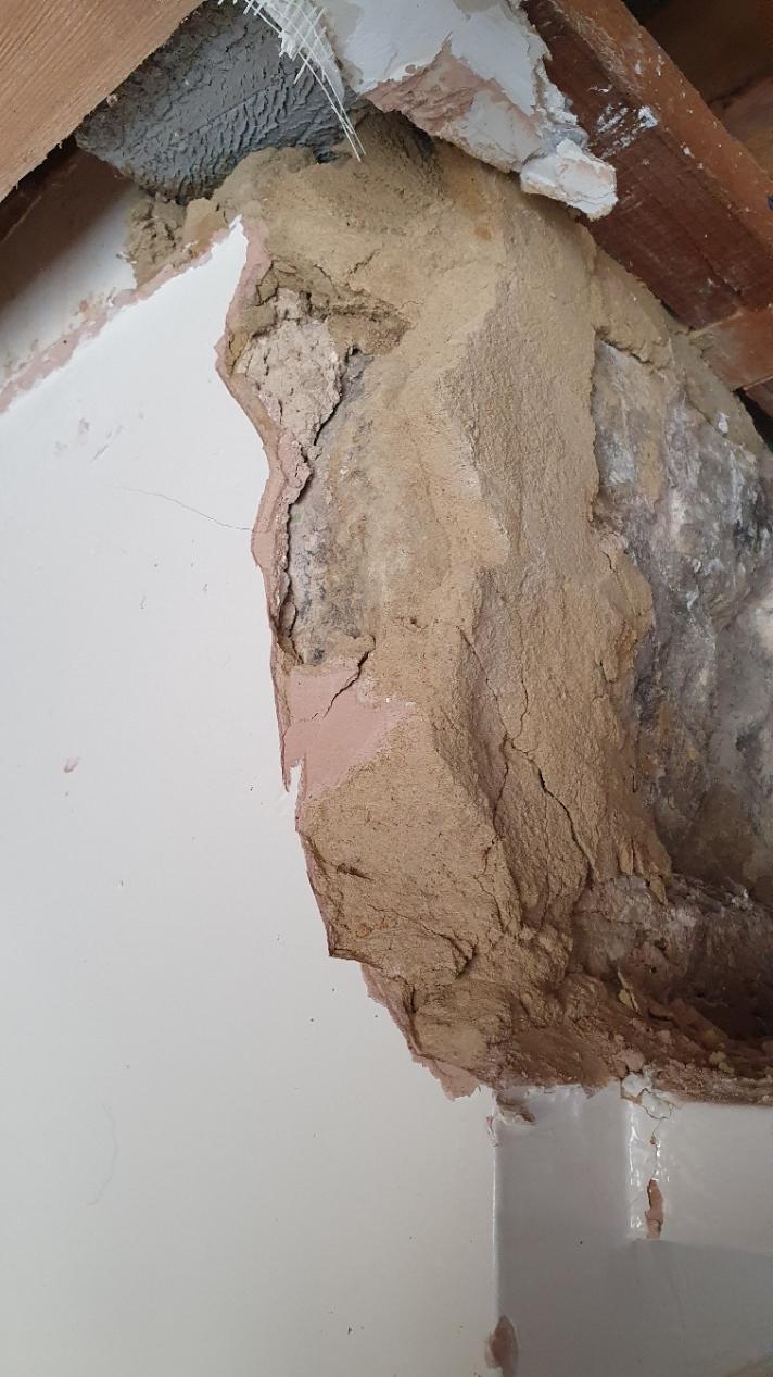

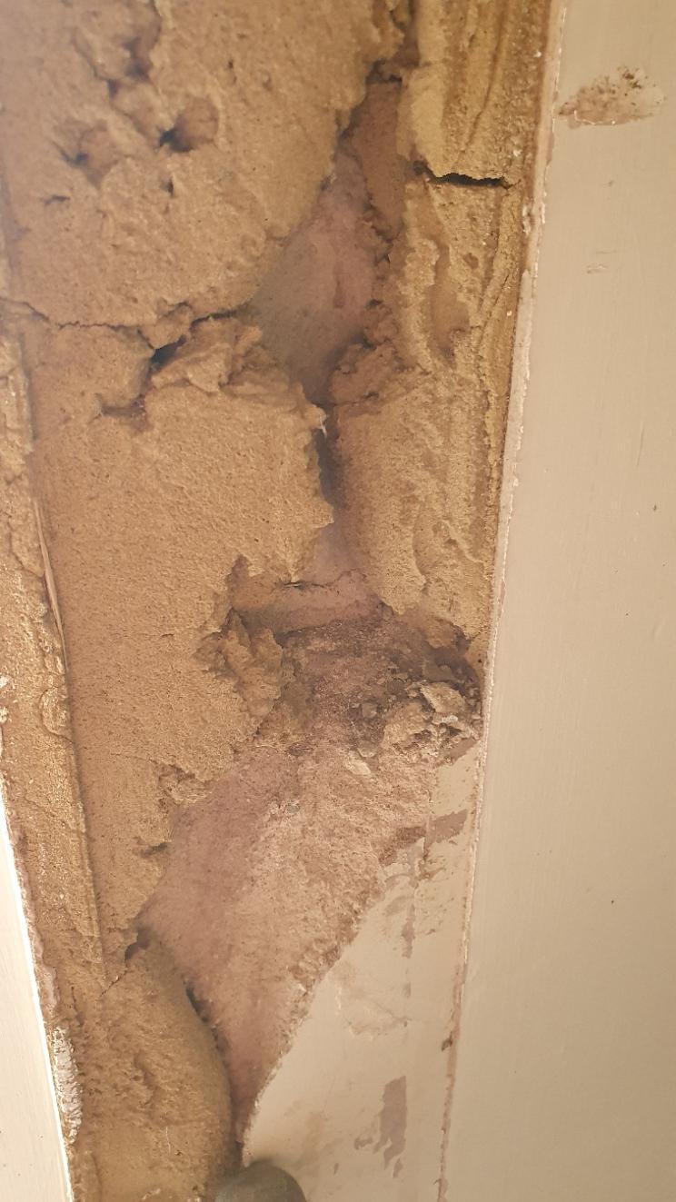

Wil Posted September 30, 2021 Posted September 30, 2021 Interesting development in that I appear not to have dot and dab at all. I thought the hollow sections indicated dot and dab, but it appears I have solid plaster direct onto the stonework. Possibly with a thin skim coat of more modern plaster on top. I bashed 7 bells out of a wall I'm going to drop anyway and it was fairly old plaster attached. I could potentially take other walls back too, but stripping all the internal walls back and re-insulating is a 'move out and live in the chicken shed type job'... Does this change things in terms of removing existing though? Would that count as my parge coat in Marc's list above and I can then DnD EPS directly onto this? The plaster appears to be up to an inch thick in places, no current signs of any condensation issues etc and I'd hopefully continue to avoid these! I've attached a couple of photos showing some of the buildups where I've got back to stonework in case they're of any use...
Wil Posted September 30, 2021 Posted September 30, 2021 On 30/09/2021 at 14:10, Mr Punter said: It looks like render and set. Expand Thanks, is there any impact from this on means of insulating the walls internally?
Mr Punter Posted September 30, 2021 Posted September 30, 2021 If it is sound I would leave it on and go over it. Sometimes with old walls if you hack of the plaster you find big chunks of wall want to fall out. 1
