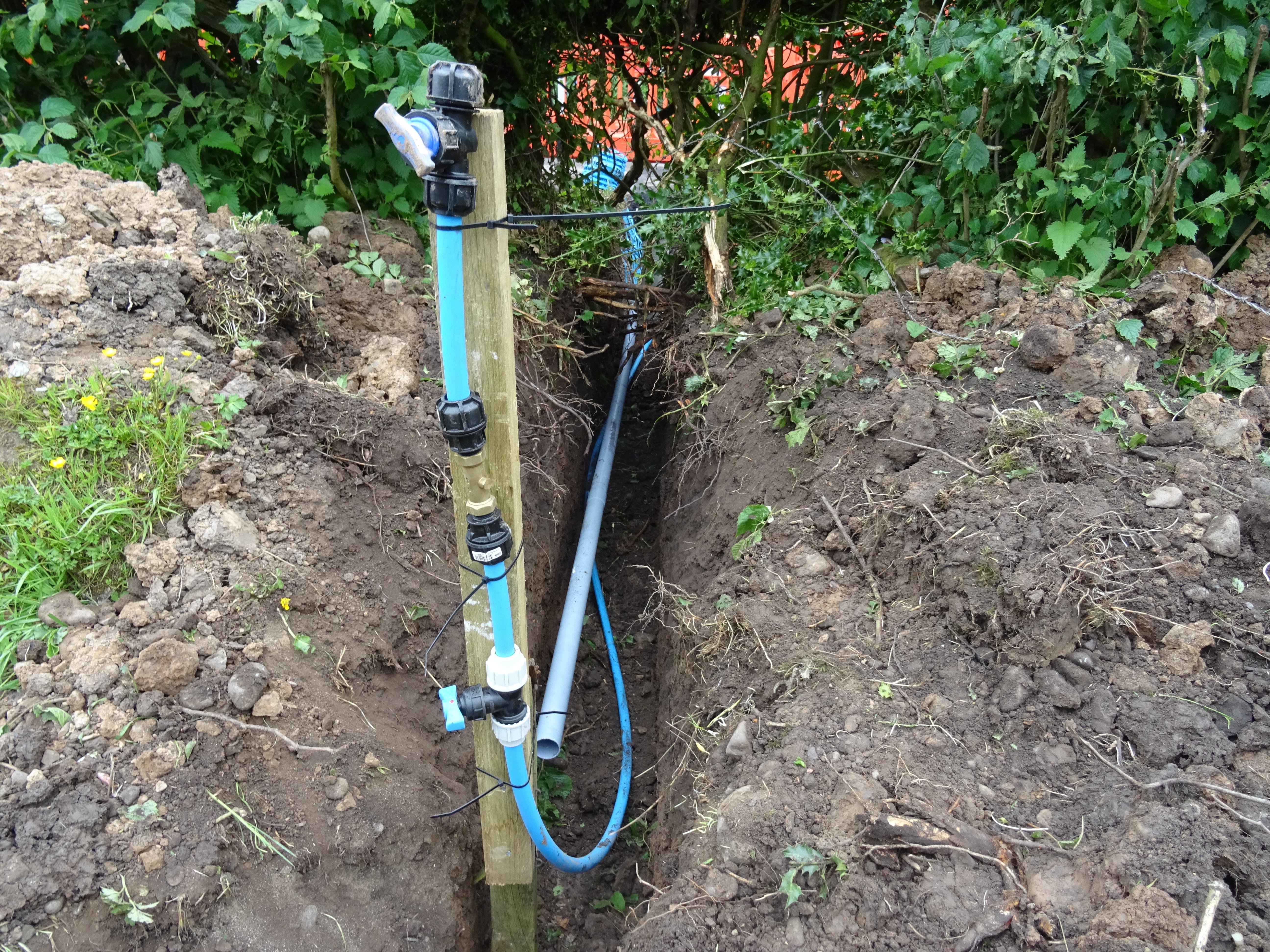

Redoctober Posted October 29, 2019 Posted October 29, 2019 As for the trench, I don't believe such things as pea shingle are required - see photo of ours installed by our plumber 18 months ago. The depth will depend on what else you plan to put in the trench. 1
BotusBuild Posted October 29, 2019 Author Posted October 29, 2019 4 minutes ago, Redoctober said: As for the trench, I don't believe such things as pea shingle are required - see photo of ours installed by our plumber 18 months ago. The depth will depend on what else you plan to put in the trench. I see three "valves". Could you explain the one in the middle (the brass one). I assume the upper and lower ones are simple isolating valves.

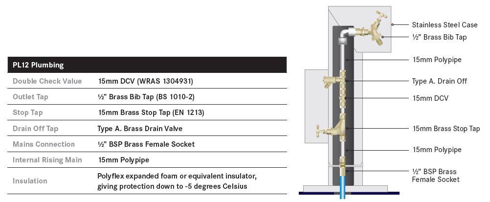

Redoctober Posted October 29, 2019 Posted October 29, 2019 27 minutes ago, Simplysimon said: double check valve Thanks as I don't have a clue on such matters. I just picked up the invoices!

Andrew Posted October 30, 2019 Posted October 30, 2019 We received the attached from United Utilities. Might be worth asking SW Water if they have a similar document. A2 Temp to perm Wall Mounted (Normal).pdf 1
