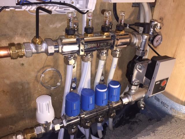

For the past couple of weeks I have been trying to get my new UFH balanced as per the instructions Uponor provide for the Compact V5.
The final piece of the puzzle is calibrating the lockshield that is on the return of the manifold; to be clear this is a single lockshield on the return pipe not on the manifold ports.
The instructions provided by Uponor are as follows:
  • The lockshield valve needs to be opened so that it forces the majority of the water around the UFH system. The primary and secondary pump speeds, existing primary pressure and manifold size will affect how far open the lockshield valve needs to be.
  • To make an adjustment first unscrew and remove the white cap. Use the included Allen Key to adjust the valve.
  • To calibrate it is recommended that the lock shield valve is first fully closed and then opened until you see the thermometer continuously reading the same temperature as the setting on the injection valve head.

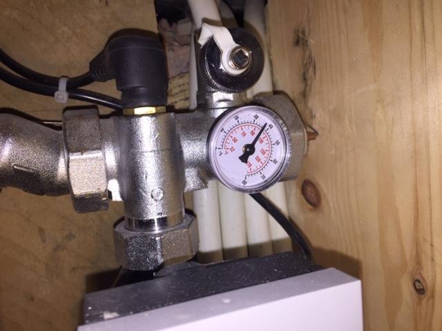

I have followed these instructions as best I can but I never get the temperature on the thermometer to match the injection head it is always 5 degrees higher (ie I ask for 30 and the mixer provides 35) - thats the first problem.
The second is that I can hear and feel the water flowing through the flow and return and I am mindful that the instructions say they want the majority of water to flow around the UFH but it seems like I get the occasional air lock so I end up opening the lockshield a little to release it.
Perhaps I am just being to cautious and it needs to be a little more open (and maybe that will fix my first problem too) but for something described as calibration the instructions are rather unhelpful; some description of what happens when it's too closed and too open would help me determine the right setting.
Does anyone have any experience of calibrating this manifold and any words of wisdom please?
My old system was the same, the two temperatures never matched. I wouldn’t loose sleep over this.
Thanks for the quick replies, I've attached a pic from the manual so most of the parts are labelled. Also a picture of my system with the allen key in lockshield and the thermometer vs injection head.

Yes, there's an AAV on the return just out of shot to the left of the allen key, there's also one on the flow from the boiler
That is a very different mixing system to any other sort of UFH manifold that I have ever seen.
A "flaw" in this calibration procedure is they are making the assumption that the setting dial on the input thermostat is actually calibrated correctly and you will therefore see exactly that set temperature on the thermometer.  I would not trust that to be the case, especially at low temperatures.
As long as you are seeing a constant temperature on the thermometer, and that constant temperature goes up and down as you adjust the input thermostat (allowing it time to do so when you make an adjustment) then I would not worry.  Then set the temperature to get the thermometer reading the temperature you want, and ignore what the dial on the thermostat says.
The principle of operation here is the thermostat head will shut off the boiler flow when the set temperature has been reached.

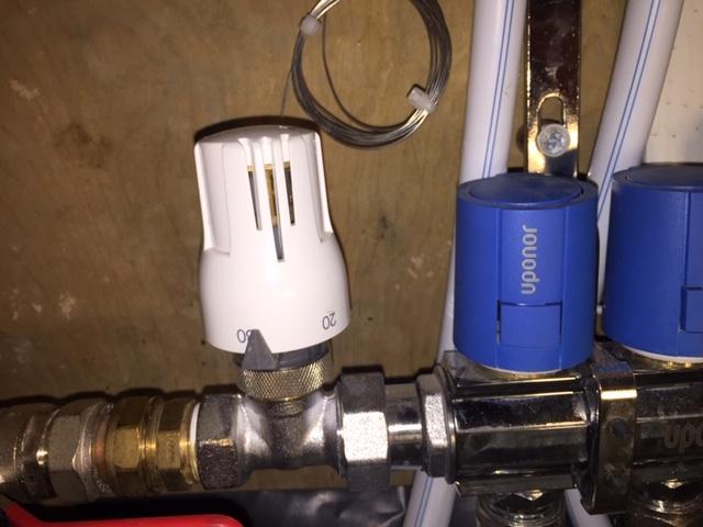

My mixing system looks like this
That was obviously before the pipes were connected.
The two ports to the left of the temperature dial, the top one is boiler return and the bottom one is boiler flow.
Most that I see are a variation on this type.  But neither is right or wrong, just different.
I asked about the source as I found mine would not reliably regulate low enough so I have it set as low as it will go and instead regulate the temperature by setting the "water leaving temperature" on the air source heat pump to deliver the water temperature that I want.
I think your type of thermostat with a capilliary sensor regulates better.
