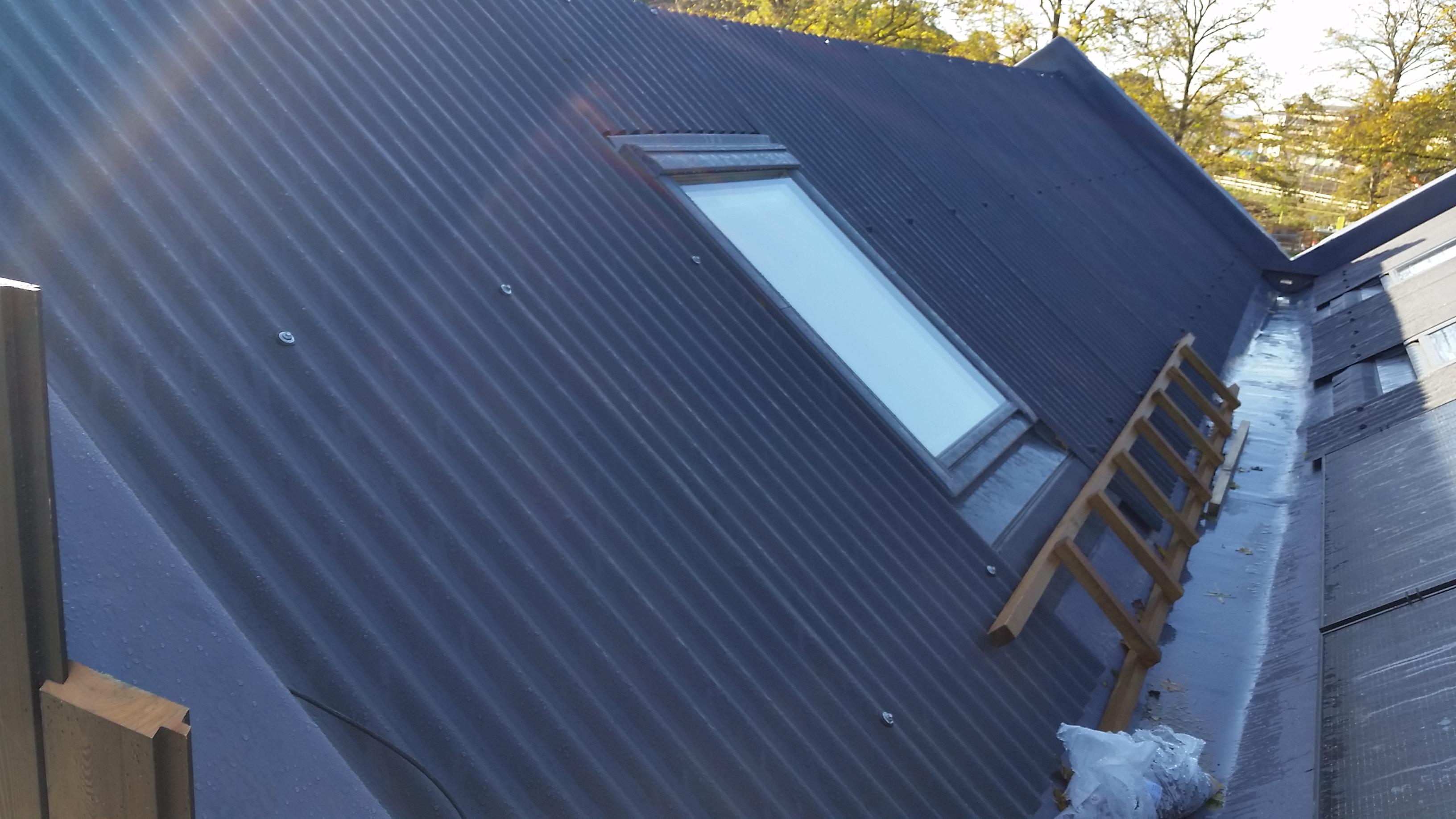

Cpd Posted October 24, 2019 Posted October 24, 2019 3 hours ago, scottishjohn said: Maybe just me ,but i would have to cover that frilly flashing it with something . Is there a reason why you could not use lead backed flashband from frame to roof -- it sticks and shapes very well if applied correctly ? I think it’s just you ?..... done correct it’s just fine and it works. It’s an integral part of the velux flashing, you could use a flat flashing and then put foam strips to stop water blowing up if you were really fussed......
scottishjohn Posted October 24, 2019 Posted October 24, 2019 1 minute ago, Cpd said: I think it’s just you ?..... done correct it’s just fine and it works. It’s an integral part of the velux flashing, you could use a flat flashing and then put foam strips to stop water blowing up if you were really fussed...... or use flashband at the end of the flat type to finish off+stop water being driven under with wind ?

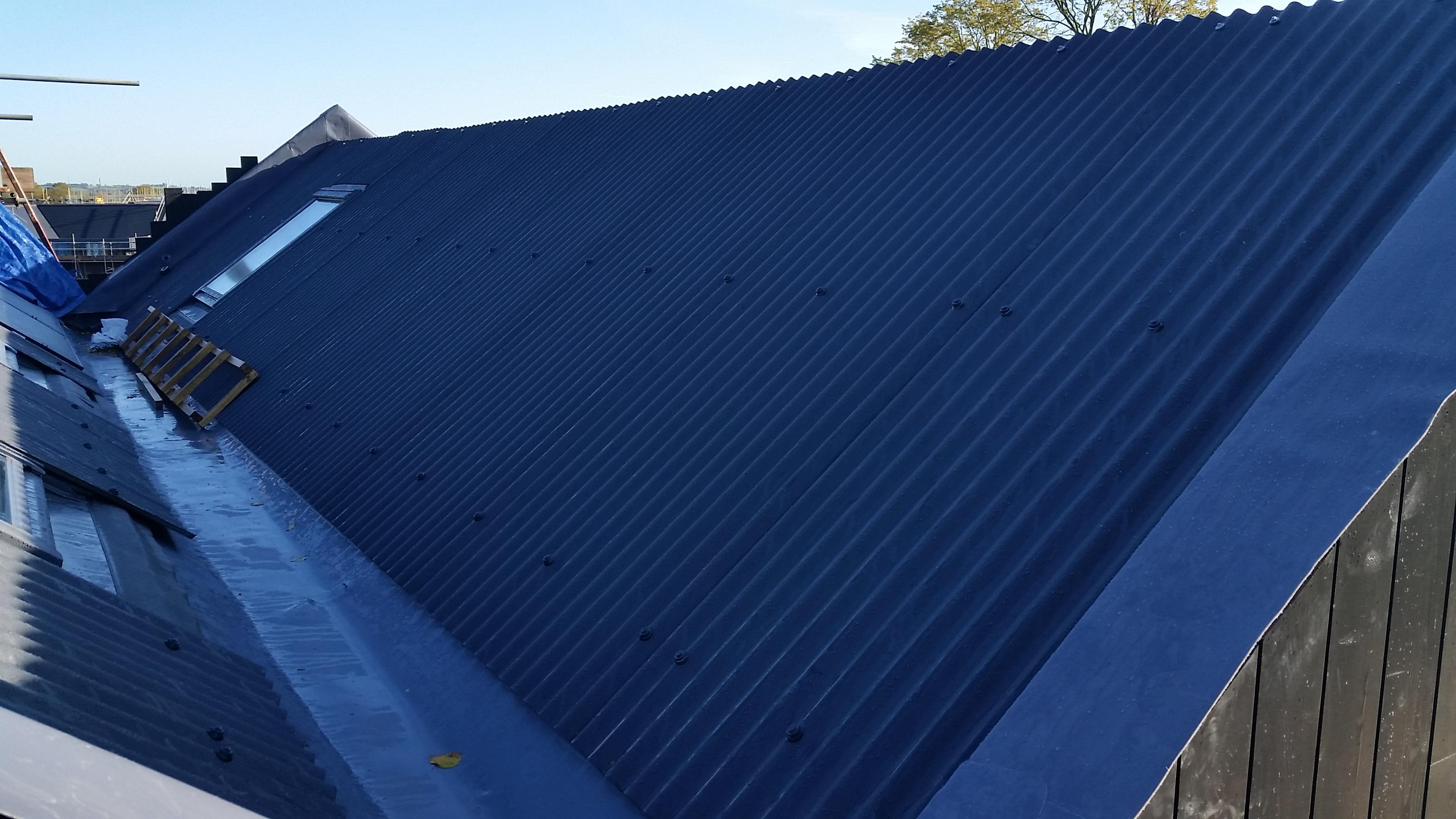

Visti Posted October 24, 2019 Author Posted October 24, 2019 Good news is I think the contractor felt ashamed enough to apologise and rectify the work on one roof today. Turns out being a reference for half the other self builders in the development has some sway when they realise it! Taken today and tomorrow off from work to supervise onsite directly and ensure the rest gets fixed too. Thankfully I had spare material for the car port which can be cannibalised for this, and they'll be paying for replacements directly out of their fees. 9

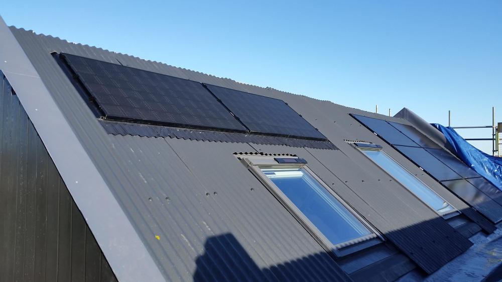

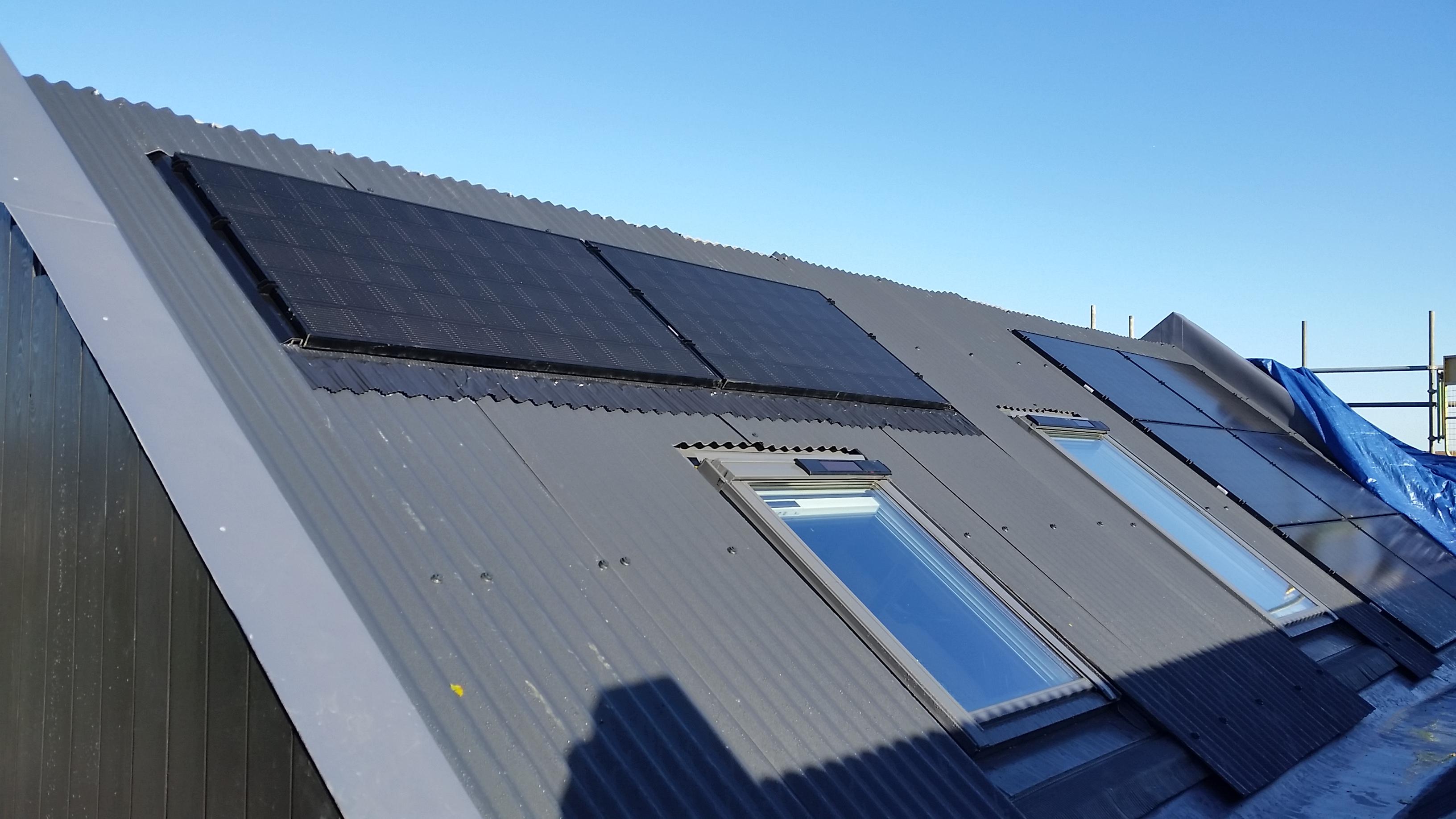

Visti Posted October 27, 2019 Author Posted October 27, 2019 Much improved! Still some details like above the window to the PV I'll get them to adjust, but much better. Will show more once the final two pitches are done @Cpd Thanks again for all your helpful advice. I'll be DIYing my carport myself with these sheets! 2
Cpd Posted October 27, 2019 Posted October 27, 2019 Definitely a big improvement, it’s a shame you had to be the customer they got to “learn” from but at the end of the day it’s done. When you do your car port I think you will wonder what all the fuss was about as it’s ALL in the preparation and planning, putting the tin up and fixing it is the EASY bit. Anyway glad I could have contributed something to the forum. 1 1
