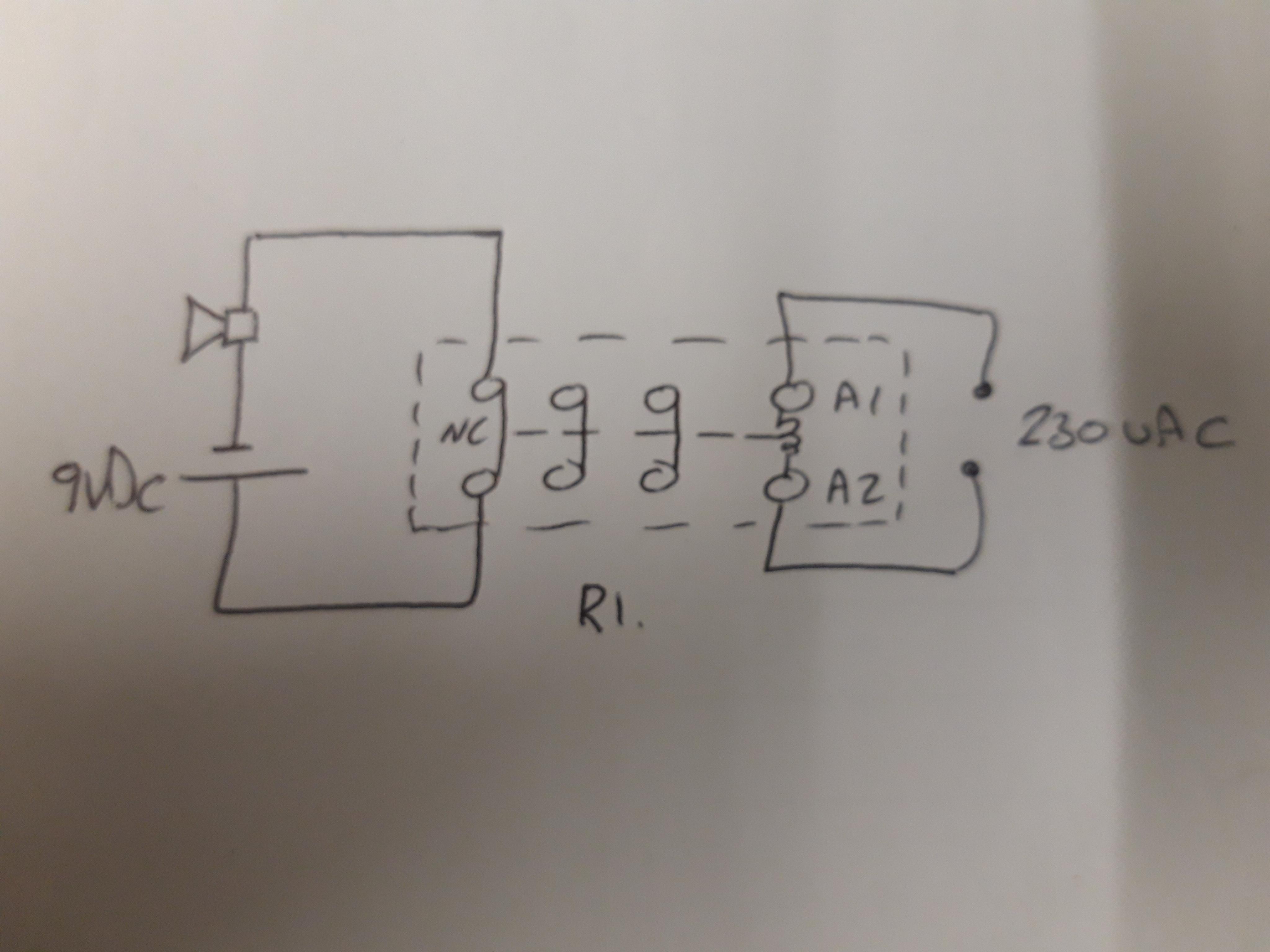

Let's face it it's only a 230VAC relay held open when there's mains there. When power is lost the relays normally closed contacts shut triggering the 9VDC battery powered sounder.
Easy to make from scratch with an ordinary electromechanical relay but always the chance it might stick over time...unlikely I guess. I'd maybe use an SSR if I was to make one I think.
Very roughly it's this. 230 keeps the NC contact open. Lose it and sounder goes off. Replace sounder with small relay to trigger wireless doorbell:
For £10 God knows what's inside. 2 pin plug btw so you need an adapter. Not an issue if your going to hack it!

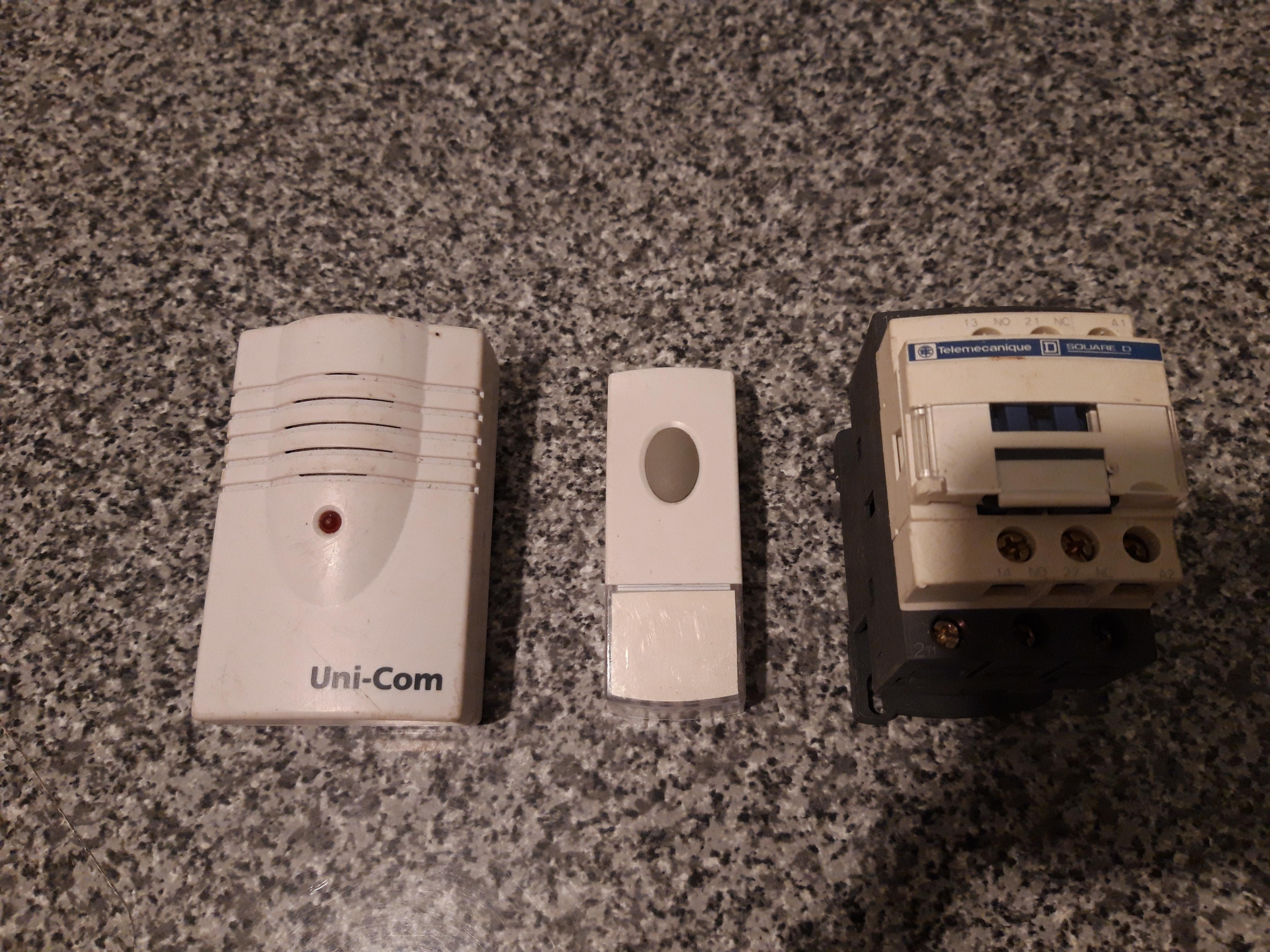

Just dug out a random wireless doorbell. Main problem is even if you keep your finger on the transmitter (CR2032 cell) button it doesn't continually sound the sounder (2 AAs).
Contactor might be overkill but first I found with an NC contact! ?

Here you go Peter, little video of a nice and simple chunky contactor to give you a volt free set of contacts to do "something" if you lose power.

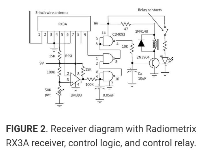

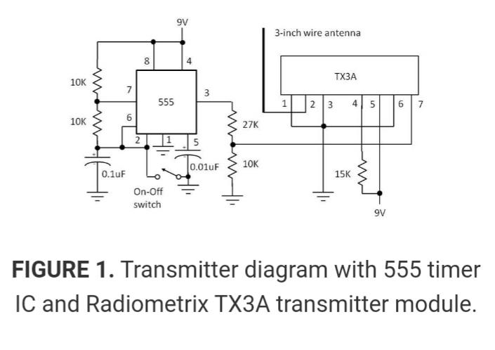

Ideal transmitter and receiver circuits here methinks:
https://www.nutsvolts.com/magazine/article/cheap-and-dirty-wireless-remote-control
Transmitter constantly transmits and receiver has an LED and relay output.
I wonder if those cheap as chips Chinese RF modules @ProDave got from China could be substituted for the Radiometrix modules?
