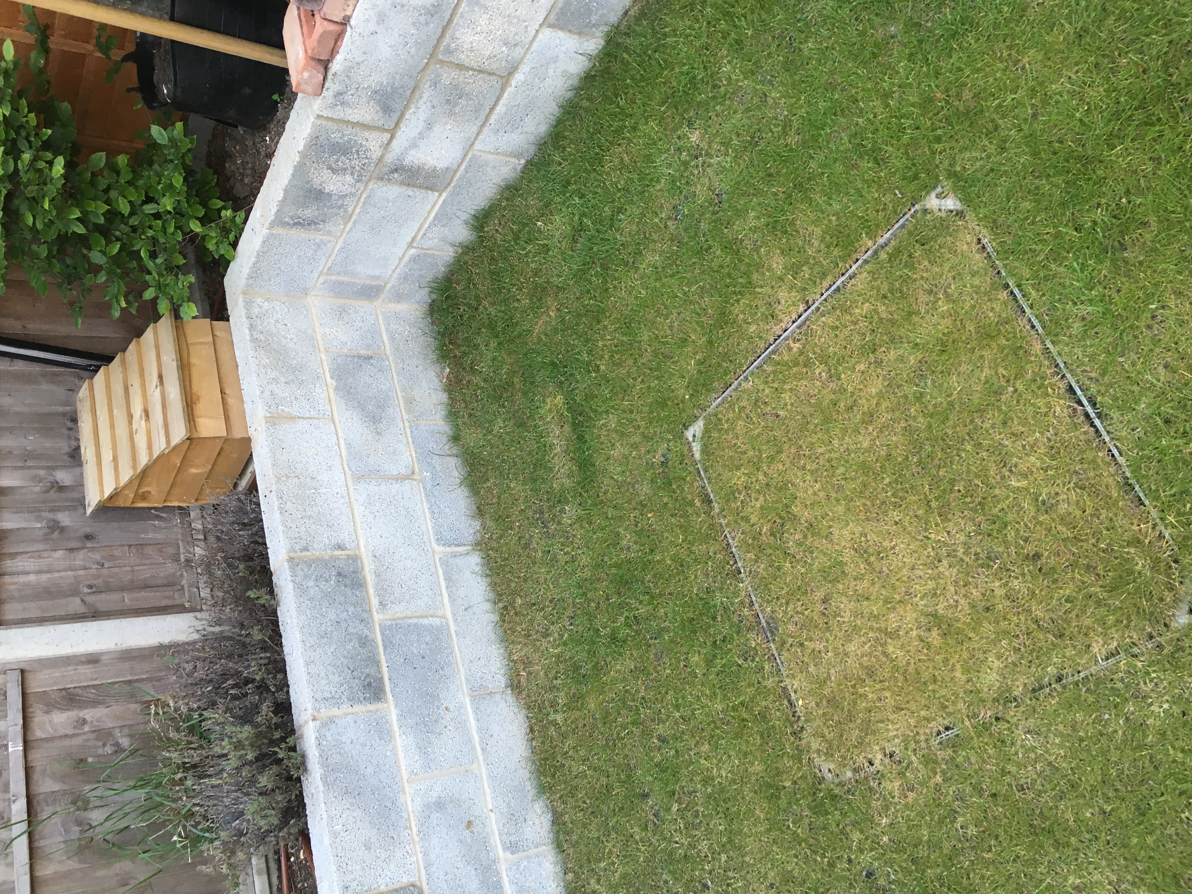

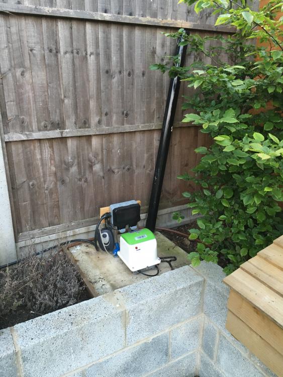

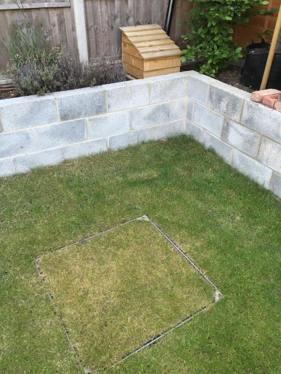

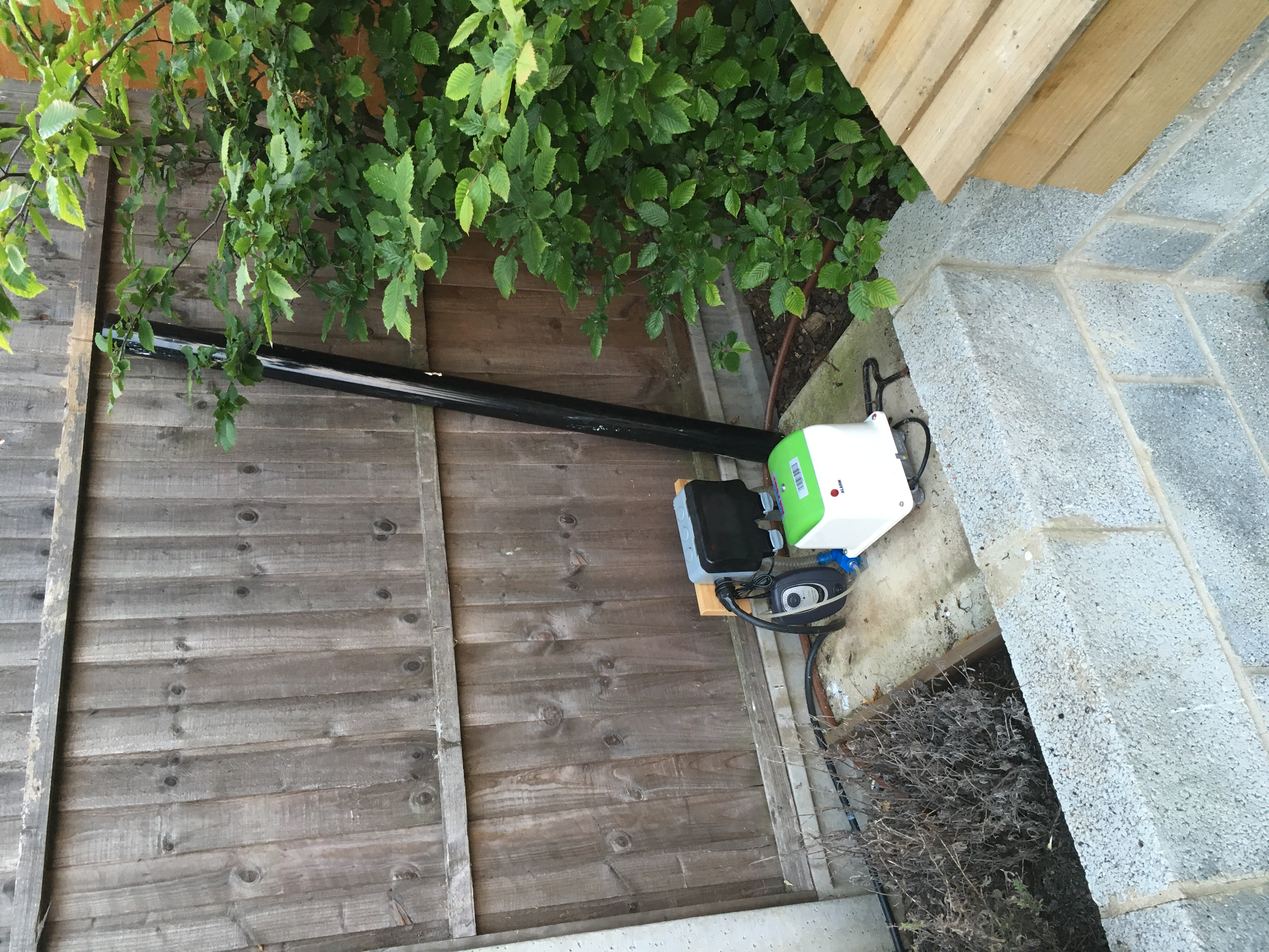

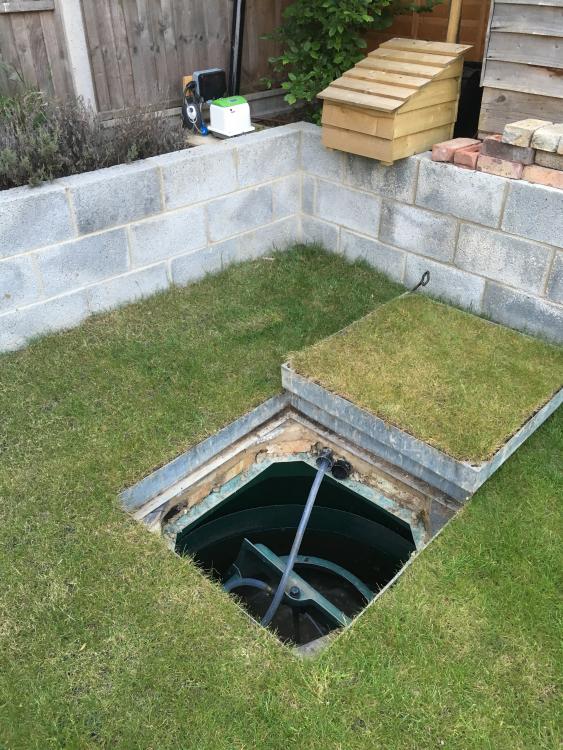

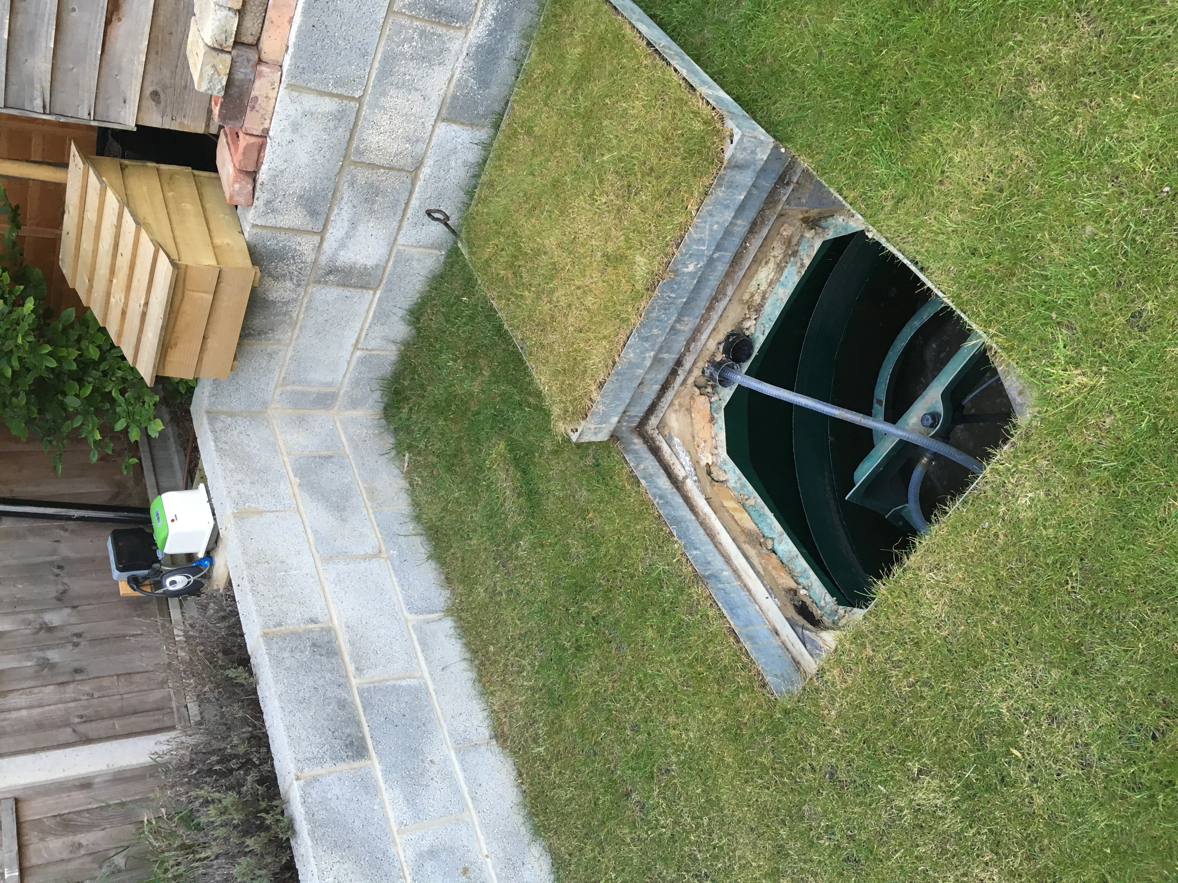

So here is the set up I have on our treatment plant.
This is the corner it's in, you can see the manhole in the grass as the soil has dried out and the metal edges are showing a bit more than normal.  The pump is under the beehive.
This is the cover off and you can see the pipe running through a drainpipe to the unit.
Finally this is the beehive removed and you can see the pump (50w), the alarm and the power sockets.image.jpeg

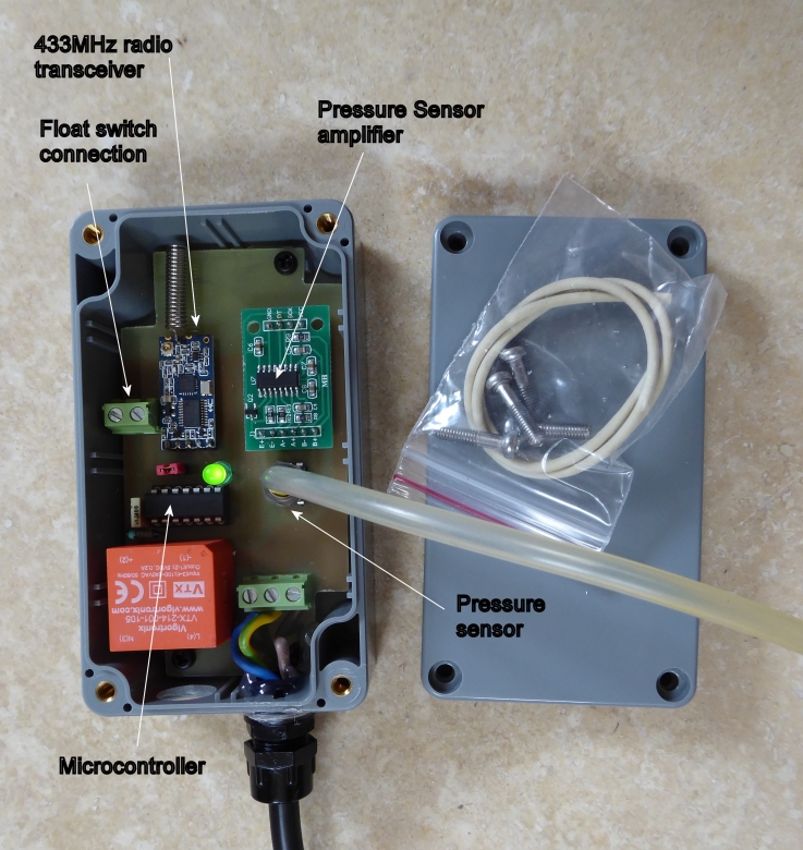

Right, I made a start at the weekend (as light relief from collating VAT receipts) and made up a prototype.  It's very much a prototype, and although I may end with it installed on our system, there are probably things I will change for "production" versions, just to make them a bit easier to make, and a bit neater.
First off, this is the small waterproof box that goes at the treatment plant end:
I should have added a scale, but the air pipe to the pressure sensor is about 5mm in diameter and the case is 65mm wide x 115mm high, so pretty small.  This needs to be mounted vertically, with the transceiver antenna at the top.  Ideally it needs a reasonably good line of sight to work, but I tested it yesterday with this unit sat inside the garage on the floor (our garage is right at the opposite end of the site to the corner of the house where the display unit will be) and it worked perfectly (that was a range of around 35m through several thick walls).

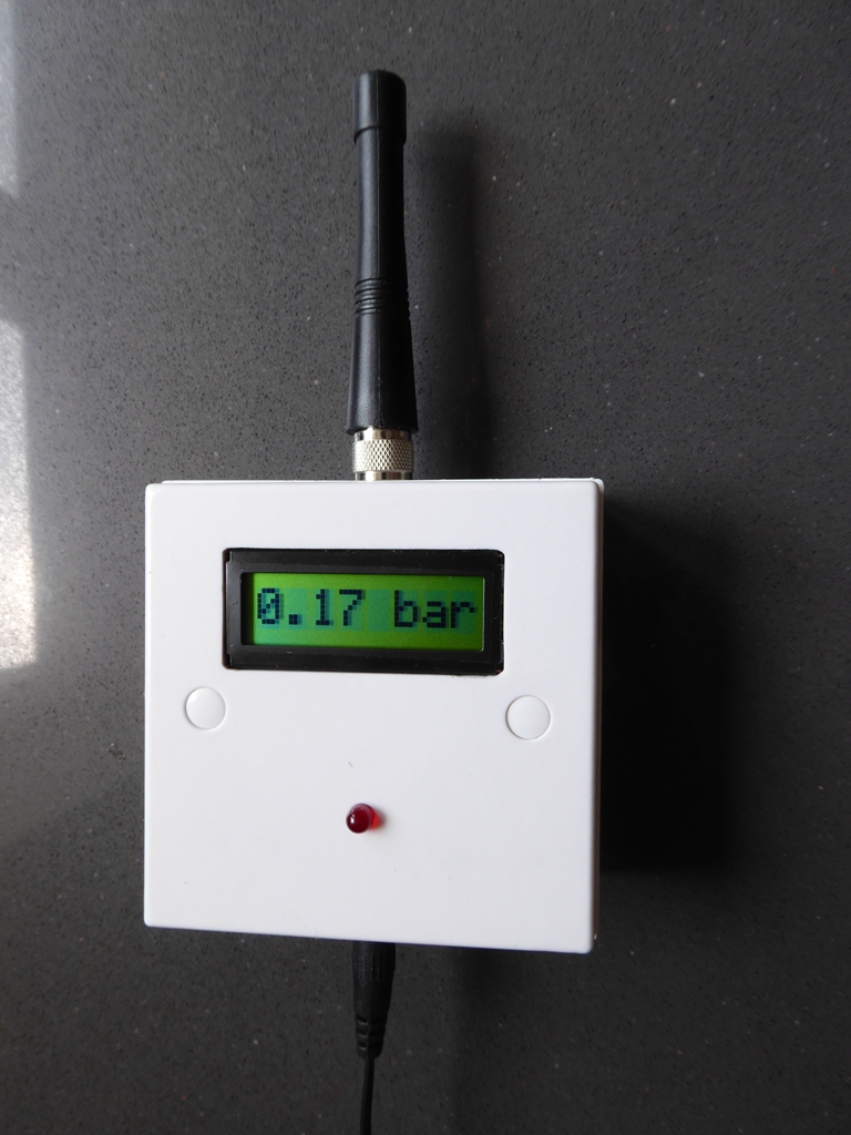

This unit has a small pressure sensor that measures the air pressure and transmits it to the indoor unit.  It also has a pair of screw terminals to allow a "normally open" float switch to be added if needed.  The unit works with or without the float switch, as it all it does is send data on request to the indoor display and alarm unit.  I'm probably only going to make some minor revisions to the design of this unit, just to make fitting the cables and pipe a bit easier.  The green LED is just for local diagnostics.  You can only see it with the cover off and it has a sequence of flashes that indicate normal operation, a fault condition and what that might be and also a confirmation of sensor zero calibration.  There should be no need for zero calibration in use, as the sensor is very stable, but there are variations from one sensor to another in the zero offset, so I had to build in a way to calibrate this out.  The red link to the left of the LED is the calibration link.  If this is removed (with the unit powered off and the air pipe disconnected) and then the unit is powered on, it will measure the zero offset of the sensor, store it in non-volatile memory (should last decades) and then give three quick flashes of the LED to show that calibration is complete.  The power can be turned off, the red link replaced and the unit then installed and operated.  This isn't something I envisage anyone needing to do, though, as I'll do the zero calibration as a part of testing the functionality.

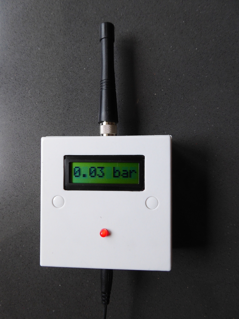

The indoor unit has a small display to show either the air pressure, or to indicate "HI LEVEL" if a float switch is fitted to the treatment plant.  In normal use the unit just checks and displays the pump pressure about every 5 seconds, and looks like this (I may change the case, as I'm not 100% happy with this fitted in a patress box and working from a plug-in wall supply):
The red LED on the front comes on continuously when there is an alarm condition and an internal beeper sounds a short beep every 5 seconds to alert you to the alarm.  If the alarm was triggered by the float switch operating, then the display will show "HI LEVEL" instead of the pressure, the LED will be on and the beeper will beep.  If the alarm was triggered by the pressure dropping from the pump, then this will show as a low reading on the display.  I currently have the pressure alarm threshold set to 0.03bar. so the alarm operates at or below this pressure and the unit looks like this when the pressure reaches the low pressure alarm threshold:
One advantage of being able to see the pressure all the time is that you should be able to get a feel for the normal operating pressure for your unit (the pressure above was not from our unit, I simulated it with a bit of silicone pipe and a syringe).  If the pressure rises, then based on Peter's experience of this being an indication of sludge build up, that can damage the pump diaphragm(s), then it may well be a good indicator that the unit needs emptying.  If the level in the tank stays pretty constant, then the pressure will, too, as the air pressure depends very much on the head in the tank.  This means that for some systems there may be a slight pressure variation as the tank fills to a slightly higher level before draining to the normal operating level.
The good news is that everything works as I'd hoped and that the radio link is very robust.  It's a two way link, where the outdoor unit sends a very short "wake up" data burst saying that it's ready to transmit data, the indoor unit responds by transmitting a "ready to receive data" message, the outdoor unit sends the data and the indoor unit transmits back confirmation that the data has been received.  This makes the data link pretty robust, and combined with the low data rate used and the high receiver sensitivity means that the range is likely to be well over 50m in practice, and it will easily cope with being obstructed by walls.  It's helped by having a decent antenna on the indoor unit, and for a difficult location it would be easy to add a similar antenna to the outdoor unit, rather than rely on the small helical one inside the box you can see in the photo.  The downsides of fitting an external antenna to the outdoor unit is that it would need some additional sealing around the antenna connection and it would almost double the vertical size of the unit.  The outdoor unit is in an IP65 rated box, so could be fitted to a small post next to the treatment plant to get it above ground level, if that was found to be needed.  My view, based on the tests I did yesterday) is that it would probably work OK, with a range reduced to maybe 25m or so, even if it was fitted in the pump compartment of a typical treatment plant.
