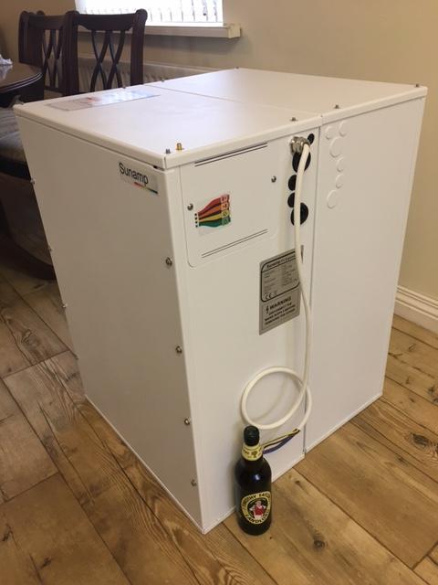

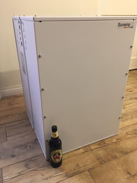

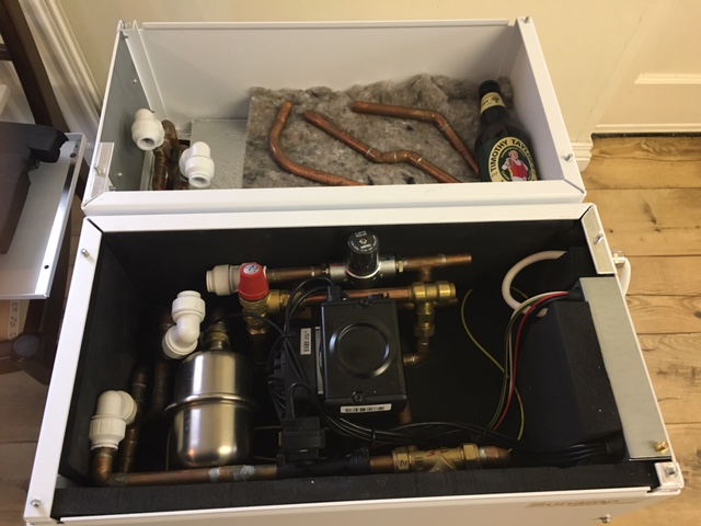

Guest Alphonsox Posted January 10, 2017 Posted January 10, 2017 Worth giving them a call, I seem to remember ours taking around 10 days from order to delivery to Ireland.
