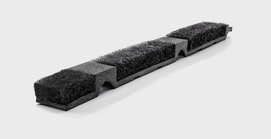

Tom's Barn Posted January 24, 2020 Author Posted January 24, 2020 On 21/01/2020 at 19:22, Patrick said: I can't comment on the quality of this one as I on purpose put a link from random ebay seller to not create a conflict of interest, but generally we use this kind of thing all the time on our roofs, corrugated and box profile, and it works perfect. thanks Patrick. It has arrived and looks good. I will use that on the first and last row of purlins.

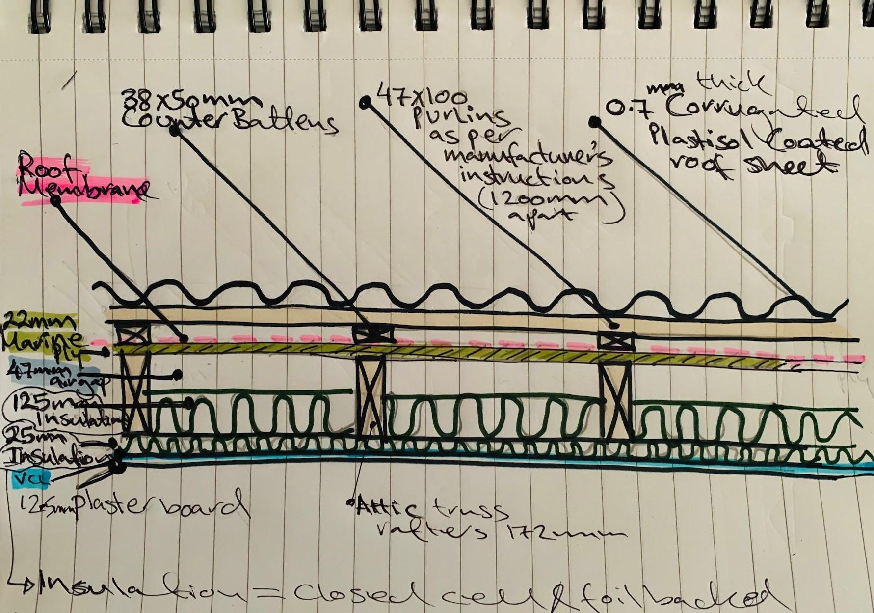

Tom's Barn Posted January 24, 2020 Author Posted January 24, 2020 On 21/01/2020 at 18:17, Cpd said: No I have a vented area of 50mm above the insulation and below the sarking running up between each joist. my vcl is behind the plasterboard but all the insulation is fully fitted and foamed / taped at each layer. there is No where for air to move between the layers of insulation as there are no gaps. the vented area is open at the bottom of the roof with soffit vents and open at the top with roof vents as well as a 200mm open vented triangle just below the ridge. air freely moves in this area, you will of course get air flowing up beneath the tin in each of the curves / profiles as they are open at the bottom and open at the top as I said probably not the text book roof but it seems to be working well, I expect if you did a condensation risk analysis then it would show potential problems with the joists but due to my windy location I am happy with how it works. I have also read that you can fully fill with the correct build up but I have always felt that should there be any issues with damp then I want it capable of drying out ASAP. My shed roof is far more basic and until I decide on whats going on in there I will keep my options open. Hi Col An interesting approach, thank you for sharing and providing a graphic, it is very clear now. I don't think your tin is coming off any time soon. Question....what screws did you use through your tin? I have been recommended to use timberlok screws but with 50x25mm counter battens they seem a little chunky. Tom

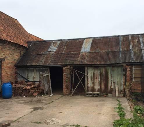

Tom's Barn Posted January 24, 2020 Author Posted January 24, 2020 On 22/01/2020 at 07:40, Russell griffiths said: Is this any help. Stainless mesh over counter batten gap. then 100x25treated batten to take the sheets. Not corregated but it is metal. Hi Russ, what metal are you going with? I assume based on the support structure you are creating it is standing seam? Nice edge detail... I have looked online for 25x100 and the sites say 22 x100. Is that what you have? Tom

Russell griffiths Posted January 25, 2020 Posted January 25, 2020 @Tom's Barn treated sawn 25x100 got it in BPS IN CIRENCESTER, really nice lads, the branch manager Wayne has been to site a couple of times, he’s keen on new business. Raised seam roof. In the pic of the stainless mesh I also covered the edges with sikaflex to stick it down because of the gaps created by staples. You could have come and had a look a week ago, but it’s all covered now.

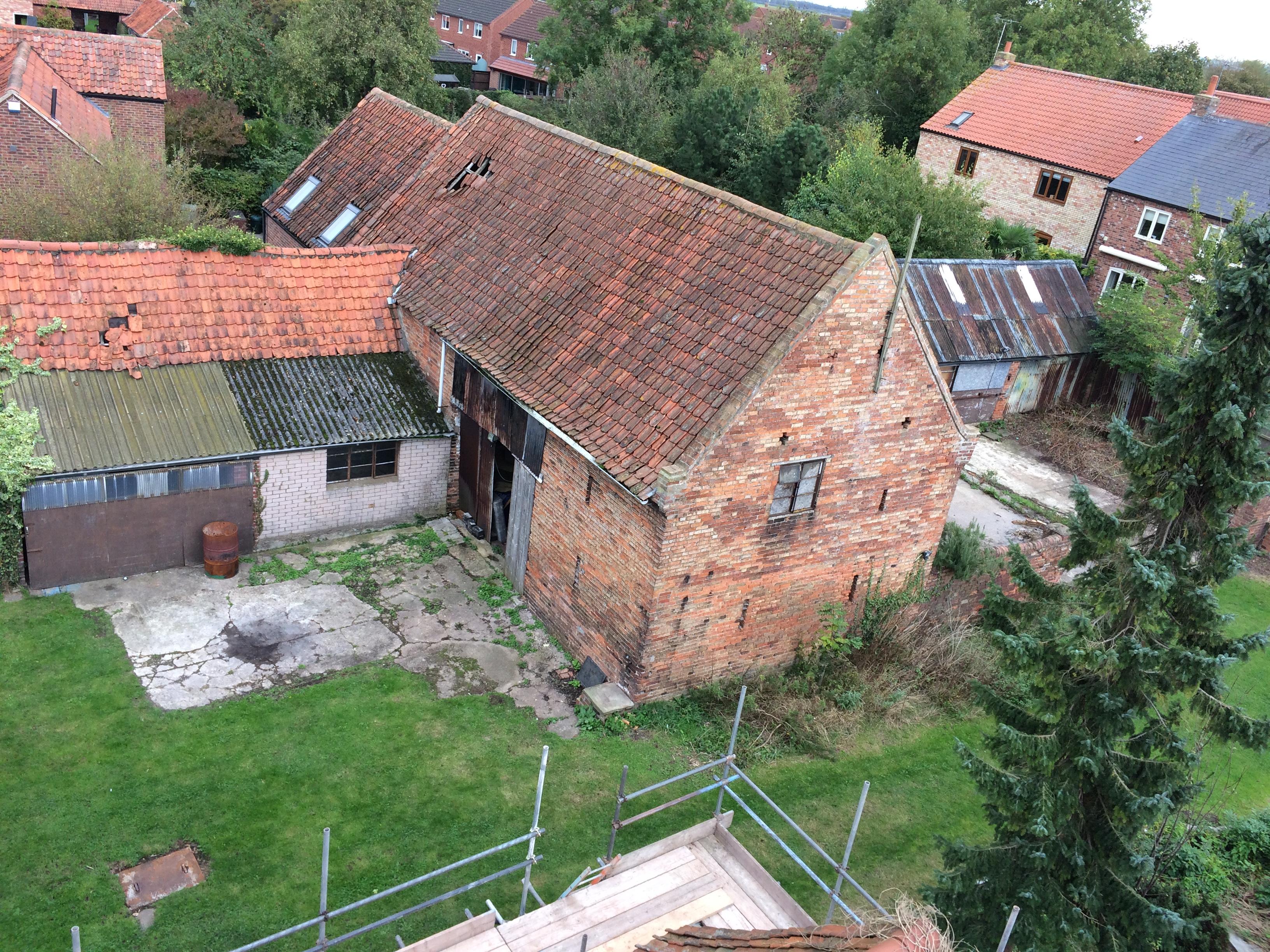

Richflew Posted January 29, 2021 Posted January 29, 2021 Hi, I have read this thread with interest and joined the forum to participate (looking forward to seeing what else is on here ?) We are in the initial stages of a barn conversion as in photo. One single storey wing has corrugated roof at present. The whole structure needs replacing but, as it is Grade II listed we would like to use black plastisol coated corrugated sheets to keep the feel as it is now (it's also considerably cheaper than other metal roofing). We have to keep to the same height so insulation will go between rafters then over-boarded with insulated board to get to building regs. Although common in other parts of the world it is uncommon to use corrugated sheets in the UK for domestic roofing. I have 2 questions... particularly for @Cpd @Russell griffiths as it looks like you have done similar projects. 1) With the insulation as suggested is sound likely to be a problem when it rains? 2) Do you know if insurers and mortgage providers will have a problem with this type of roofing? thanks
Cpd Posted January 29, 2021 Posted January 29, 2021 3 hours ago, Richflew said: 1) With the insulation as suggested is sound likely to be a problem when it rains? Despite rigid insulation’s poor acoustics properties it’s not as bad as I thought, I went to great lengths to make sure my insulation was all foamed and taped at multiple levels and I think this probably helps. I have then got osb on the inside and am still not at the point of plasterboard but when I do I will use an acoustic one, see what it’s like with one layer and double up if required... but having spent time in the building without I am thinking one layer will be fine. When it rains your aware of the noice but it’s more a nice comforting sound as your happily inside ! Others with finished houses may have more info but for me I am happy. 1

Richflew Posted October 7, 2021 Posted October 7, 2021 @Cpd after months of delays for various reasons we are now getting round to doing this. Looking at your drawing, can you explain to me why the sauring board is necessary rather than just using horizontal timber 3x2 lats to support the corrugated sheets. Also, we have to build the timber truss structure. My joiner says it's a waste of time having rafters every 400mm - do you have an opinion on this? thanks Richard
Cpd Posted October 7, 2021 Posted October 7, 2021 Have sent you a pm. is your roof open / vaulted in the inside or is it a cold roof with insulation on the flat ceilings ? If it’s a cold roof then you can probably get away with a lot less timber but if it’s a vaulted ceiling then you need to think about all the additional weight such as insulation and plasterboard as well as the extra work / wood around the windows. I needed sarking as my location is very exposed and it was part of what made the whole roof more rigid, also due to the serious exposure I wanted the roof membrane to be sitting on a solid deck rather than draped between rafters.
