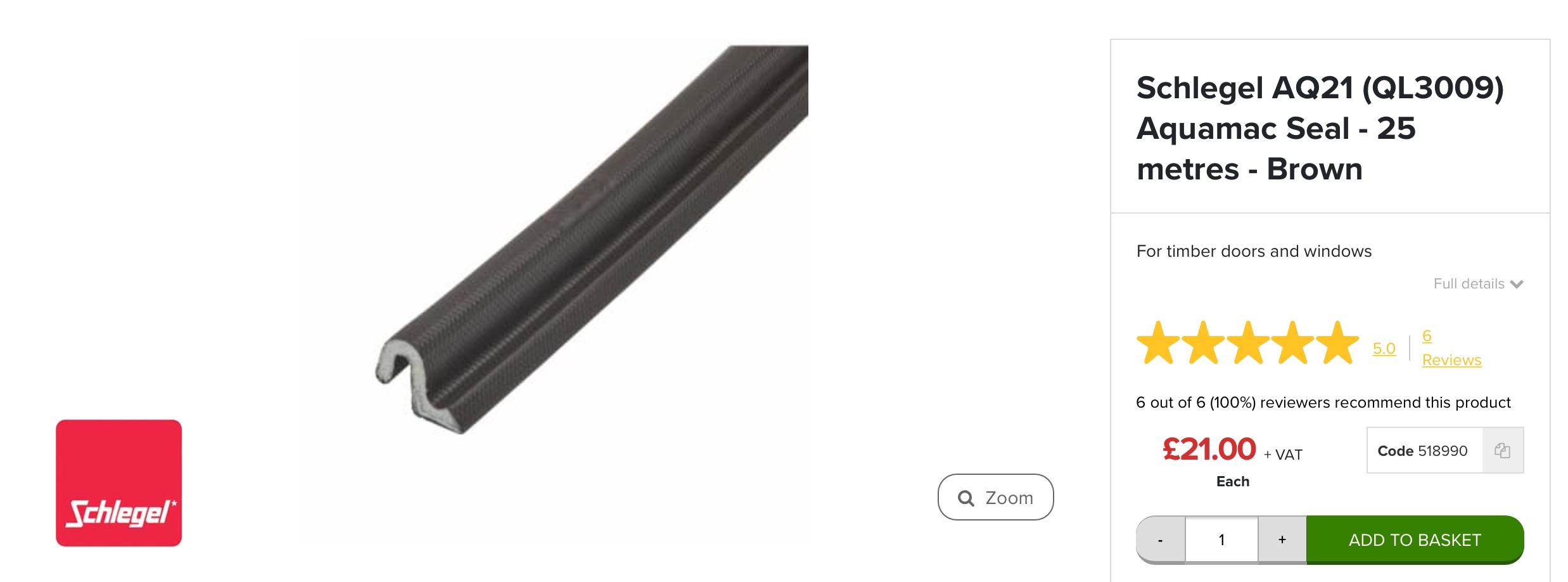

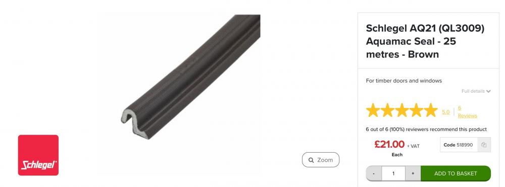

Cpd Posted October 11, 2019 Posted October 11, 2019 On 04/10/2019 at 10:53, JulianB said: Improve front door performance (all timber) – currently very drafty! Thinking the frame might need to be replaced to provide an adequate sealing area – wondering if any modifications can be made to the door itself to help matters (granted that we have no chance of replacing it…) The door is an easy fix in my opinion (if it opens internally) as I have done a number of my own doors. The quickest way is to attach an external lining round the door reveal. This is what I do. Get some 20-22mm thick timber, treated if possible or treat it yourself. It can be as wide as you like depending on how it looks in the frame. You can router a nice curved edge or cut a 30-40 degree angle on it to make it look better. Assuming that the door is relatively flat.... (check by putting a full length of flat timber up against it) you can then router the slot for the weather seal, remember to re treat the slot with wood preservative before putting the seal in. Once you have assembled / put the weather strip in your two sides and top you can do a dry run and place them in the frame to make sure they are all going to fit snugly. Pre drill holes for your ss screws and them put up your top piece first with the door shut. You need to apply a a bit of pressure to get the weather strip to compress and make sure there is an even gap between the door face and your timber insert. Screw it into place. Repeat this process for both sides. The bottom of the door is more tricky but a quick way to make at least some improvement is to fit a brush seal on the bottom of the door on the inside. A quick way to improve the thermal efficiency is to stick 25mm of rigid insulation to the inside face of the door and then stick some thin ply over this to protect it. You can faff around and make it as nice as you like but again if your looking to get a quick fix until a new door / frame can be fitted then this will make a huge difference.... I know as I have done this to a few doors and then checked with an Infer red temperature device to see the results. I have done these improvements and they are great if your starting from a totally crap draughty door...... This is the cheep and quick way of sealing the external doors with a minimum of one seal. I have just build 3 doors and frames from scratch and made sure that my design incorporated 2 seals all the way round. If you have the money then obviously ripping the whole lot out and replacing with of the shelf quality external doors and frames would be the way to go.... just not an option for me. I can provide more information on seals, equipment and some photos if you decide to go down this road, but I’m flat out doing my accounting at the moment so this is just a quick overview of one option to get you through the winter!
JulianB Posted October 11, 2019 Author Posted October 11, 2019 Thanks for the info; all makes perfect sense. I don't suppose you've got some photos of the seal profiles etc (no rush!) Thanks Julian
Cpd Posted October 11, 2019 Posted October 11, 2019 (edited) https://www.ironmongerydirect.co.uk/product/schlegel-aq21-(ql3009)-aquamac-seal-25-metres-brown-518990# will post some photos later Edited October 11, 2019 by Cpd
