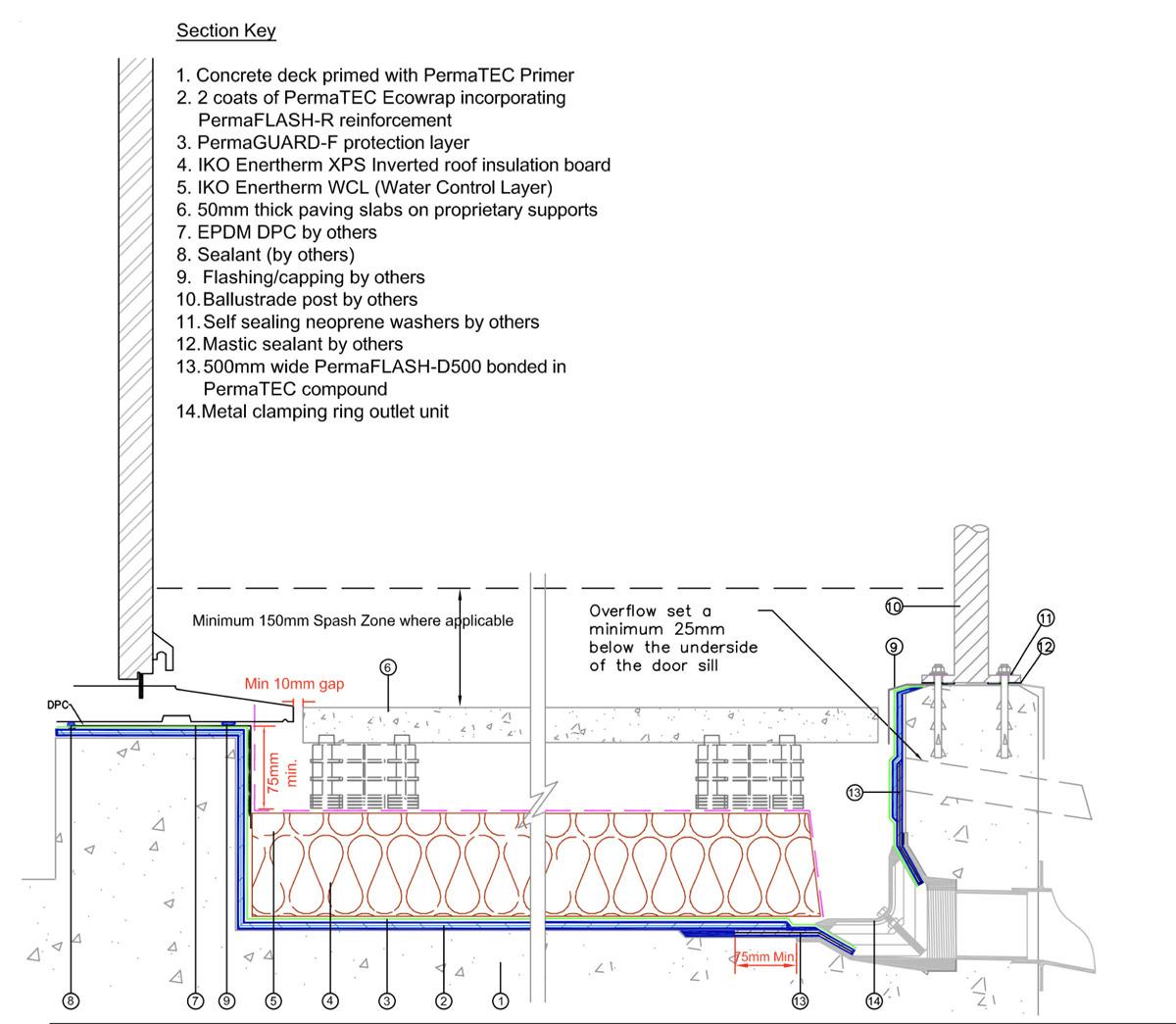

Adam2 Posted September 30, 2019 Share Posted September 30, 2019 I'm going to have a couple of roof terraces that are over habitable rooms and currently expecting to use EDPM with the structure beneath being waterproof concrete. The finished surface will be tiles on adjustable pedestals. So am thinking the make up will be: concrete -> VCL -> PIR -> EDPM -> Pedestals -> tiles Should the VCL be beneath the concrete instead? I'm guessing I should probably have OSB or similar attached through the PIR (below EDPM) into the concrete to ensure rigidity? Should I expect wide based pedestals to spread load sufficiently such that they would not damage the EDPM or PIR? Link to comment Share on other sites More sharing options...

Adam2 Posted September 30, 2019 Author Share Posted September 30, 2019 Hi - well, we'll be needing the insulation over the concrete (AFAIK) and will be laid to a 1:40 fall so will be using the pedestals to level out the tiles (free-draining where the grout would usually be). BUT - please, if there are other ways to achieve this then totally open to hearing about them. I don't really want the insulation inside as that will impact the ceiling heights/cause various dramas with levels etc. Link to comment Share on other sites More sharing options...

Adam2 Posted October 1, 2019 Author Share Posted October 1, 2019 Thanks. Will look at those pedestals also. Agree re VCL over concrete all good there. My questions in initial post were in relation to whether I need OSB over the PIR and beneath the single ply and if I also may need something over the single-ply as this will have pedestals and tiles on top of it? Would be good to know what others have done and how it has worked out. Link to comment Share on other sites More sharing options...

willbish Posted October 3, 2019 Share Posted October 3, 2019 I'm not familiar with the compressive limits of PIR but here is XPS with pedestals on top without a plywood layer. This detail may also be of use, which I am broadly following. 1 Link to comment Share on other sites More sharing options...

Adam2 Posted October 3, 2019 Author Share Posted October 3, 2019 Cheers @willbish that detail is really helpful - plenty of interesting products from IKO! Link to comment Share on other sites More sharing options...
Mr Punter Posted October 3, 2019 Share Posted October 3, 2019 I am not keen on the inverted roof with the waterproofing under the insulation as the insulation can be compromised by water under it. I prefer a layer of OSB or cement board over the insulation to carry the EPDM. 1 Link to comment Share on other sites More sharing options...
mvincentd Posted October 3, 2019 Share Posted October 3, 2019 2 hours ago, Mr Punter said: I am not keen on the inverted roof with the waterproofing under the insulation as the insulation can be compromised by water under it. And I believe you have to go from pir to xps in order to use this method due to being 'in water'....so thickness for equivalent u-value increases significantly. Link to comment Share on other sites More sharing options...

Adam2 Posted October 4, 2019 Author Share Posted October 4, 2019 22 hours ago, scottishjohn said: too late now Ahh - nothing is too late - this is still at design stage - my concern re changing construction method significantly and impacting levels etc was going back to architect & SE, which I can do of course if that is the right thing. Not sure of the booby trap/rotting? I though the make up was a pretty standard approach and similar things must have been done recently many many times for roof terraces etc. The questions really were just around the pedestals on the EDPM on the Insulation and whether this may pose a problem with durability of the EDPM - have since seen the pedestal makers state they are for installing direct on the EDPM so this should be OK : https://www.rubber4roofs.co.uk/shop/paving-slab-support Link to comment Share on other sites More sharing options...
