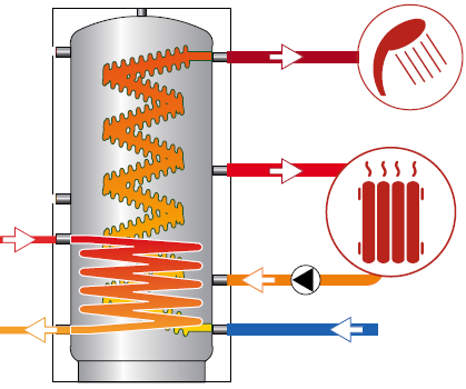

le-cerveau Posted March 24, 2017 Share Posted March 24, 2017 Surely what you need is a dual coil tank, something like this (example picture): Plumb the ASHP into the coil (shown on the left). DHW pre heat on the DHW coil (for the shower head read feed into UVC). UFH off the tank taps (radiators on the picture) limits the anti freeze in the UFH system. Reduces the DHW legionella issue as it is only the coil and separates it from the UFH so you can have inhibitor in the UFH circuit. Link to comment Share on other sites More sharing options...
Declan52 Posted March 24, 2017 Share Posted March 24, 2017 Aren't most TS multi coiled. Mine has 1 for dhw, 1 for ufh, 1 for rads upstairs, 1 unused as i was originally going down solar thermal but gladly went pv. Link to comment Share on other sites More sharing options...
Nickfromwales Posted March 24, 2017 Share Posted March 24, 2017 9 minutes ago, DeeJunFan said: I didn't know you were a martini man! all that talk of fire, meat and beer! Nah, just what I say when I start the day in 'clean' clothes, and then have to go back home to chuck the boots and combats back on 11 minutes ago, DeeJunFan said: So even though we are going with W plan you are still suggesting to max out the potential of the low temp tank and use it for cold water up-lift. I was thinking that approach was to be abandoned. Well, before this got to a point where we assumed anything, and then you acted upon it, I thought it best to chat briefly with the tech guys at Telford to see what can actually be extracted from a X sized buffer tank with regards to DHW uplift via an instantaneous coil of X size. Bigger of both = more and vice versa. So....after a chat and a brew....deep breath...."options" :- On the assumption that, You already will have an ashp installed and working. You already will have a buffer of whatever size installed, according to majority advice and positive feedback here ( against running a HP to Ufh directly in a 'low' energy home ). You will have a reasonably sized Pv array. I have arrived at the following :- The costs of the larger buffer tank, having it fitted with a 4.5m2 DHW uplift coil ( the minimum size that would offer any meaningful yield at low temp but also physically too big to go into any less than a 300L cylinder ), accepting a reduced max flow rate of 18litres per min, ( you may well only have 18litres per min coming in so case specific for that point ), and the additional volume of antifreeze ( plus replacment of the antifreeze every 5 years as it has a limited working life ), make the TS and coil option for DHW uplift very tight, if not plain uneconomical for your expected DHW needs. So, after more head scratching, further tea drinking and procrastinating..... The figures do stack up quite well in favour of going for a small buffer and copying @JSHarris with a plate heat exchanger, but as your expected DHW consumption and flow rates may well be double his, I'd suggest going for a pair of 30kw versions running in parallel to get a combined pipe size input & output of 22mm ( to match the UVC accordingly ). PHE example only PHE's are far better at transferring heat from a wet source than coils, especially when being used at lower temps. I've had to adjust my thinking accordingly for this case, and even so, I still think it's a worthwhile endeavour. Less long term labour of the ASHP = longer life expectancy. Far fewer defrost cycles compared to driving DHW directly from the ASHP at high temp range. Majority of the DHW getting produced at the better CoP rate, ( DHW will be your biggest energy requirement as its needed year round eg also when you have little or no Pv gain ). Smaller buffer tank ( circa 100 litres ) with less loss, size, and reduced antifreeze required. ( thanks @Alphonsox for the example costs, makes it a game changer tbh ). So, to summarise, I'm still thinking of DHW uplift from the ASHP via a buffer, but a smaller buffer and PHE's instead of the coil. That will require a pump and flow switch, ( any PHE will need one ). Still relatively straightforward tbh, and may just provoke me into getting off my arse and looking for a decent plumbing schematic software so I can translate this babble into a working drawing for a / your plumber to follow. 12 minutes ago, le-cerveau said: Surely what you need is a dual coil tank, something like this (example picture): Plumb the ASHP into the coil (shown on the left). DHW pre heat on the DHW coil (for the shower head read feed into UVC). UFH off the tank taps (radiators on the picture) limits the anti freeze in the UFH system. Reduces the DHW legionella issue as it is only the coil and separates it from the UFH so you can have inhibitor in the UFH circuit. Thats the chat I've just had. These cylinders have very low heat transfer rates at low temp, so that type of cylinder would need to be VERY hot in order to do what is suggested in that image . It would also need to be KEPT very hot to do it too . 3 Link to comment Share on other sites More sharing options...
Nickfromwales Posted March 24, 2017 Share Posted March 24, 2017 2 minutes ago, Declan52 said: Aren't most TS multi coiled. Mine has 1 for dhw, 1 for ufh, 1 for rads upstairs, 1 unused as i was originally going down solar thermal but gladly went pv. You get them specific to your remit . No such thing as a "standard" TS afaik. Link to comment Share on other sites More sharing options...
Nickfromwales Posted March 24, 2017 Share Posted March 24, 2017 3 hours ago, Declan52 said: Aren't most TS multi coiled. Mine has 1 for dhw, 1 for ufh, 1 for rads upstairs, 1 unused as i was originally going down solar thermal but gladly went pv. What did your plumber do with the unused coil tappings? If they're left open you can get condensation forming inside and that causes corrosion. Not a prob if they're stainless, but if they're copper then they need sealing with a bit of foam / mastic. Don't cap them as there could be expansion issues with the coil heating and cooling the air inside. Link to comment Share on other sites More sharing options...
