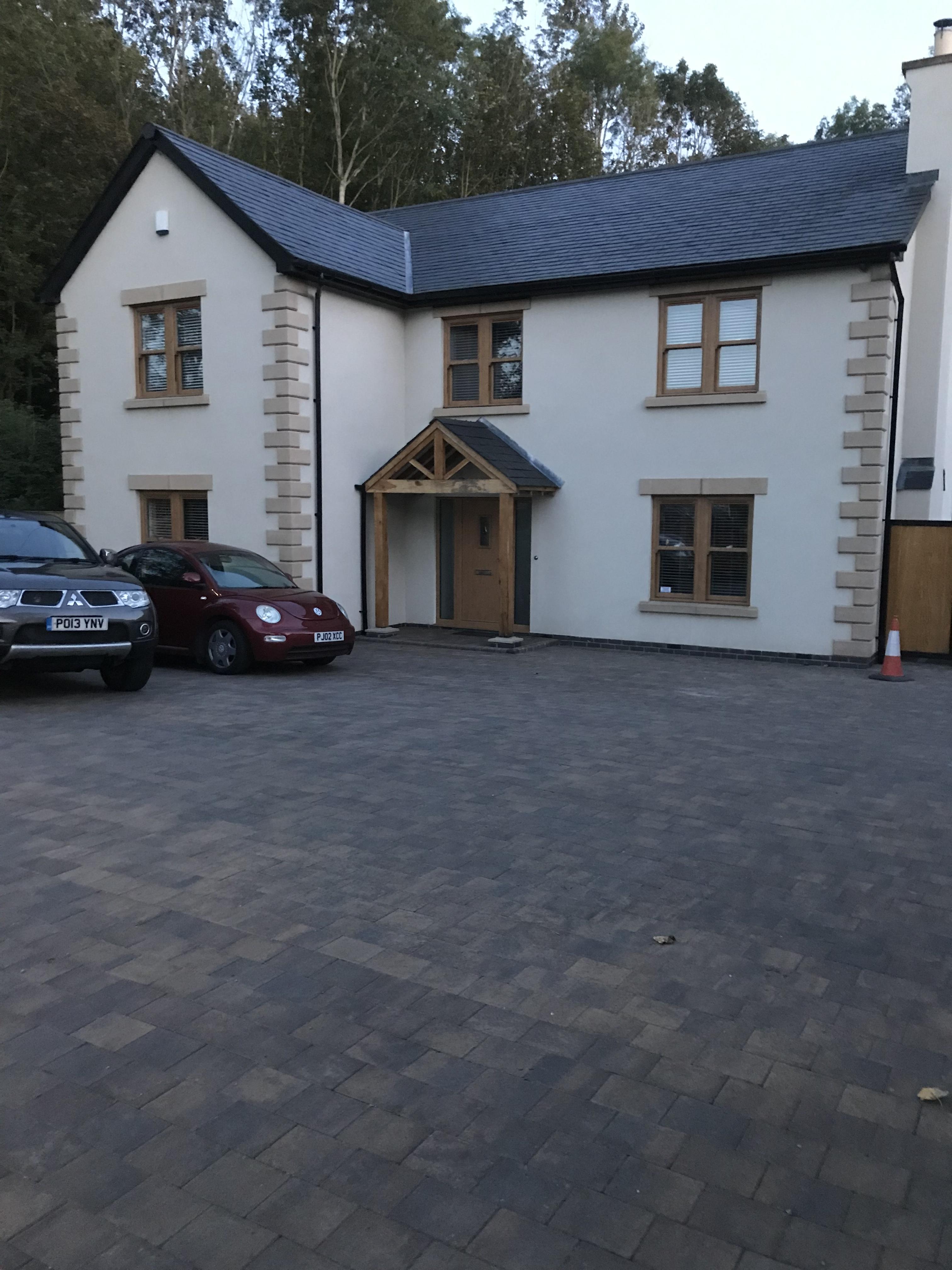

nod Posted September 30, 2019 Share Posted September 30, 2019 14 minutes ago, Jenni said: My builder has said he won't be using that joiner again, he's apparently lost a lot of money trying to rectify issues in other builds as well. Our 'permission' was via permitted development, our architect specified wooden windows, we were under the impression that's just what we had to have. TBH we probably wouldnt have gone with uPVC anyway, personal thing. But I would have investigated Ali' / Aluclad if I thought it was allowed. Live and learn / next time. I'm told the doors/glazing was fitted with 'toeing and heeling' method. The metal straps are slide bolts, I was advised to have them to stop twisting, I specified those flush ones but wasnt advised they'd cause any issues. Hmm, I don't know for sure, but I think after installation. The video is of a window (sorry I should have been clearer) I think the water is coming in here - Ok, now I know more, thank you. Yes, will be saving up for aluminium replacements, one day it will get better, until then these will have to be good enough. The 2 outward opening doors were painted on top/bottom/sides (just not the inside face). of those 2, 1 has dropped/jams, the other is ok. Our permission stated timber painted sash windows As we are next to a former farmhouse that is listed The voyage that is joined to the farmhouse was extend 8 years ago and had hardwood sash throughout Most now leak or stick I spent six months arguing with planners While I accepted that I must have sash (There goes my air tightness ) I new That with more than thirty timber sash there would be some issues and annual maintenance We found a company that had won Heritage sash window award (UPVC wood grain ) and planners agreed to allow these Had we not been next to a listed building I don’t think there would have been any issue with planners Link to comment Share on other sites More sharing options...

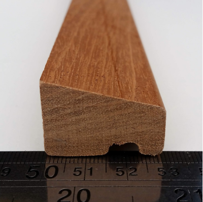

Onoff Posted September 30, 2019 Share Posted September 30, 2019 (edited) I think you will want a weather bar here as well i.e between the two windows: This just as an example, timber, aluminium, plastic all available. Will need to be siliconed on and pinned / screwed with stainless fixings ideally. Edited September 30, 2019 by Onoff 2 Link to comment Share on other sites More sharing options...
