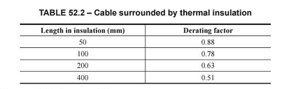

Jeremy Harris Posted September 25, 2019 Posted September 25, 2019 On 25/09/2019 at 10:11, AnonymousBosch said: Why , why, why do companies even attempt to trade without even a cursory look at relevant guidelines? Why? Expand May be that some companies are just importing products from countries with different regulations? The regs here haven't changed significantly for years with respect to cables in insulation. This is from the current regs (BS7671:2018): Quote 523.9 Cables In thermal Insulation A cable should preferably not be installed in a location where it is liable to be covered by thermal insulation. Where a cable is to be run in a space to which thermal insulation is likely to be applied it shall, wherever practicable, be fixed in a position such that it will not be covered by the thermal insulation. Where fixing in such a position is impracticable the cross-sectional area of the cable shall be selected to meet the requirements of Chapter 43. Where necessary, the nature of the load (e.g. cyclic) and diversity may be taken into account. For a cable installed in a thermally insulated wall or above a thermally insulated ceiling, the cable being in contact with a thermally conductive surface on one side, current-carrying capacities are tabulated in Appendix 4. For a single cable likely to be totally surrounded by thermally insulating material over a length of 0.5m or more, the current-carrying capacity shall be taken, in the absence of more precise information, as 0.5 times the current-carrying capacity for that cable clipped direct to a surface and open (Reference Method C). Where a cable is to be totally surrounded by thermal insulation for less than 0.5m the current-carrying capacity of the cable shall be reduced appropriately depending on the size of cable, length in insulation and thermal properties of the insulation. The derating factors in Table 52.2 are appropriate to conductor sizes up to 10mm² in thermal insulation having a thermal conductivity (λ) greater than 0.04 W-1m·•K-1 Expand
A_L Posted September 25, 2019 Posted September 25, 2019 On 25/09/2019 at 10:27, JSHarris said: The derating factors in Table 52.2 are appropriate to conductor sizes up to 10mm² in thermal insulation having a thermal conductivity (λ) greater than 0.04 W-1m·•K-1 Expand Do they actually mean 'less than' or are their other values for more insulating insulation?
Jeremy Harris Posted September 25, 2019 Posted September 25, 2019 On 25/09/2019 at 10:35, A_L said: Do they actually mean 'less than' or are their other values for more insulating insulation? Expand I think they mean "greater than", with less thermally conductive insulation needing specific calculation of the derating factor based on cable temperature and cable insulation material. I've always tried to avoid putting cables in insulation if at all possible, not just for derating reasons but also because it's a PITA to work on later if cables are embedded in the stuff.
A_L Posted September 25, 2019 Posted September 25, 2019 On 25/09/2019 at 10:47, JSHarris said: I think they mean "greater than", with less thermally conductive insulation needing specific calculation of the derating factor based on cable temperature and cable insulation material Expand So at what thermal conductance ( or other definition) does a material become an insulation requiring use of Table 52.2?
Jeremy Harris Posted September 25, 2019 Posted September 25, 2019 On 25/09/2019 at 10:59, A_L said: So at what thermal conductance ( or other definition) does a material become an insulation requiring use of Table 52.2? Expand I'm not privy to the machinations within the IET that came up with these figures, I'm afraid! If the conditions in Table 52.2 aren't met then the earlier paragraphs apply, so the derating factor is 0.5, or the factors in Appendix 4 apply. Appendix 4 is several pages long, and includes calculations that should be used for different circumstances. It's a bit too long for me to copy and paste to a post here, I'm afraid. The general way the regs work is that they give a "quick and dirty" tabulated option that doesn't need calculations, plus a detailed option that requires a few sums in order to derive a valid answer. Most of the time electricians try and stick within the simplified tabulated guidance, as it makes life simple, but it is equally valid to calculate factors using the methods given in Appendix 4. 1
