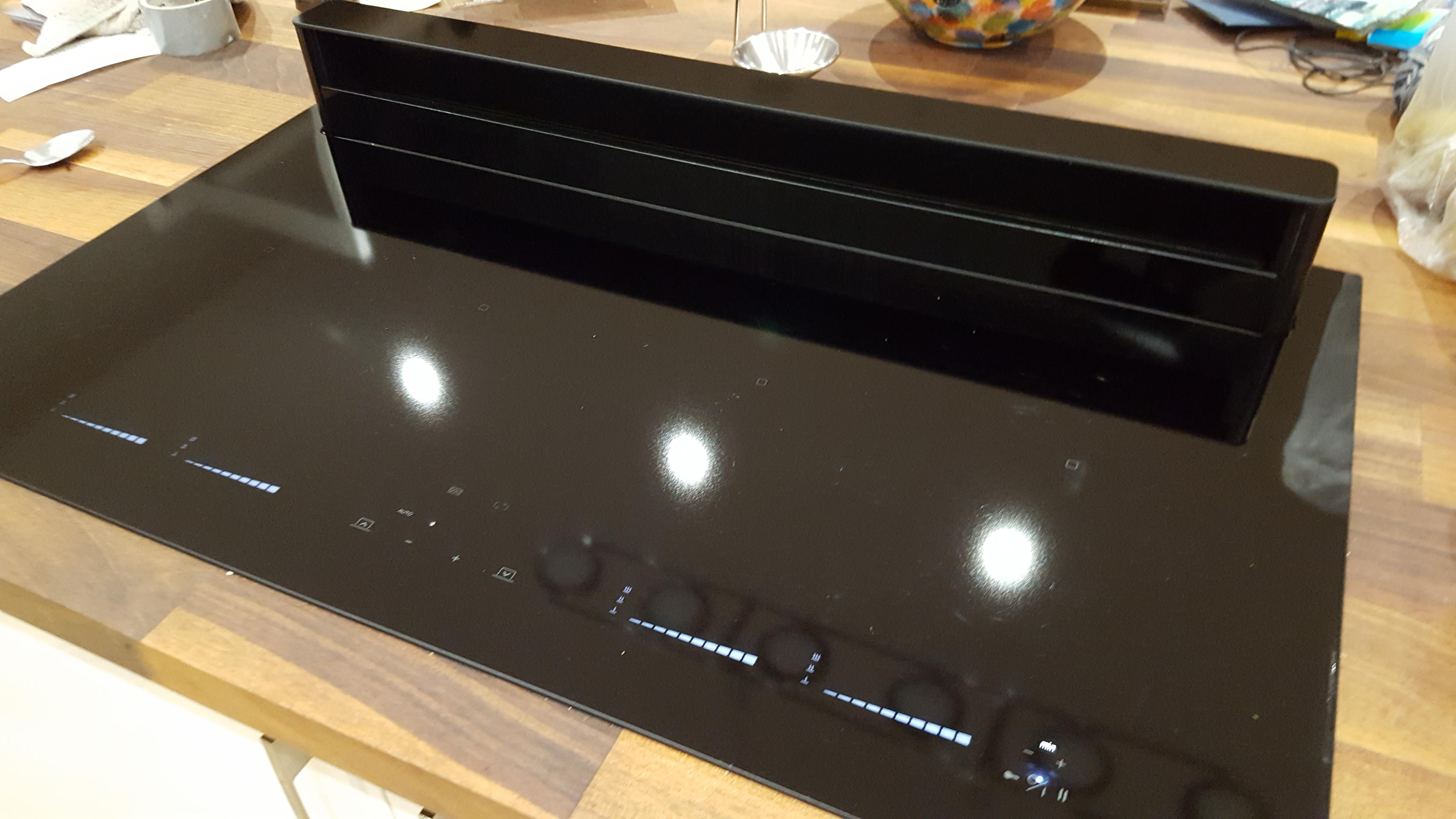

vivienz Posted September 14, 2019 Share Posted September 14, 2019 Here's a rubbish picture of the novy in situ with the extractor on the lowest height position. Each hotspot is in front of the slider control, i.e. parallel with the line of the extractor. I have found it to be very effective; my MVHR extracts for this room are also located about 1.5 metres back from the hob so rising steam isn't a problem. I'm very pleased with it. 2 Link to comment Share on other sites More sharing options...
puntloos Posted September 14, 2019 Author Share Posted September 14, 2019 4 hours ago, vivienz said: Here's a rubbish picture of the novy in situ with the extractor on the lowest height position. Each hotspot is in front of the slider control, i.e. parallel with the line of the extractor. I have found it to be very effective; my MVHR extracts for this room are also located about 1.5 metres back from the hob so rising steam isn't a problem. I'm very pleased with it. Weird, I've been looking at Novys for a little while and indeed only your picture made me realise how it actually is oriented. Okay, that looks quite sensible. That also explains the 'Panorama' name... Ha. Link to comment Share on other sites More sharing options...
