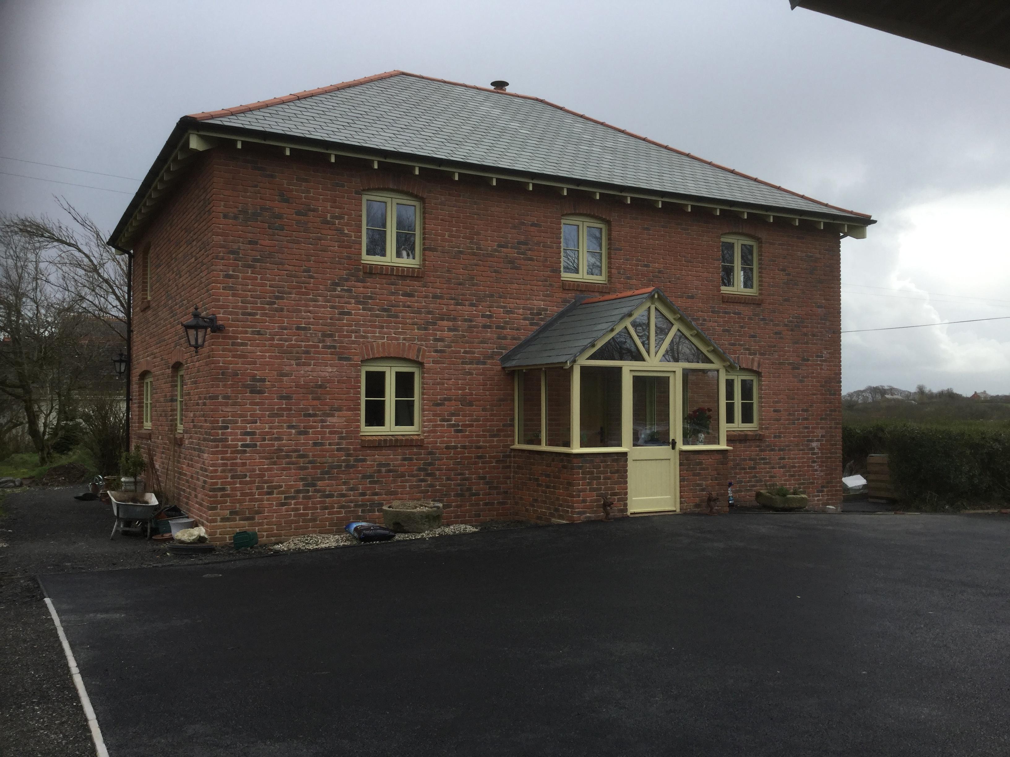

ProDave Posted September 11, 2019 Share Posted September 11, 2019 Yes very similar to our house. Rectangular house entrance in the middle forming an entrance corridor and stairwell. Rooms either side of this on both floors. Very little space wasted with corridors or circulation space. Works best on a plot that will support a house wider than it is deep. Link to comment Share on other sites More sharing options...
Jeremy Harris Posted September 11, 2019 Share Posted September 11, 2019 Just realised, @ProDave, that your house is fairly similar to ours from the front, central entrance hall and rooms off to either side: Link to comment Share on other sites More sharing options...
ProDave Posted September 11, 2019 Share Posted September 11, 2019 12 minutes ago, JSHarris said: Just realised, @ProDave, that your house is fairly similar to ours from the front, central entrance hall and rooms off to either side: Yes I have know that for a long time, and fairly similar size as well. About the only significant difference is we have the stairs at the back of the entrance hall as 2 flights, up to a half landing then turning back. That allows us to have the bathroom above the front door. Link to comment Share on other sites More sharing options...

joe90 Posted September 12, 2019 Share Posted September 12, 2019 Mine is very similar to @ProDave, mine is a rectangle with the longest elevation facing south to maximise solar gain into the brickwork. Bathrooms above kitchen/hall/cloakroom for short pipe runs. Link to comment Share on other sites More sharing options...
Amateur bob Posted September 12, 2019 Author Share Posted September 12, 2019 4 minutes ago, joe90 said: Mine is very similar to @ProDave, mine is a rectangle with the longest elevation facing south to maximise solar gain into the brickwork. Bathrooms above kitchen/hall/cloakroom for short pipe runs. nice house, how many m2 is that? Link to comment Share on other sites More sharing options...
joe90 Posted September 12, 2019 Share Posted September 12, 2019 240 sq m. Link to comment Share on other sites More sharing options...
