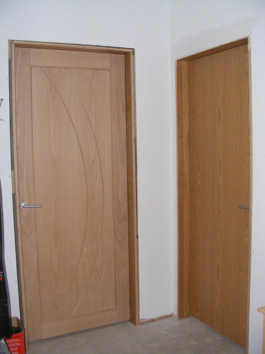

ProDave Posted September 6, 2019 Share Posted September 6, 2019 I have 5 Oak veneered internal doors to treat. The general consensus seems to be "Osmo Oil" Having found the usual suspects, Screweys, toolstation etc don't stock it, I searched on ebay. Only to find Osmo do a bewildering selection of different oils. I am guessing it is this one "door oil? https://www.ebay.co.uk/itm/Osmo-Door-Oil-3060-Clear-Satin-Tester-Single-or-Twin-Internal-Doors-Joinery/190805409273?hash=item2c6ce37df9:m:mr_MiJAZLQYsJAp1gvgca_A Is that the one, or something different? As it appears to be flipping expensive I only want to buy what I need, so how much for both sides of 5 internal doors? Link to comment Share on other sites More sharing options...
Jeremy Harris Posted September 6, 2019 Share Posted September 6, 2019 I used Osmo Door Oil and found it to be very good, but expensive. Looking at a spare tin here, it's labelled "3060 Clear Satin", so the same as the stuff in your link. I believe that our doors are very similar to yours. 1 Link to comment Share on other sites More sharing options...
Russell griffiths Posted September 6, 2019 Share Posted September 6, 2019 I went on their Facebook page and put up a pic of what I wanted to do, they replied the same day. Bloody expensive stuff. Link to comment Share on other sites More sharing options...
ProDave Posted September 6, 2019 Author Share Posted September 6, 2019 7 minutes ago, JSHarris said: I used Osmo Door Oil and found it to be very good, but expensive. Looking at a spare tin here, it's labelled "3060 Clear Satin", so the same as the stuff in your link. I believe that our doors are very similar to yours. XL Joinery Oak veneered doors, expensive ones. Link to comment Share on other sites More sharing options...
Jeremy Harris Posted September 6, 2019 Share Posted September 6, 2019 Probably similar in construction to ours: https://www.doordeals.co.uk/products/internal-doors/solid-internal-doors/oak-hagan.aspx Link to comment Share on other sites More sharing options...
PeterW Posted September 6, 2019 Share Posted September 6, 2019 @ProDave 5 doors is 33sqm with two coats. That is only 1.5 litres with some to spare. This would do, as would Fiddes Door Oil Link to comment Share on other sites More sharing options...
ProDave Posted September 6, 2019 Author Share Posted September 6, 2019 Thanks. I have ordered 2 litres. Later on there will be another 5 doors (some part glazed) to treat, but they have not even been hung yet. Is it okay to treat them in situ, or is it better to take them off and lay them flat to paint them? Link to comment Share on other sites More sharing options...
Jeremy Harris Posted September 6, 2019 Share Posted September 6, 2019 We did all ours in situ with no issues. The Osmo oil is fairly thick stuff, so it doesn't tend to drip. We just slid old newspapers under each door, just in case. 1 Link to comment Share on other sites More sharing options...
Gone West Posted September 6, 2019 Share Posted September 6, 2019 I fitted the doors, took them off, removed all door furniture and painted them flat. Link to comment Share on other sites More sharing options...

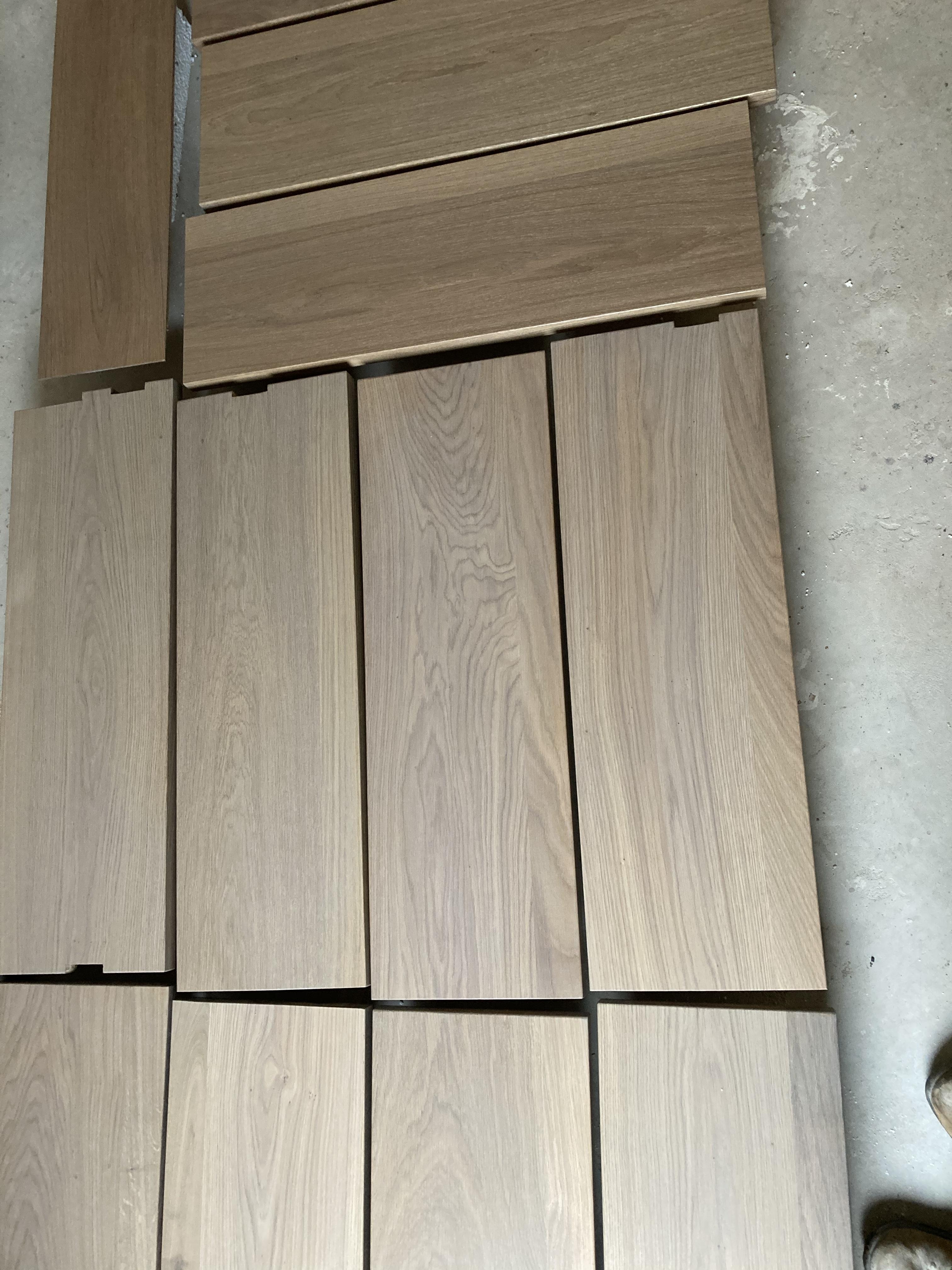

Russdl Posted January 17, 2021 Share Posted January 17, 2021 Just thought I’d share my OSMO experience so far. Our stairs treads are made out of oak/engineered oak and to try and keep them lightish and greyish and stop them going orangeish I’ve used OSMO’s Polyx Oil - light grey. It’s a bit nerve wracking, the product in the tin is most definitely grey, it looks like a grey primer paint. I had numerous trial runs on off cuts of oak before I had the balls to go for it on the treads themselves but I’ve achieved the look I’m after. Time will tell if it keeps the orange at bay. In the picture below the horizontally aligned treads have had one coat and the vertical treads the maximum of two coats. 3 Link to comment Share on other sites More sharing options...
Makeitstop Posted January 19, 2021 Share Posted January 19, 2021 On 17/01/2021 at 19:59, Russdl said: Just thought I’d share my OSMO experience so far. Our stairs treads are made out of oak/engineered oak and to try and keep them lightish and greyish and stop them going orangeish I’ve used OSMO’s Polyx Oil - light grey. It’s a bit nerve wracking, the product in the tin is most definitely grey, it looks like a grey primer paint. I had numerous trial runs on off cuts of oak before I had the balls to go for it on the treads themselves but I’ve achieved the look I’m after. Time will tell if it keeps the orange at bay. In the picture below the horizontally aligned treads have had one coat and the vertical treads the maximum of two coats. Looks like American white oak. doesn't colour to an orange shade in the same way as European stuff does, so you should be ok, especially treating them as you have. They look lovely tbf. Link to comment Share on other sites More sharing options...
Ralph Posted June 15, 2021 Share Posted June 15, 2021 On 17/01/2021 at 19:59, Russdl said: Just thought I’d share my OSMO experience so far. Our stairs treads are made out of oak/engineered oak and to try and keep them lightish and greyish and stop them going orangeish I’ve used OSMO’s Polyx Oil - light grey. It’s a bit nerve wracking, the product in the tin is most definitely grey, it looks like a grey primer paint. I had numerous trial runs on off cuts of oak before I had the balls to go for it on the treads themselves but I’ve achieved the look I’m after. Time will tell if it keeps the orange at bay. In the picture below the horizontally aligned treads have had one coat and the vertical treads the maximum of two coats. This is exactly what we are looking for on our oak treads, they look great. We tried Fiddes with a white and a grey tint and the Osmo grey. The whites were awful, like we had smeared PVA glue on them. Greys were not bad but it was on offcuts that we had not fully sanded. Can I ask how you applied it? Did you thin out the first coat with turps or wipe off after painting, anything like that? Many thanks Link to comment Share on other sites More sharing options...
Russdl Posted June 16, 2021 Share Posted June 16, 2021 Hi @Ralph I didn’t use any thinners with the Osmo Oil, just stirred well and applied a thin coat, thin enough so that you couldn’t see any obvious signs of pigment once applied. I left that for 24hrs and gave it a very light sanding and then the second thin coat. As it dries it goes vaguely grey. Link to comment Share on other sites More sharing options...
