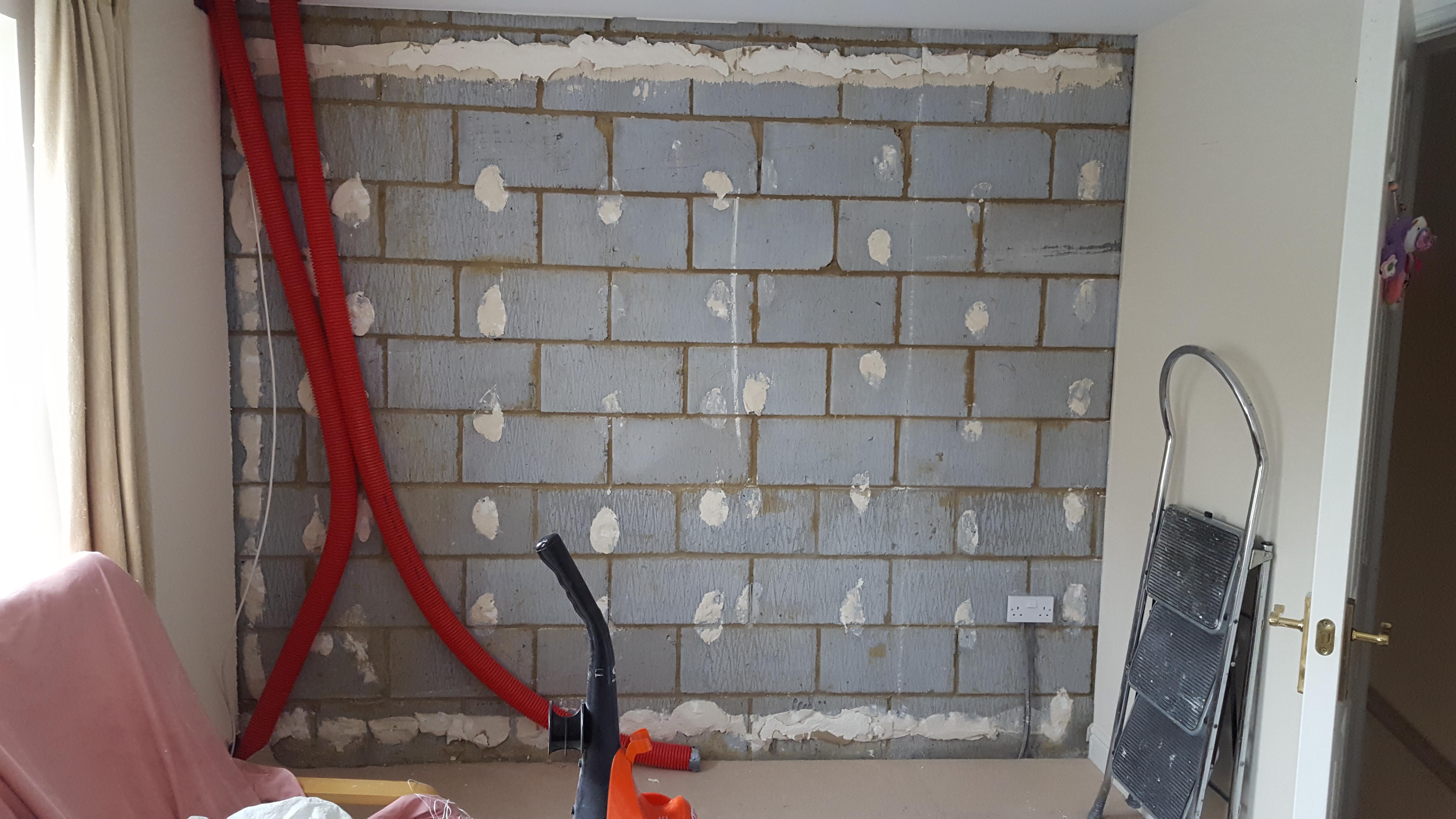

MJNewton Posted September 2, 2019 Posted September 2, 2019 Having stripped back the dot-and-dab plasterboard from a bedroom wall I now need to route four 75mm OD semi-rigid ducts from floor to ceiling. To conceal these, and reinstate the wall finish, I will be building a stud frame out of 75mm x 50mm timber. Unfortunately, whilst the base plate can be screwed down to the floor joists the joist hangers of the ceiling joists mean I won’t be able to affix the top plate to anything so the lateral loading will have to be accommodated by fastening the studs to the wall. My question is: what fasteners would your recommend, noting the ~75mm stud depth and limited scope for noggins for stiffness? If it’s relevant the wall finish will be 12.5mm PB + skim and whilst I don't anticipate putting heavy shelves up future owners might well do.

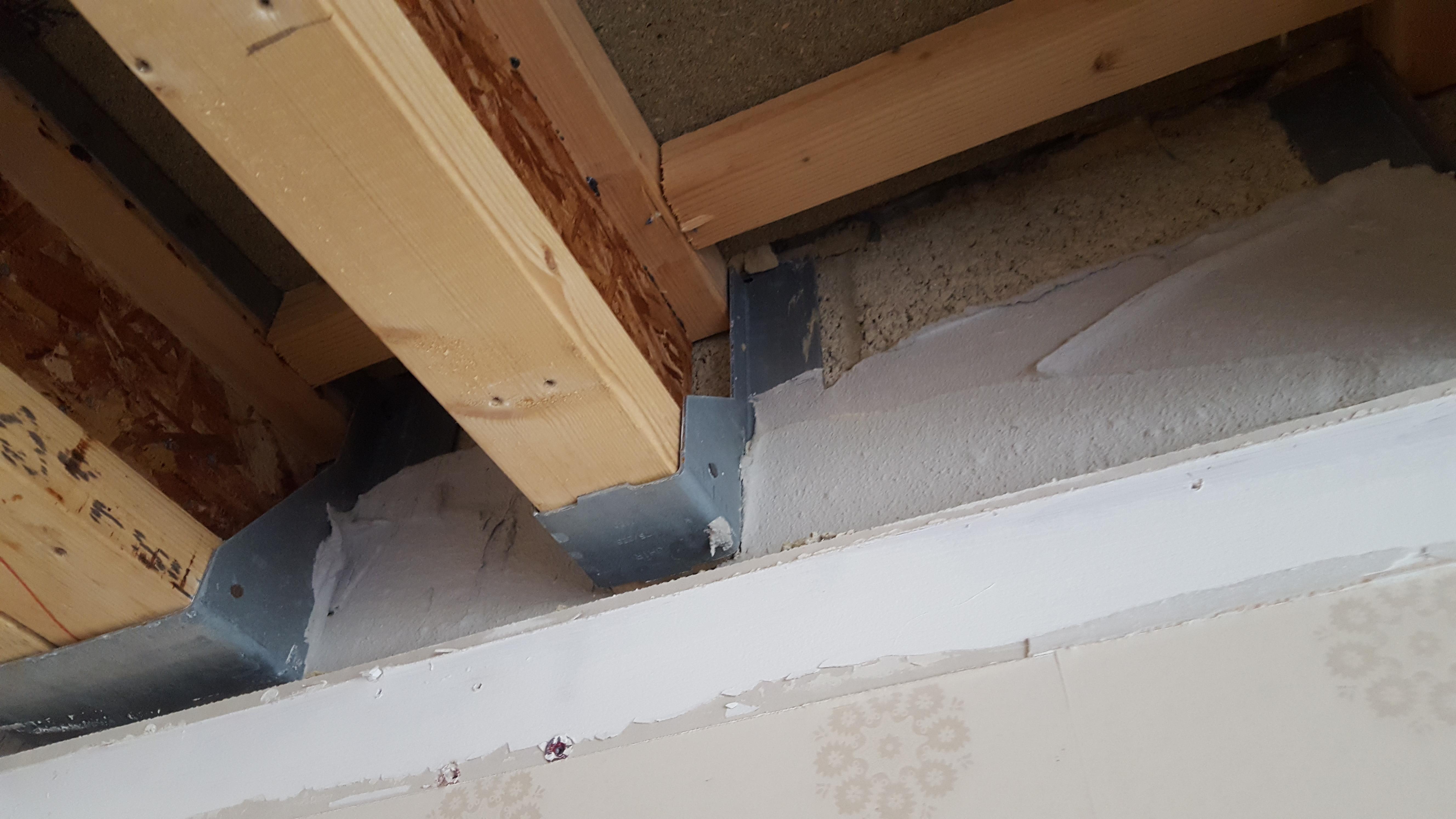

MJNewton Posted September 2, 2019 Author Posted September 2, 2019 I think all of these suggestions are probably valid; and I should add that by asking the question I have perhaps given the impression that I think it is a difficult problem to solve - I don't think it is but am never the less keen to hear of new (to me) ideas/products or whether a 'just use what Ive got' approach might suffice. On to the pics, here's the wall in question: (Ignore the duct routing - they're just hanging there! Oh, and don't highlight the less-than-ideal noncontinuous dot-and-dab method that'll almost certainly exist throughout the house!) And here are the joist hangers; photo taken from another room where I've taken the ceiling (plasterboard and resilient bars) down but the wall boards are still up: The 'cradle' of the hangers protrude ~80mm into the room so just about the size of my stud depth. If the hangers already hand a hole drilled in the bottom I think I'd be laughing - I'd locate them and drive a decent depth screw up through but for some reason I am nervous about drilling my own hole in them just in case that causes any weakness!
ProDave Posted September 2, 2019 Posted September 2, 2019 Yep I would just personally drill say an 8mm hole in the bottom of the joist hanger and insert a wood screw through that into the wood to fix the top plate. 1
MJNewton Posted September 2, 2019 Author Posted September 2, 2019 I'm warming to that idea - certainly sounds the easiest and most straightforward method and having thought about it further can't see how it could cause issue. Assuming of course drilling through the metal is achievable which given all my HSS drill bits are the ones made from cheese that you get in a multi-pack when you first buy a drill will unlikely be the case! Any bit recommendations? (Ideally from Toolstation/Screwfix for ease of reference)

MJNewton Posted September 6, 2019 Author Posted September 6, 2019 (edited) I did this job today and, as Simplysimon said, the Dewalt drill bit was a dream to use - it was like the proverbial hot knife through butter. Edited September 13, 2019 by MJNewton
