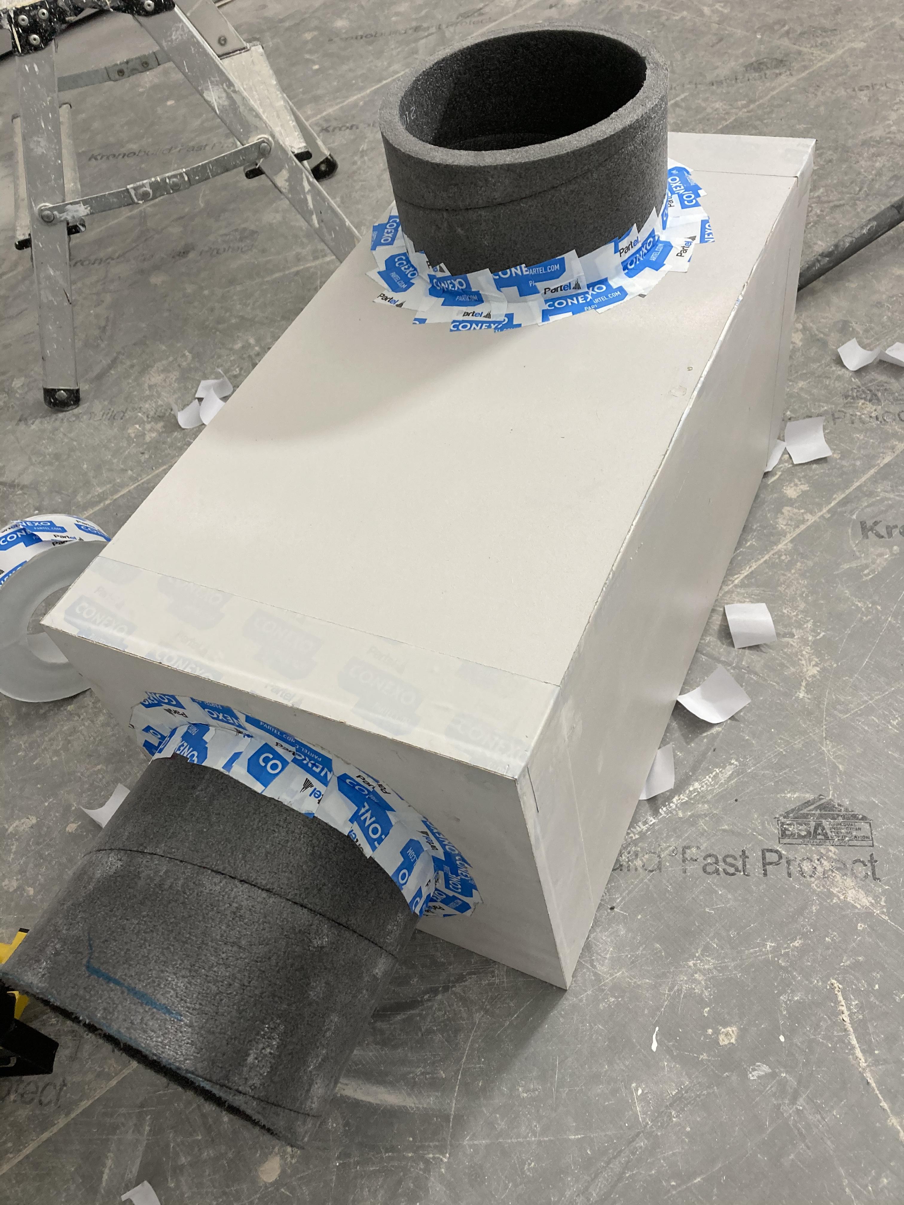

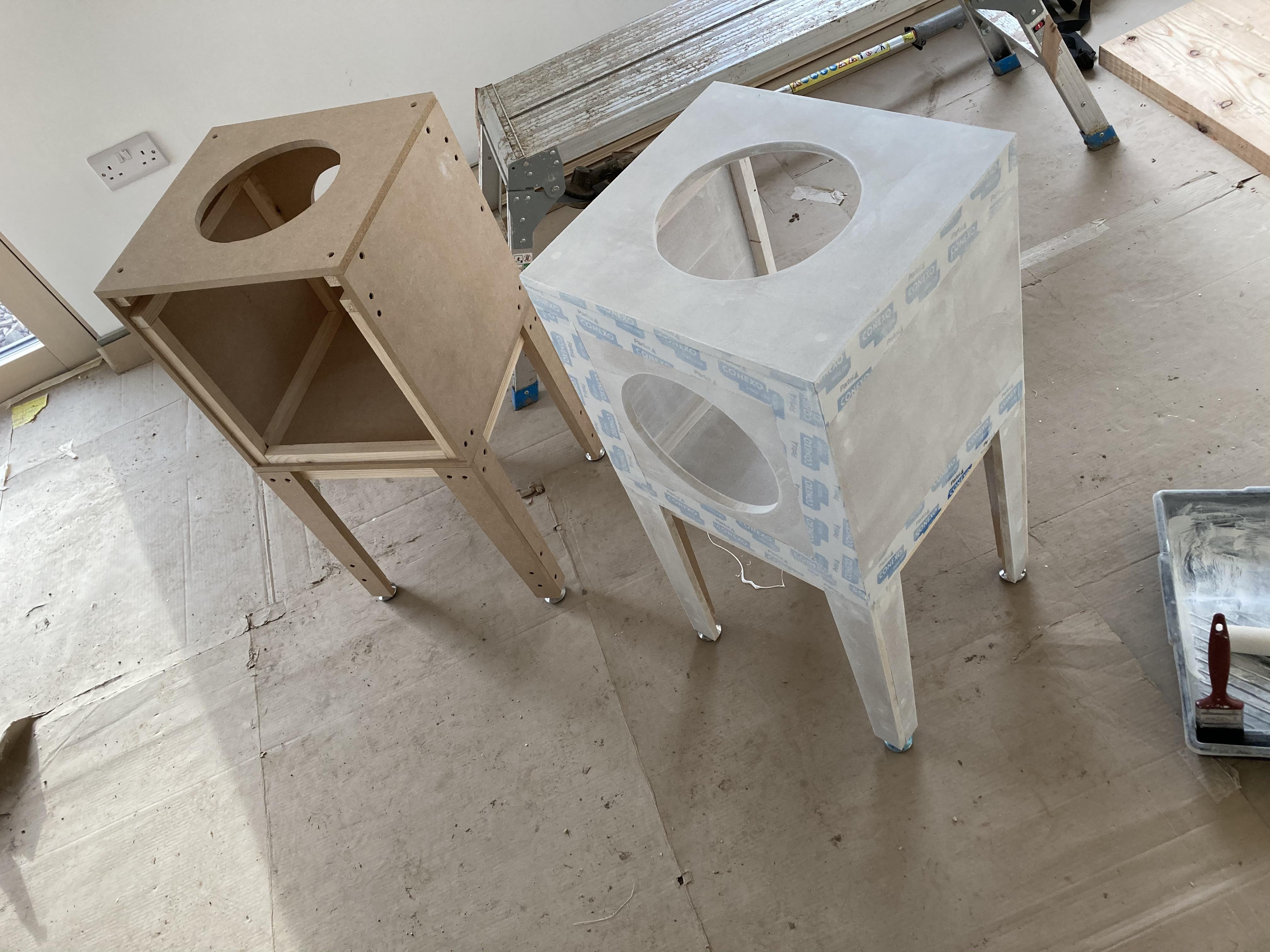

Russdl Posted December 4, 2020 Author Share Posted December 4, 2020 And then there were two. External joints taped with left over airtight tape. 1 1 Link to comment Share on other sites More sharing options...

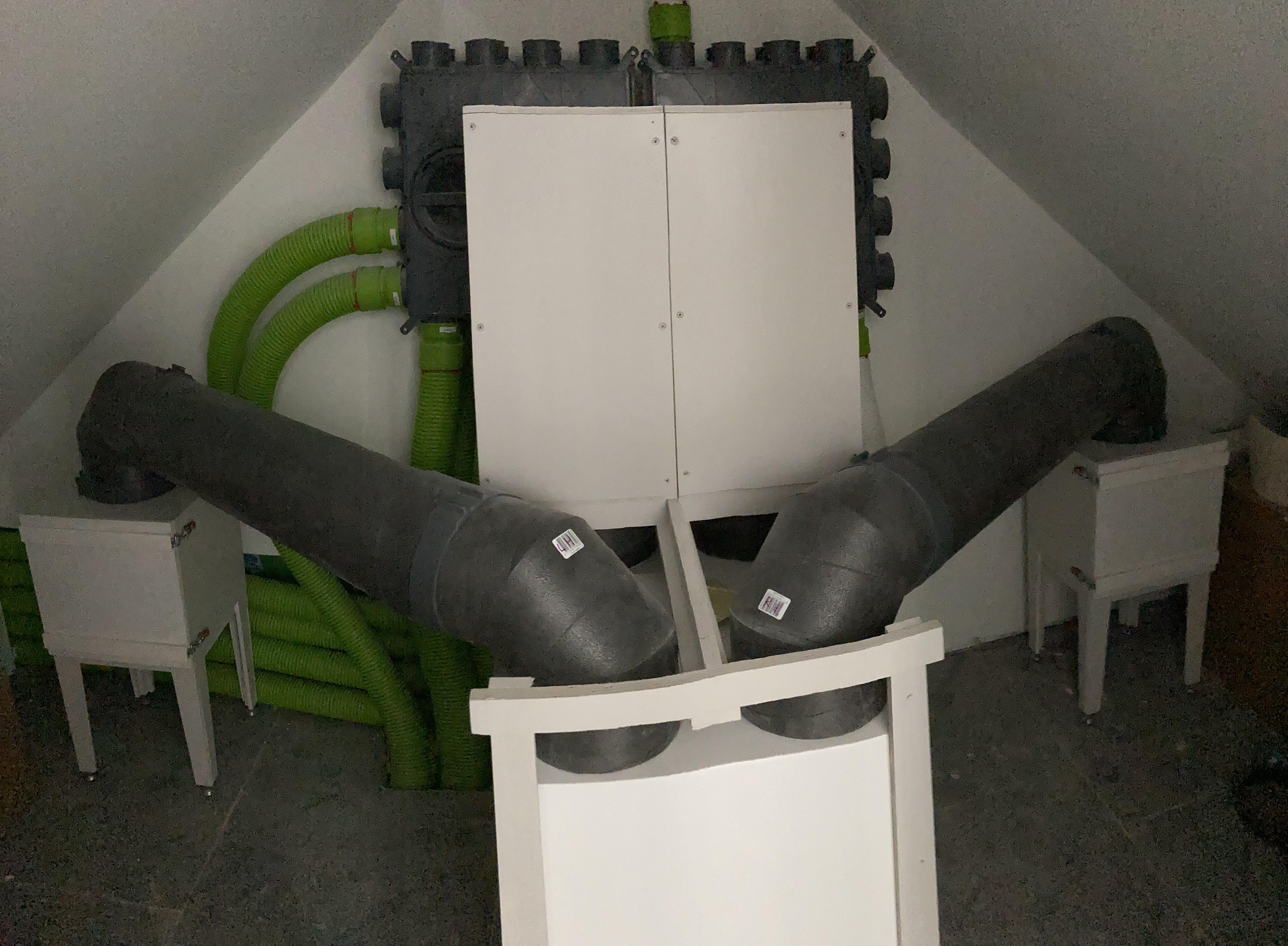

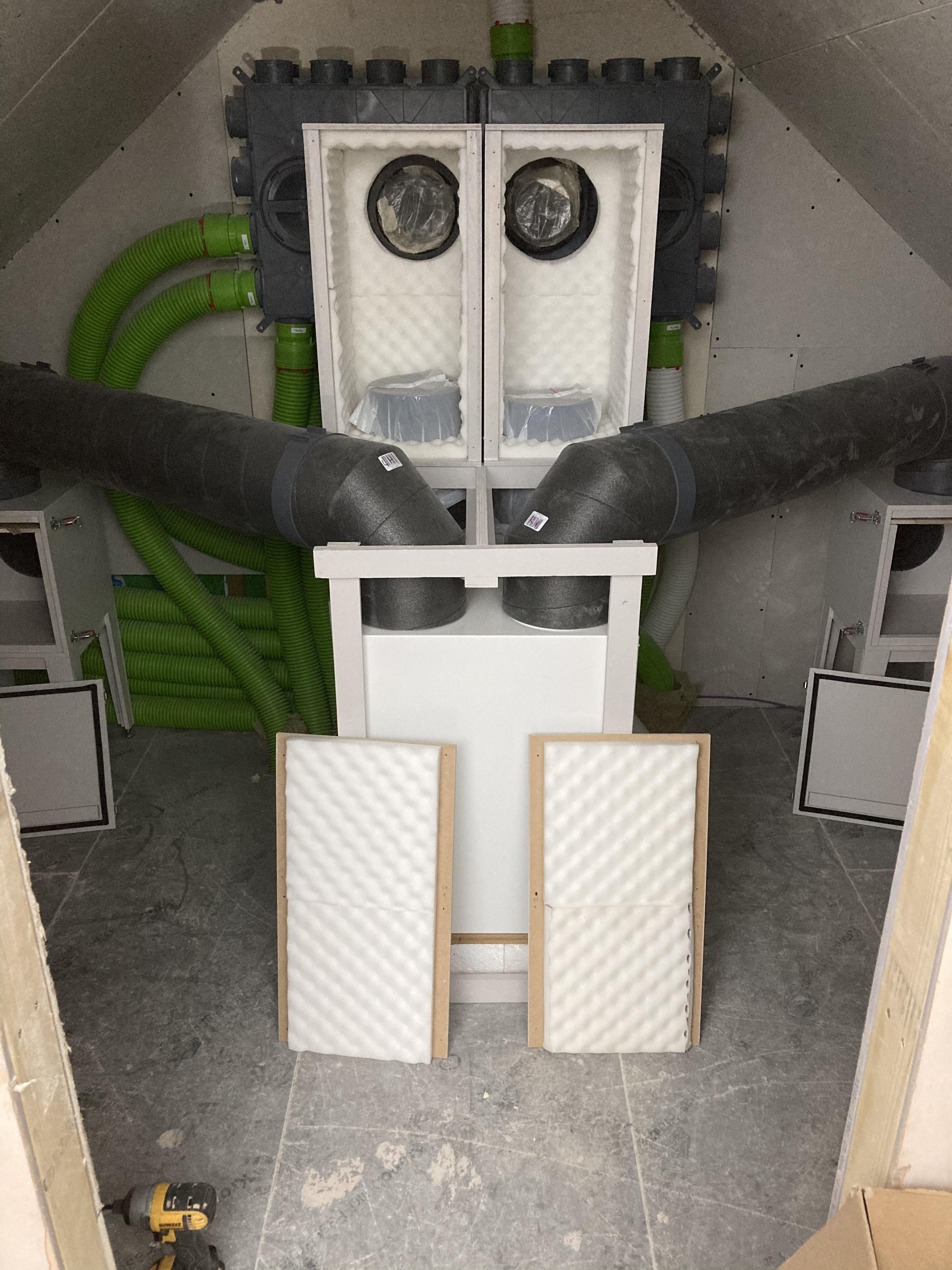

Russdl Posted December 18, 2020 Author Share Posted December 18, 2020 So, the over engineered MVHR pre filters are ready to go, along with the over engineered attenuators. I still need to tape and paint the wall before I fit it all properly but it’s gone together well so here’s hoping it all works ?? 3 Link to comment Share on other sites More sharing options...

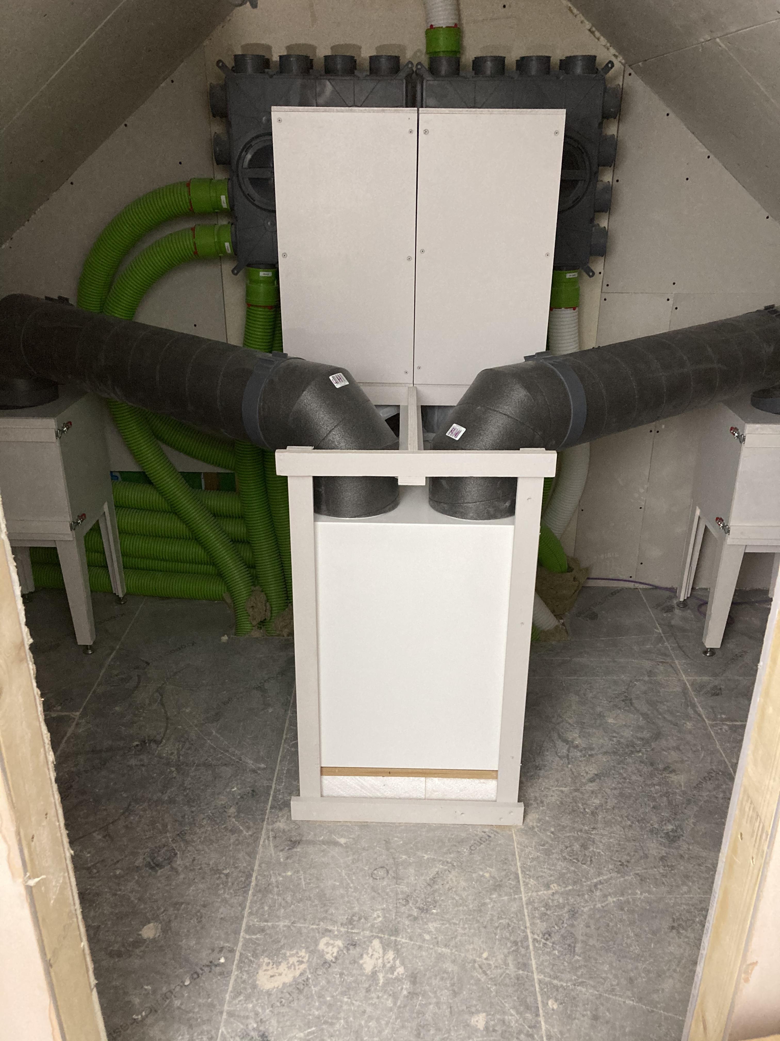

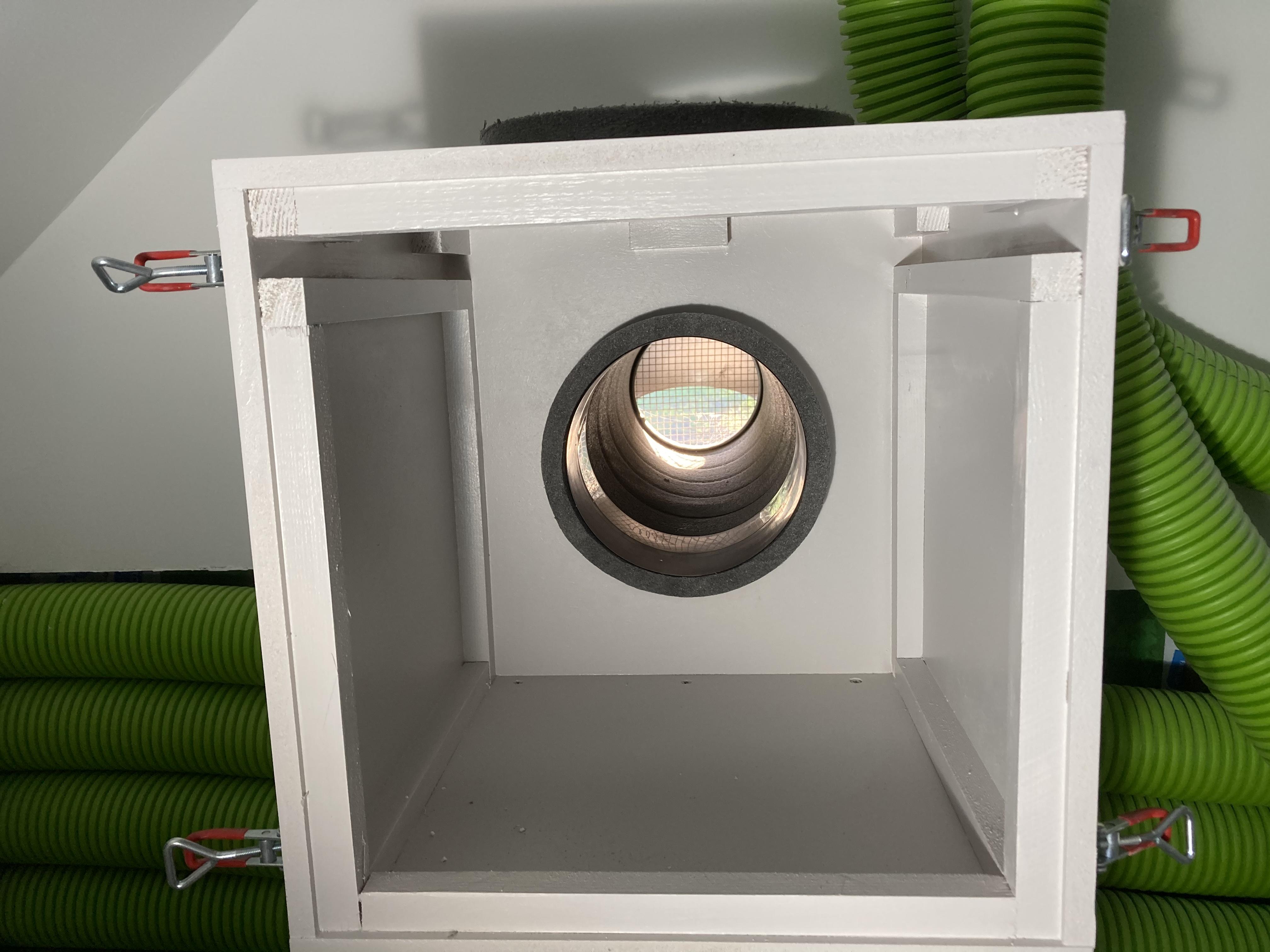

tanneja Posted January 1, 2021 Share Posted January 1, 2021 This is inspirational @Russdl, can I ask, with the distribution boxes, did you use the restrictor rings for balancing? Presumably these required cutting as appropriate for each run to achieve your balancing? Do you expect to need access to the internals of the distribution boxes in future as they seem to be behind your home made silencers? Link to comment Share on other sites More sharing options...
Russdl Posted January 2, 2021 Author Share Posted January 2, 2021 @tanneja I will be using the restrictor rings for balancing and they will require cutting, I'll also be using air valves that have a small amount of adjustment on them as well. It's not commissioned yet for several reasons, not least of which is that there is no power up there yet. The front face of the home made silencers will be screwed on and then taped so if I do need access at a later date (bound to!) then I'll just have to cut the tape and undo the screws and the silencer will be removable, in fact everything will be easily removable should the need arise. 1 Link to comment Share on other sites More sharing options...

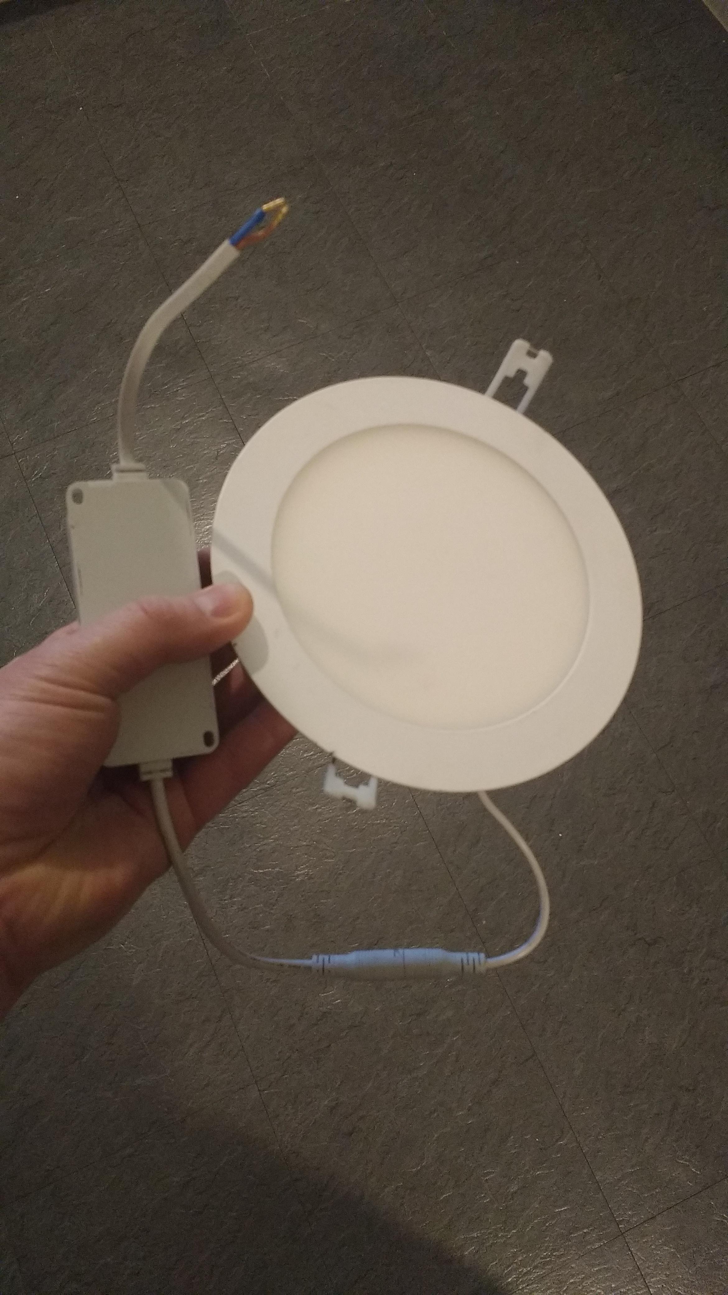

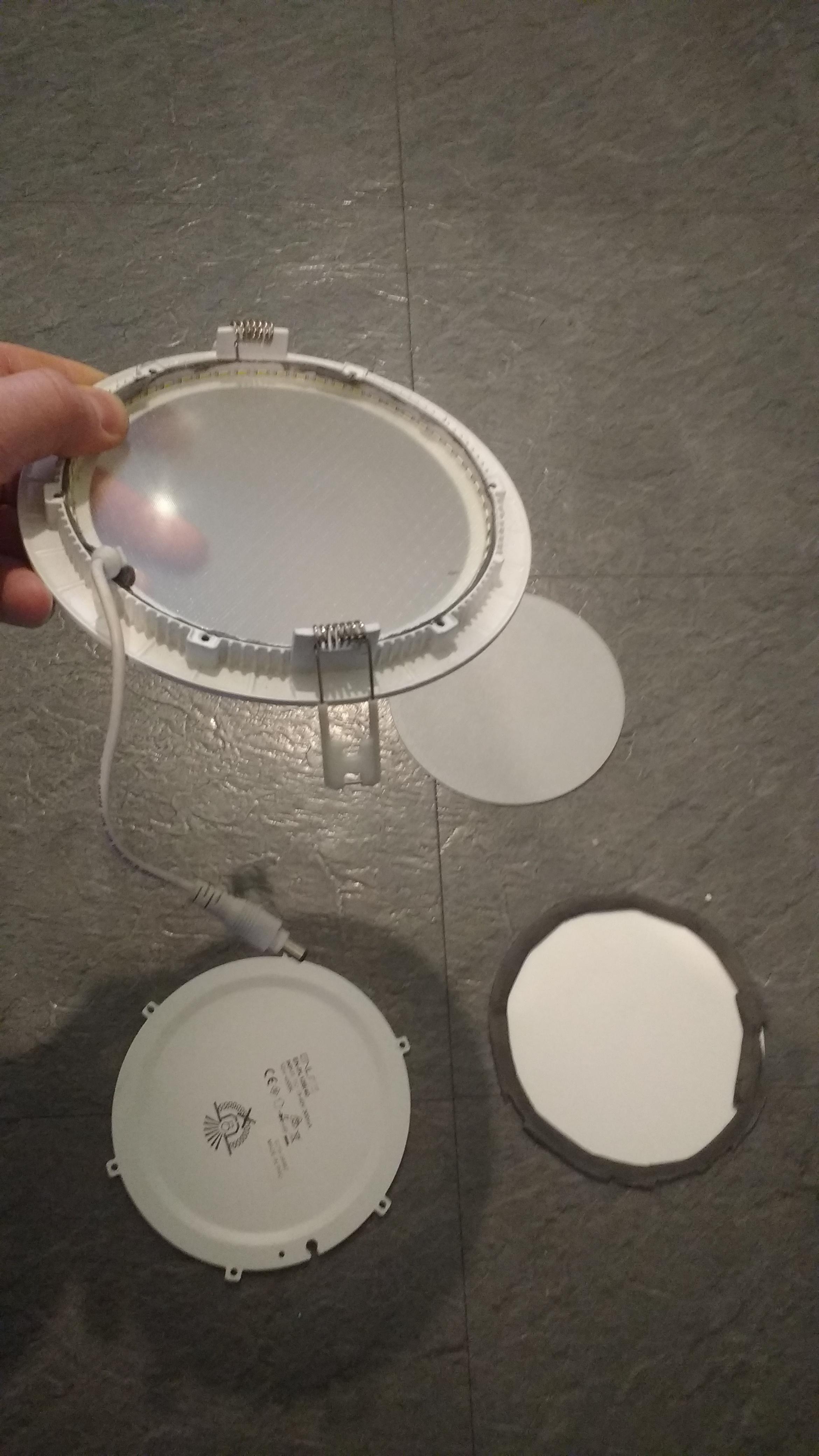

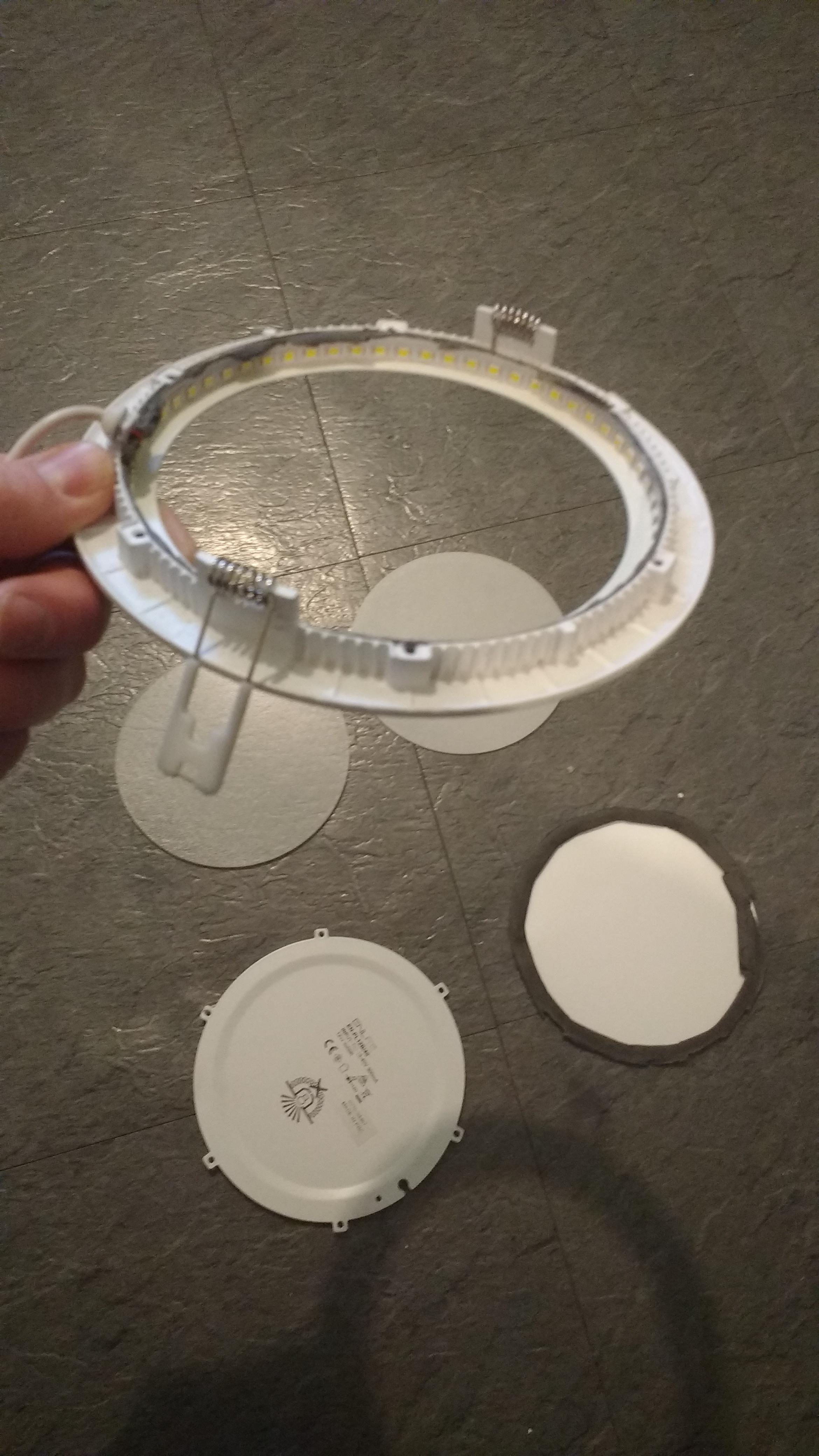

Onoff Posted January 2, 2021 Share Posted January 2, 2021 (edited) On 04/12/2020 at 13:31, Russdl said: And then there were two. External joints taped with left over airtight tape. Wouldn't a continuous bead of wood glue have achieved the same (better even), air tightness as the tape? Ref inspection windows, I've salvaged a number of non functioning, Enlite flat panel LEDs from the bin at work. They strip down to leave a nice, insertable (157mm cut out) bezel. Made from a light, white painted alloy, they'd sit nice in a cabinet with a bead of silicone. I think the diffuser is too opaque to see through for condensation so another acrylic/polycarbonate disc would be needed (it might polish up clear with compound). Just ever more crap I've collected but you're welcome to a couple or more. Originally got for my lad's 3D printer enclosure until we went with full glass sides. (Of course 3D printing inspection window bezels is an option): Edited January 2, 2021 by Onoff Link to comment Share on other sites More sharing options...
Russdl Posted January 2, 2021 Author Share Posted January 2, 2021 1 hour ago, Onoff said: Wouldn't a continuous bead of wood glue have achieved the same (better even), air tightness as the tape? It may well have done but I had some airtight tape left over so I used it. I had MDF left over as well hence they are made of MDF and not ply, we’ll see what happens. Thanks for the offer of the old light fittings as inspection thingies, a great idea, I won’t need them however as the fronts come off with a few flicks of levers for inspection/cleaning. The fronts are sealed with closed cell foam, I’m guessing that’ll be as close to airtight as I’ll need. (They’re still not fitted properly yet) 1 Link to comment Share on other sites More sharing options...
tanneja Posted January 3, 2021 Share Posted January 3, 2021 @Russdl, would you please confirm (as seems to be the case based on your picture above), have you used the same foam ducting for duct length that punctures the building wall? Is there any fall / gradient on that length? Link to comment Share on other sites More sharing options...
Russdl Posted January 3, 2021 Author Share Posted January 3, 2021 @tanneja yep, it's the Ubbink 180mm insulated duct and both runs have a slight fall from inside to out. 1 Link to comment Share on other sites More sharing options...

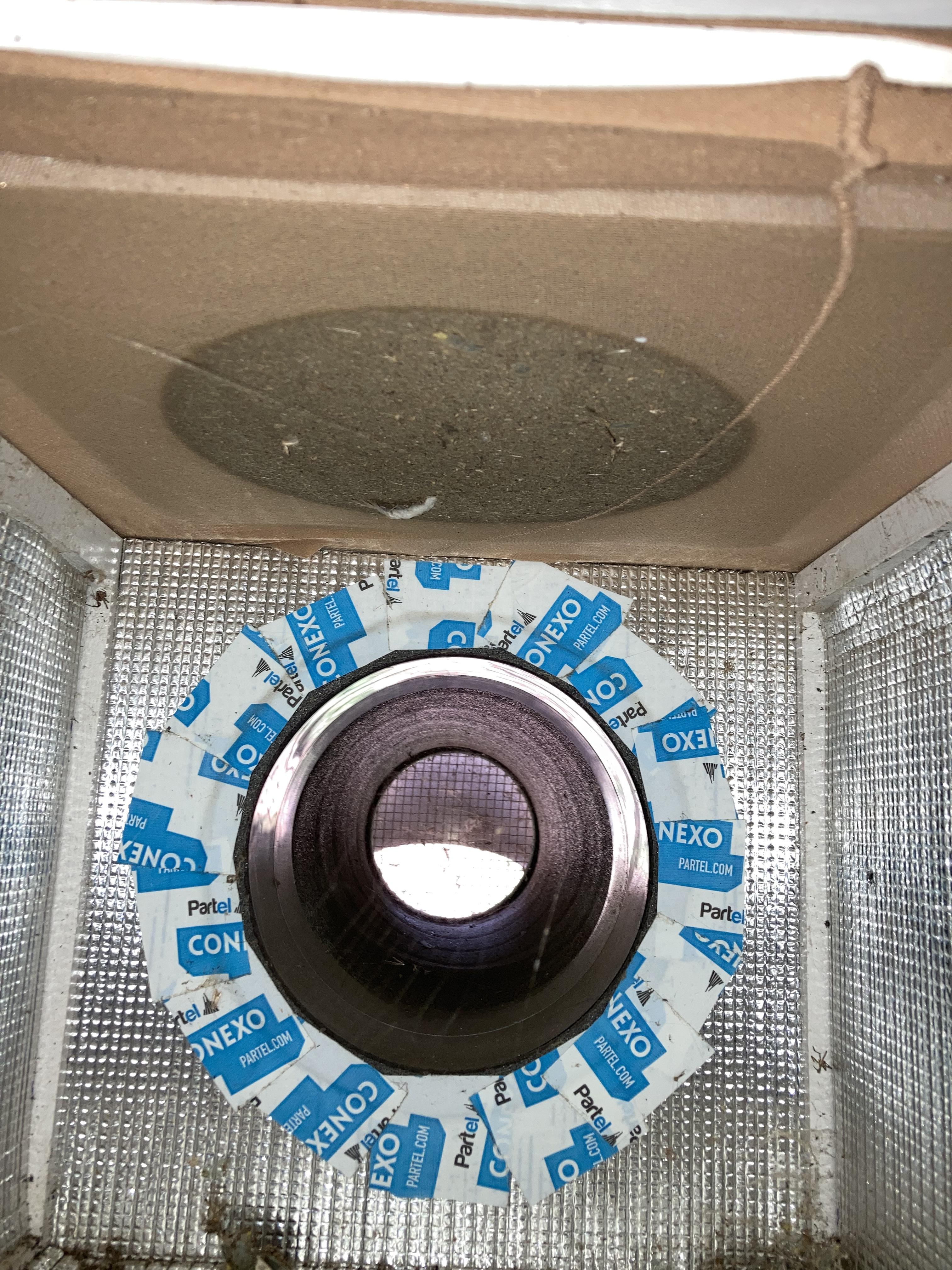

Russdl Posted January 17, 2021 Author Share Posted January 17, 2021 (edited) Finally the MVHR with added bits is properly fitted and the loft space in which it resides is taped and painted. The spiders are already on the advance through the grills on the intake and exhaust vents so hopefully my MVHR pre filter will keep them out of the MVHR itself. The pre filters are airtight so should be spider proof as well. The home made attenuators are easy to remove, which I’ll need to do to fit the restrictor rings to the manifolds and I haven’t airtight taped the fronts on yet. Not sure if I need to? The boxes are lined with acoustic foam, would that be airtight enough I wonder, and how would I know if it wasn’t? Just need some electricity to see if it all works as I hope ?? Edited January 17, 2021 by Russdl 3 Link to comment Share on other sites More sharing options...

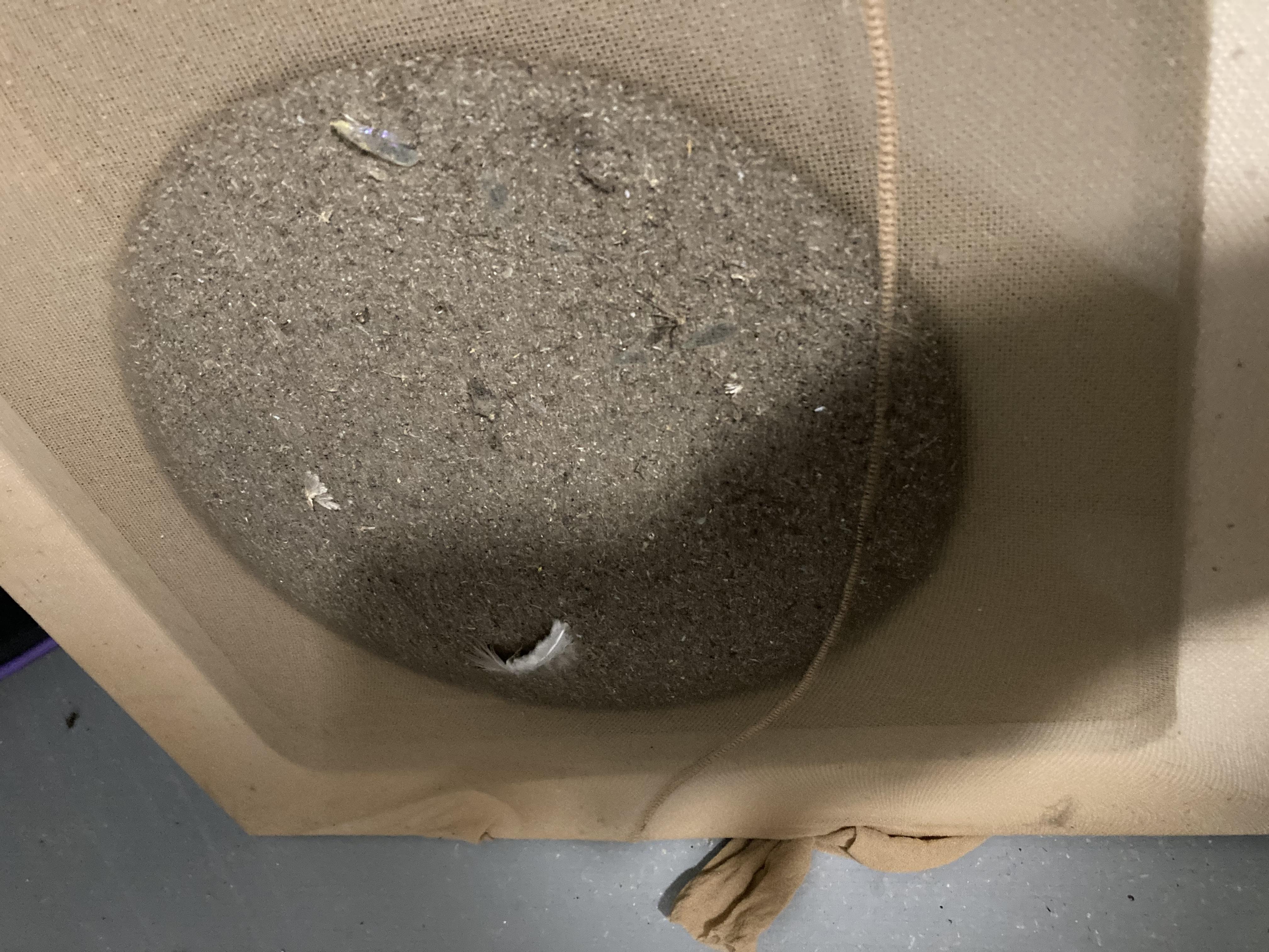

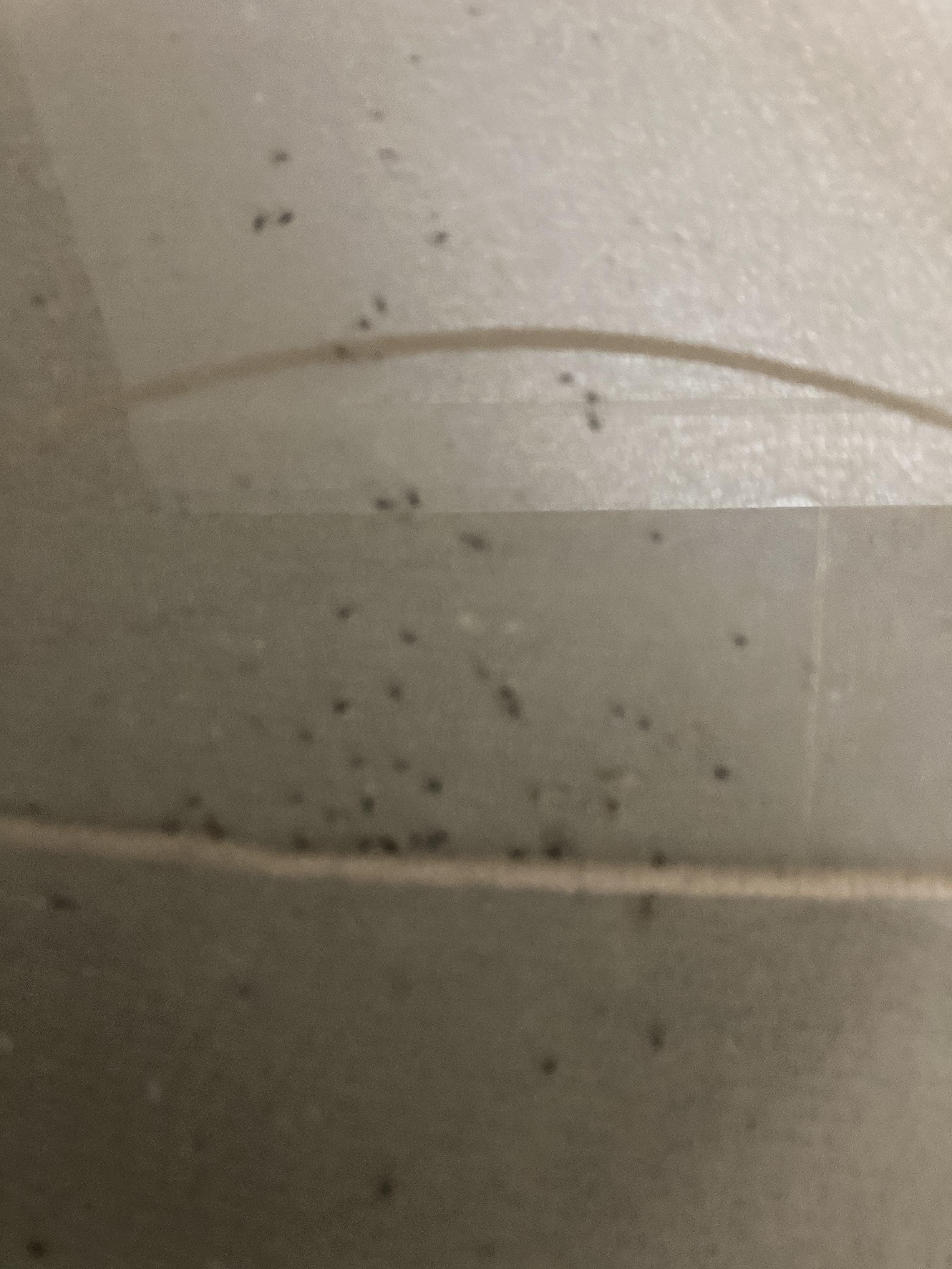

Russdl Posted March 28, 2021 Author Share Posted March 28, 2021 Well it’s early days as the MVHR has only been on for a little under a month but my pre filters seem to be doing the trick But not perfectly, some of the little rascals are getting through, I think I’ve got a ladder in me tights. 3 Link to comment Share on other sites More sharing options...

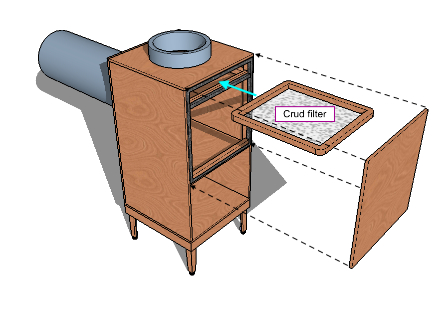

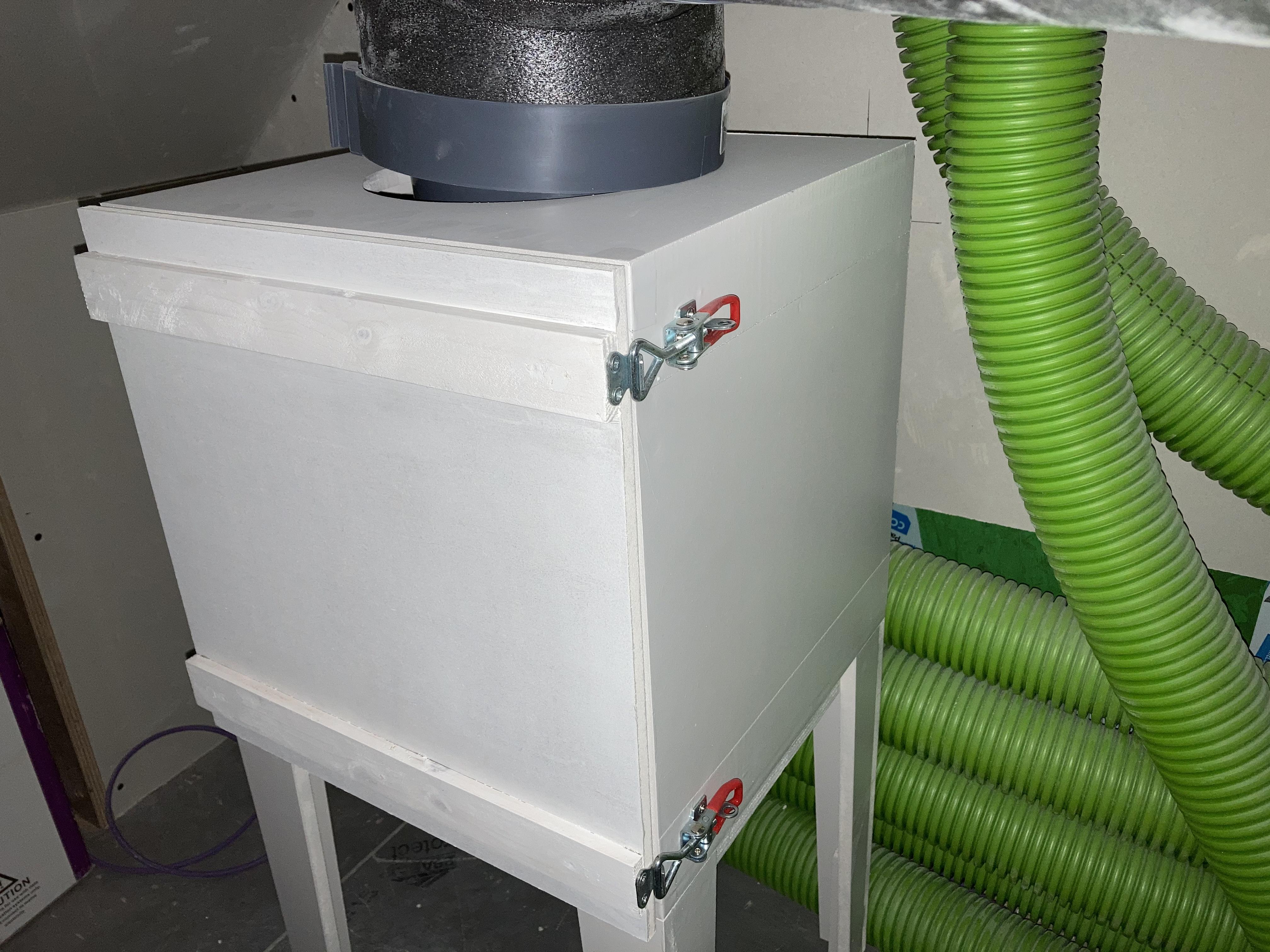

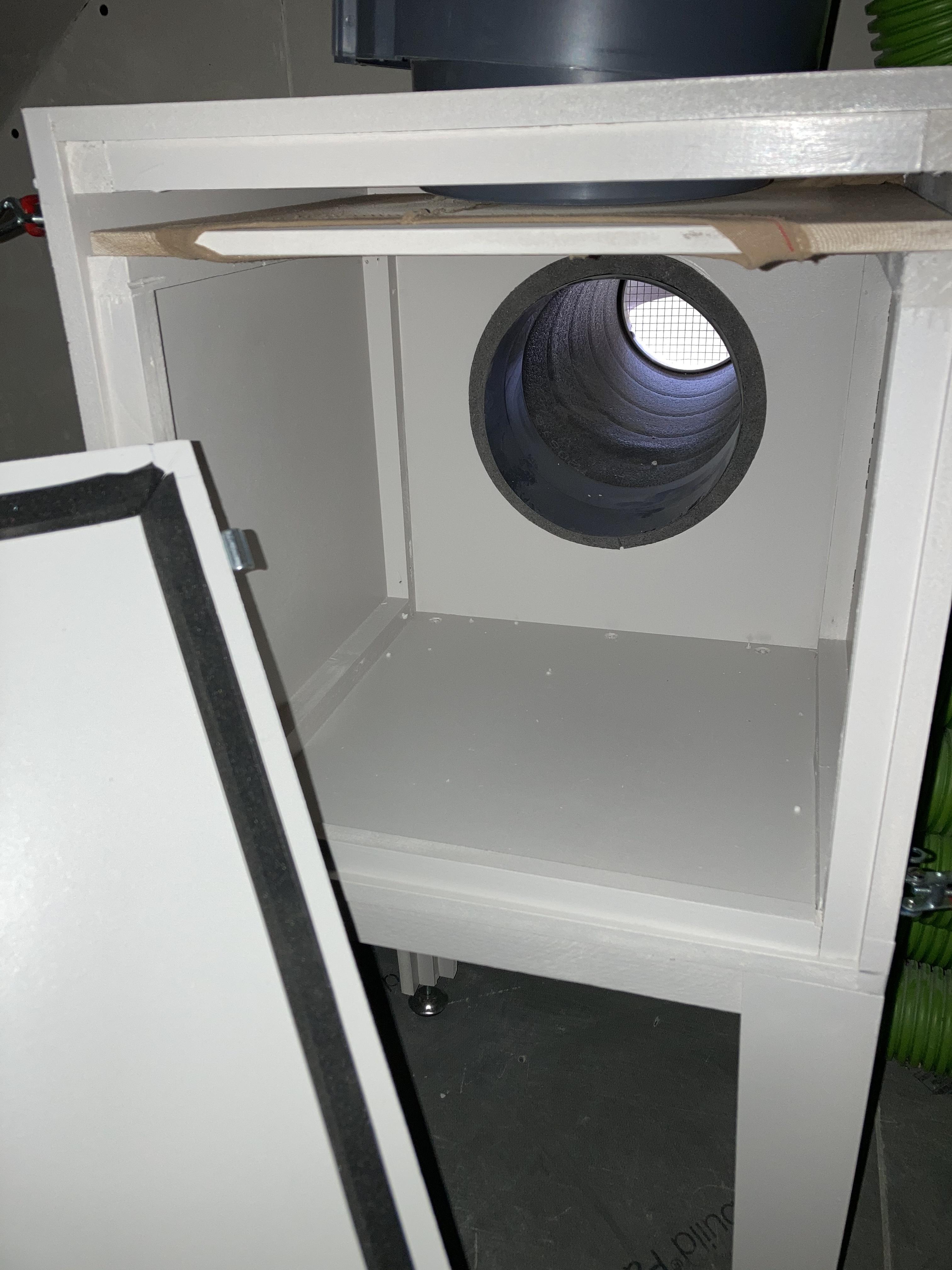

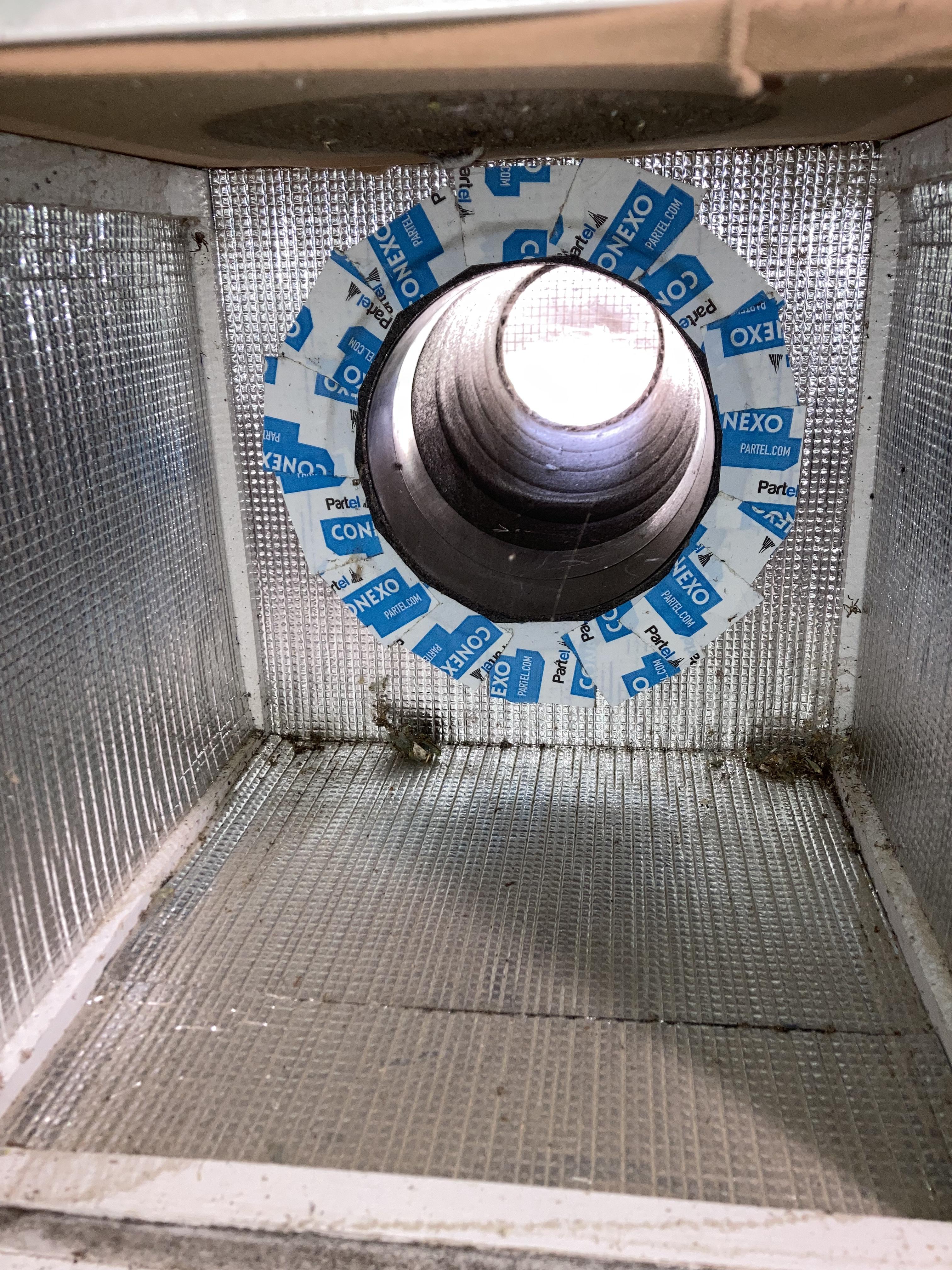

Russdl Posted November 22, 2021 Author Share Posted November 22, 2021 On 15/11/2020 at 22:17, Russdl said: I wonder if my little wooden box pre-filter will cause me condensation issues???? I can answer my own question here. My ‘pre-filter’ MDF boxes are in a warm loft and work a treat at pre-filtering however I am getting plenty of condensation on the outside of my ‘supply side’ pre-filter box, the ‘exhaust’ side is fine. I’m thinking the easiest fix will be to insulate the inside of it. any suggestions as to what would be best to use? Link to comment Share on other sites More sharing options...
PeterW Posted November 22, 2021 Share Posted November 22, 2021 Cheap yoga mat or camping mat cut to fit and stuck on with carpet glue 1 1 Link to comment Share on other sites More sharing options...
Onoff Posted November 22, 2021 Share Posted November 22, 2021 36 minutes ago, Russdl said: I can answer my own question here. My ‘pre-filter’ MDF boxes are in a warm loft and work a treat at pre-filtering however I am getting plenty of condensation on the outside of my ‘supply side’ pre-filter box, the ‘exhaust’ side is fine. I’m thinking the easiest fix will be to insulate the inside of it. any suggestions as to what would be best to use? Could you have built it turned through 45 degrees and had a condensate drain? Link to comment Share on other sites More sharing options...
Russdl Posted November 22, 2021 Author Share Posted November 22, 2021 31 minutes ago, Onoff said: Could you have built it turned through 45 degrees and had a condensate drain? I guess that may have helped but the condensation is on the outside the box. Mainly on the top and down the back of the box. My aim now is to make the problem go away by insulating the inside of the box. @PeterW’s suggestion of a cut up yoga mat sounds like a good idea because I don’t want to restrict the flow and that should be thin enough to achieve that. I wonder if it’ll be too thin to be effective? I guess I could always do two layers. Link to comment Share on other sites More sharing options...
Onoff Posted November 22, 2021 Share Posted November 22, 2021 29 minutes ago, Russdl said: I guess that may have helped but the condensation is on the outside the box. Mainly on the top and down the back of the box. My aim now is to make the problem go away by insulating the inside of the box. @PeterW’s suggestion of a cut up yoga mat sounds like a good idea because I don’t want to restrict the flow and that should be thin enough to achieve that. I wonder if it’ll be too thin to be effective? I guess I could always do two layers. Sorry, didn't read 'outside", saw the black bits inside I thought were the dreaded black mould. Link to comment Share on other sites More sharing options...

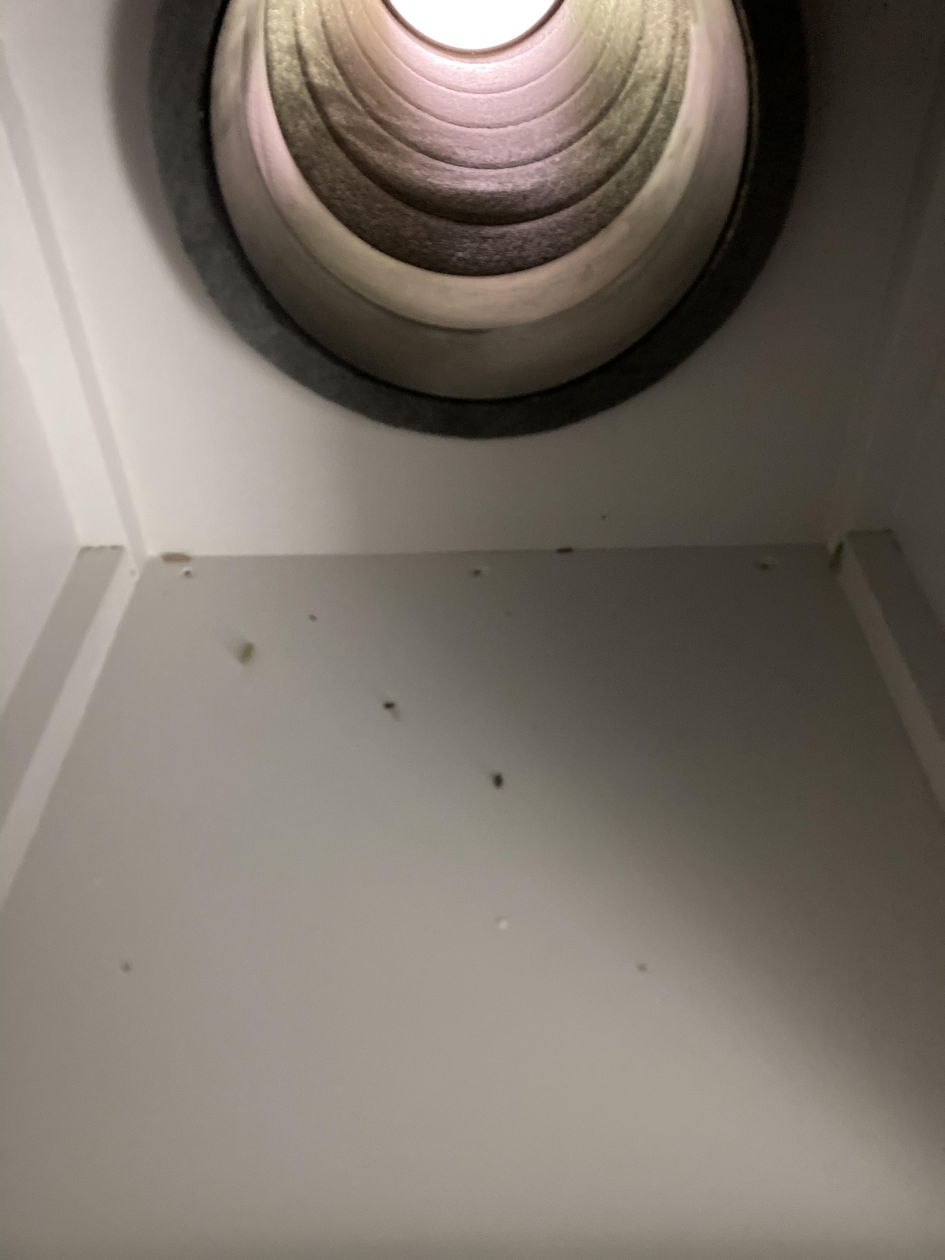

Russdl Posted November 22, 2021 Author Share Posted November 22, 2021 15 minutes ago, Onoff said: saw the black bits inside I’m pleased to report that is not mould, just crud (flies, seeds, dust etc). Link to comment Share on other sites More sharing options...

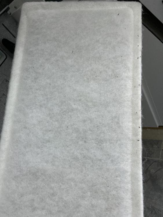

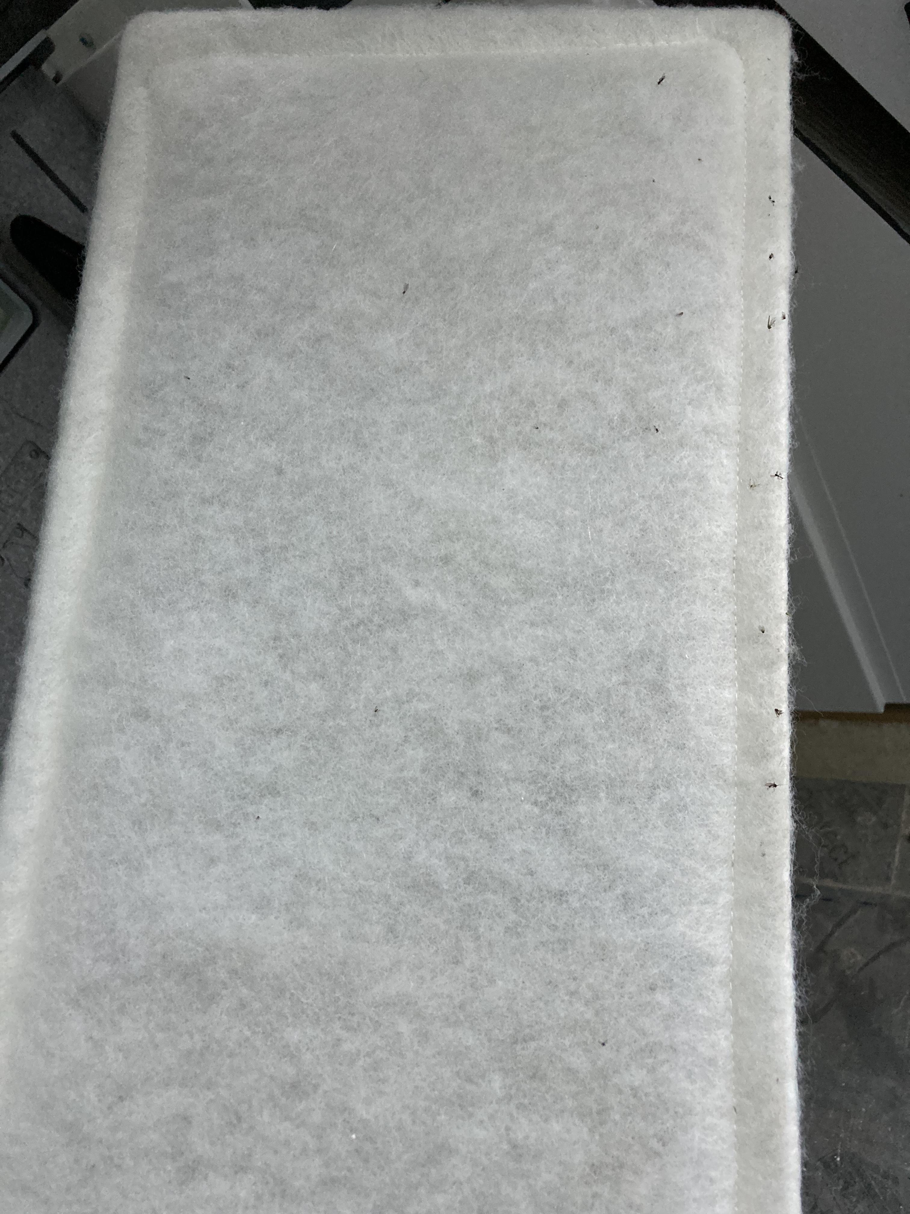

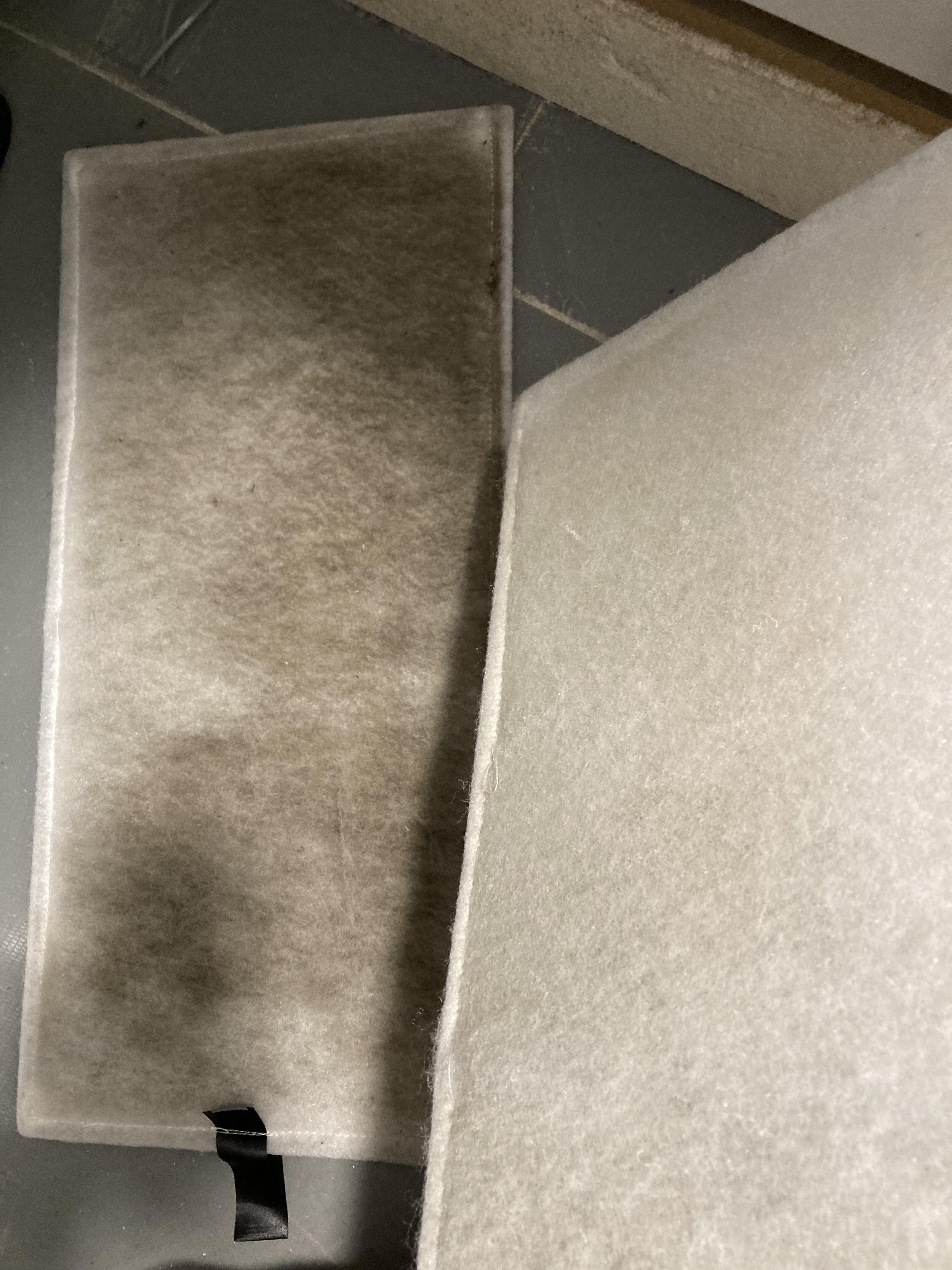

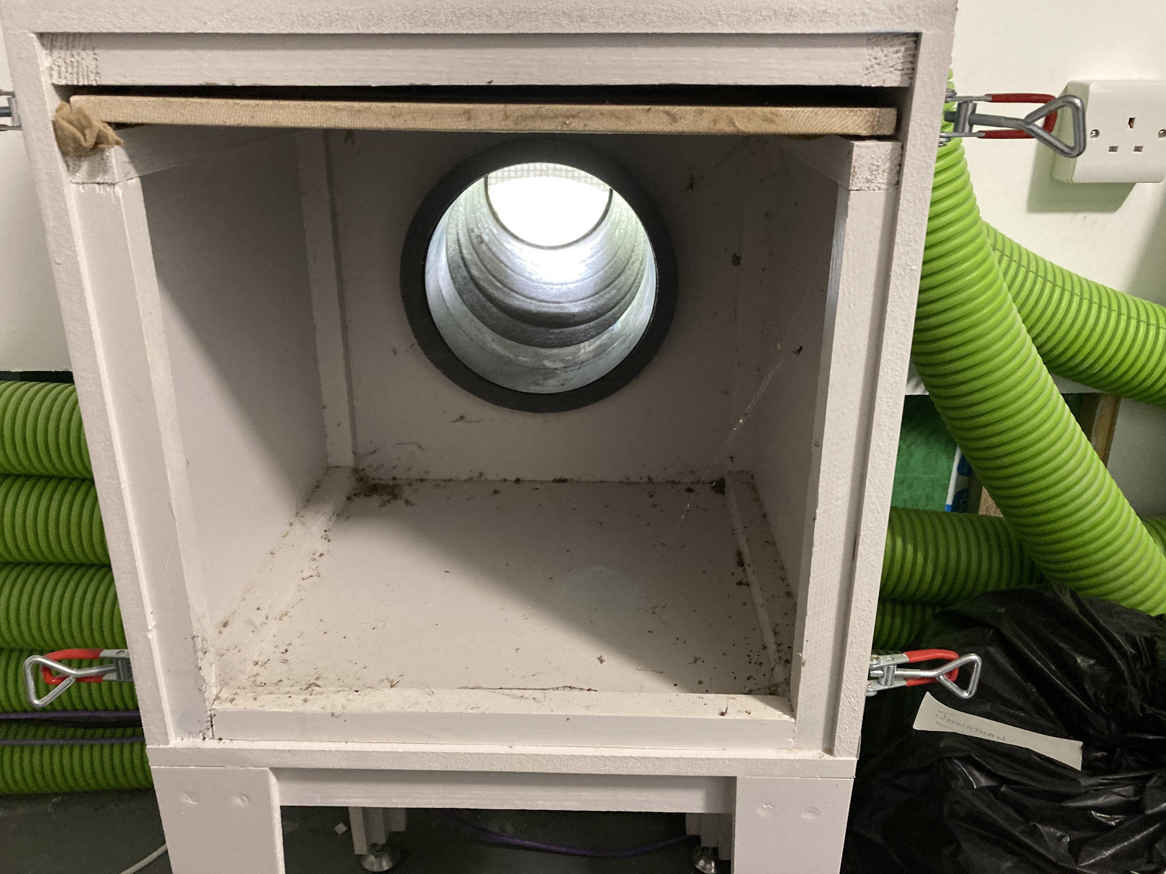

Russdl Posted August 16, 2022 Author Share Posted August 16, 2022 It’s 45 days since I cleaned the MVHR filters and whilst I’ve not had a ‘message’ telling me to clean them the MVHR did seem a bit noisier, nothing excessive but as it’s normally pretty much inaudible the fact that I could hear it sent me to the loft to investigate. The intake filter is quite bogging after a month and a half, the extract is not too bad at all considering doors and windows have been opened as required to off load unwanted heat. The pre-filter seems to be doing its job, this was a brand new pair of tights a month and a half ago! I wonder if the pre filter housing is actually enticing critters in? Again, this was cleaned out a month and a half ago. The coarse mesh of the intake grill is covered in cobwebs, as is the duct into the house though they don’t show up too well in the photos. the joys of living in the countryside, spitting distance to the wheat field that was just recently harvested I suppose. I opted to replace the intake filter as vacuuming it achieved the square root of bugger all. I didn’t think to check the MVHR fan speeds before and after the service but it seems quieter again so I’m assuming the crud was restricting the airflow enough to cause the fan speeds to increase to maintain the selected airflow. Link to comment Share on other sites More sharing options...
jack Posted August 16, 2022 Share Posted August 16, 2022 15 minutes ago, Russdl said: the joys of living in the countryside, spitting distance to the wheat field that was just recently harvested I suppose. I opted to replace the intake filter as vacuuming it achieved the square root of bugger all. I drove past a wheat field being harvested on Sunday. The dust cloud it generated was visible a mile away! Link to comment Share on other sites More sharing options...

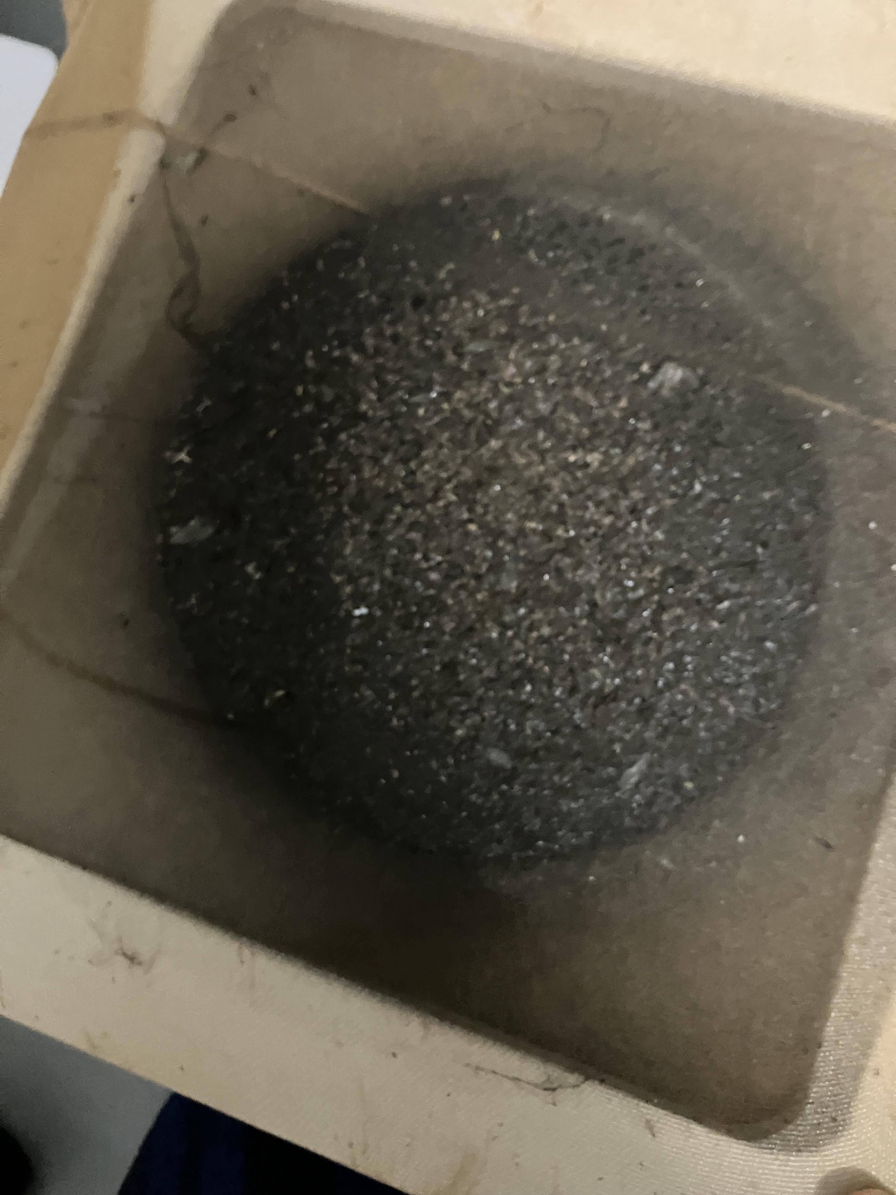

Russdl Posted August 7, 2023 Author Share Posted August 7, 2023 I think I may have neglected my pre-filters the last time I cleaned the MVHR filters. Once again the MVHR Seemed to be getting noisier, initially I put it down to me just always listening out for any noises but this morning when it did it’s morning switch from 100m3/hr to 200m3/hr it sounded like it was on boost. I went to have a look and this time remembered my pre-filter! 🤮🤮🤮 not the best photo but you can probably see that it is absolutely bogging. Almost completely blocked by all sorts of detritus. I don’t think it’s been neglected for more than 6 months so I’m surprised how bad it is. The only thing I can think of is that we seem to have had many more days of northerly/easterly winds of late (according to my gut feeling) and we have cultivated fields that side. I measured the noise with an app on my phone up against a supply terminal before and after replacing the pre filter. 41db before 33db after. Also the power draw 67W before 34W after. I must remember to keep an eye on those pre filters. 1 2 Link to comment Share on other sites More sharing options...
Temp Posted August 7, 2023 Share Posted August 7, 2023 I fitted a pre filter to the air inlet of our system so it's visible without removing any covers. Saves a lot of effort. Link to comment Share on other sites More sharing options...
