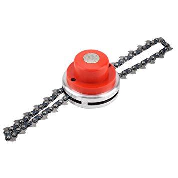

Triassic Posted August 24, 2019 Share Posted August 24, 2019 My strimmer head has worn out and given the amount of plastic line I loose to the environment I was wondering about replacing it with one of these, what do you think? Has anyone used one, are they any good ? 1 Link to comment Share on other sites More sharing options...
Jeremy Harris Posted August 24, 2019 Share Posted August 24, 2019 I really like the idea, as I hate the idea of shredding very breakdown resistant plastic into the environment. Be nice if a head like this was available for the lower power cordless strimmers. Perhaps someone needs to highlight the potential damage to the environment from shredding plastic from these things? Link to comment Share on other sites More sharing options...
ProDave Posted August 24, 2019 Share Posted August 24, 2019 My strimmer also came with a "brush cutter" head. Similar principle though perhaps even more brutal. The one BIG WARNING I will give is do not EVER try strimming up to or close by any form of wire fence, e.g chainlink or indeed anything that the "blade" will not easily cut through. For this reason, I do not normally use the brushcutter blade, as most of my strimmer work is tidying up edges with far too many things for the brushcutter blade to snag on. My strimmer head is just fitted with a left hand metric screw thread, I would have to measure it to be sure but about M10. If yours is the same then I am sure you could buy a brush cutter head for it. I find the weakness of a standard strimmer head is the holes where the line exits wear, even if they have metal inserts. You can just buy a replacement universal line head like this one that has a variety of male and female LH thread adaptors of different sizes so I am sure this would fit my machine https://www.ebay.co.uk/itm/Dual-Bump-Feed-Head-Base-Strimmer-Line-for-KAWASAKI-Petrol-Brush-Cutter-Trimmer/282586006843?epid=2144946364&hash=item41cb70453b:g:NCAAAOSwQWFZd0Gy It is probably worth having a look at a small electric strimmer to see if they have the same LH thread coupling arrangent for the head. Link to comment Share on other sites More sharing options...
Onoff Posted August 24, 2019 Share Posted August 24, 2019 I wondered about replacing my electric strimmer line with 2mm dia stainless steel aircraft cable? Link to comment Share on other sites More sharing options...
PeterW Posted August 24, 2019 Share Posted August 24, 2019 52 minutes ago, Triassic said: My strimmer head has worn out and given the amount of plastic line I loose to the environment I was wondering about replacing it with one of these, what do you think? Has anyone used one, are they any good ? Only if I was wearing chainsaw boots.... that is chainsaw chain without the cutter teeth !! Link to comment Share on other sites More sharing options...
Russell griffiths Posted August 24, 2019 Share Posted August 24, 2019 I take it your not very fond of walking @Triassic can you imagine that letting go and hitting you in the ankle, cannot really see how this is allowed to be sold over here. Looks about as friendly as the toothed blades that fit in an angle grinder. Not for me im afraid. Link to comment Share on other sites More sharing options...
Triassic Posted August 25, 2019 Author Share Posted August 25, 2019 I asked the same question on the Arboriculture forum and the response was negative, apparently these things were banned a few years ago as a result of an injury, leading to the untimely death, of a user. I won’t be buying one! I’ll be looking at other options for a replacement head for the strimmer. Link to comment Share on other sites More sharing options...

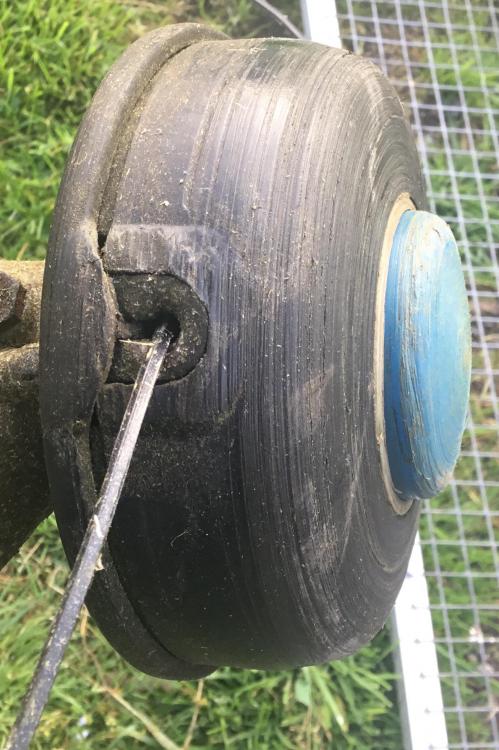

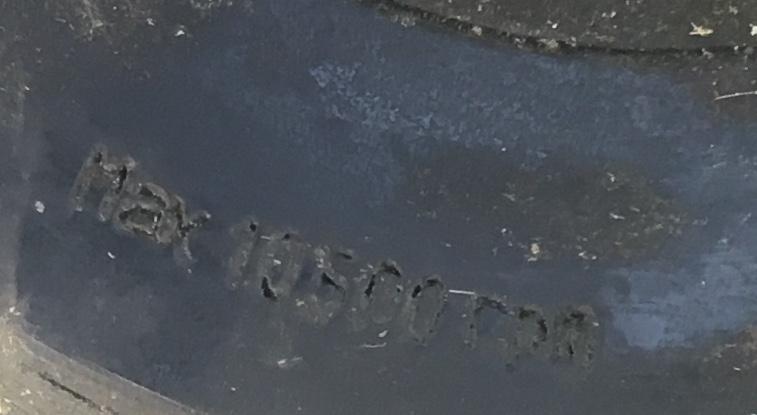

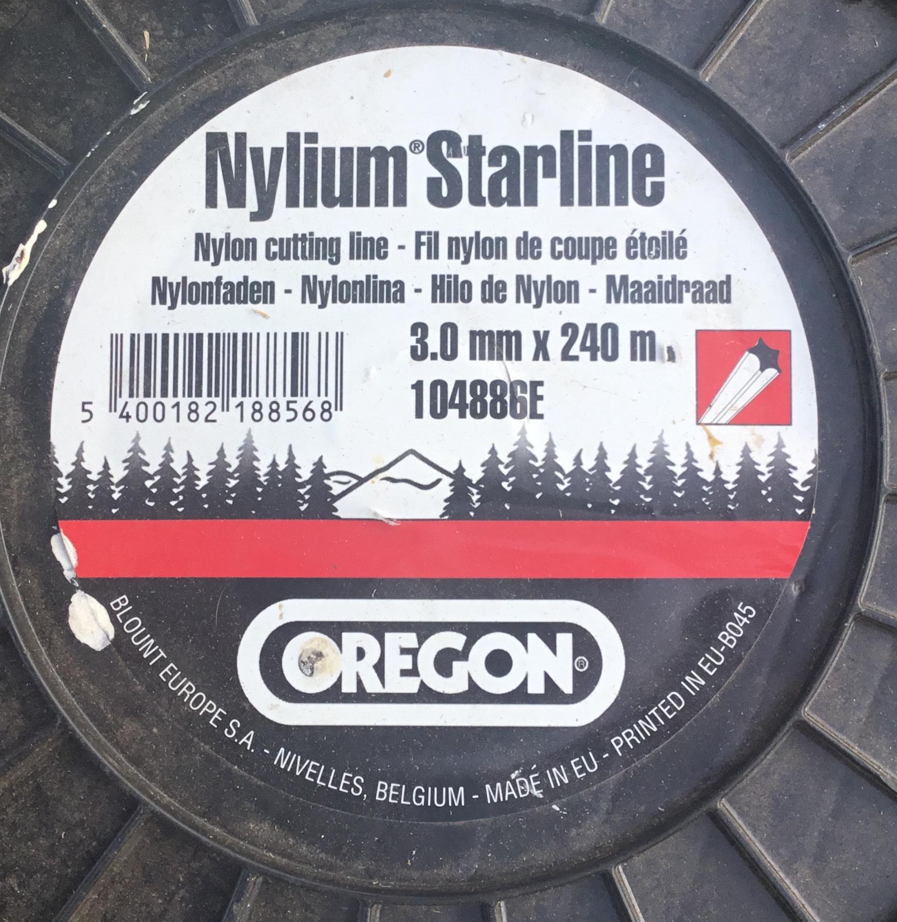

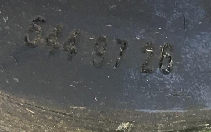

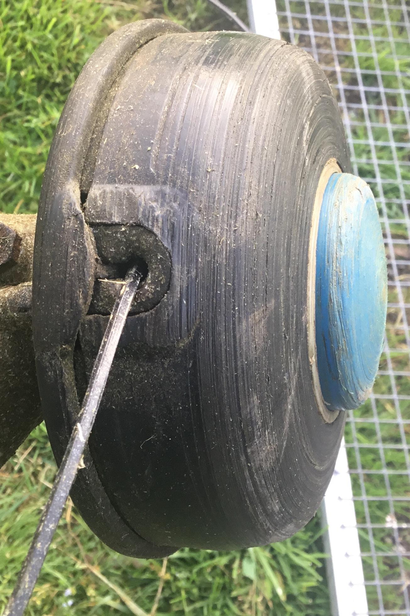

Cpd Posted August 25, 2019 Share Posted August 25, 2019 I got a really good head for my husky strimmer, it’s been put through some serious work and is still going strong 4 years in. I know at the time I went into the shop I asked for a heavy duty head and the one he gave me lasted a few weeks....... he admitted he had given me the wrong one and gave me the upgrade at no charge. Some identification marks...... and the best line I have found so far. As you can see from the head it’s got no damage to the holes and the plastic is wearing well for the abuse I put it through. 1 Link to comment Share on other sites More sharing options...
Temp Posted August 25, 2019 Share Posted August 25, 2019 That line get pretty good reviews on Amazon, I'll have to give it a go. Link to comment Share on other sites More sharing options...
