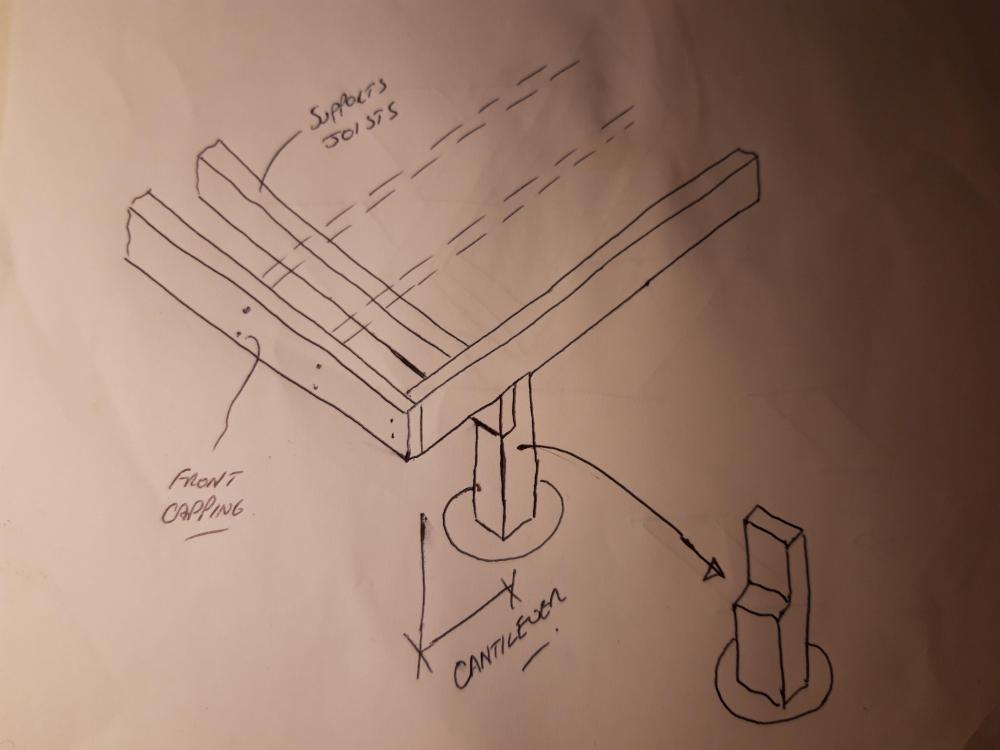

zoothorn Posted September 9, 2019 Author Posted September 9, 2019 On 06/09/2019 at 09:31, Russell griffiths said: Can you do a sketch from above and one from the side showing height difference, from lower to higher pads, you might not need any hangers, in fact they might stop you gaining height you need. This is the idea my chap sketched. This is the base four beams (my shed perimeter walls ontop of these). No.4 is lying flat: ontop of this he suggested joists running from beam no.3 > across beam no.4...... & onward a bit too (as much as I can, for a walky bit this extra bit). The joists [not yet shown] will go in & attatch most critically via joist hangers @ beam 3 (where my series of 'o' zits & '>' arrows are), & to the flat beam no.4. 2x 85cm H full sleeper thickness, for ontop of lower 2x plinths & up. 85cm is the difference in height between lower two plinfs & upper two. Thing is I can't see what beam I can my that's ~3.4m long. The hardwood ones are 2.4m long.
PeterW Posted September 9, 2019 Posted September 9, 2019 I’d go the other way with the infil joists and hang them off the side rails. You can work from the “hill” side so less to wave around and then board and joist as you go. Use 6x2 tanalised timber with timber hangers and you won’t go far wrong.
zoothorn Posted September 9, 2019 Author Posted September 9, 2019 24 minutes ago, PeterW said: I’d go the other way with the infil joists and hang them off the side rails. You can work from the “hill” side so less to wave around and then board and joist as you go. Use 6x2 tanalised timber with timber hangers and you won’t go far wrong. Hi PeterW- so you'd go joists from beams no.1 to no.2 instead you mean?
Declan52 Posted September 9, 2019 Posted September 9, 2019 46 minutes ago, zoothorn said: Hi PeterW- so you'd go joists from beams no.1 to no.2 instead you mean? Yes the span will be less.
zoothorn Posted September 9, 2019 Author Posted September 9, 2019 9 minutes ago, Declan52 said: Yes the span will be less. But that means the cantilever'd extra area (walky bit RHS), over & onwards past beam no.4, won't happen tho.
Russell griffiths Posted September 9, 2019 Posted September 9, 2019 No 4 cannot lay flat like that, no strength in it flat, needs to be stood up and beams cantilevered over the top of it.
andyscotland Posted September 9, 2019 Posted September 9, 2019 4 minutes ago, zoothorn said: But that means the cantilever'd extra area (walky bit RHS), over & onwards past beam no.4, won't happen tho. Yes it will, beam 1 &2 don't change length, you just hang the joists from the sticky-out bit of them. Would also mean beam 4 could be vertical so do a better job of holding 1&2 together and stopping them twisting.

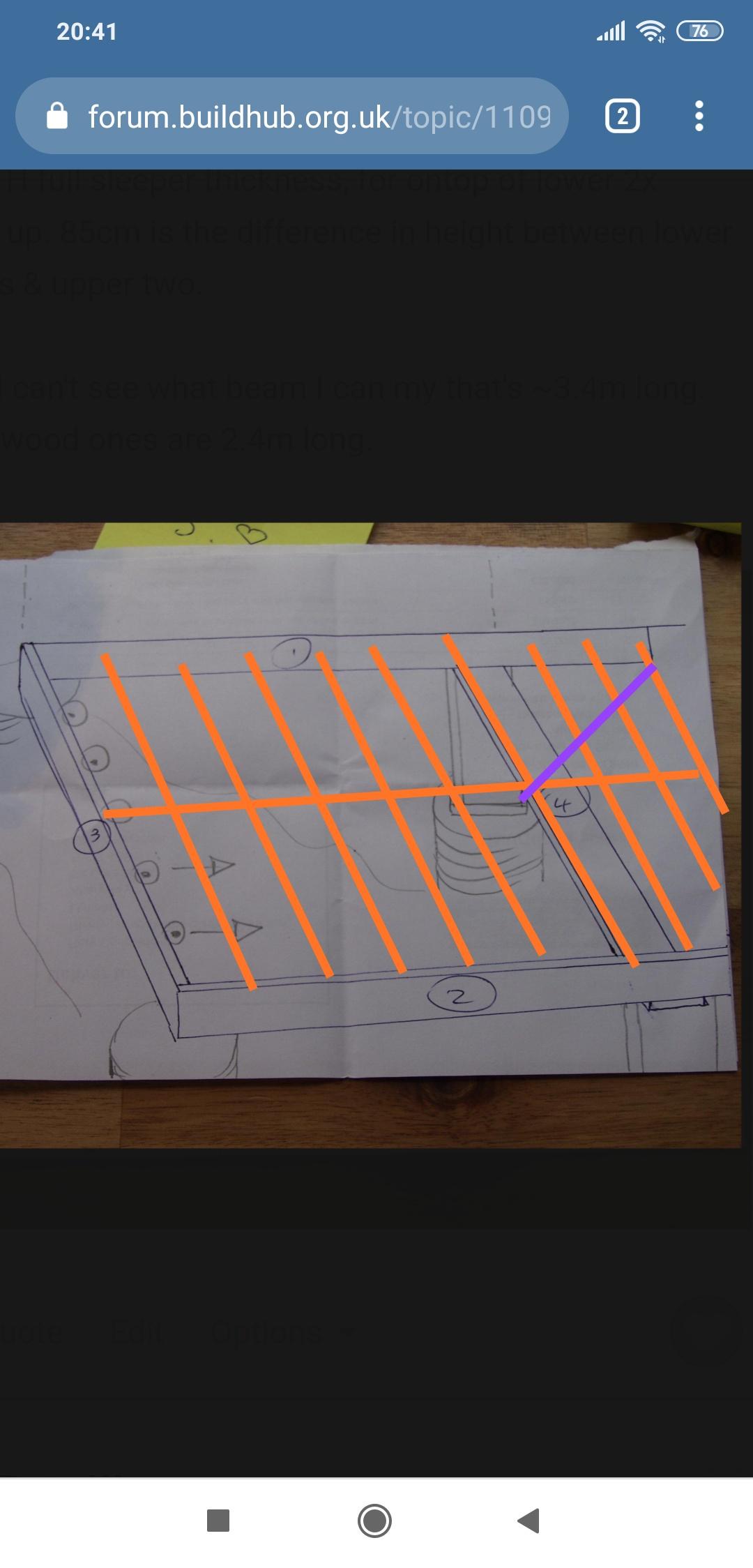

Declan52 Posted September 9, 2019 Posted September 9, 2019 4 minutes ago, zoothorn said: But that means the cantilever'd extra area (walky bit RHS), over & onwards past beam no.4, won't happen tho. Why not??? Put them in like this on the pic. If your worried about the strength of beam 1&2 then double it up. Or put a diagonal brace like the purple line on the pic. The line down the middle are your noggins.
PeterW Posted September 9, 2019 Posted September 9, 2019 Thanks @Declan52 that is exactly what I was trying to describe...! @zoothorn a cantilevered 6x2 will comfortably take the load of a deck you’re talking about here for a metre or so - add a couple of angled supports down from the edge to the posts too and it will be even stronger.
zoothorn Posted September 9, 2019 Author Posted September 9, 2019 @Declan52 ah ok I'm on board.. thanks for that sketch. I guess then I can do a proper ~1m walky bit then (& put up ballastrade whatnots in time) if not constrained by the cantilever'd addition. Ok so how about the joists @ 400mm centres, C'tex in between etc below cabin area.. is this the right idea? I'll get C'tex in the roof probably even if only 25mm, & as the back 's unseen I can maybe go 50mm (on the outside.. if I can think how to attatch, & cover/ clad etc: not on the inside as space is priority). Sides & door/ front.. tricky tho.

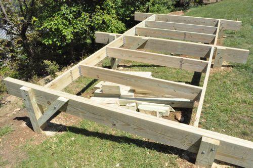

Onoff Posted September 9, 2019 Posted September 9, 2019 Food for thought. Loads of ideas on Pinterest (free to join).
zoothorn Posted September 9, 2019 Author Posted September 9, 2019 That's a useful pic. gives me a rough idea. Pininterest? what on earth does that mean?

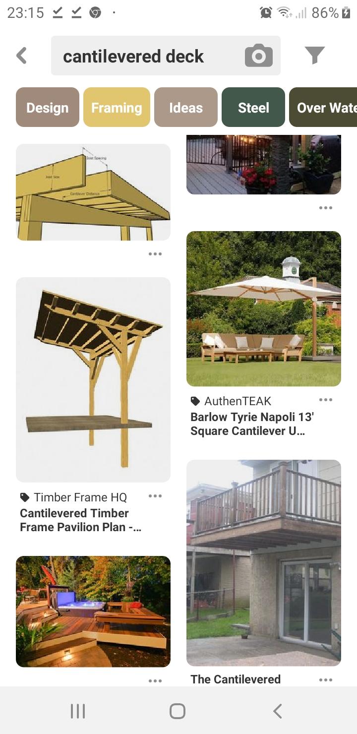

Onoff Posted September 9, 2019 Posted September 9, 2019 Just playing around... 6 minutes ago, zoothorn said: That's a useful pic. gives me a rough idea. Pininterest? what on earth does that mean? Just go to pinterest.com create a free account or get the app from the Playstore etc. An absolute mass of ideas and projects on any subject. I searched "cantilevered deck" for example: You get the odd ad thrown in. Tried "diy guitar amplifier":
