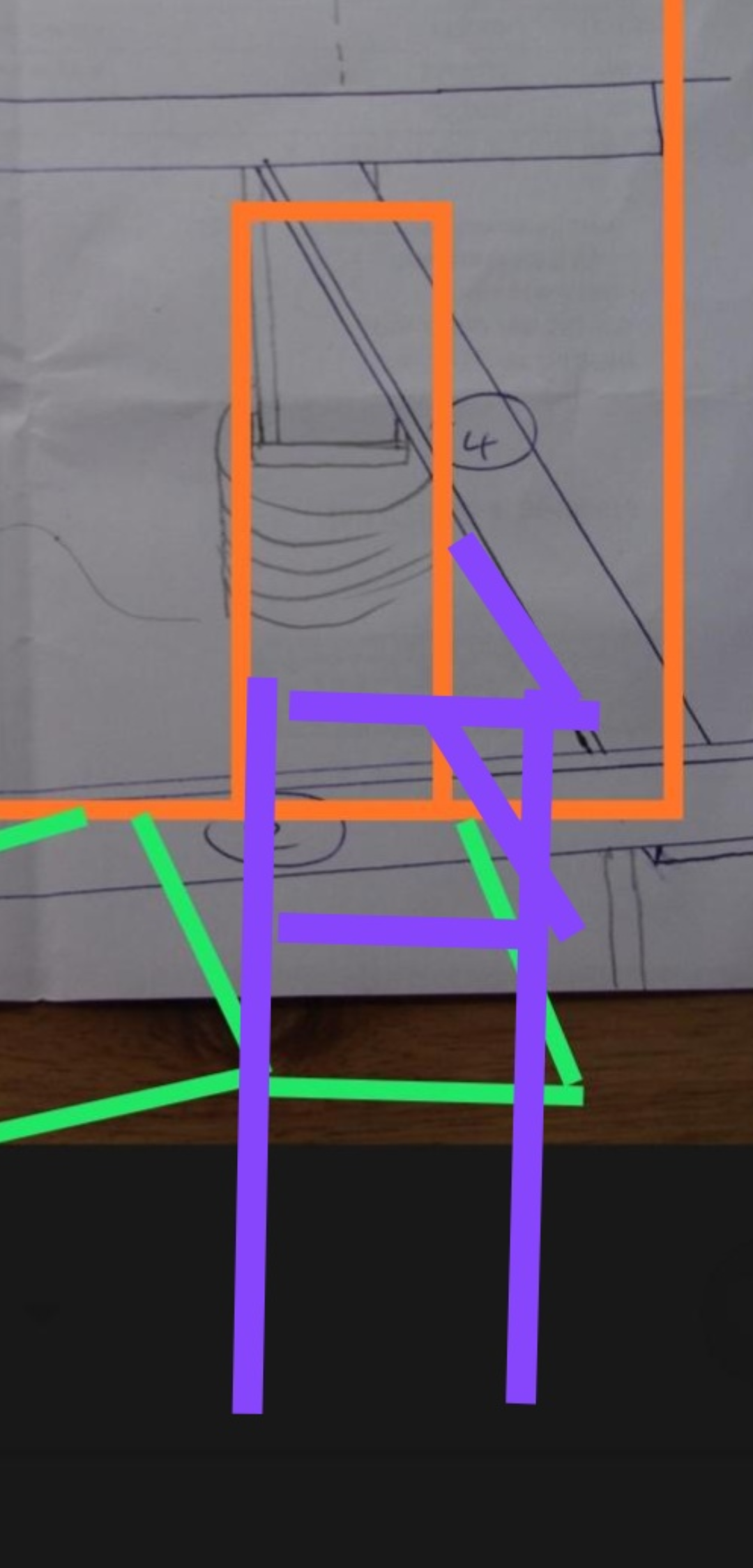

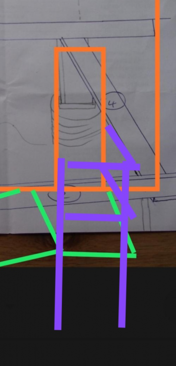

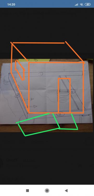

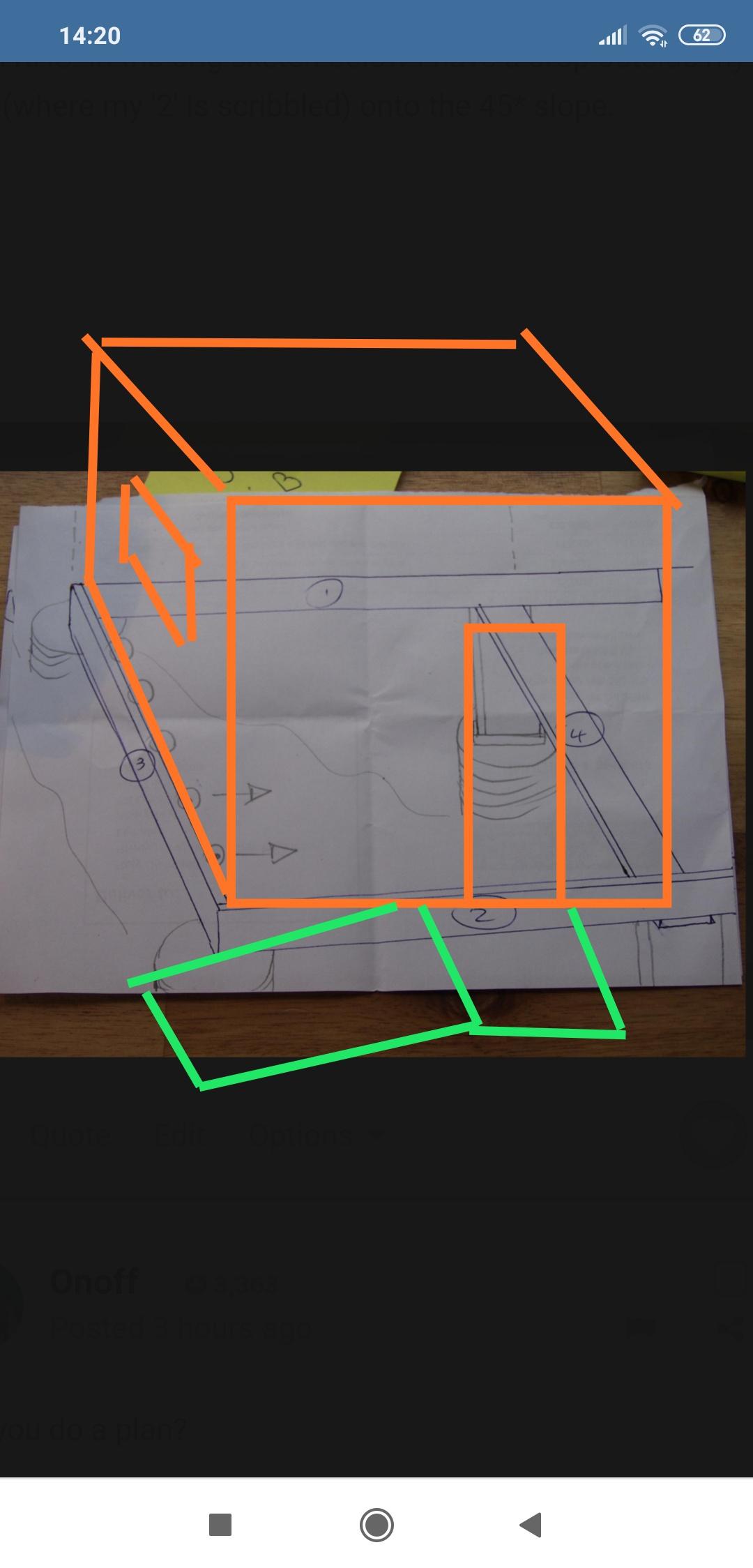

zoothorn Posted September 16, 2019 Author Share Posted September 16, 2019 Hi chaps- took wknd away/ just seen replies. Sorry for confusion. I add my sketch again. Beam numbers 1,2,3,4. The idea has been the cantilevered +20% or so walky area to be added RHS @ lower two pillars' side. This was/ & always will be the RHS -side- of cabin, next to & parallel to stream below. But the front of cabin, door etc(facing down gdn to house) then has no terrace/ balcony. As I'll obviously need a front terrace area (I cant just step out of door ~4ft splat) should the added walky cantilevered section instead go on the FRONT I'm wondering now? (IE extending beams 3 & 4 forwards, instead of extending beams 1 & 2 twds rhs as per the orig sketch below). Beam 2 is always the cabin FRONT. Beam 4 is always the cabin RHS. In the orig sketch below I have a drop outside my door (where my '2' is scribbled) onto the 45* slope. Link to comment Share on other sites More sharing options...

Declan52 Posted September 16, 2019 Share Posted September 16, 2019 Just draw it out with a pencil and a ruler and take a pic with your phone and post it. We are not looking a work of art just a bit of a better idea on how you intend it to look so we can help you get there a bit easier. Link to comment Share on other sites More sharing options...
zoothorn Posted September 16, 2019 Author Share Posted September 16, 2019 2 hours ago, Declan52 said: Just draw it out with a pencil and a ruler and take a pic with your phone and post it. We are not looking a work of art just a bit of a better idea on how you intend it to look so we can help you get there a bit easier. B but thats what I do! takes me hours to draw & photo it (dont have phone w'pics, only an sLr you see/ faff). Ok for the mo, let's just say I build a square 2.3m frame > cabin on. I'm standing down gdn looking at front/ door of it. I have 2 plinths in front of me: the LHS on's on the upper slope, RHS one's on the down slope, ~1m pillar. So I have a L>R ground discrepency of ALOT. I need to have a decking area in front of the thing (or I open door & fall out, hit slope & roll down R into stream crying, & I shouldnt wonder if my trousers dont fall down as well). I need 1.2m deck here min. Do I add as an -afterthought- IE build it separately later? (& should I even add this side walky area into the mix? is a separate Q) or add the walky extra area to the --front-- instead of the RHS? Does that help for now? Link to comment Share on other sites More sharing options...
Declan52 Posted September 16, 2019 Share Posted September 16, 2019 Is this what u have in mind???? Link to comment Share on other sites More sharing options...
zoothorn Posted September 16, 2019 Author Share Posted September 16, 2019 @De 2 hours ago, Declan52 said: Hi Declan- bingo that's it.. even window's correct LHS (stream is opposite, RHS, & n'bors too). Very grateful for that. Ok this green front area is what I'm considering at the mo: I'm obviously gonna need a deck here. I have 3 options afaict. 1) Swizzle the cantilever area round to the frontside forming my front deck/ not sticky-outy out RHS. 2) Keep cantilevered walky bit as planned (on RHS, orig idea).. & build a separate front deck later. 3) Ditch the cantilever altogether, make a 2.3m square base.. & build separate front deck later. Link to comment Share on other sites More sharing options...

Declan52 Posted September 16, 2019 Share Posted September 16, 2019 Option 2. Build the deck and put the shed on. This will give you the door position. Then you can use 2 3*3/4*4fence posts to give you both something for the deck to attach on plus will give you enough height to let you form some sort of bannister to stop you falling into the stream. Dig 2 holes drop the posts in and put a bag of postcrete into each hole with some water. Plumb the posts and leave to set. So it will look like this. Link to comment Share on other sites More sharing options...
Declan52 Posted September 16, 2019 Share Posted September 16, 2019 Or you could really go to town and have an overhang on both sides so you can walk round to your seating area without going into the cabin. This will be the more expensive option as not only will the timber joists need to be longer but you will need more of whatever you where going to use as a barrier to stop kids falling into the stream. Link to comment Share on other sites More sharing options...
zoothorn Posted September 16, 2019 Author Share Posted September 16, 2019 @Declan52 yes I think 2. But you see if I leave the cantilevered area RHS too, I'll need access to it.. so its got to protrude forwards, & join the front "green area" deck somehow. This is the problem with 2. This is why you see I'm thinking the RHS walky area is actually problematic (unuseable as it is?), &, the obvious thing if I'm ditching it RHS.. is instead to have it coming out frontwards. Link to comment Share on other sites More sharing options...
