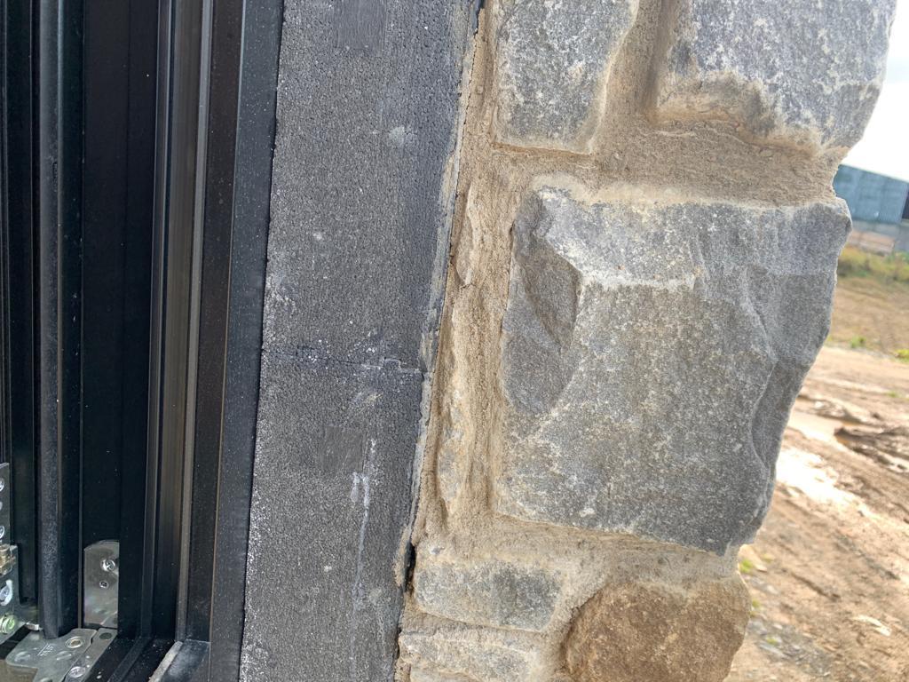

magnethead Posted August 23, 2019 Share Posted August 23, 2019 Hi, I would like to hear your opinions on what way to do the Windows and Door on an ICF house with Stone facing. Here are some examples below. In this example below the windows are kept back behind the 100mm exterior insulation But this leave an EPS reveal!! up above, the EPS is painted with a TT rubberized membrane and the Lintel is powdercoated black. I understand the guy about, he has a 25mm nib all around the reveal to which the window frame is bonded too, but I believe it won't look the best. I was thinking to bring the stone into the reveal like in the below, but was worried I might not get a good enough seal to the window frame/stone, Link to comment Share on other sites More sharing options...
BotusBuild Posted August 23, 2019 Share Posted August 23, 2019 Will be doing something similar so interested in the responses. Personally, I would be seeking to have the stone face and window fitting meet up. Probably need a flexible seal between the two, so just need to make the stone edge as straight as possible I guess. It's what you use for that flexible seal that I guess is the key. Link to comment Share on other sites More sharing options...

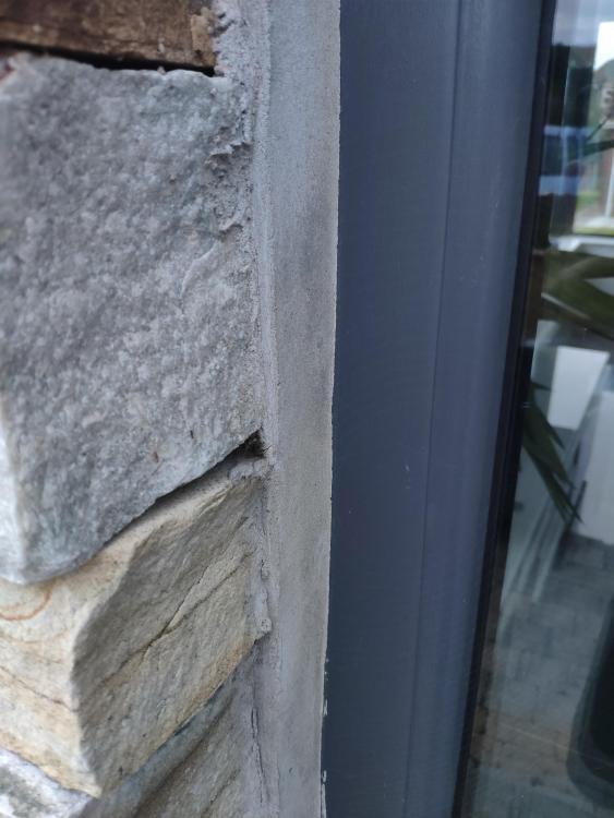

magnethead Posted September 16, 2019 Author Share Posted September 16, 2019 Here's how the above finished up, I leave an EPS reveal that needs to be protected, I think this guy is going to use metal sheeting. I'm after the stone facing right up to the window, so I'm going to cut the little nib at the front and move the windows flush with the outside EPS face, (See attachedhow another guy has just run the cement up against the PVC face) Link to comment Share on other sites More sharing options...

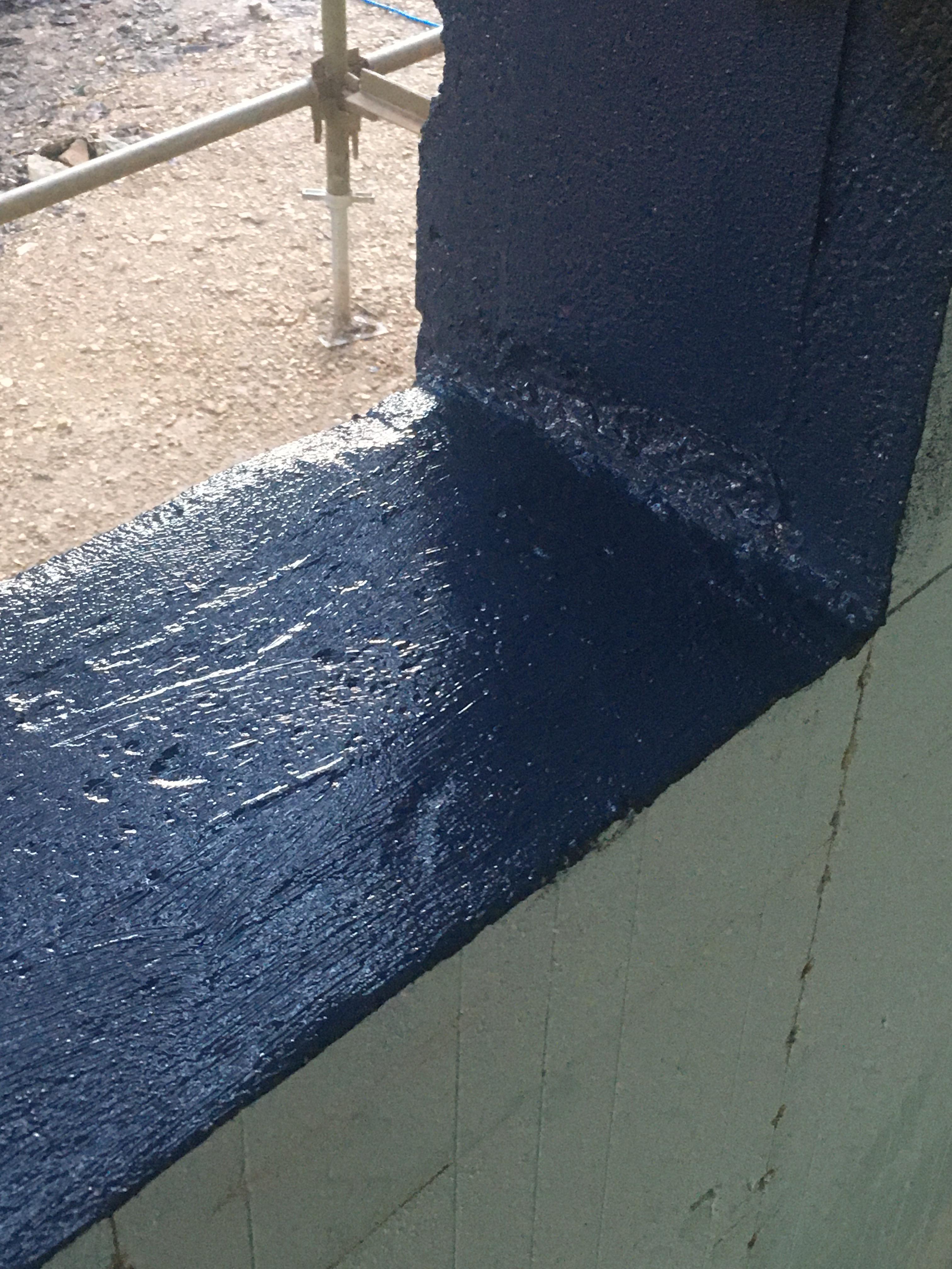

magnethead Posted February 11, 2020 Author Share Posted February 11, 2020 (edited) Just to continue this, This is my plan so far to seal up the windows and doors. Please drop some comments if you see an area to be improved, something I should do differently. I Put some supports under the windows and doors even though I was told it's not necessary and that the foam would carry the load. I love overkill anyway. you can see some backer rod sticking out here on the right side Some close up and the upper window @BotusBuild Any luck with your detailing of the stone face? Do you know which way you are going with it. Even though it says this Feltrim 2 tape can be plastered over with sand/cement, the data sheets says to leave about 15mm of tape on the frame not covered in concrete/plaster. Does anyone know a better tape that can be completely covered? Thanks Edited February 11, 2020 by magnethead Link to comment Share on other sites More sharing options...

Russell griffiths Posted February 11, 2020 Share Posted February 11, 2020 (edited) I am just fitting my windows and decided I wanted to avoid any window tape as I thought it looked a right pain, on the advice from NORSKEN windows I have used a system made by TREMCO ILLBRUCK it is a two part process first you use there airtight foam FM330 if I remember correctly, you let this dry and trim it back flush, you then use an air sealing paste that comes in a tube, you squirt this all over the foam just like silicon. However the clever bit is it has a very low viscosity so you get a 20mm wide paint brush and pull it gently down so it spreads all over the foam, you can get your finger in the corners and smooth it out, you can brush it all around the brackets making a complete seal. I am very very very impressed with the product and the reduced cost compared with tape. I am generally a hard arsed very hard to please bloke, but i am seriously impressed with this stuff. I think i have spent £220 on sealing up all my windows, and they are huge, my average window is 2.6 wide by 1.8 high so a fair distance around them. Edited February 12, 2020 by Russell griffiths 1 2 Link to comment Share on other sites More sharing options...
willbish Posted February 11, 2020 Share Posted February 11, 2020 Sounds good @Russell griffiths Did you paint blowerproof liquid all around your reveals prior to installing your windows? Seems counterintuitive to make an airtight seal onto EPS which is not airtight Link to comment Share on other sites More sharing options...
Russell griffiths Posted February 12, 2020 Share Posted February 12, 2020 (edited) 21 hours ago, willbish said: Sounds good @Russell griffiths Did you paint blowerproof liquid all around your reveals prior to installing your windows? Seems counterintuitive to make an airtight seal onto EPS which is not airtight I have given all the reveals 2 counts of solvent free waterproof and gas proof type paint. Edited February 12, 2020 by Russell griffiths Incorrect wording of a product. 1 Link to comment Share on other sites More sharing options...

ToughButterCup Posted February 12, 2020 Share Posted February 12, 2020 1 hour ago, Russell griffiths said: I have given all the reveals 2 counts of solvent free waterproof bituminous type paint. Now you tell me. Late, as usual Russ. Phhhhh..... Quote you then use an air sealing paste that comes in a tube, you squirt this all over the foam just like silicon. Do you have a trade name for that paste? Link to comment Share on other sites More sharing options...
magnethead Posted February 12, 2020 Author Share Posted February 12, 2020 If I had a time machine, I would go back and use this product , Building science says cavity is the best defense against leaks https://www.surecav.co.uk/ Link to comment Share on other sites More sharing options...
scottishjohn Posted February 12, 2020 Share Posted February 12, 2020 maybe just me but anything bituminous is made from oil --so you sure it will have no long term effect on foam? can,t see how it can be totally solvent free? acryilic based stone chip as used on cars --is solvent free and paintable the test to me would be if you can paint it if it don,t like it and melts --then it has a some solvent me i will be having windows just covering it and overlapping stone work by small amount+ flexible sealer at join 1 Link to comment Share on other sites More sharing options...
Russell griffiths Posted February 12, 2020 Share Posted February 12, 2020 @scottishjohn you are spot on with your bitumin comments. I have been working all day fretting that I had written the wrong word in my post and nearly came home half way through the day to edit it. So my previous post had said I used a bituminous paint to seal my icf reveals. THIS IS INCORRECT i used a water based waterproof and gas proof paint, it is completely safe on eps whereas bitumen or any solvent based product must not be used. Please check the compatibility of a product before you install it. Link to comment Share on other sites More sharing options...

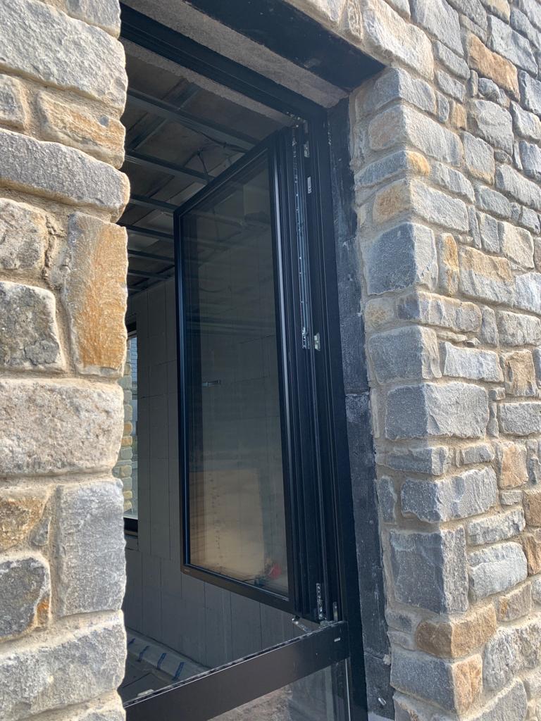

magnethead Posted March 2, 2020 Author Share Posted March 2, 2020 (edited) Thanks @Russell griffiths I was actually making a doppy mistake, I had being using a 6mm bit with the helical ties and they were getting bent to bit and destroying the wall insulation as I was trying to insert.....Once I started using the 6.5mm bit everything was a lot easier ? so just to finish off my input, this is the way I had to go in the end....Metal lad onsite swopped in and saved the day, by taking the lintels off me last minute and wrapping them in zinc. It's a very bad picture below for some reason (camera didn't pick up the shiny silver polished finish on the underside of the lintels.) This picture was taken before I passivated the welds. you can see here how they brought the stone up to the edge of the SIGA tape, and they are not going to point the edges here. you can see at the bottom here, that the zinc is wrapped at the grey edge of the zinc around the dripped edge of the lintel, it's also bends down 90 degrees at the back of the stone by about 10mm. Used a load of X-tack, instant bond adhesive Very very happy with the results, natural stone does it for me !! Feel free to critique any of the details, I was just doing a best effort as I couldn't locate enough details online for this type of thing Edited March 2, 2020 by magnethead Link to comment Share on other sites More sharing options...
Russell griffiths Posted March 2, 2020 Share Posted March 2, 2020 Looks spot on @magnethead questions. What make is the black dpm you have painted on ?? and what is the silicon type stuff you are using and how well does it stick. I’m finding it increasingly hard to find anything to stick to this icf. Link to comment Share on other sites More sharing options...
Declan52 Posted March 2, 2020 Share Posted March 2, 2020 What kind of stone is that?? Looks very similar to the Donegal quartzite that I used from mcmonagle. Link to comment Share on other sites More sharing options...
