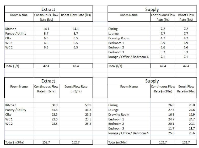

gc100 Posted August 22, 2019 Share Posted August 22, 2019 Hi, Probably a dumb question but can I install the MVHR rather than using an installer? I know building control want details of the MVHR being used but does that mean I need to use an official installer? I'm looking at a quote of £8,744 + VAT from the installer: 1 x Zehnder ComfoAir Q 350- MVHR unit 2 x ComfoWell Manifolds (including sound attenuators) Radial Pipework – Zehnder ComfoTube (smooth interior) 12 x Standard – Supply/Extract Lindab Airy Vents (round/metallic/white) 2 x External Wall Grilles Controllers – ComfoSense C67 remote display Labour & Commissioning From a rough online search the materials cost about £3000! unless I'm horribly mistaken but I don't think so. That leaves £5700 for the 'install and commissioning' Is there any reason I could not do it, or the builder for that matter? Link to comment Share on other sites More sharing options...

Jeremy Harris Posted August 22, 2019 Share Posted August 22, 2019 Commissioning is mainly getting the system balanced. There are a couple of airflow meters in the forum tool loan scheme for doing the flow measurement at each terminal. The process is a bit iterative, but really just needs patience, going around every ceiling terminal, measuring the flow rate and then adjusting it up and down to get the required extract rates from specified rooms (kitchen, bathroom, WC, utility, as in building regs), making sure the sum of the fresh air supply equals the sum of the extracts and also that the total background ventilation rate meets the figure in building regs. Forget about trying to run air conditioning via MVHR, the flow rate is way too low to make any useful difference. We have an MVHR that cools the air, but it's not very effective in warm weather at all. 1 1 Link to comment Share on other sites More sharing options...

gc100 Posted August 22, 2019 Author Share Posted August 22, 2019 3 minutes ago, JSHarris said: Commissioning is mainly getting the system balanced. There are a couple of airflow meters in the forum tool loan scheme for doing the flow measurement at each terminal. The process is a bit iterative, but really just needs patience, going around every ceiling terminal, measuring the flow rate and then adjusting it up and down to get the required extract rates from specified rooms (kitchen, bathroom, WC, utility, as in building regs), making sure the sum of the fresh air supply equals the sum of the extracts and also that the total background ventilation rate meets the figure in building regs. Thanks. How do you adjust the flow rates? Is this done in the plenums? Whats the difference between 'total background ventilation rate' vs ' total airflow in/out? 1 Link to comment Share on other sites More sharing options...
dnb Posted August 22, 2019 Share Posted August 22, 2019 (edited) Approved document F (a riviting bedtime read) containst the details of exactly how much ventilation is required and defines the terms. Remember that the A/C is recirculating the air within the house, and the MVHR is exchanging it with air from outside. So it's not a case of dual purposing all ducts. Some will only be required for one job. I will turn my house plan document into a simplified schematic (it's difficult to follow over 3 floors) to illustrate what I mean. There are some games to be played with summer bypass on the MVHR too. I should say my plan involves a Mitsubishi Electric 5kW ducted A/C unit and an MVHR unit. Edited August 22, 2019 by dnb Link to comment Share on other sites More sharing options...
Jeremy Harris Posted August 22, 2019 Share Posted August 22, 2019 Just now, gc100 said: Thanks. How do you adjust the flow rates? Is this done in the plenums? Whats the difference between 'total background ventilation rate' vs ' total airflow in/out? Adjustment depends on the parts chosen. Ours uses throttle plates fitted in the distribution plenums to throttle down each duct, other systems may use adjustable ceiling terminals. Adjustable ceiling terminals may possibly be slightly noisier, as the flow velocity ends up increasing, but they are a lot easier to adjust. The throttle plates are a PITA to adjust, but in theory reduce flow noise, because the local velocity increase they create is in the plenum chamber, so well away from the rooms. The total background rate often dominates, and is the rate that the system needs to deliver when on its normal setting. The total airflow in and out should be equal and can either be the background rate or any other setting. In addition, the system needs to be able to achieve the required extract rates for the kitchen, bathrooms, WC and utility room. Often this rate may be met in background ventilation mode. 1 Link to comment Share on other sites More sharing options...

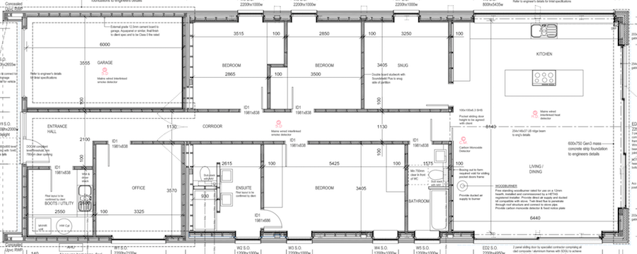

joth Posted August 23, 2019 Share Posted August 23, 2019 The garage would not normally be recommended place for the MVHR as it's outside the thermal envelope: it works more efficiently to have it inside the envelope. 1 Link to comment Share on other sites More sharing options...
joth Posted August 23, 2019 Share Posted August 23, 2019 13 hours ago, gc100 said: That leaves £5700 for the 'install and commissioning' Fwiw I'd first look into doing the install DIY as that's the bulk of the cost and very easy to learn to do, then get in someone experienced to commission it. Green building store recommend this approach (saying DIY install is often better than paying e.g. a builder to do it, as generally the DIYer will take their time and follow the design more accurately) There's certainly an argument for learning to do the commissioning so you can maintain and adjust it if needed in future too, but for for a few hundred pounds I'd prefer to know it was at least initially all running correctly. Link to comment Share on other sites More sharing options...
gc100 Posted August 23, 2019 Author Share Posted August 23, 2019 (edited) Yes makes sense indeed thanks. I suspect finding someone willing to commission/check it over as its just the installers who do this so can't see them being motivated. However I think I'll have to end up doing it, as the labour rate is just too crazy. If only I could do the same for the ASHP!! Edited August 23, 2019 by gc100 Link to comment Share on other sites More sharing options...
joth Posted August 23, 2019 Share Posted August 23, 2019 On a sample of 2, Green building store and Enhabit were both very happy to quote for design, supply and commissioning. Neither seemed particularly interested in doing the install work. If you have a radial topology the install is very simple. However looking at you linear layout a trunk and branch might be more efficient. Still not terribly complex to install from what GBS said. 1 Link to comment Share on other sites More sharing options...
