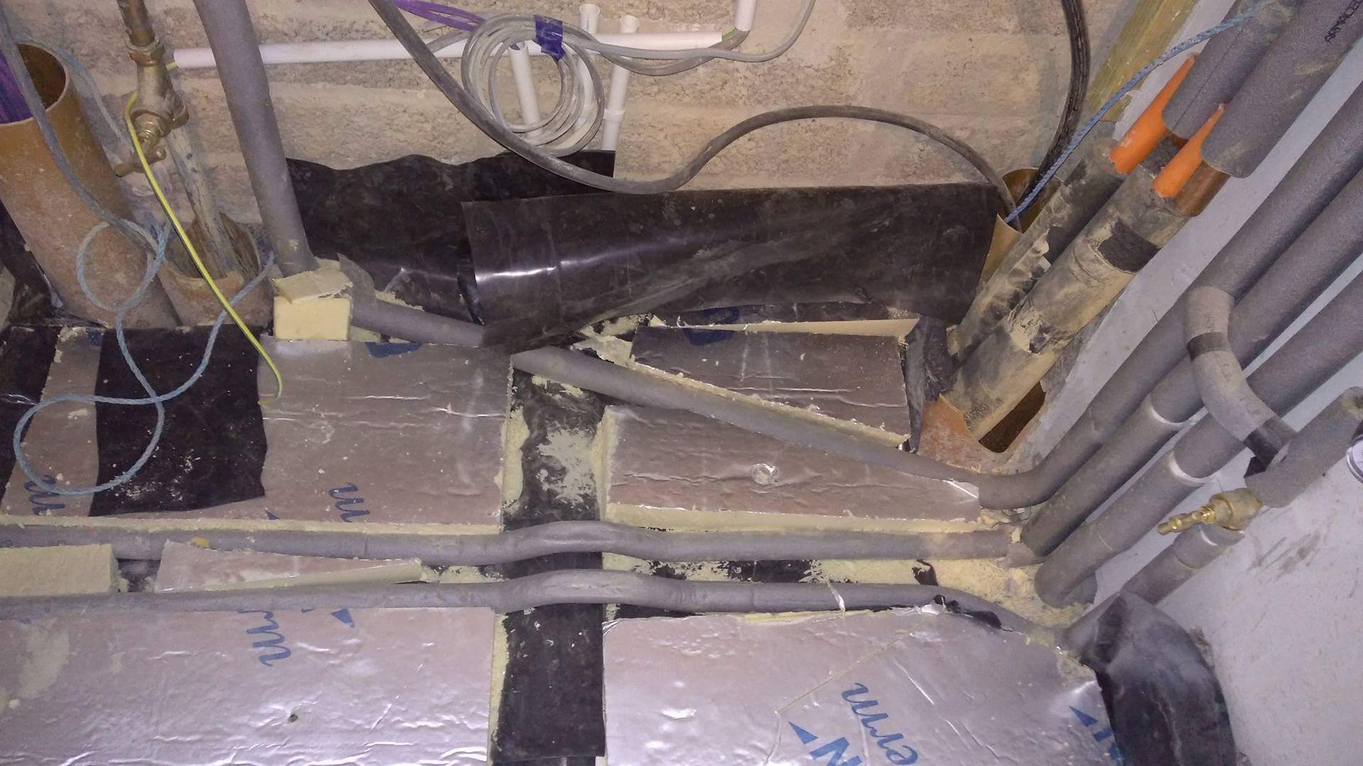

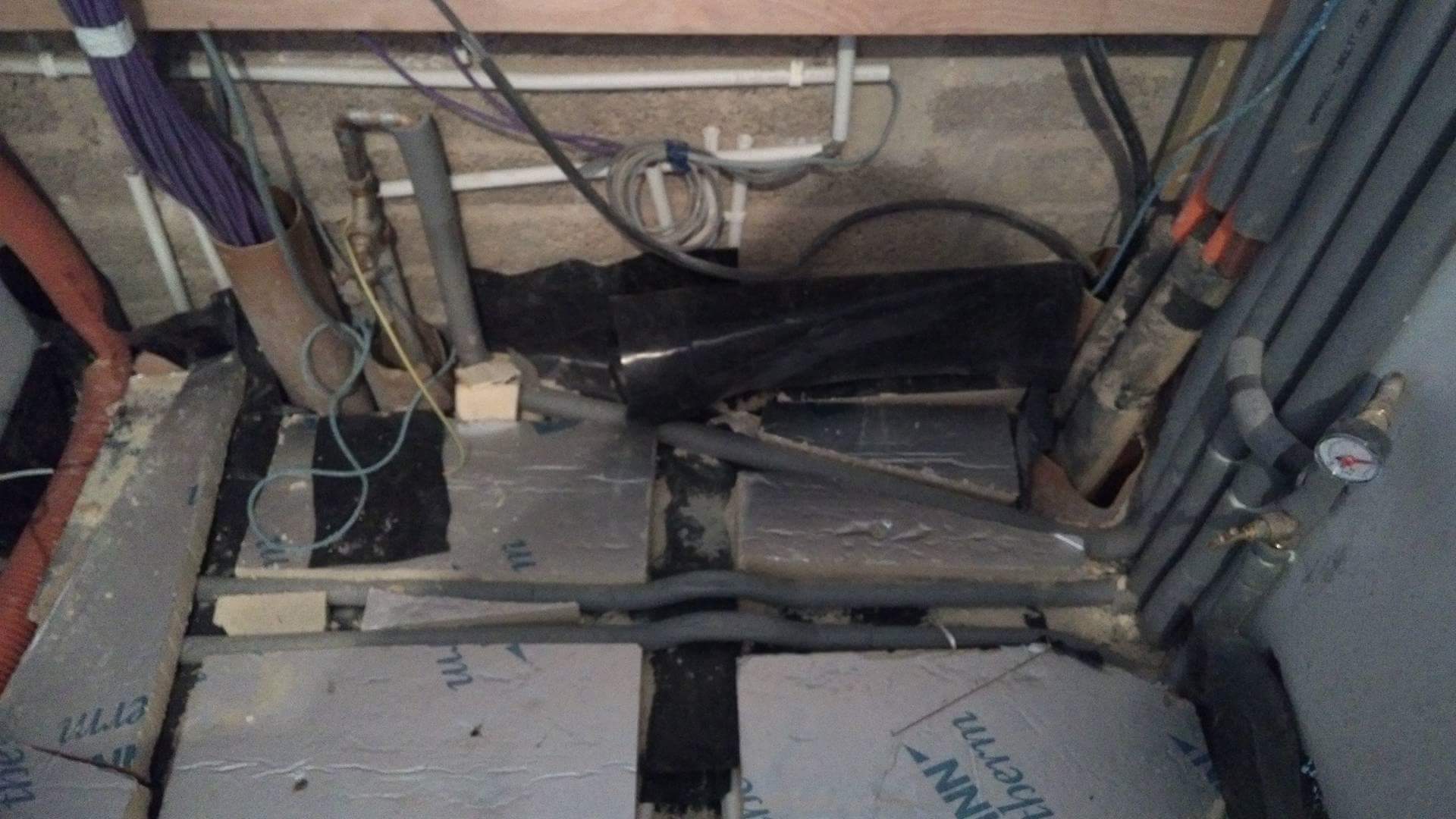

Shell820810 Posted October 1, 2016 Author Share Posted October 1, 2016 @Nickfromwales found some photos from before floor went down Link to comment Share on other sites More sharing options...

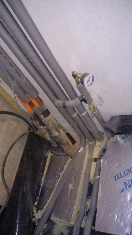

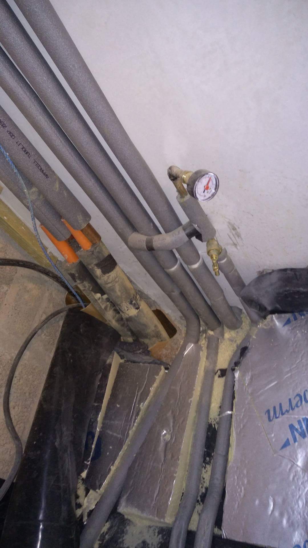

Nickfromwales Posted October 1, 2016 Share Posted October 1, 2016 1 minute ago, Declan52 said: Just a case of elimination. Is your stopcock under a sink and is its pressure ok. See the pics Can I see a side view, close up, of the left hand stopcock. And also a clear pic of that pressure gauge as it is now. Ta. Link to comment Share on other sites More sharing options...

Nickfromwales Posted October 1, 2016 Share Posted October 1, 2016 I've squinted at the pics a bit more, and it looks like a 25mm x 22mm stopcock to the left. Is that right? Link to comment Share on other sites More sharing options...

Onoff Posted October 2, 2016 Share Posted October 2, 2016 (edited) Slightly off track but is that the way it's done normally ref running pipes in the floor? I mean the way the PIR has been roughly channelled then normal pipe insulation used? My goto not knowing otherwise was to carefully V everything and replace when the pipes were in then foil tape over the top: Edited October 2, 2016 by Onoff Link to comment Share on other sites More sharing options...

Shell820810 Posted October 2, 2016 Author Share Posted October 2, 2016 (edited) Just checked the outside tap, two 25l drums almost filled in 1 minute. Will check on pipe sizes and stopcock. The pressure gauge has been taken off, it was only on when first fix plumber was testing for leaks. Material list attached with quantities of pipe sizes etc Edited October 2, 2016 by Shell820810 Link to comment Share on other sites More sharing options...
