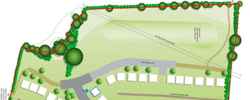

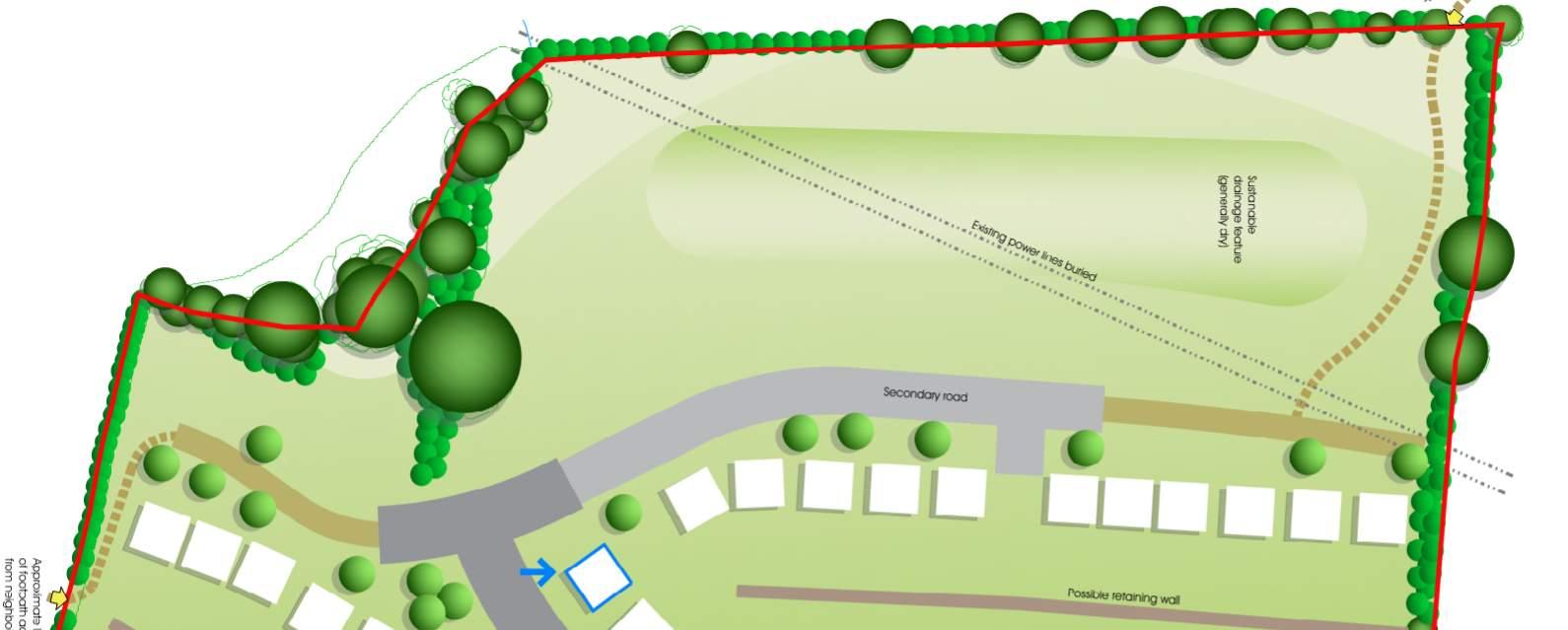

Ferdinand Posted August 21, 2019 Posted August 21, 2019 (edited) We have a new outline proposal for a housing estate nearby, and I will be making some comments - supporting principle but pointing out inadequate quality features in the scheme. This is a clip from the "Illustrative Master Plan". We all know how "illustrative plans" proposed at Outline without full compliance, somehow turn into the final plan and the non compliances can get forgotten about at Detailed. 1 - Is it normal to bury large 'lecky cables under a Balancing Pond in a housing estate? (These are *big* - they may be 33kV ,and serve thousands of people)? 2 - That looks a little close to the houses, assuming the brown road is about 5m wide. The scheme is not dissimilar to another one taken through planning nearby; not sure how the cables ended up there. Edited August 21, 2019 by Ferdinand
ProDave Posted August 21, 2019 Posted August 21, 2019 Cables can pass under rivers and streams (the 33KV underground line passes under our burn just upstream under our neighbours garden) so I don't see why not under a pond providing the depth is correct. There are minimum distances for building next to underground lines, I would have to look them up for 33KV but as long as the house is built greater than that distance from the underground line there is no problem. If choosing a house on that development I would be choosing one opposite the underground line, it would quite effectively prevent further houses being added the other side of the road. 1
Conor Posted August 21, 2019 Posted August 21, 2019 It's normal, as long min cover is maintained. If the utility company has an issue, they'll request for the developer to divert the lines (assuming they are existing power cables) 1

ProDave Posted August 21, 2019 Posted August 21, 2019 7 minutes ago, Ferdinand said: Thanks both. Still getting to grips with this. There is a certain amount of nice features that have a look of being designed to be taken out later - eg those nice permeable paths are quite emphasised, yet the people who own the land have not been approached. That is probably normal at Outline, but I have seen other developers salami slice backwards later. That sounds strange. While you can apply for PP on land you don't own, that would increase the land value so the owner would then want building plot price for the land, if indeed he agreed to sell. Normally there is some form of agreement with the land owner before applying for PP.
Ferdinand Posted August 21, 2019 Author Posted August 21, 2019 2 minutes ago, ProDave said: That sounds strange. While you can apply for PP on land you don't own, that would increase the land value so the owner would then want building plot price for the land, if indeed he agreed to sell. Normally there is some form of agreement with the land owner before applying for PP. Sorry. No - the people who own the land through which the proposed pedestrian pathways will run have not been approached.
