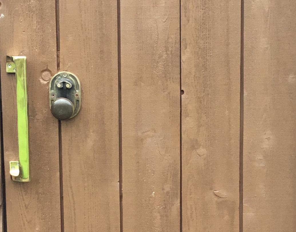

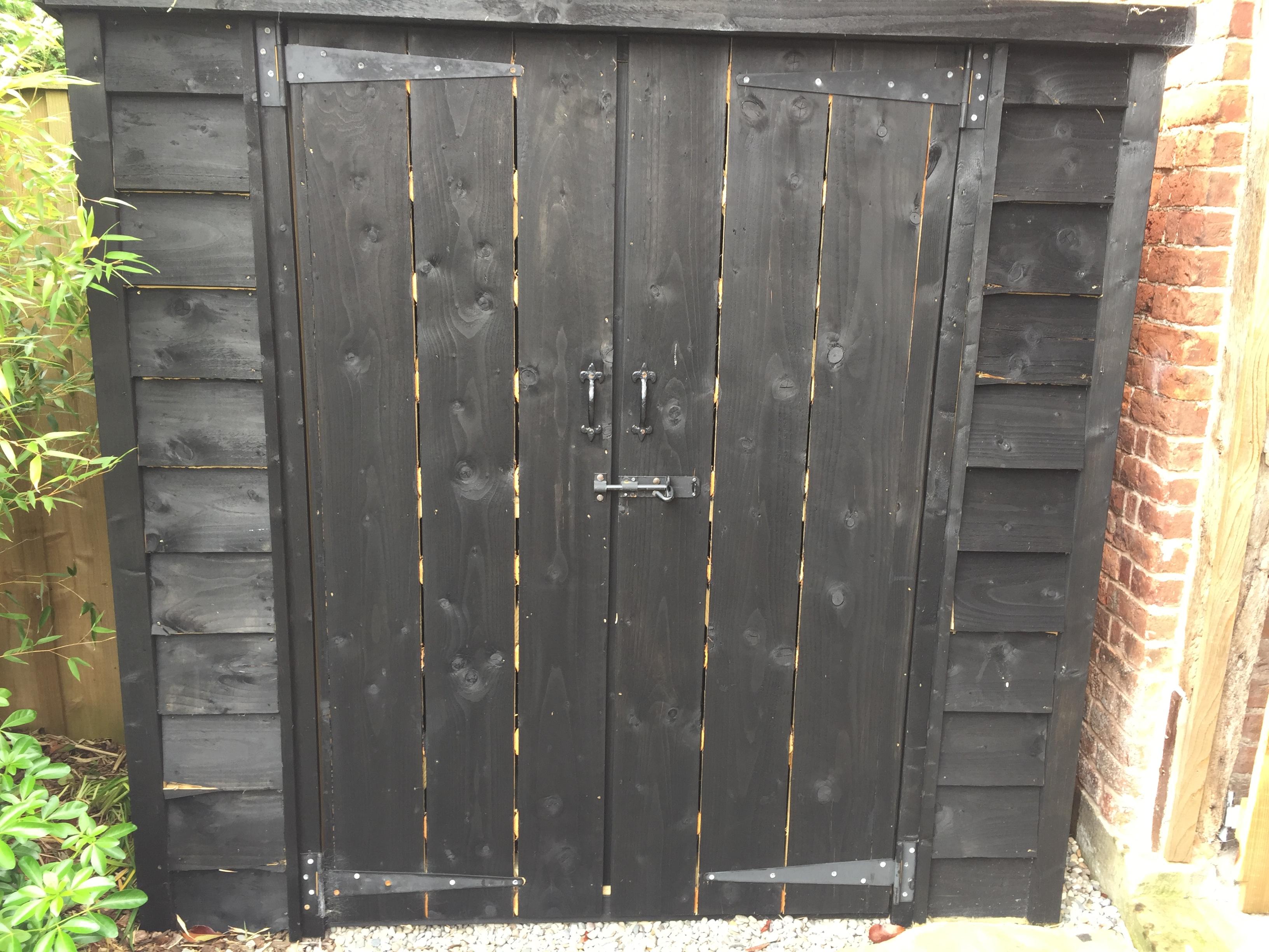

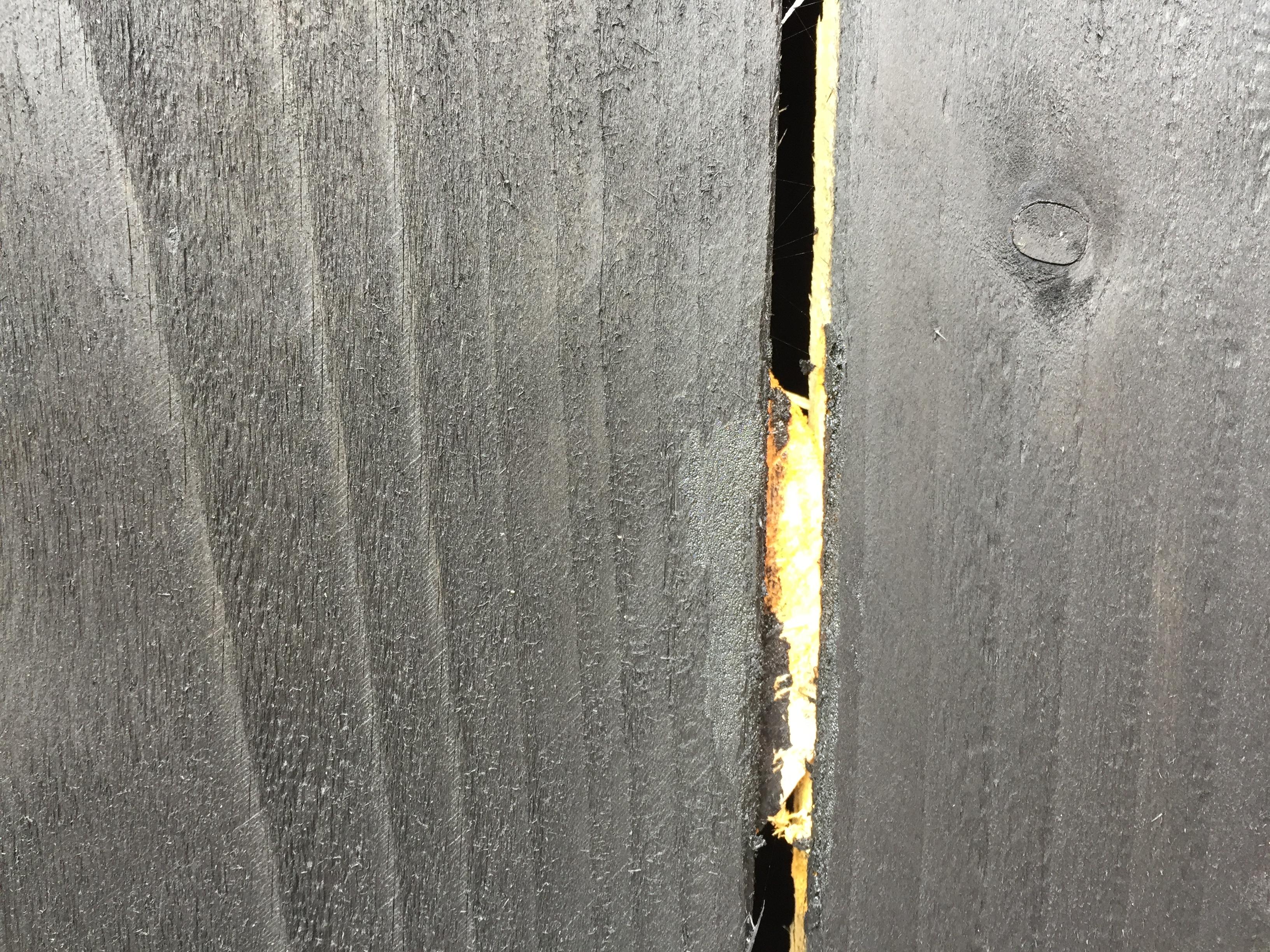

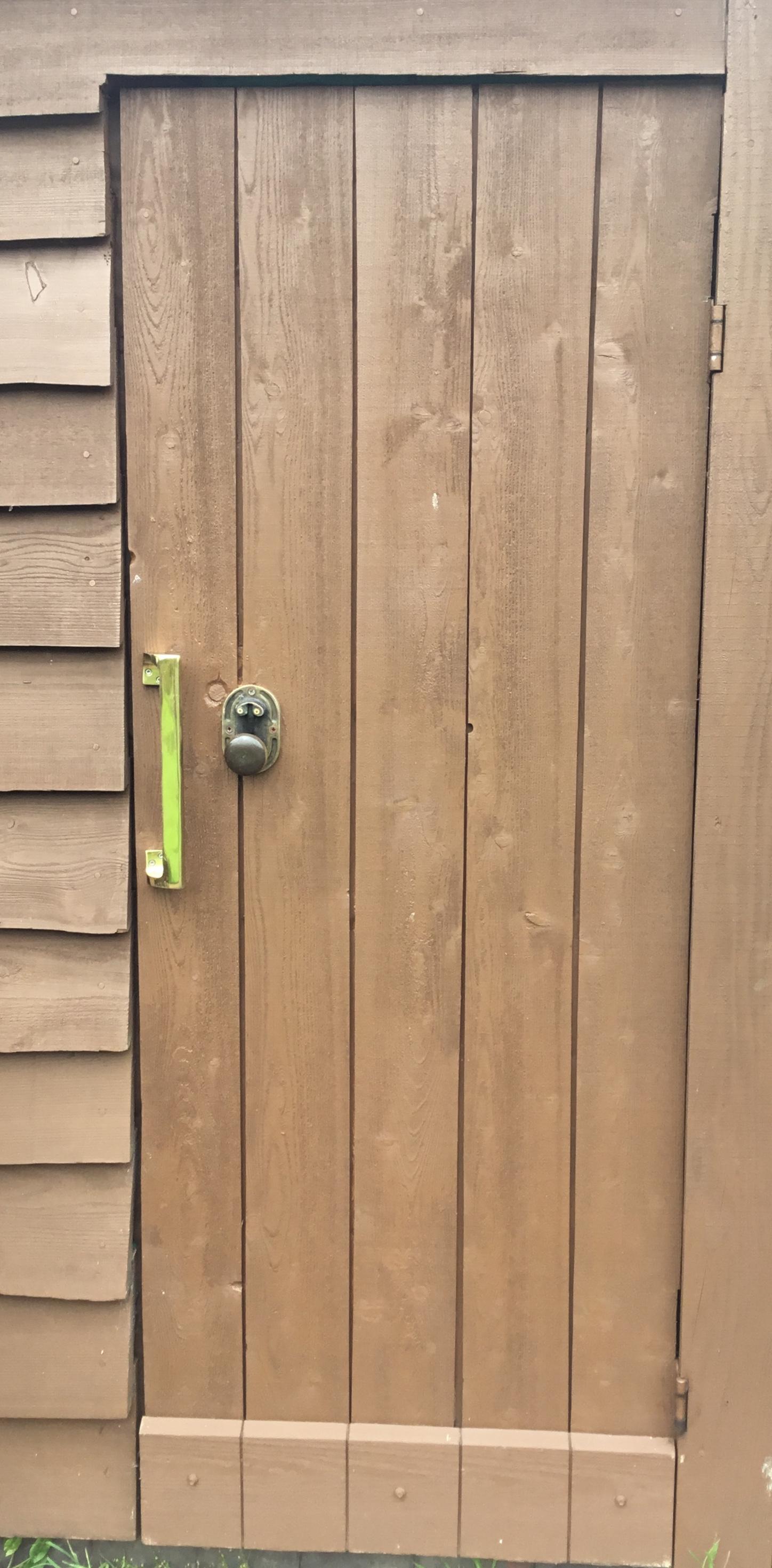

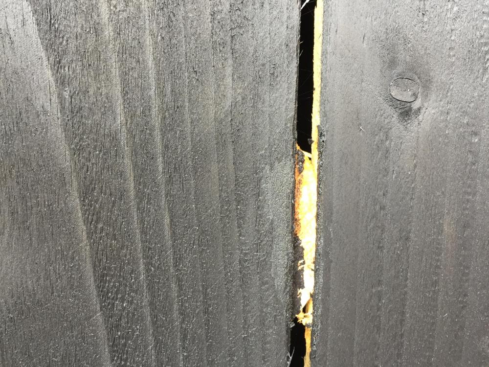

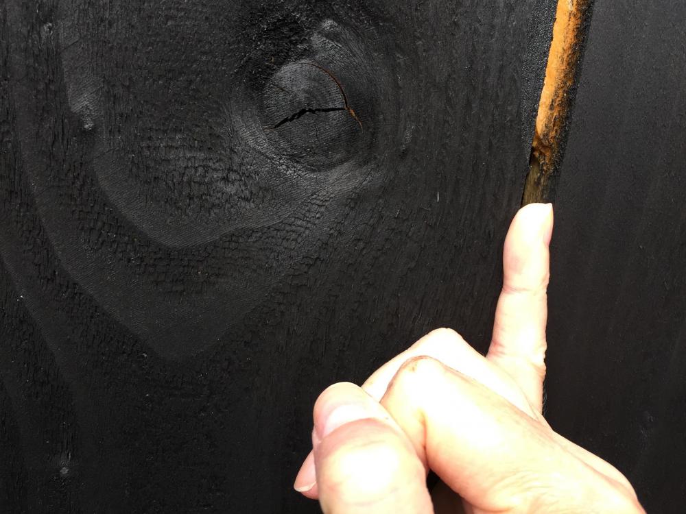

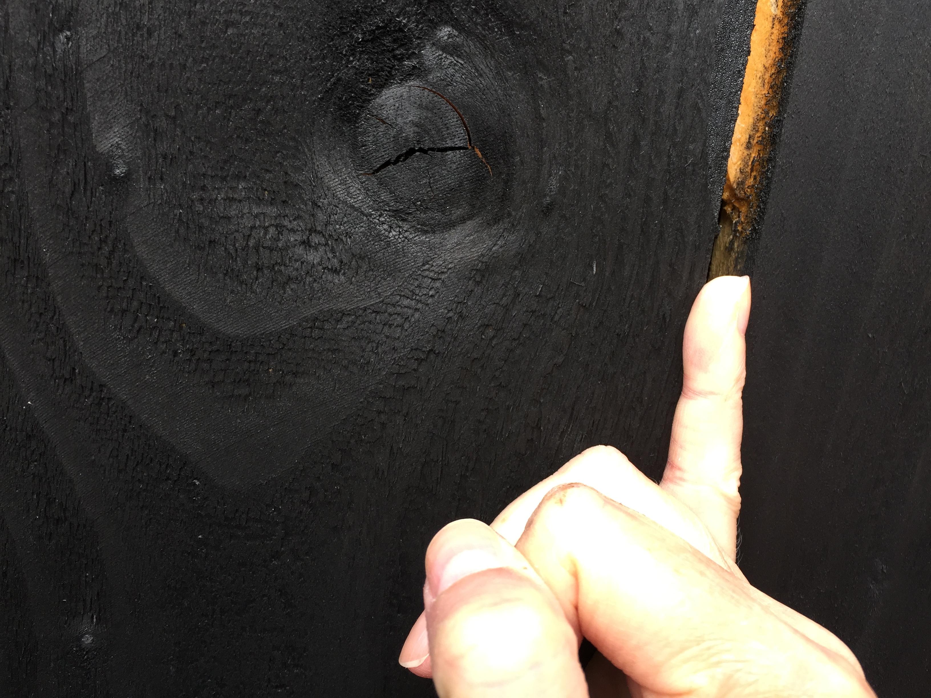

H F Posted August 21, 2019 Share Posted August 21, 2019 We commissioned a guy to build us a shed in our garden. The wood has obviously expanded, but it seems to have expanded an awful lot. I think he said that he made a biscuit joint to keep the wood together in the doors to prevent this kind of thing from happening. The gaps are now about 1cm wide. I was thinking of buy 5cm wide slats and placing them over the gaps because the shed's not watertight now and we keep our outdoor cushions in there. Is that a good idea? Link to comment Share on other sites More sharing options...
RichS Posted August 21, 2019 Share Posted August 21, 2019 The timber has shrunk (not expanded) as it has dried out in the sun, a not uncommon problem nowadays, even with merchant bought gates. Pity he didn't form a full length tongue instead of biscuits. Won't do any harm to cover over the gaps with something like tile lath and just stain in to match. Best to only put fixings into one side of the lath and then it will still allow movement as necessary. 1 1 Link to comment Share on other sites More sharing options...
Cpd Posted August 21, 2019 Share Posted August 21, 2019 I would use a 50mm wide batten to cover the gaps all the way down and some stainless steel screws. Photo of what it would look like. 2 Link to comment Share on other sites More sharing options...

Onoff Posted August 21, 2019 Share Posted August 21, 2019 Bottom line is the guy who did it was a bit inexperienced. Should have done a continuous tongue and groove like I did on my gate using 6mm marine ply. Glued one side only. Been like this 5 years and perfect. The boards can expand and contract as they like and no gaps. Thinking about your situation then your boards I junk might still expand / contract. If your 50mm strip is affixed over the gap but to both boards I wonder if, over time the strips will split? I might be tempted to fit 70m strips but to one side of the gap only. Then it can slide over the adjacent board to allow for movement. Only worry there is will the boards, affixed one side, "curl"? How about, as a cheap "try": Buy a few tubes of the cheapest black silicone and put that in the gaps finishing with a decent Fugee tool. Link to comment Share on other sites More sharing options...

Cpd Posted August 21, 2019 Share Posted August 21, 2019 As @Onoff says it’s a pretty poor job.... but it is what it is. I agree about the batons potentially causing some problems but I would not use 70mm only fixed on one side as I think they will lift and look messy, better to fix the 50mm ones through the middle so the fixings go through the gap in the boards as shown in my photo above. You could easily put something on the back of the door to run the screws into. This way the wood can expand and contract without splitting. But again all this is because it has not been done correctly. I have build various doors and the one in the photo below was with unseasoned larch but I put in a big larch Tongue expecting them to shrink and they have been up for six years without fault. Link to comment Share on other sites More sharing options...

Onoff Posted August 22, 2019 Share Posted August 22, 2019 13 hours ago, Cpd said: better to fix the 50mm ones through the middle so the fixings go through the gap in the boards as shown in my photo above How about simply more 50mm battens behind? Like mini I beams at each gap. The inner ones would I guess need cutting to suit if the door is ledged and braced. Think I'd still fill the gaps with something soft. Link to comment Share on other sites More sharing options...
H F Posted August 22, 2019 Author Share Posted August 22, 2019 19 hours ago, Onoff said: How about, as a cheap "try": Buy a few tubes of the cheapest black silicone and put that in the gaps finishing with a decent Fugee tool. Your workmanship looks great. Would mastic be an option, and then we paint over it? Link to comment Share on other sites More sharing options...
H F Posted August 22, 2019 Author Share Posted August 22, 2019 Thanks cpd and onoff - I’ll do as you and screw through the back into a cross beam to allow movement. This has all been very eye opening. Link to comment Share on other sites More sharing options...
Cpd Posted August 22, 2019 Share Posted August 22, 2019 6 hours ago, Temp said: had an oak "shed" door made and they used T&G boards. These expanded and having nowhere to go the whole door bowed until it looked pregnant. If T&G is used it shouldn't be fully seated. I had to run a saw down the joints to allow some movement. I don’t glue in the tongue, it’s just a perfect fit, as the boards are wet they are only going to shrink not expand and the floating tongue allows for continued movement. But your right in that if the boards were dry they would expand and warp as they would have nowhere to go ! always something throwing to trip us up on a self build....... Link to comment Share on other sites More sharing options...

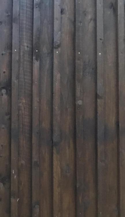

H F Posted September 17, 2019 Author Share Posted September 17, 2019 Taken me a while to post this sorry. It's a short video based on the advice received here. Hopefully it's OK. It looks good from the outside. Feedback and comments are always welcome. https://youtu.be/FO5IhMNZZHw Link to comment Share on other sites More sharing options...
Onoff Posted September 17, 2019 Share Posted September 17, 2019 Those little off cuts on the back look s**t. ? Link to comment Share on other sites More sharing options...
H F Posted September 17, 2019 Author Share Posted September 17, 2019 22 minutes ago, Onoff said: Those little off cuts on the back look s**t. ? Yeah, I know. Didn't want to waste a lot of time cutting neat little pieces and no one's ever going to see them ? Link to comment Share on other sites More sharing options...
