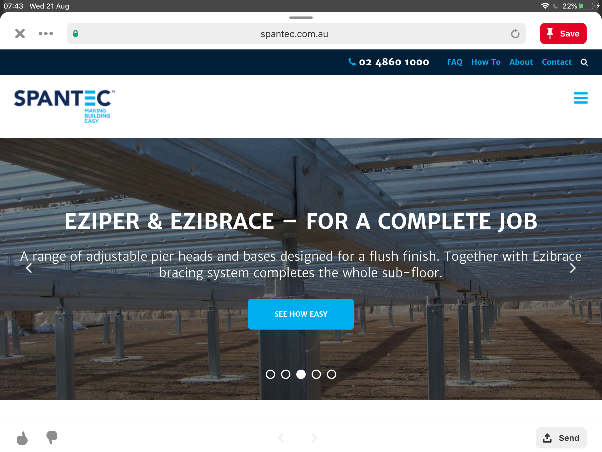

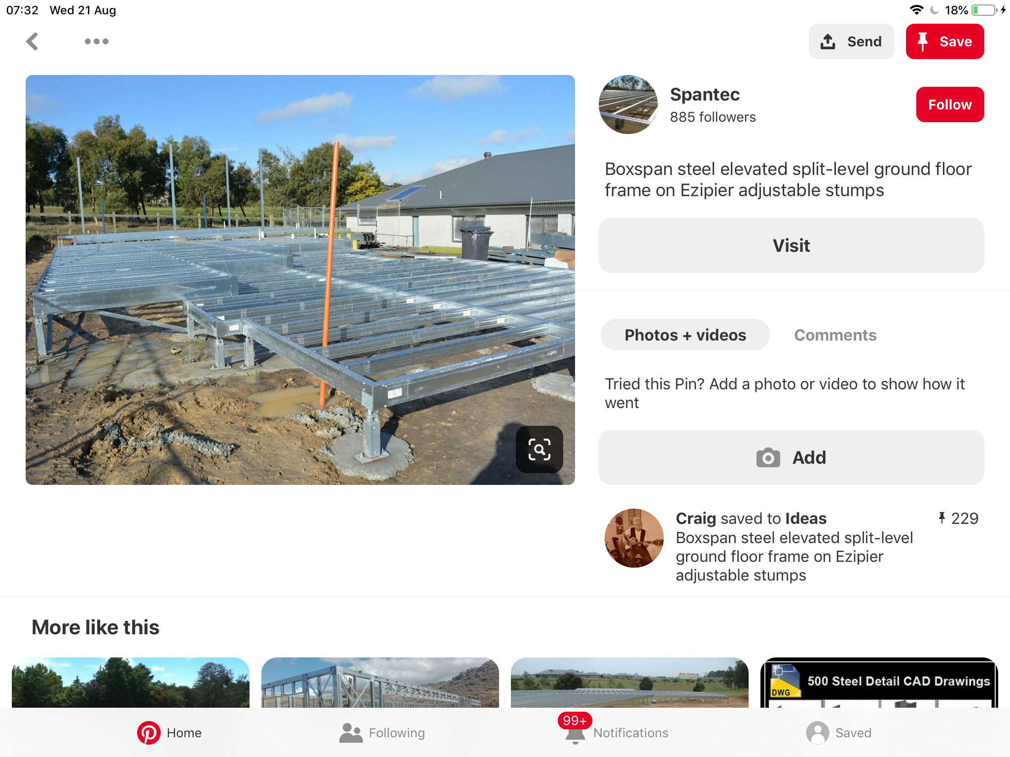

Russell griffiths Posted August 21, 2019 Posted August 21, 2019 21 hours ago, colin7777 said: Hi Russell, As we are on the Broads, we need to have piling with a steel ring beam as we need to maintain a void under the property to allow flood water to flow freely. Normally the ground floor is formed by solid timber joists or Wood/ Metal web joists, the concern I have with this solution is that you can not see what is happening to the condition of the wood and as it can not be accessed will not be able to maintain the wood and over time the whole floor will need to be replaced. I think most people take a chance and just know one day it will need doing, I'm just thinking to avoid it in the first place. I have looked at block and beam on top of the steel ring but it adds a lot of weight and will need additional piles. Colin Metal joists are common in Australia to combat termite damage, I wouldn’t consider wood in your situation, have a look a bit further from home, we really are stuck in the past here.
Russell griffiths Posted August 21, 2019 Posted August 21, 2019 @redtop and @colin7777 I have seen this system in oz many times, it is very robust. 1
