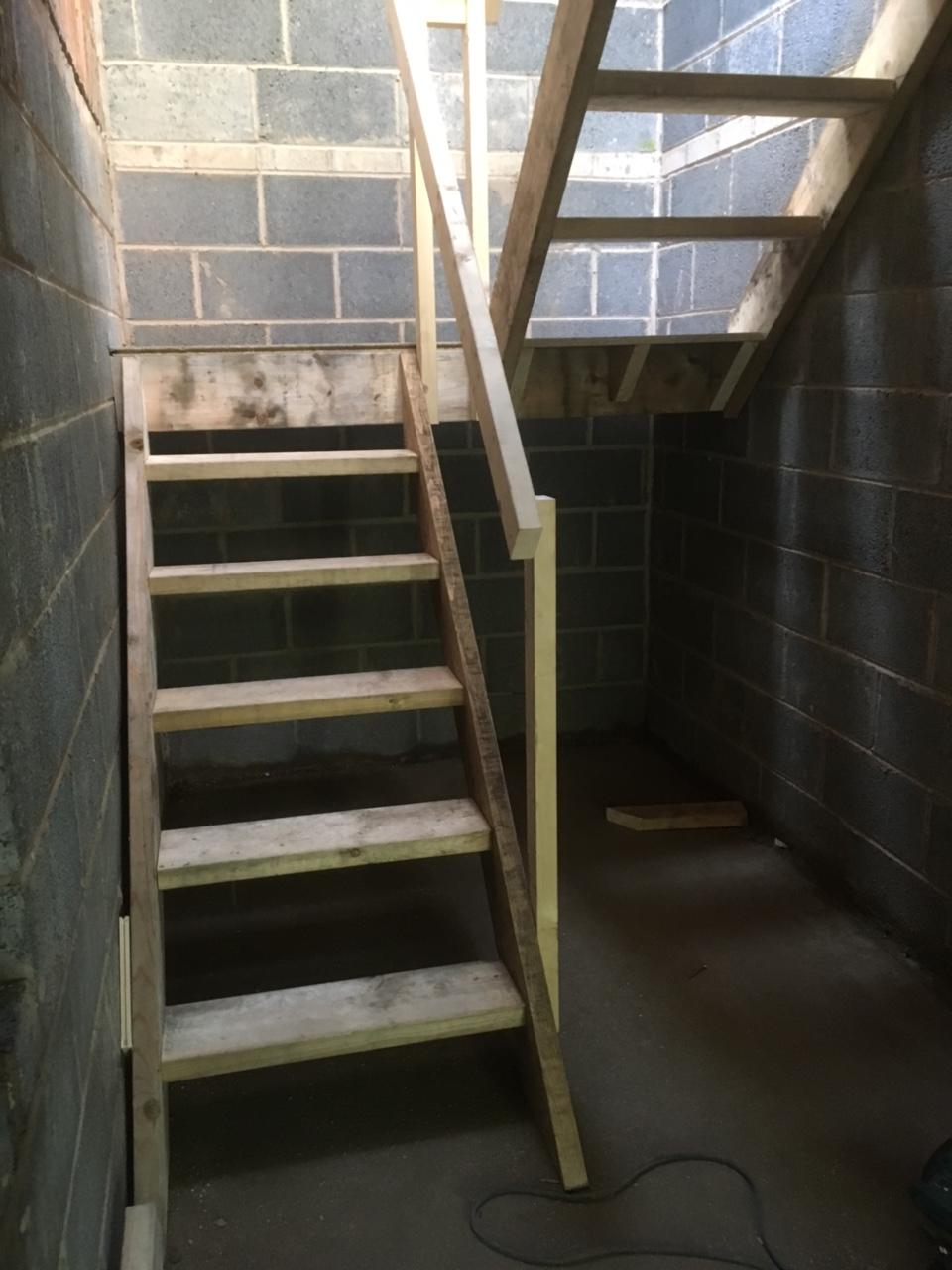

PeterW Posted August 19, 2019 Posted August 19, 2019 51 minutes ago, AnonymousBosch said: A few yards of 9 by 2 for the stringers and whatever is lying round the site for the treads - spare sheets of glass will do. ? Yards..?? 9 by 2...??? Have you been building since the turn of the last century ..??! ? You can build your own fairly easily - these were from leftover rafters and Egger board, and lasted for 14 months before being repurposed as cellar steps ..!

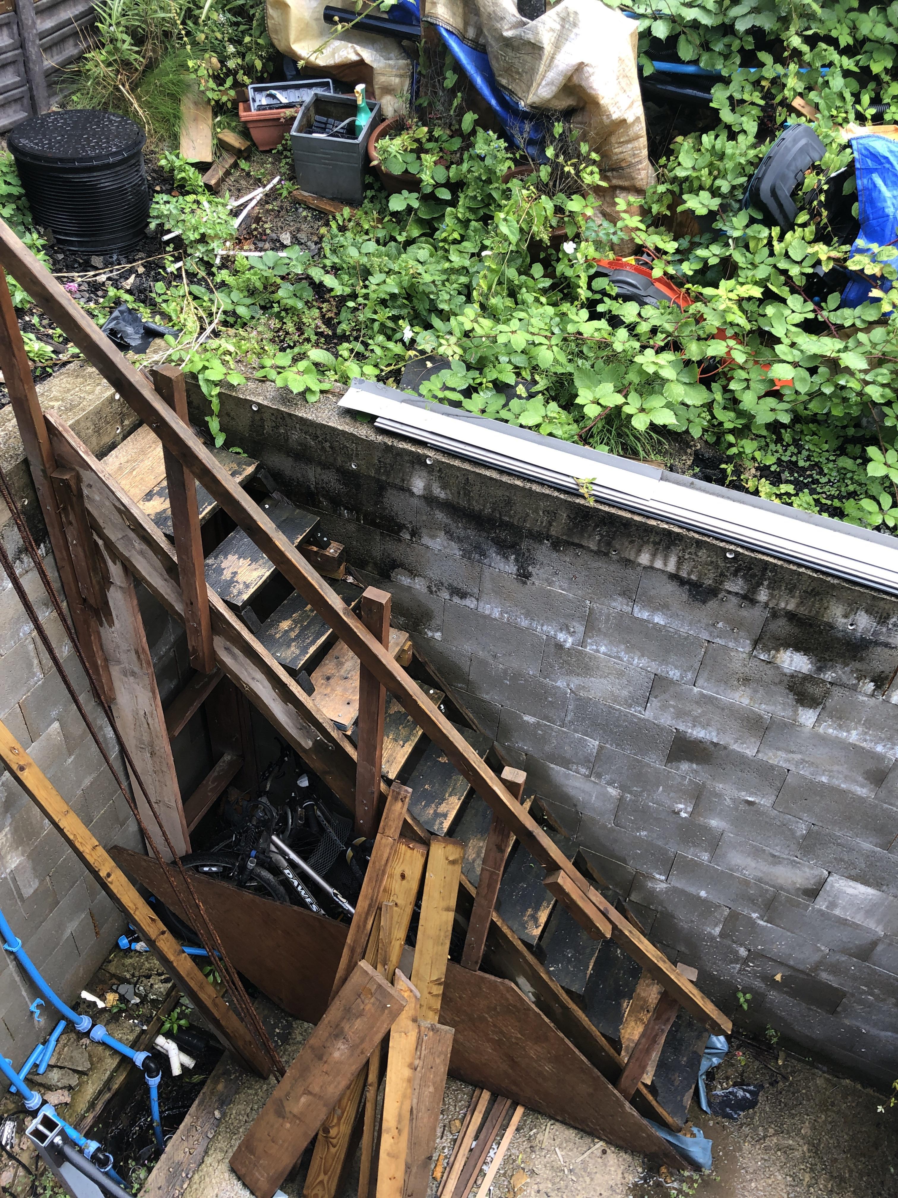

Pocster Posted August 19, 2019 Author Posted August 19, 2019 These are what i’ve Been using for 2 years . Now a bit rotted . SWMBO wants a ‘proper’ temporary staircase when we live on the build ? Building a wooden one whilst cheap is a pita to move and fix . Mobile stairs make my life easier .

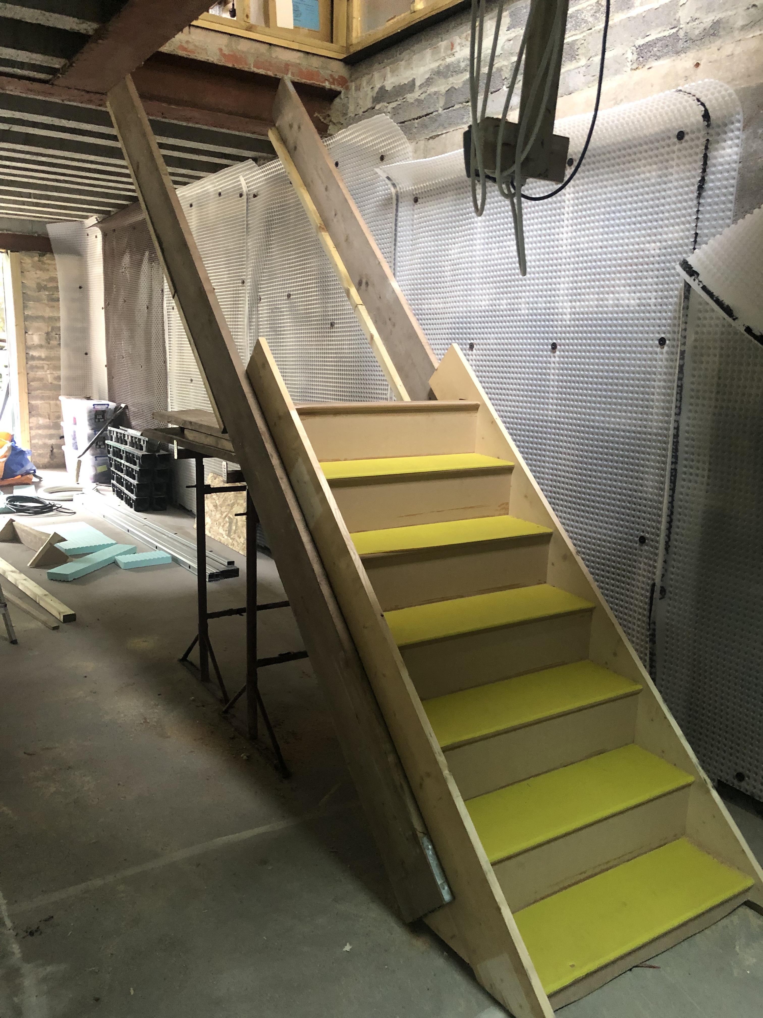

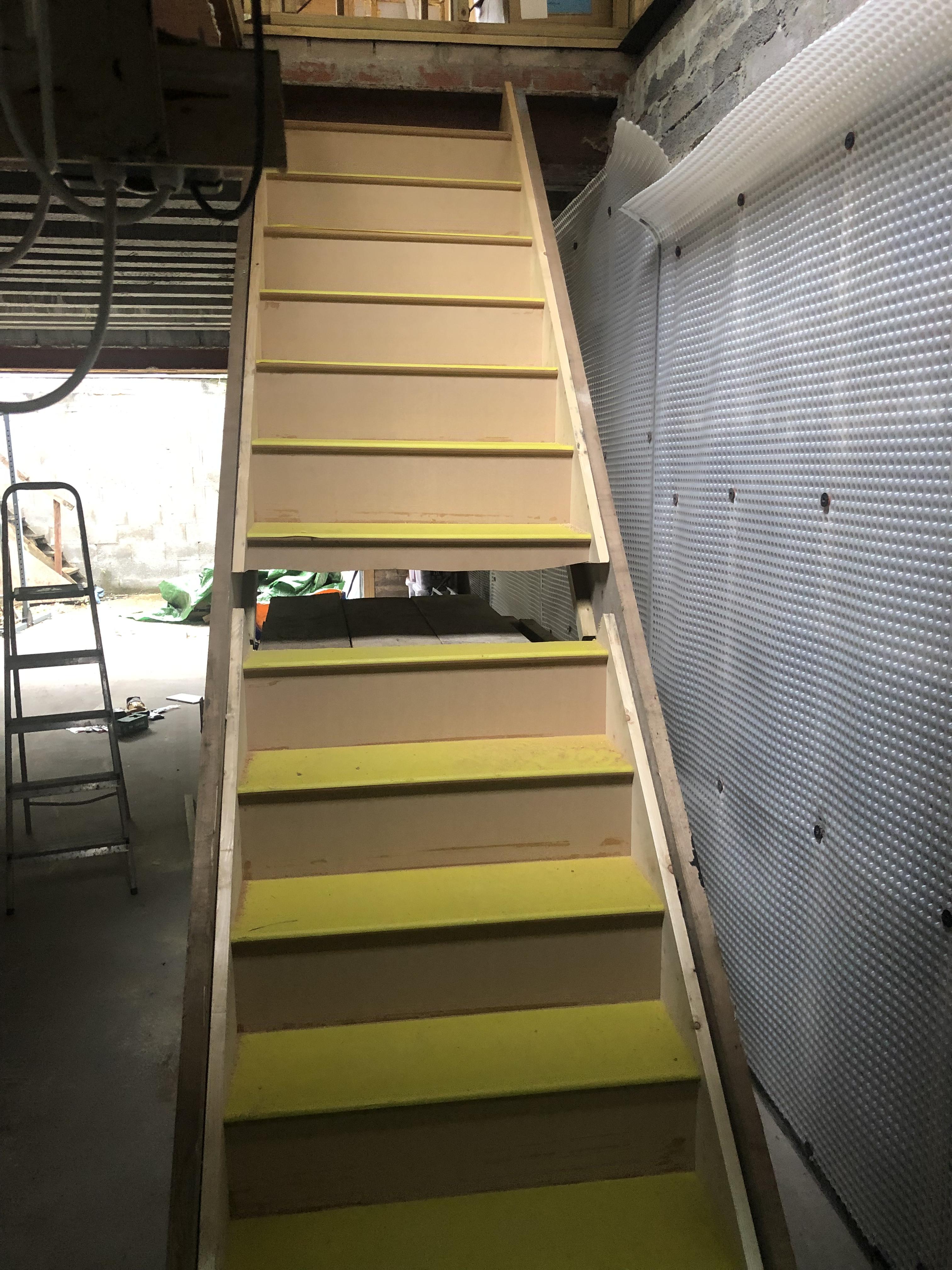

Pocster Posted August 19, 2019 Author Posted August 19, 2019 Gave in . Got a 12 step pre made staircase Total height 2.6 for £168 inc vat and delivery . Needless to say I had to ‘play’ with the builders merchants for it at that price ...
Pocster Posted August 27, 2019 Author Posted August 27, 2019 Hmmmm This isn’t going to be as easy as I thought . Stairs weigh 90kg - haven’t work out a safe way to get them underground. Also once I build a frame and strengthen it - it’s going to be very heavy !!
Pocster Posted August 28, 2019 Author Posted August 28, 2019 Not quite finished but ... “ Necessity is the mother of invention “ Indeed the worlds first sliding staircase . Top half slides up over bottom half and will eventually lock in place Looks like an @Onoff monster 1
PeterW Posted August 28, 2019 Posted August 28, 2019 Looks like a picture from one of those HSE reports that ends with the amount of fine the company got for unsafe working practices..... 2
