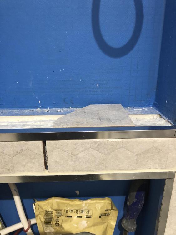

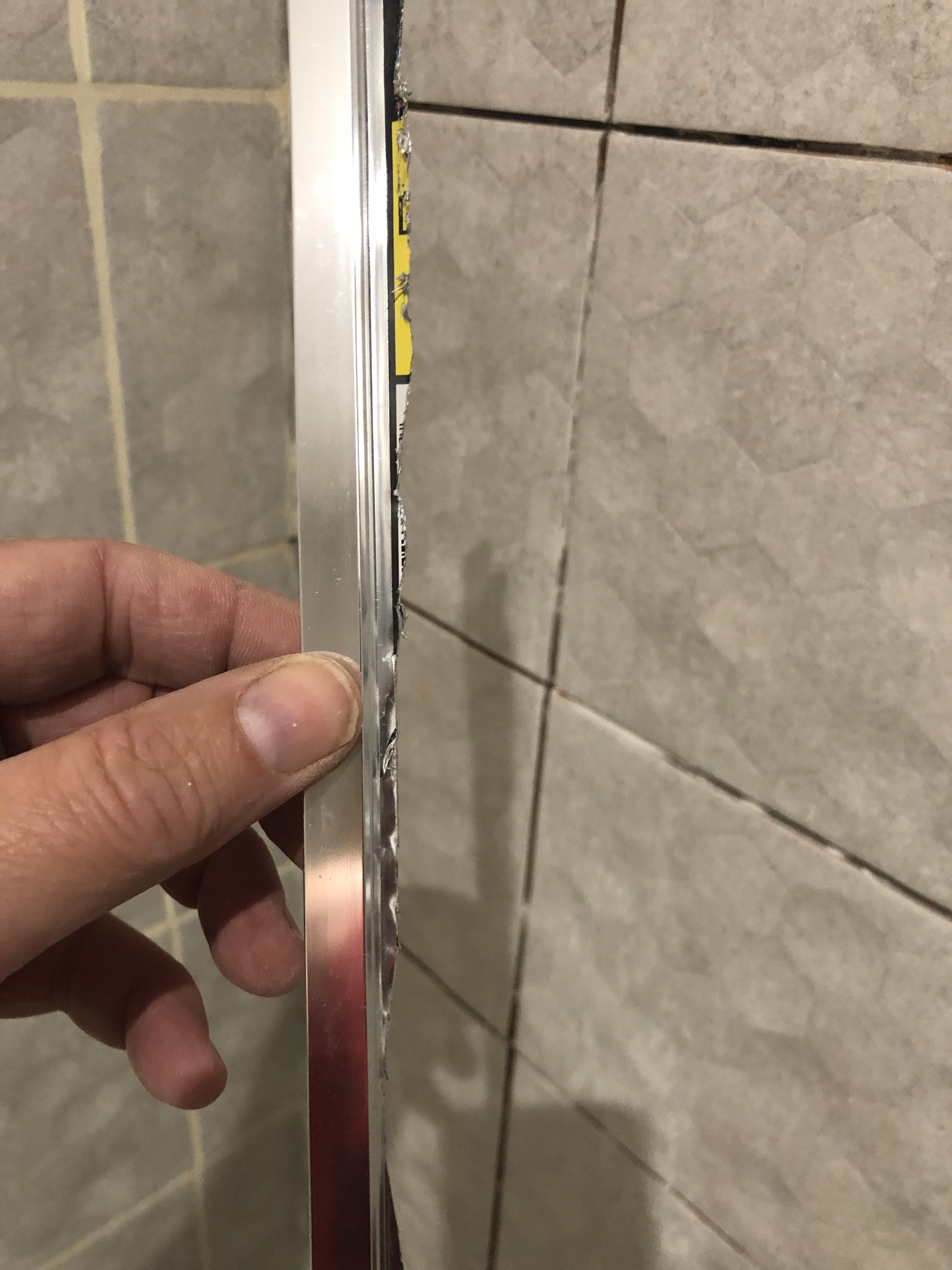

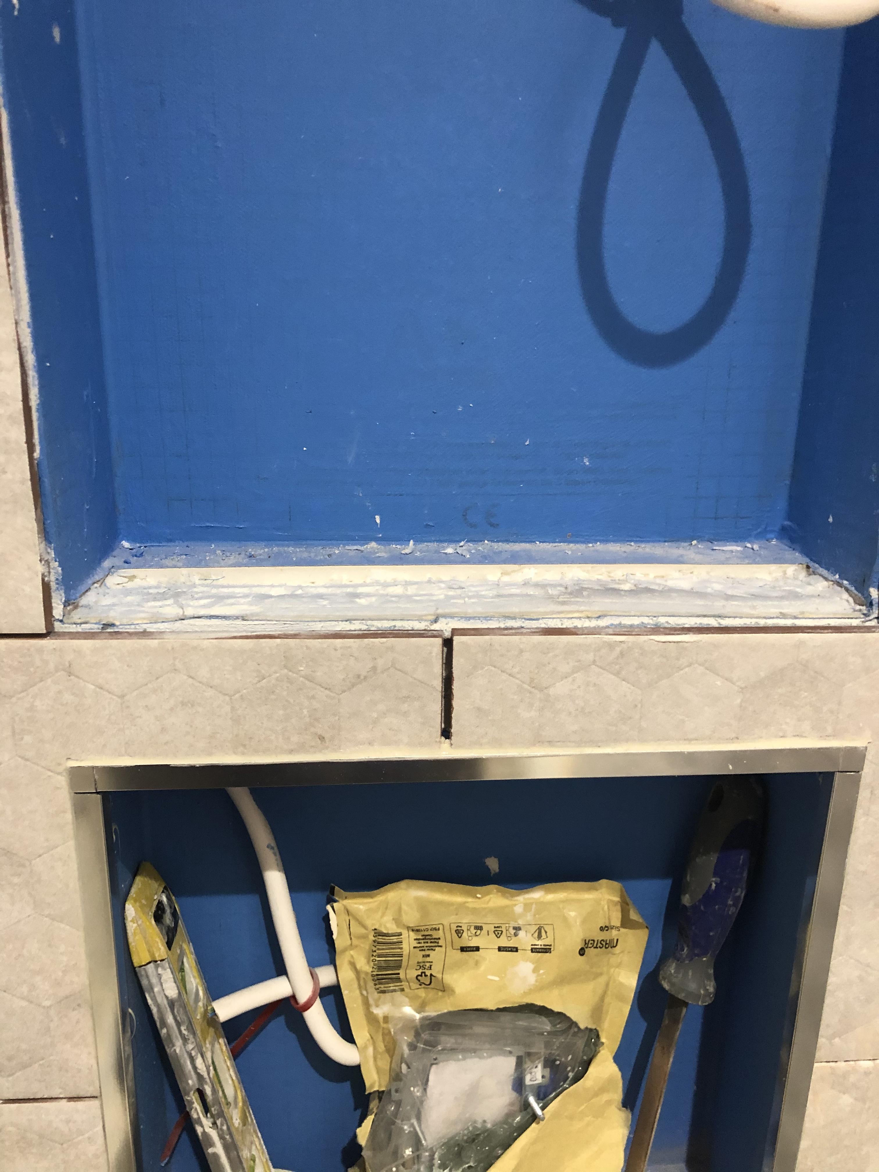

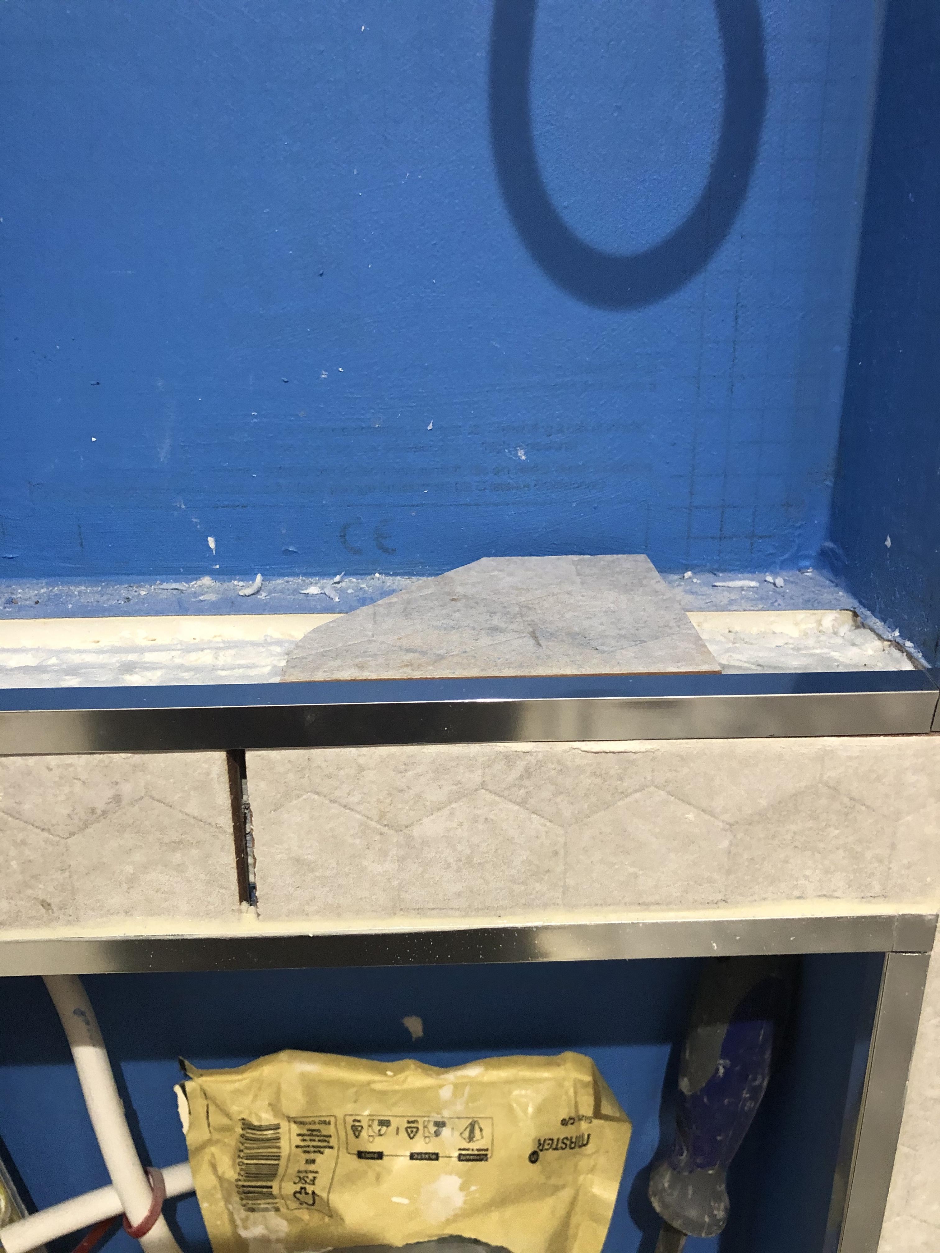

Pocster Posted October 9, 2020 Author Posted October 9, 2020 Meanwhile ( I.e leave the heavy tray alone for a bit ) . Reluctantly cut away the pre formed recess . Cut back the tile bead . Now it should all fit with a thin layer of tile adhesive and a slight fall on the tile . Will ‘blue out ‘ the cut former just for my peace of mind.
Pocster Posted October 9, 2020 Author Posted October 9, 2020 Just now, pocster said: Meanwhile ( I.e leave the heavy tray alone for a bit ) . Reluctantly cut away the pre formed recess . Cut back the tile bead . Now it should all fit with a thin layer of tile adhesive and a slight fall on the tile . Will ‘blue out ‘ the cut former just for my peace of mind. ????? First photo looks liked I’ve made a noose if it all gets too much !! 1
Onoff Posted October 9, 2020 Posted October 9, 2020 Don't have too much fall on those bottom tiles. I have 3 recesses, 2 deeper ones on one wall and a shallower one driven by the need to get at least some pir in the wall behind it. I think where the shallow pocket is there's only 25mm pir behind. I made a jig so in theory all pocket bottom tiles ended up at the same angle but with the shallow one stuff can slip off potentially. Maybe I got the angle wrong? I'll find some pics. 1
Onoff Posted October 9, 2020 Posted October 9, 2020 A bit here. Flickr down at the mo so can't access the pics I wanted. Basically I sat the bottom tile on a plastic packer at the back to just tilt it forward a little. The adhesive only squashes down so far. 1

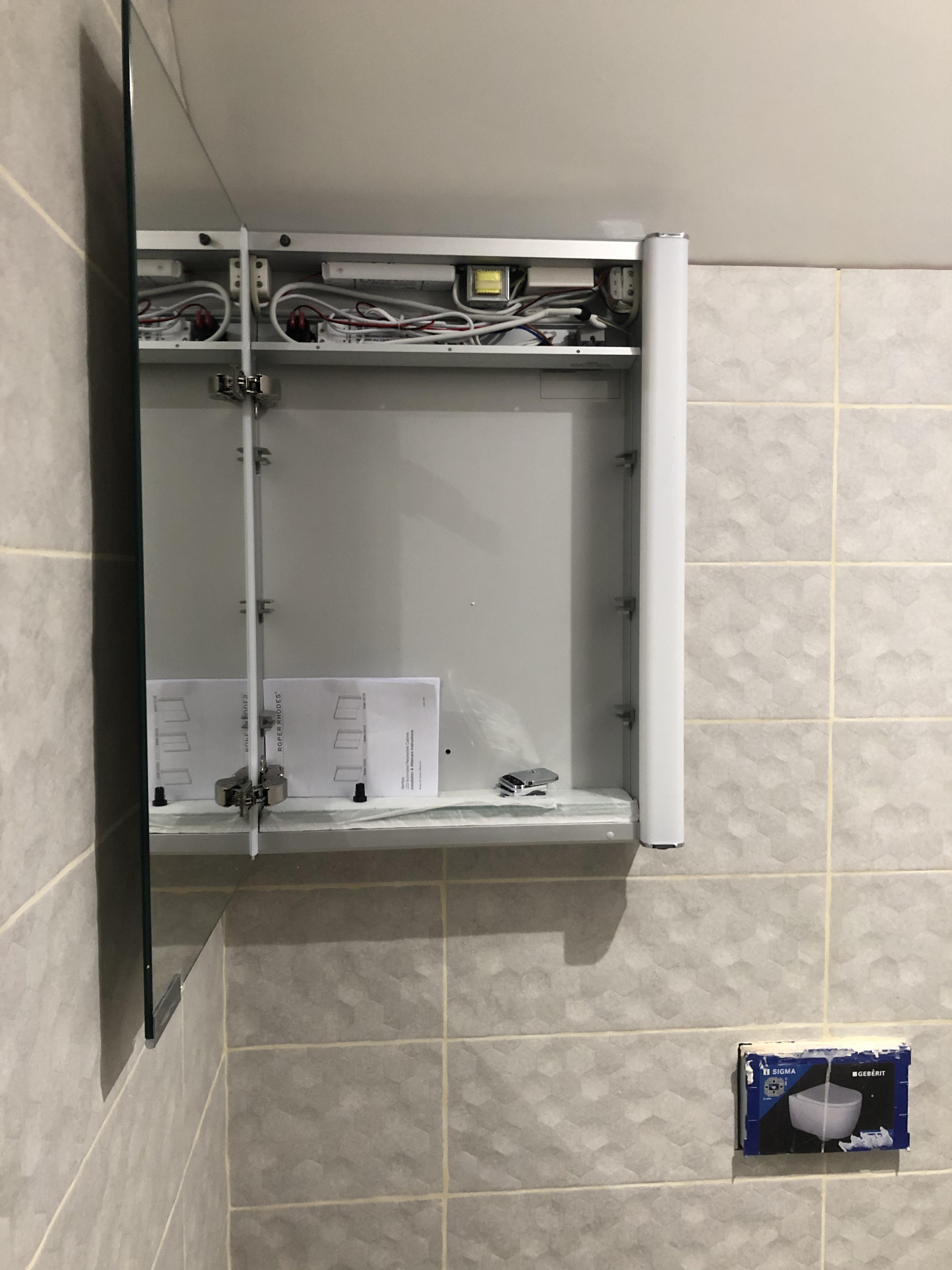

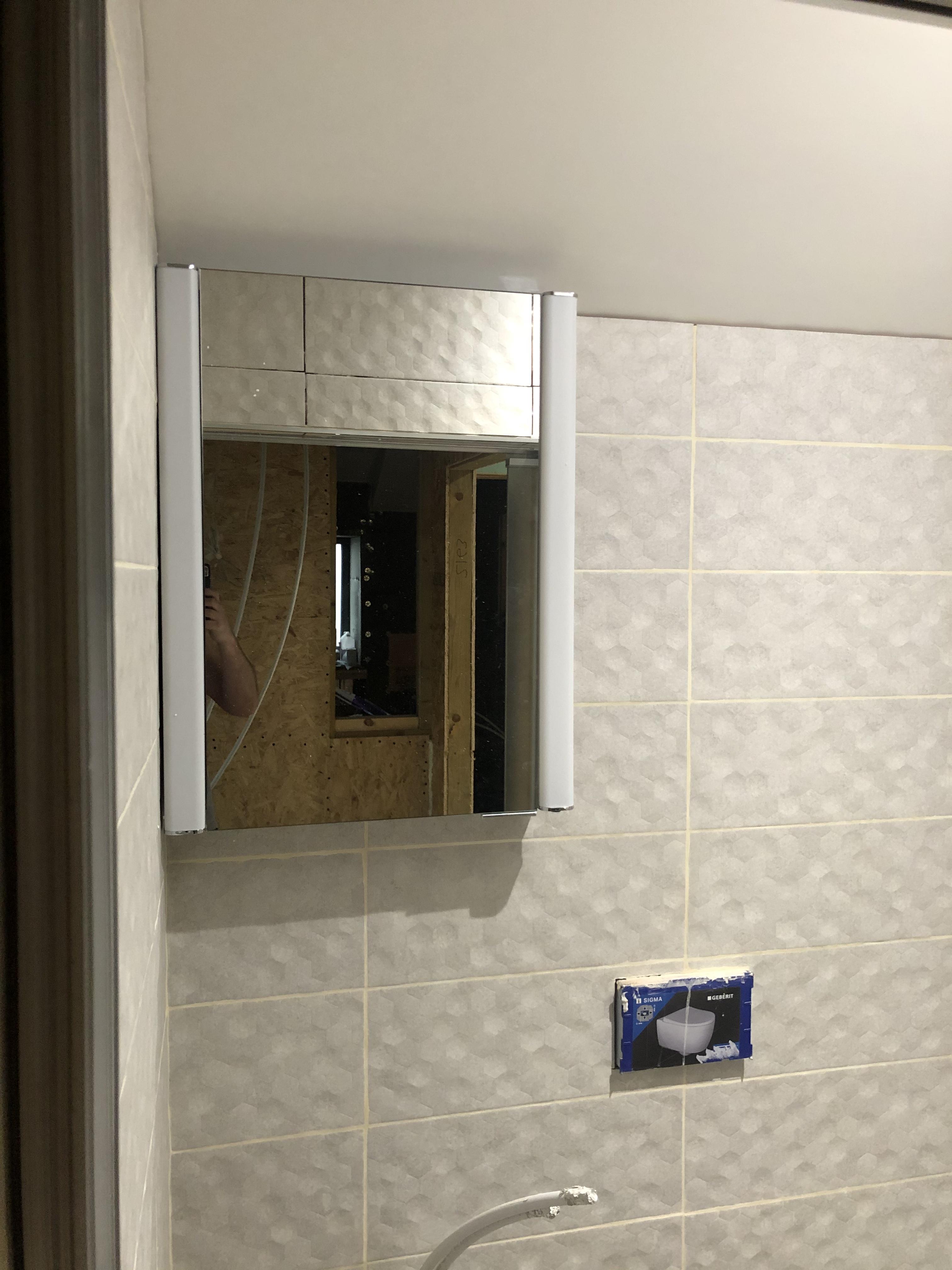

Pocster Posted October 9, 2020 Author Posted October 9, 2020 As it’s Friday decided to score some SWMBO points and also get rid of a box . So put the ensuite wall unit up - no electrics connected to it yet . 1
