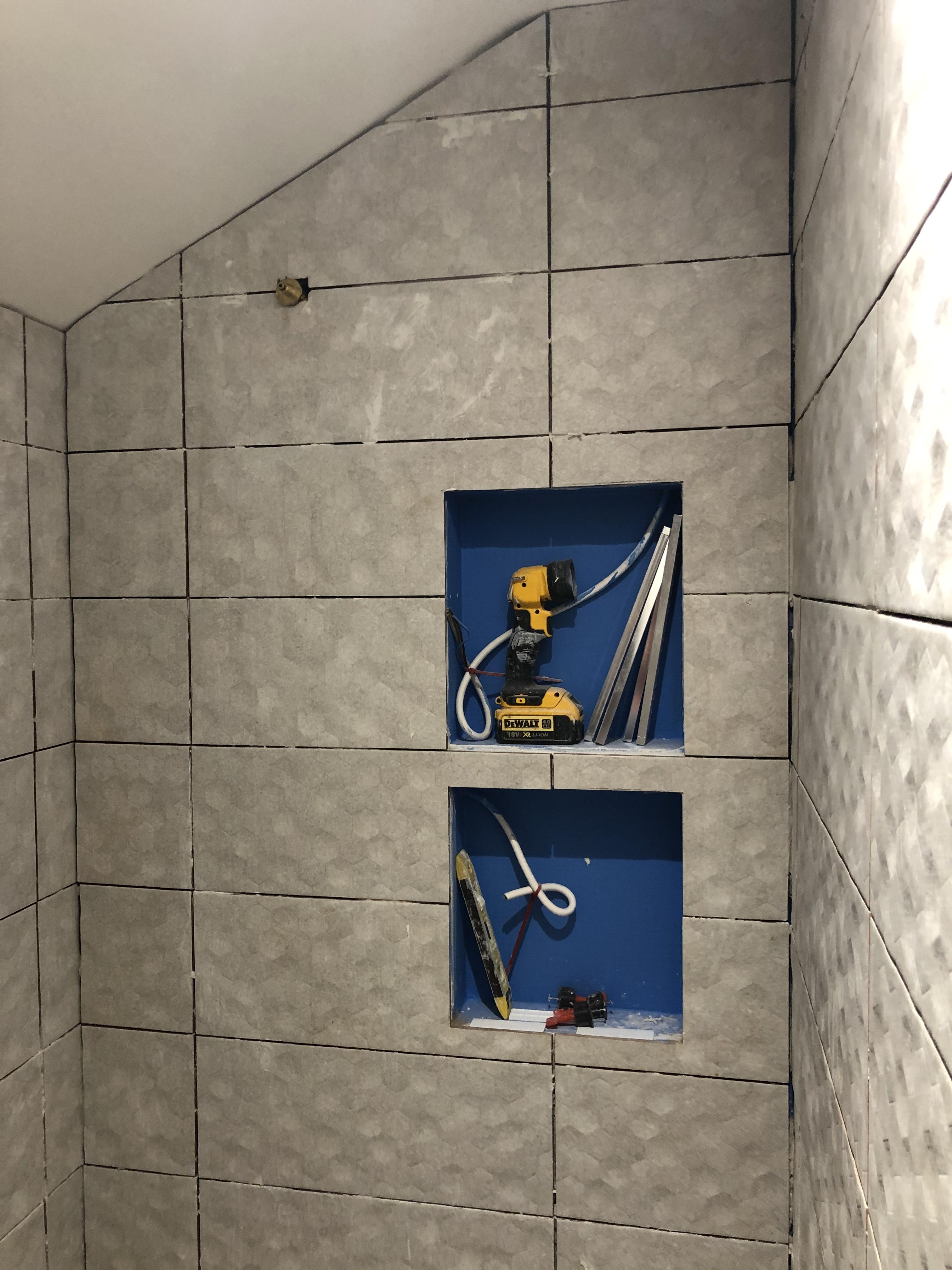

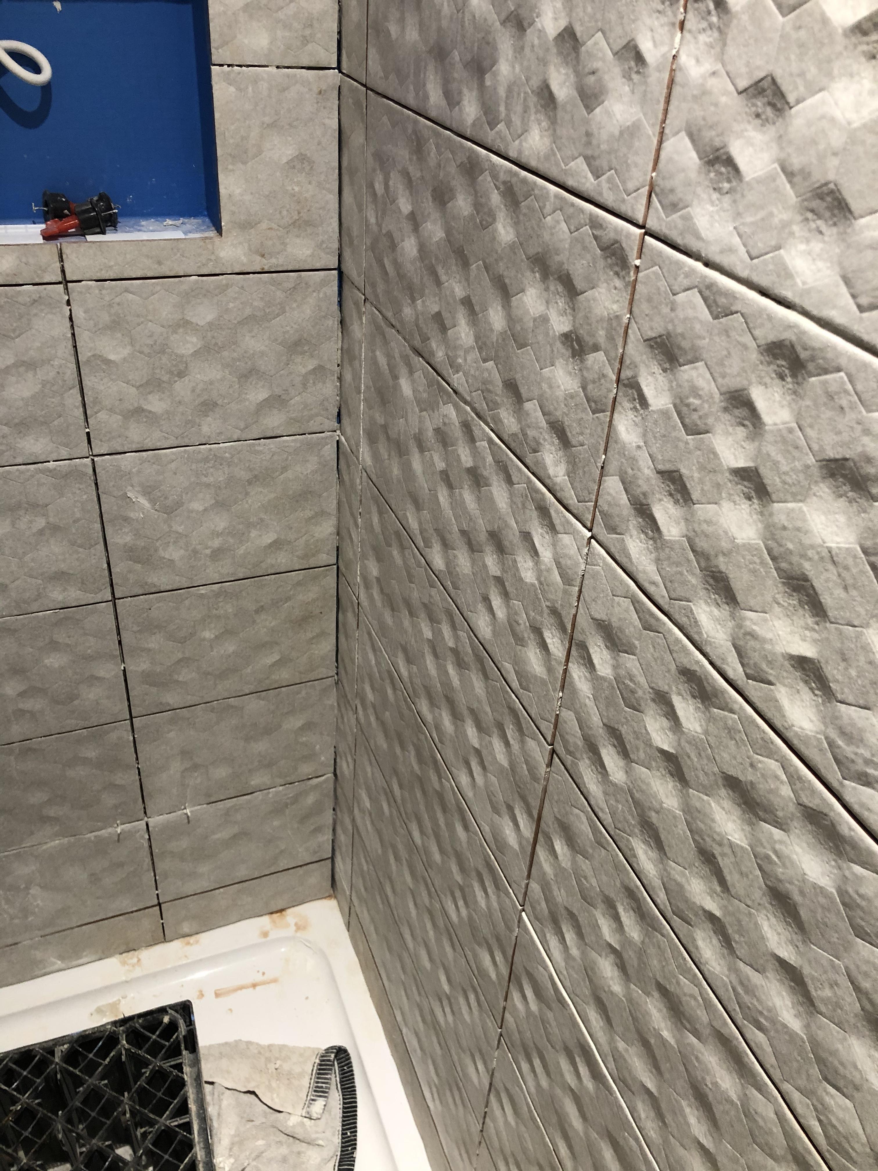

Pocster Posted September 23, 2020 Author Posted September 23, 2020 (edited) Ensuite fully tiled now Now need SWMBO to choose grout colour ? Presume I need to clear out all tile gaps of adhesive Edited September 23, 2020 by pocster
Big Jimbo Posted September 23, 2020 Posted September 23, 2020 Looking great Pocster. Dont use white after all that hard work fella.
Gav_P Posted September 23, 2020 Posted September 23, 2020 33 minutes ago, pocster said: Presume I need to clear out all tile gaps of adhesive Didn’t you do that at the time?? It would have been really easy with the adhesive still soft. ?
Gav_P Posted September 23, 2020 Posted September 23, 2020 36 minutes ago, pocster said: Ensuite fully tiled now Except those kerdiboard pockets... what are you doing about them? Are they going to be tiles with the same tiles?
Pocster Posted September 23, 2020 Author Posted September 23, 2020 2 hours ago, Big Jimbo said: Looking great Pocster. Dont use white after all that hard work fella. Not going to SWMBO wants biscuit - I think that means beige . I’d prefer grey
Pocster Posted September 23, 2020 Author Posted September 23, 2020 1 hour ago, Gav_P said: Except those kerdiboard pockets... what are you doing about them? Are they going to be tiles with the same tiles? Yes . Waiting for silver ct1 to arrive then will do them
Pocster Posted September 23, 2020 Author Posted September 23, 2020 1 hour ago, Gav_P said: Didn’t you do that at the time?? It would have been really easy with the adhesive still soft. ? I find that really risky . Because you can move or flick out a spacer . I do water brush down the faces and any ‘safe’ gaps . Will just dremel each line .

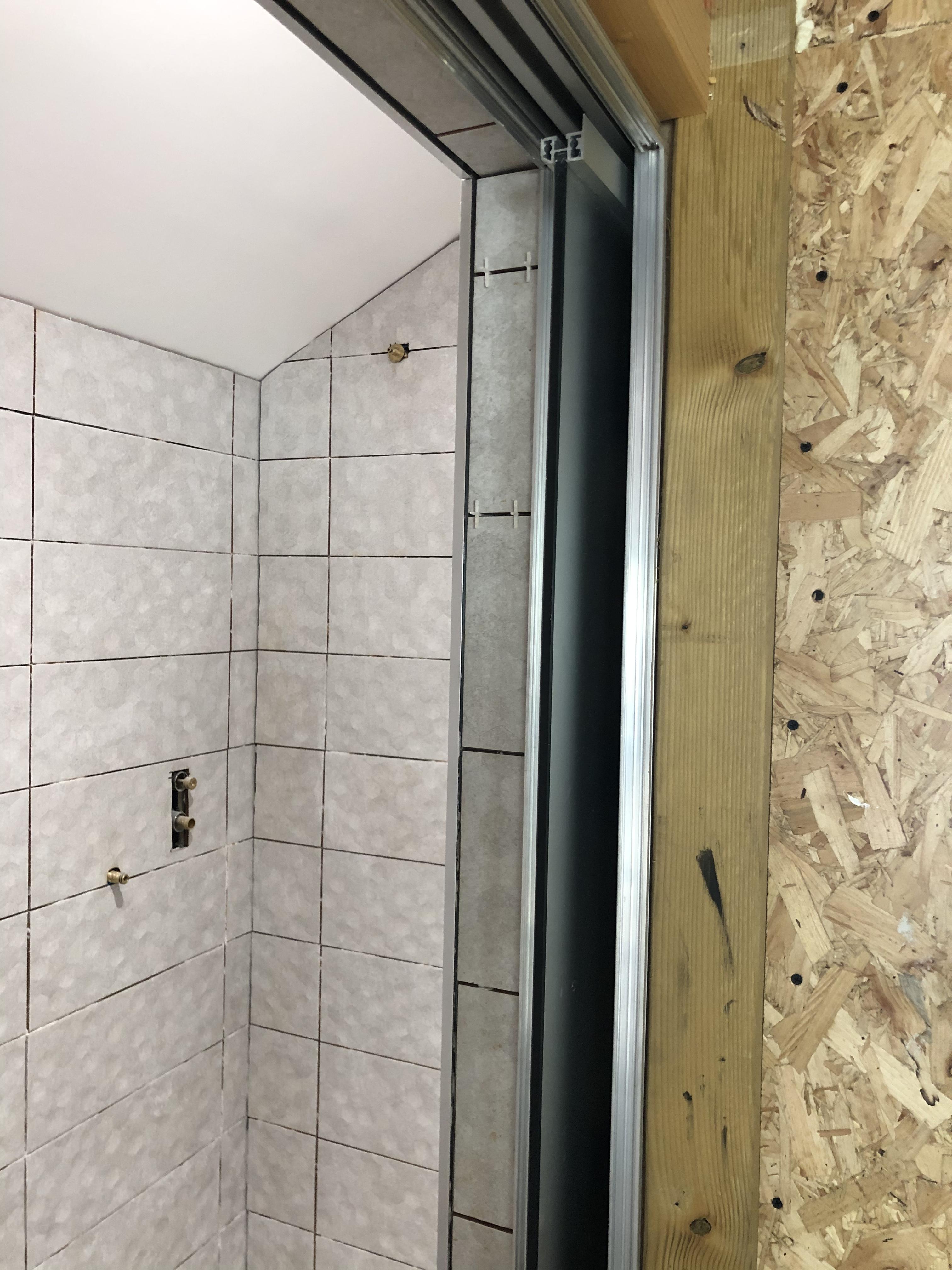

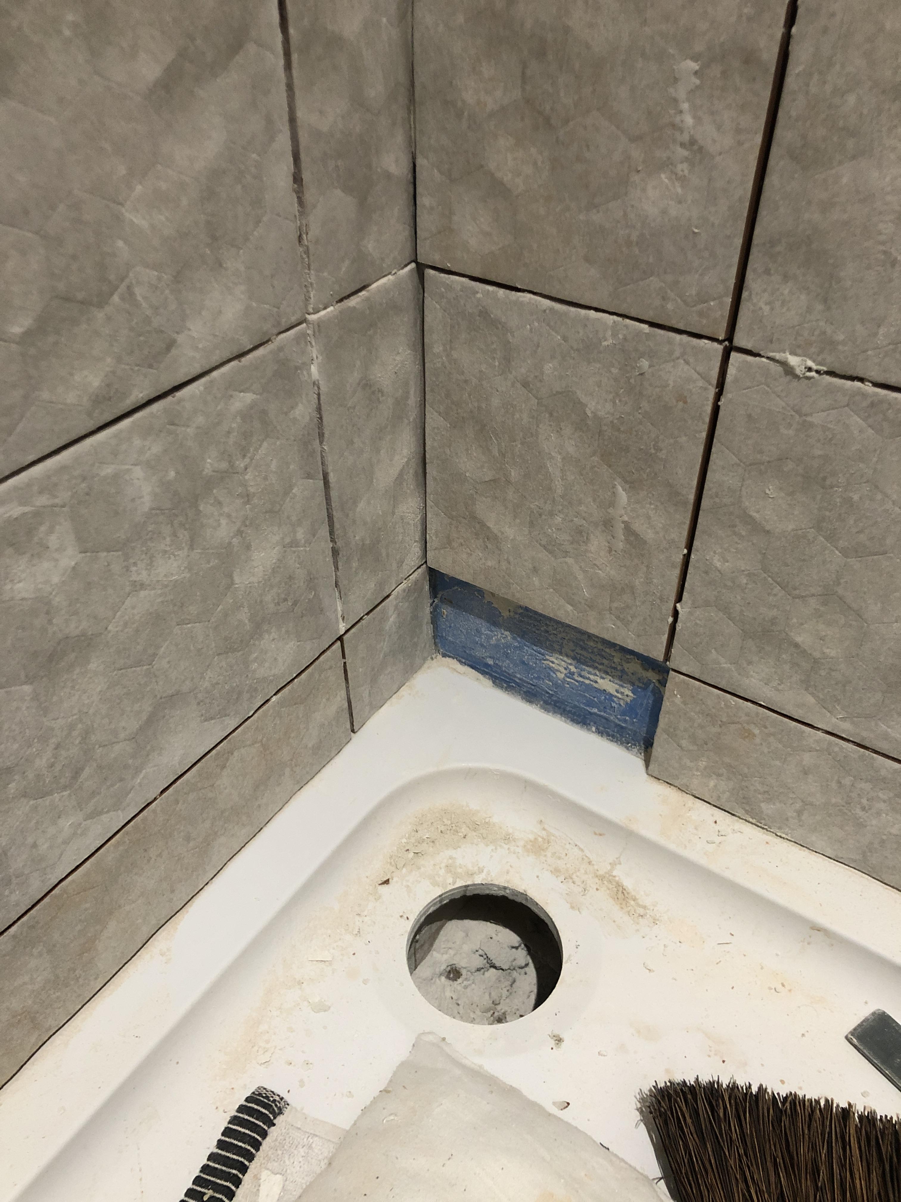

Pocster Posted September 23, 2020 Author Posted September 23, 2020 This bottom tile seemed to have tipped . Came out surprisingly easy as adhesive not rock hard yet !

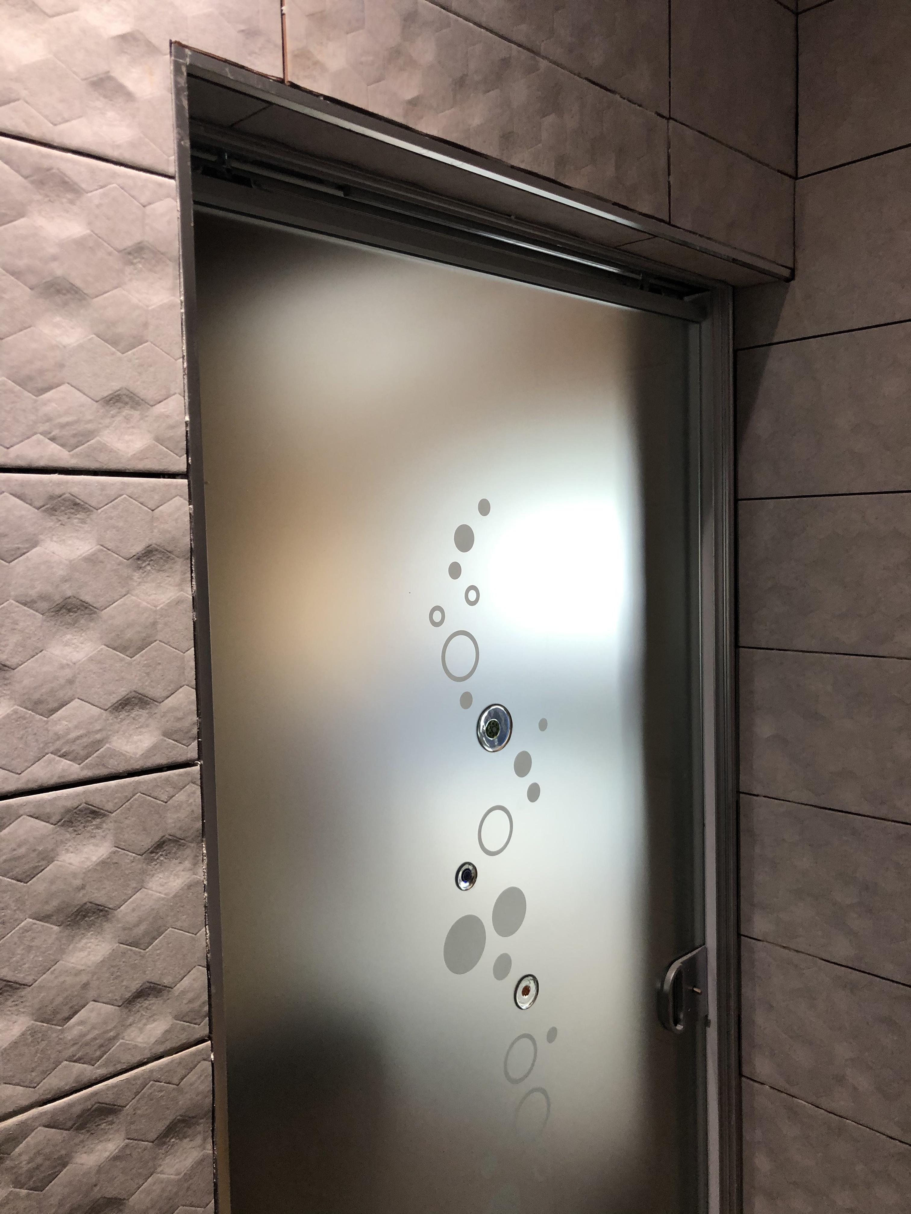

Pocster Posted September 23, 2020 Author Posted September 23, 2020 Fiddly door return tiles done . Few mm out at the top - but I’ll just over grout to hide that .I have to say it’s all looking pretty good . Been also cleaning out the tile gaps with the dremel ( reckon I’m good enough with that to be a dentist ) . So just wall pockets to do .Time to conquer the bathroom now ?? 1

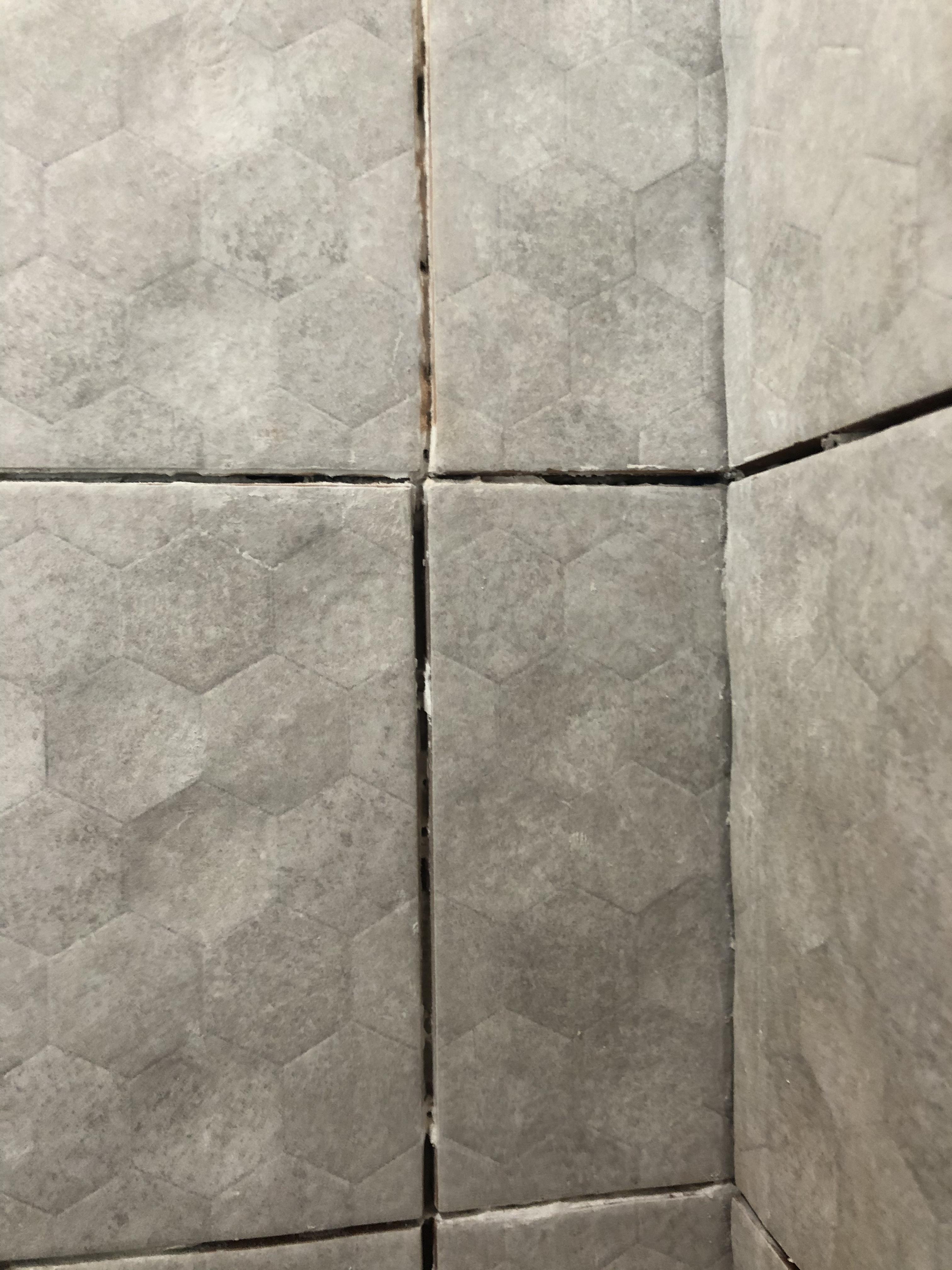

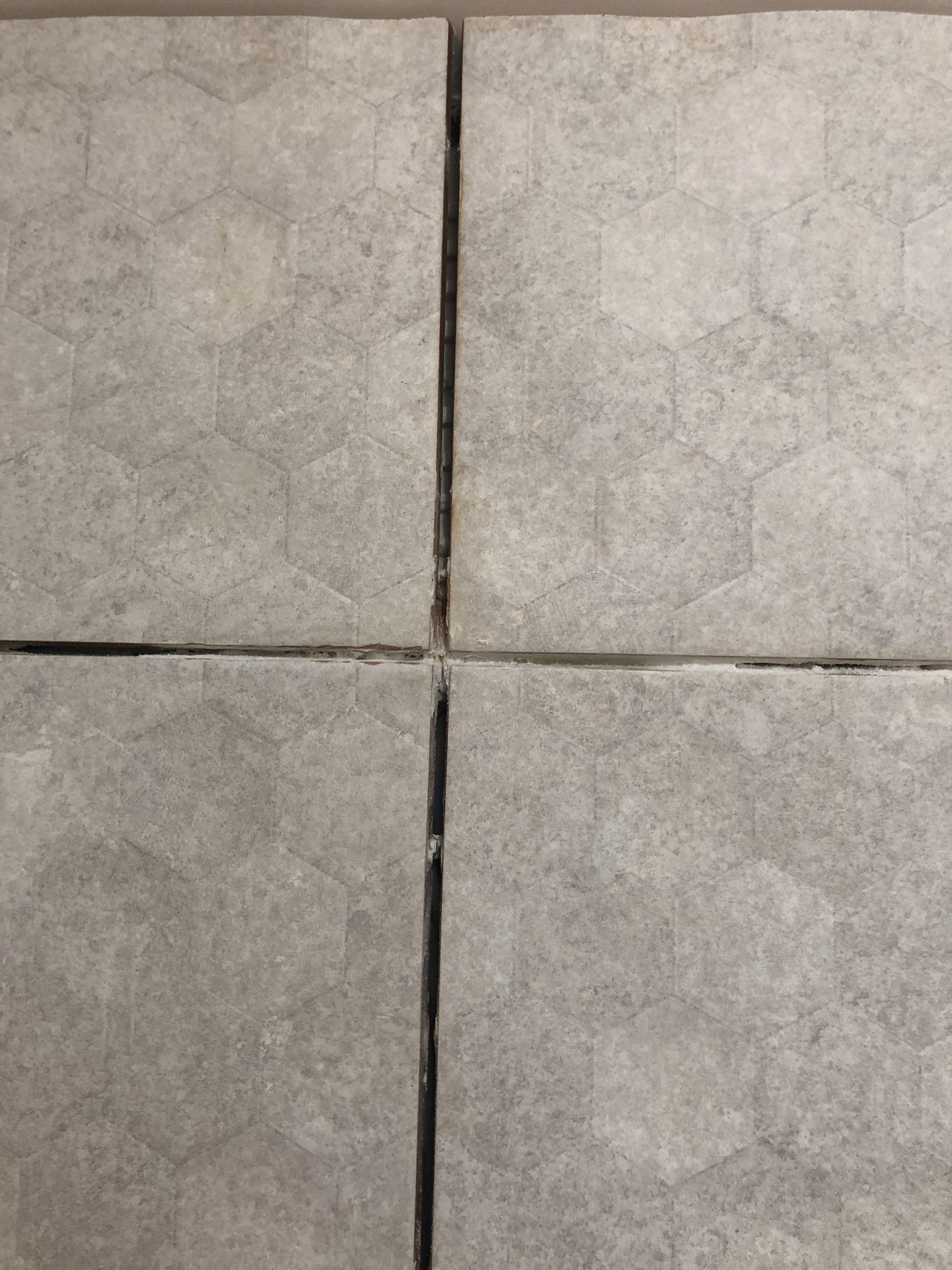

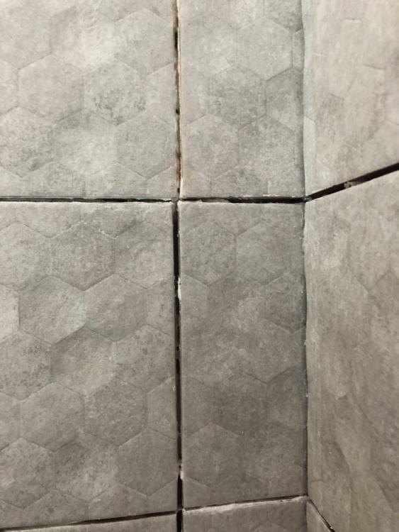

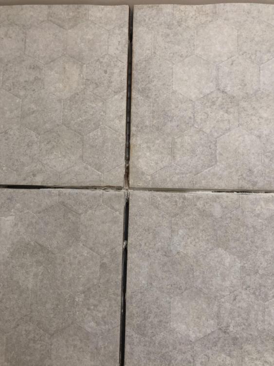

Pocster Posted September 24, 2020 Author Posted September 24, 2020 N dremel hours later Presume these grout lines are clean enough ? . Assume I can over grout and have the lines fractionally wider than the line . What I don’t want is white bits of adhesive showing through coloured grout
