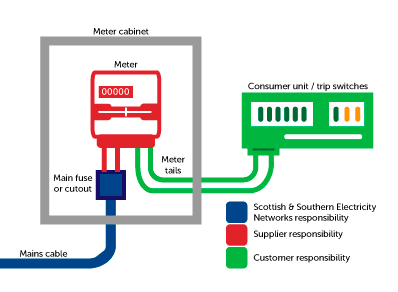

MrMagic Posted August 16, 2019 Posted August 16, 2019 Just to help anyone looking at this topic in the future... this picture helps with defining who is responsible for what... Obviously replace SSE with your local leccy network operator (DNO). Supplier in the above diagram refers to the company you actually pay for your electric. When I had a meter swap recently they upgraded tails between the cutout and meter. Tails on the meter -> CU had already been done by the spark. With regards to seal removal and resealing, I expect it varies by DNO - in my area (SSE), sparkies are actually allowed to pull the main fuse to work safely.. but they have to inform SSE and they also have to had 'signed out' 5 serial numbered temporary seals from the local SSE depot.
