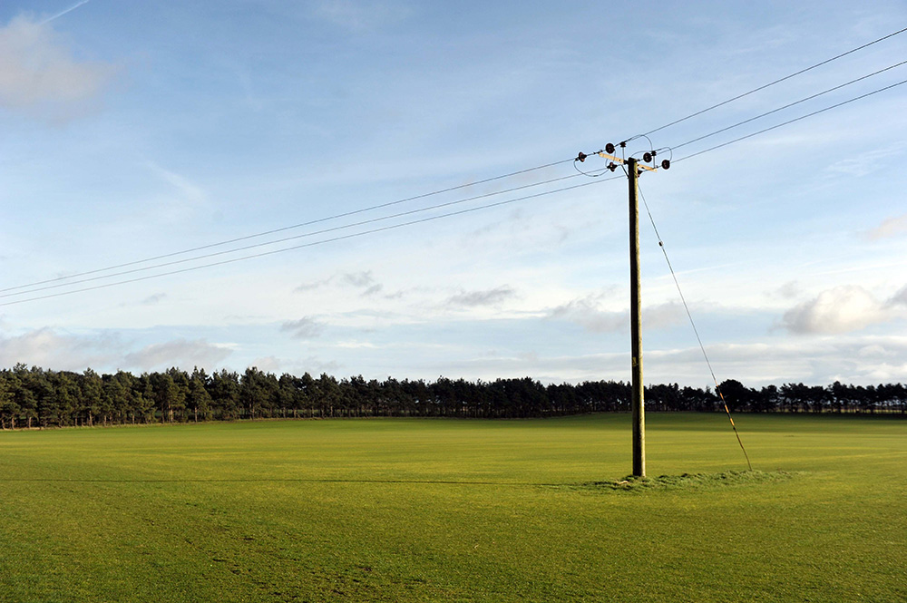

ProDave Posted August 13, 2019 Share Posted August 13, 2019 Post a picture. HV will be 2 or 3 separate wires standing up in insulators and well spaced out usually supported on a horizontal steel angle. LV will be a single (multicore) wire or individual wires just standing off the pole on insulators one above the other. Link to comment Share on other sites More sharing options...
Jeremy Harris Posted August 13, 2019 Share Posted August 13, 2019 This is what a typical rural HV overhead will look like: Link to comment Share on other sites More sharing options...
bgmill Posted August 13, 2019 Author Share Posted August 13, 2019 Yep, it's HV then. Link to comment Share on other sites More sharing options...
Jeremy Harris Posted August 13, 2019 Share Posted August 13, 2019 HV puts the price up a bit compared to LV, really just because the cable is more expensive and the joints take a bit longer to make, but it shouldn't be a huge increase. There are also restrictions on HV with regard to the distance from structures. Off the top of my head I think the minimum clearance between an 11kv cable and a building is 3.7m (need to check this, as my memory may not be 100%). If the cables are closer to the building than this then it may be that they need to be moved anyway, so there may be some possible way to use that when negotiating the price with UKPN. Link to comment Share on other sites More sharing options...

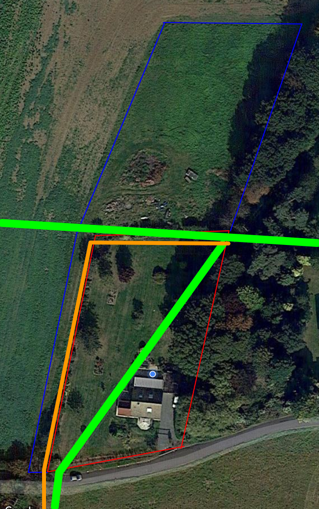

bgmill Posted June 1, 2020 Author Share Posted June 1, 2020 The saga continues... We're now around 10-11 months into the process and believed we were almost at the finish line however a final issue is now threatening to derail things entirely. To recap: - we own a double plot with plot A containing an old bungalow and plot B wrapping it on two sides (see attached, red plot = A and blue plot = B) - we have an HV overhead line essentially crossing at the middle boundary with an off-shoot that cuts through plot A diagonally (marked green). Neither line supplies our property or any of our neighbours. - the main east-west HV route is entirely over-sailing, with a pole on our immediate neighbours land and the other about 100m away from our boundary in the farm field. - the off-shoot has two poles, both on our land, one at the NE corner and another at the SW corner. This is the one we want removed/buried as it cuts through where we want to build our new house. There's an existing wayleave between UKPN and the previous owners with a 6mo termination clause. - original quote was in excess of £30k to underground the route along the orange marked line but we finally had the DNO agree to cover all costs in exchange for easements for both the over-sailing line and the new underground route; all good and we agreed to this to avoid serving notice and risking them applying for a compulsory wayleave. - fast forward a few months and we finally got the Heads of Terms through. Unfortunately the proposed terms would allow them to "erect, supplement and maintain" new overheads, inc. supports along the easements if they so wish in the future. Not an option for me and clearly defeats the purpose of what we're trying to achieve. - I was told "no negotiation" initially but eventually managed to get them to agree to remove the clauses after 3-4 weeks of emails back-and-forth - result! - next stage, Deeds of Easement were finally shared however a brand new clause had appeared disallowing me to lay any cable, conduit or pipe "across, under or above" the area marked in orange. Arghh! So this is where we currently find ourselves. As the easement completely separates plot A from plot B it means one of my major build requirements - ground-based solar PV in the NW corner of plot B - would no longer be viable as there would be no way to connect it up to the main house. It also precludes all sort of other things we or a future owner might want to do further down the line and would inherently devalue the land IMO. I've asked if they can allow some kind of crossing area, clearly marked above ground with signage and at whatever max depth they tell me but I'm curious if crossing underground HV is an absolute no-go and I'm just fighting a losing battle here? The alternative would be going all the way around the outside of plot B, however that comes with it's own issues such as not being able to put any sheds or other structures against the boundaries for example, so again not an ideal scenario! Link to comment Share on other sites More sharing options...
ProDave Posted June 1, 2020 Share Posted June 1, 2020 Two things strike me. Why does the branch have to come from the same place? Would it be possible to take the branch from where the crossing line passes your left boundary. That WOULD mean an extra pole at that point, but that would avoid the orange cable passing under your land across the plot and remove the issue, so would that be a price worth paying? The other, is if all you want to bury is a cable for the solar PV, just do it. the 11KV cable will be a lot deeper than you need to go for an LV cable, just hand dig that part to be sure. 1 Link to comment Share on other sites More sharing options...
Temp Posted June 1, 2020 Share Posted June 1, 2020 (edited) They are concerned that you might damage their cable. If they really won't budge ask if you can add.. "..without their permission, which will not be unreasonably withheld". The alternative is to make sure you are there when they bury the cable so you know _exactly_ how deep it is and just get on with it. I very carefully dug a pad foundation for the oak post of an outbuilding right over an 11kv line. Edited June 1, 2020 by Temp Link to comment Share on other sites More sharing options...

bgmill Posted June 11, 2020 Author Share Posted June 11, 2020 On 01/06/2020 at 20:20, Temp said: They are concerned that you might damage their cable. If they really won't budge ask if you can add.. "..without their permission, which will not be unreasonably withheld". This is the route I went in the end and am waiting to hear back from their solicitors (who have indicated they've agreed to similar terms previously). I'll report back if/when we get it resolved! Link to comment Share on other sites More sharing options...
