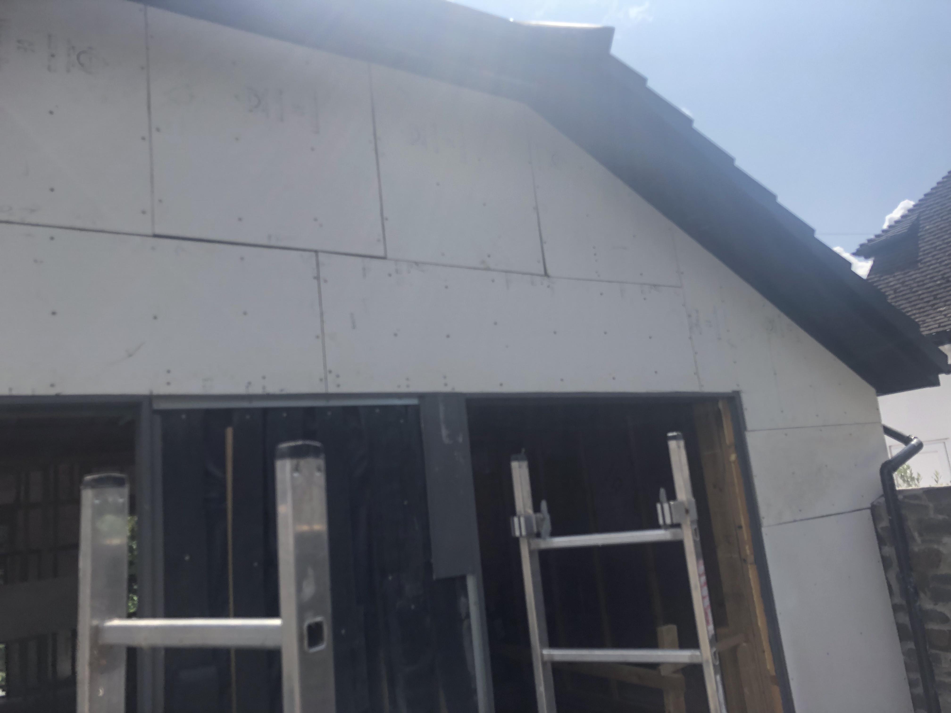

Pocster Posted August 12, 2019 Posted August 12, 2019 Well I boarded mine ages ago . Render guy came to look today for k rend or similar . He was not impressed with the gaps deliberately left between boards - but it was ok . His tip for future reference is to put the boards up butt tight to each other , then just angle grind a nice neat expansion gap ! ? Live and learn ! Hope that helps someone !!

Mr Punter Posted August 12, 2019 Posted August 12, 2019 The gaps are not very even but should be fine with mesh coat and the render will fill the gaps in any case. You could have used plastic packers. I would not fancy grinding a gap - sounds messy. If this is a "proper" expansion gap going through render and board with the special bead then he may have a point but I have done some fairly large walls without. I think horizontal expansion gaps are more important than vertical on timber frame, but you need a break in the vertical battens to match the expansion gap in the render. As yours is not multi storey I would not bother with any. For fixing I use stainless screws. They react less with other materials and were recommended by Bluclad and other board manufacturers. 1

Pocster Posted August 12, 2019 Author Posted August 12, 2019 2 hours ago, Mr Punter said: The gaps are not very even but should be fine with mesh coat and the render will fill the gaps in any case. You could have used plastic packers. I would not fancy grinding a gap - sounds messy. If this is a "proper" expansion gap going through render and board with the special bead then he may have a point but I have done some fairly large walls without. I think horizontal expansion gaps are more important than vertical on timber frame, but you need a break in the vertical battens to match the expansion gap in the render. As yours is not multi storey I would not bother with any. For fixing I use stainless screws. They react less with other materials and were recommended by Bluclad and other board manufacturers. Yeah I think he meant if his 'chippy' had done it he'd sack him but as it's a self build and "you've got enough to do already" .... He was confident that the boards don't expand but it is recommended by the manufacturer to have the gaps. Yeah I 'thought' I used stainless steel but some have definitely rusted (been up maybe 1.5 years) ; so I'll replace those with new stainless steel - probably end up replacing every screw for peace of mind!!! Cheers

nod Posted August 12, 2019 Posted August 12, 2019 4 hours ago, pocster said: Well I boarded mine ages ago . Render guy came to look today for k rend or similar . He was not impressed with the gaps deliberately left between boards - but it was ok . His tip for future reference is to put the boards up butt tight to each other , then just angle grind a nice neat expansion gap ! ? Live and learn ! Hope that helps someone !! 4 hours ago, pocster said: Well I boarded mine ages ago . Render guy came to look today for k rend or similar . He was not impressed with the gaps deliberately left between boards - but it was ok . His tip for future reference is to put the boards up butt tight to each other , then just angle grind a nice neat expansion gap ! ? Live and learn ! Hope that helps someone !! Pretty stupid tip I wouldn’t use him Apart from it being very slow Why on earth would grind or leave an expansion joint then cover it with render Going off the picture you have posted It looks sot on to me Plenty of fixing Not driven in to far Staggered joints A few small gaps on the joints are not an issue The base coat and mesh will cover them without a problem ? 1

Pete Posted August 12, 2019 Posted August 12, 2019 6 hours ago, pocster said: Well I boarded mine ages ago . Render guy came to look today for k rend or similar . He was not impressed with the gaps deliberately left between boards - but it was ok . His tip for future reference is to put the boards up butt tight to each other , then just angle grind a nice neat expansion gap ! ? Live and learn ! Hope that helps someone !! The spec on mine was a gap with a dpc behind so if I had done what your render said it would have slit the dpc!! 1

Pete Posted August 12, 2019 Posted August 12, 2019 If you spec your render board it will give you fixing guide. I used plastic packers as @Mr Puntersuggested. Get your first row straight and the rest will take care of itself. External corners need to be staggered corners, one long on one side and short on the next side and then do the opposite on the next row up, easy peasy lemon squeezy 1
