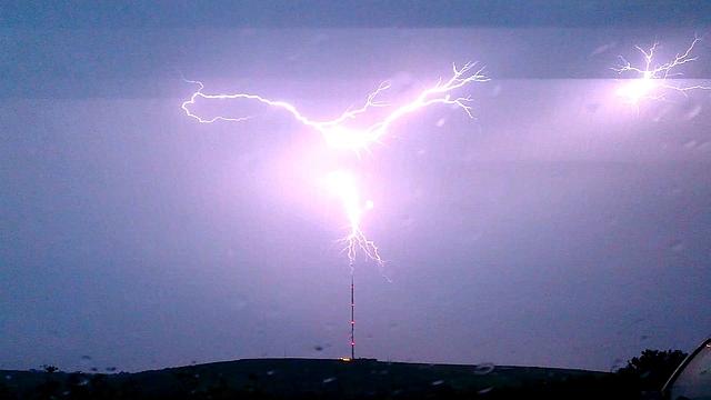

SteamyTea Posted August 13, 2019 Share Posted August 13, 2019 9 hours ago, joe90 said: guinea pigs I seem to remember that Channel 5 was the first to broadcast digitally from Carn Brae. You can see that mast, at night, all over the country (well not quite, but a fair slice of Cornwall). Not sure where the digital radio mast is, but when it rains heavily, DAB stops. Link to comment Share on other sites More sharing options...
