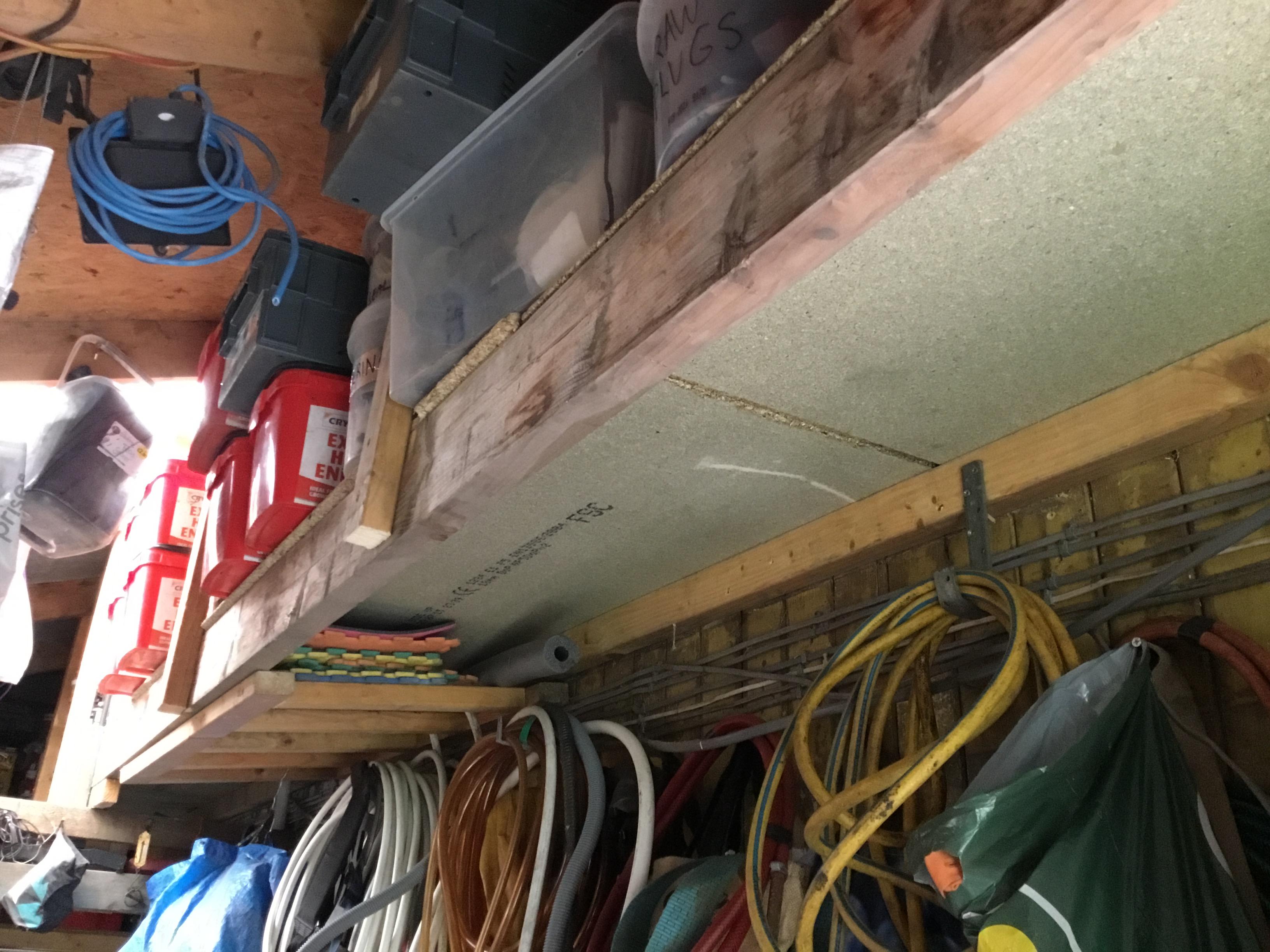

Cpd Posted August 8, 2019 Share Posted August 8, 2019 I just built (yesterday) a 6m long shelf at 600mm wide and used some left over 22mm chip / flooring board. Had a continuous wall plate at the back out of 3x2 and a big 6x2 along the front with 3x2 ties from the front up to the roof joists at about 1200mm intervals. It’s stacked up with loads of stuff, but it’s really great to have won the space from below. I was walking / crawling around in it and it did not flex on bit. Link to comment Share on other sites More sharing options...
