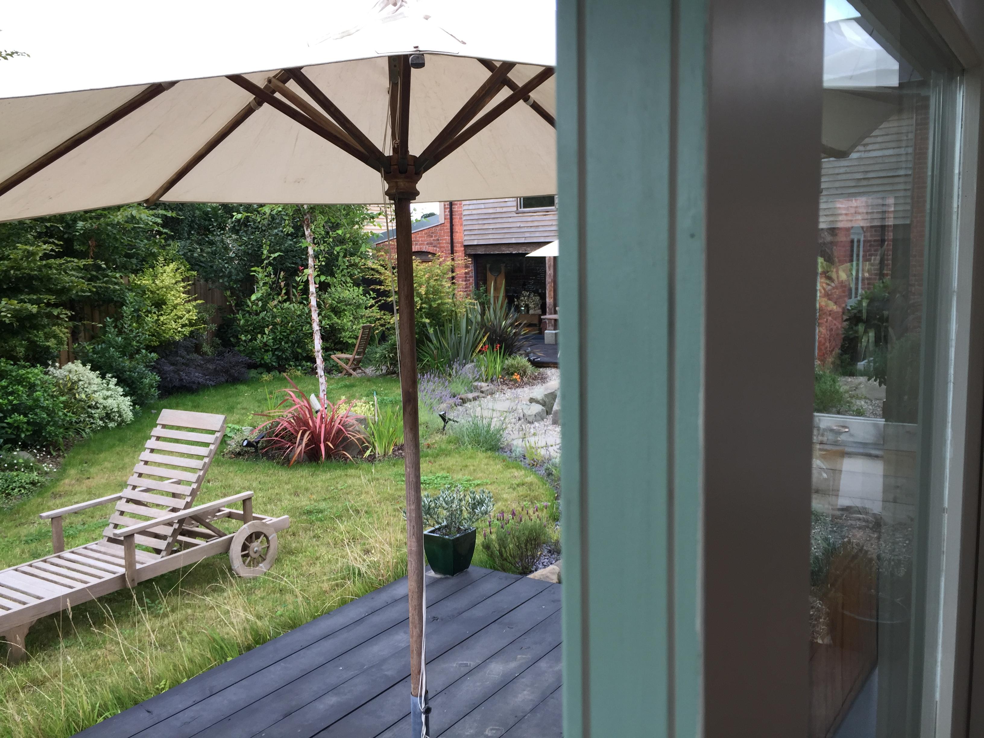

H F Posted August 4, 2019 Posted August 4, 2019 The house we've moved into has a new wood conservatory which the previous owners have painted with an indoor/outdoor (multipurpose) paint, which is exposed to a fair amount of wind and rain, and the paint is beginning to chip and flake off. We are going to repaint this with a proper outdoor paint. What I'm unsure of is whether we need to strip the existing paint off where it has flaked and just paint over the areas that are still OK almost utilising it like a primer? Or do we need to strip/sand the lot?
Russell griffiths Posted August 4, 2019 Posted August 4, 2019 (edited) Got any pictures, what’s the timber. The problem with not stripping it all is the thickness difference between paint surfaces will always show, unless you can feather it out nicely. Edited August 4, 2019 by Russell griffiths

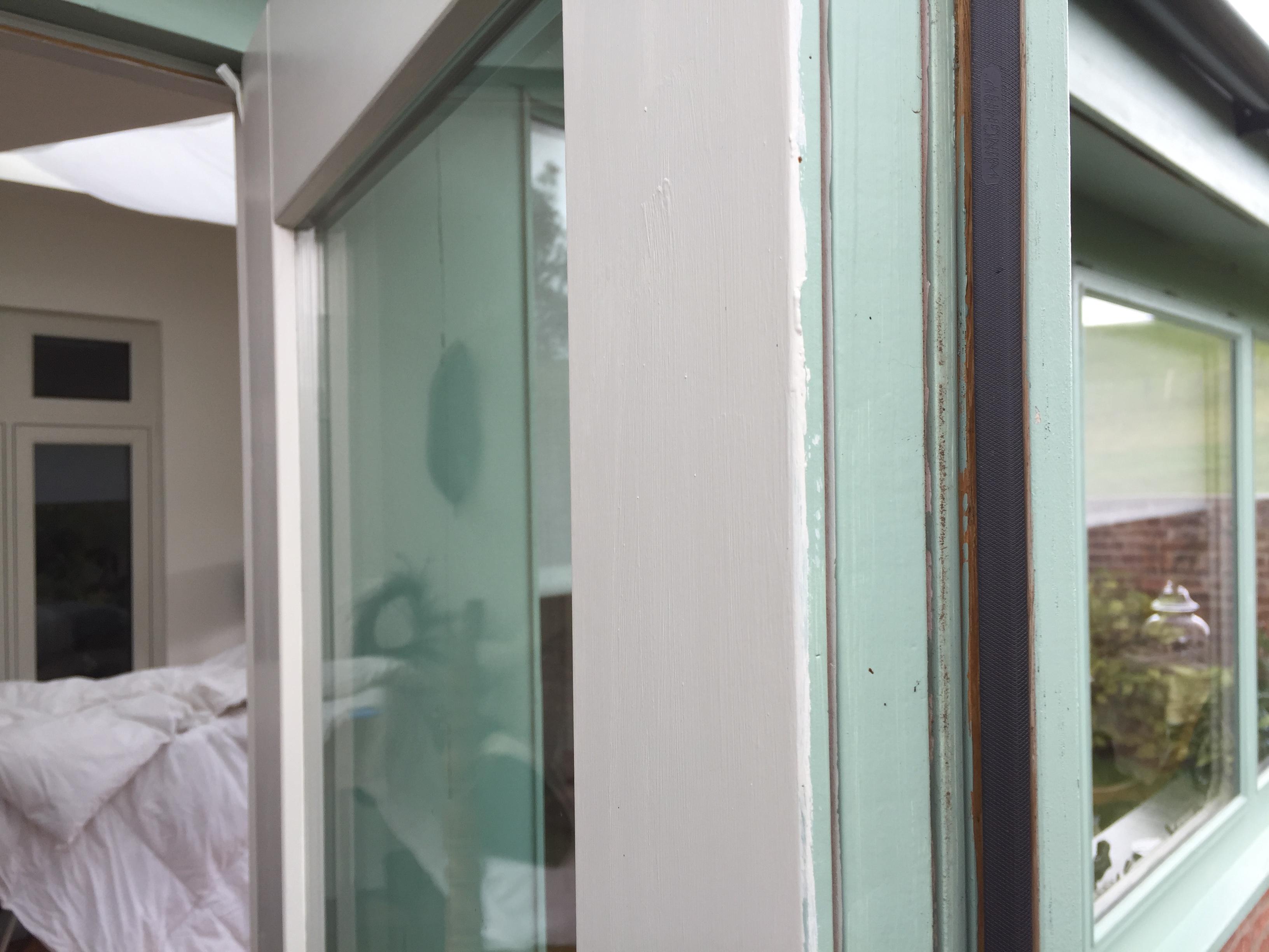

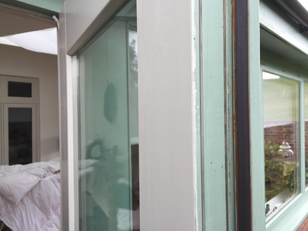

H F Posted August 4, 2019 Author Posted August 4, 2019 Please see attached photos - and the wood is cracking in many places. They also left a pot of "touchup" paint for us, which is why we know what they used. Image also attached.
Jeremy Harris Posted August 4, 2019 Posted August 4, 2019 I'd strip it right back, as it looks very much as if the original bare wood wasn't stopped and primed properly to me. The way that knots are showing through is a pretty good indication of this. If the underlying wood wasn't primed well, or at all, then there is a good chance that the paint adhesion is poor, so any repainting on top will still suffer from that. 1
H F Posted August 4, 2019 Author Posted August 4, 2019 Thanks JS. That's what I feared. This is going to be a dirty, dusty job.
H F Posted August 4, 2019 Author Posted August 4, 2019 48 minutes ago, Russell griffiths said: Got any pictures, what’s the timber. The problem with not stripping it all is the thickness difference between paint surfaces will always show, unless you can feather it out nicely. I think its cedar or another treated timber, but not 100% sure as they never told us.
Jeremy Harris Posted August 4, 2019 Posted August 4, 2019 1 minute ago, Home Farm said: I think its cedar or another treated timber, but not 100% sure as they never told us. It doesn't look like cedar to me, especially as there seem to be fairly large surface knots present. I'd guess that it's untreated softwood, based on the photos.
