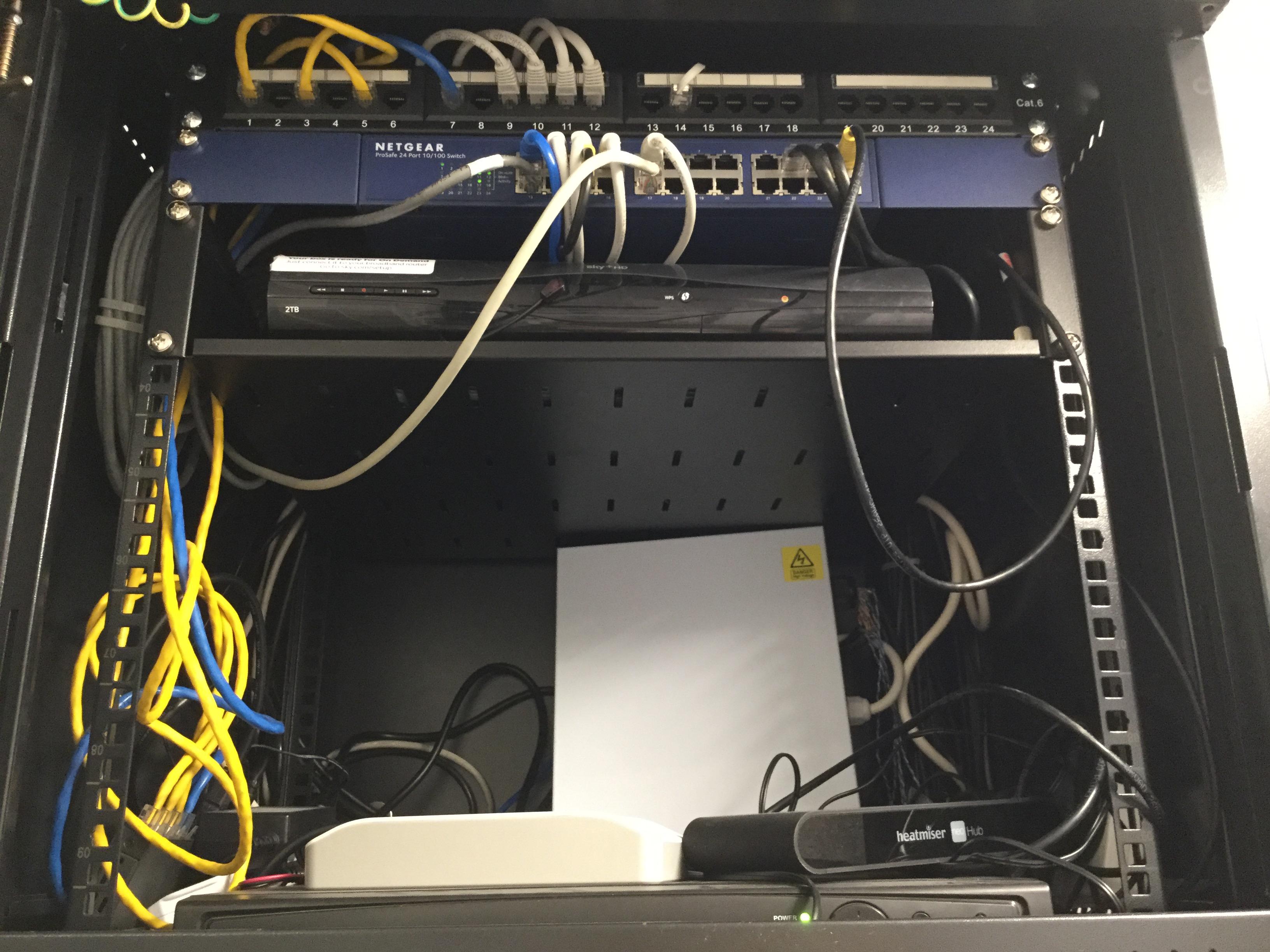

ProDave Posted July 30, 2019 Posted July 30, 2019 How is the alarm system integrated to the broadband? is that hard wired or is that sucking all your wifi bandwidth?
lizzie Posted July 30, 2019 Author Posted July 30, 2019 On 30/07/2019 at 15:34, ProDave said: How is the alarm system integrated to the broadband? is that hard wired or is that sucking all your wifi bandwidth? Expand alarm is separately hard wired. Cameras are hardwired too, I have a board in my data cab and it all goes via the board ...that is connected to router via ethernet cable I think All been working fine for a year its only the last few weeks the problems have started.
Ed Davies Posted July 30, 2019 Posted July 30, 2019 On 30/07/2019 at 15:34, lizzie said: It drops out totally no wi fi at all and when you ask it to connect again its not easily finding the hub. When I come back to kitchen area nearer hub have no problems at all its full strength Expand Then I'd be suspecting a physical connection problem with the Wi-Fi antenna in the router. I bought a cheap end-of-line router from Maplin for some networking experiments. It worked fine as a wired router which was what I really wanted at the time but was useless as a Wi-Fi router: within one room it worked fine but as soon as you tried to use it in another room with the doors closed there was no signal. Later I opened the box up for other reasons and found that the cable from the antenna had come unplugged from (or never been plugged to) the circuit board. Plugged that it and the Wi-Fi work as well as you'd expect for a cheap router. Maybe your router's antenna or its connection have become unplugged or been damaged in some way. 1

Temp Posted July 30, 2019 Posted July 30, 2019 (edited) On 30/07/2019 at 15:39, lizzie said: alarm is separately hard wired. Cameras are hardwired too, I have a board in my data cab and it all goes via the board ...that is connected to router via ethernet cable I think All been working fine for a year its only the last few weeks the problems have started. Expand Is your BT modem/wifi hub in that cabinet? It's not a great idea to put a device that uses radio in a metal box as it blocks the signal. Have you recently put the cabinet door on? Edited July 30, 2019 by Temp
lizzie Posted July 30, 2019 Author Posted July 30, 2019 On 30/07/2019 at 22:25, Temp said: Is your BT modem/wifi hub in that cabinet? It's not a great idea to put a device that uses radio in a metal box as it blocks the signal. Have you recently put the cabinet door on? Expand no router is on an open shelf nearby and not moved position in last year. ipad I am using now has defaulted to 4g as I have moved from kitchen to bedroom....it was on wi-fi in kitchen. My phone is in kitchen and won’t hold a connection to wi fi. No other devices in use. Its mad....I have changed nothing its all the same but for this problem that recently started. Hoping the new kit coming tomorrow might sort it out. Of course it could be some Apple IOS glitch as all problem devices are apple.
