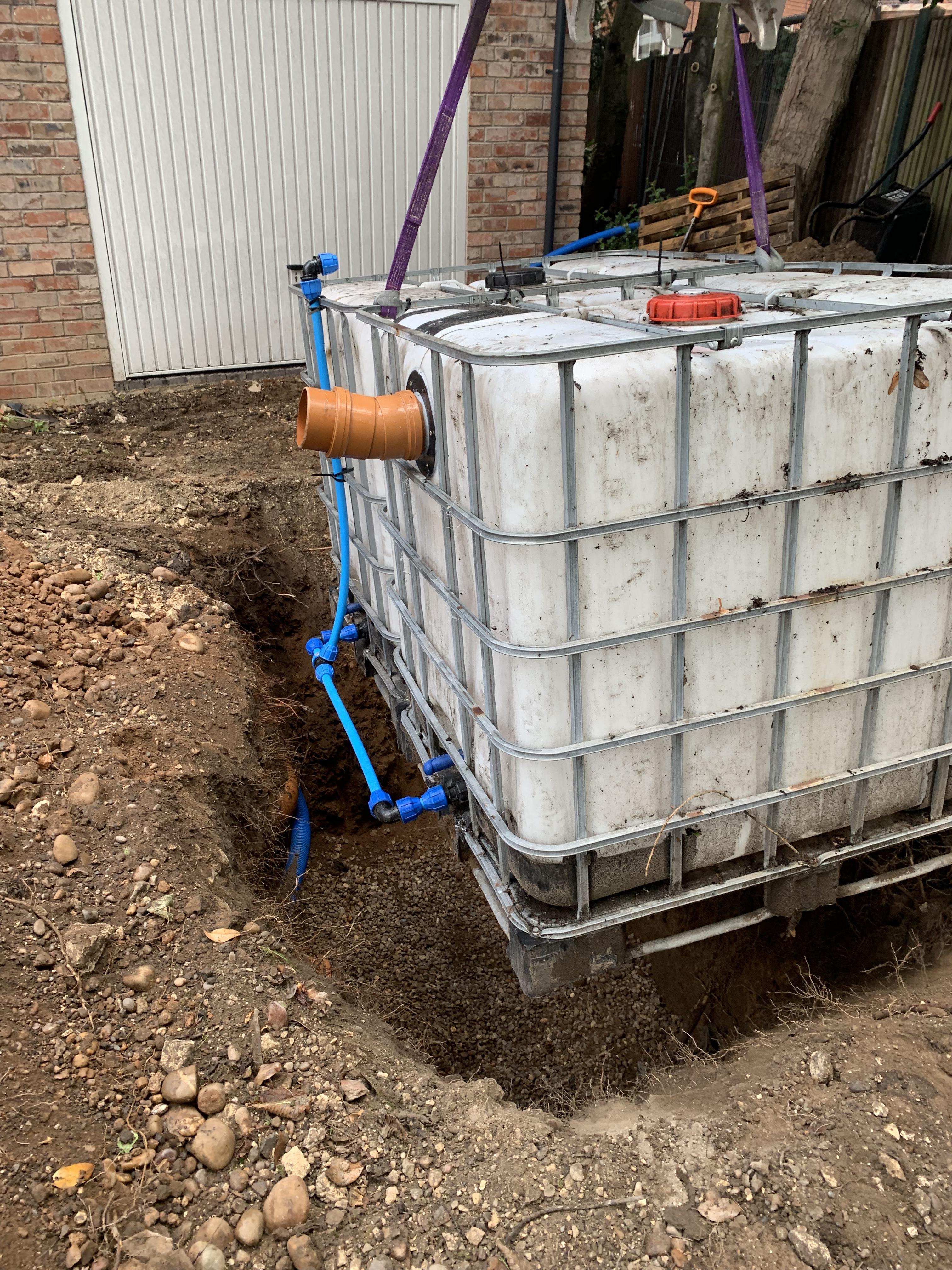

PeterW Posted July 28, 2019 Posted July 28, 2019 I buried this beast - one good rain shower and it was half full, god knows what it’s like now after a day and a half of rain..!! How much storage do you need ..??
Onoff Posted July 28, 2019 Posted July 28, 2019 7 minutes ago, PeterW said: I buried this beast - one good rain shower and it was half full, god knows what it’s like now after a day and a half of rain..!! How much storage do you need ..?? 2000L?
Barney12 Posted July 28, 2019 Author Posted July 28, 2019 7 minutes ago, PeterW said: I buried this beast - one good rain shower and it was half full, god knows what it’s like now after a day and a half of rain..!! How much storage do you need ..?? Working on the assumption of a hosepipe using 1000ltrs an hour (which seems to be want google suggests) then I think in reality I need 2000ltrs of storage per day in the summer months. This of course is if the weather is dry. Once the garden is established then it will reduce.
Barney12 Posted July 28, 2019 Author Posted July 28, 2019 2 minutes ago, Onoff said: 2000L? I think those cubes are one cubic meter.
PeterW Posted July 28, 2019 Posted July 28, 2019 Yep they are. There is a standard set of calculations as to how much storage you need somewhere. I’ll see if I can find it.
