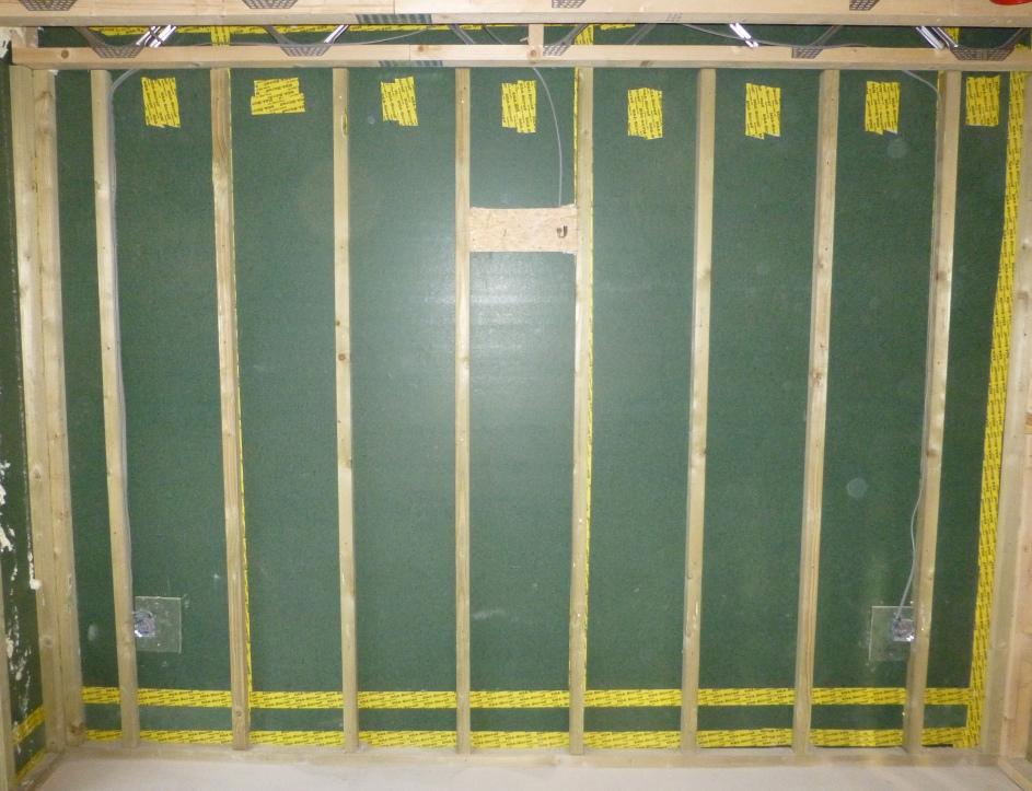

That's often not the case with the type of frame that I and @lizzie have, unfortunately.  The studs are on 400mm centres in the main part of the panels, but they are often not 400mm from the corners, as they tend to set the stud pitch so that the "left over" dimension is equally spaced at either end of a cassette.  This shows a typical frame cassette in our build (the service void battens are aligned with the frame cassette studs):

Our 'studs' are I-beams and vary in spacing depending on the loads on the structure.
Spot on @JSHarris I have just found a photo of the wall I want to use and exactly as yours I have a smaller gap at one end.
This stud thing may defeat me because I have only one wall the aircon unit could go on and three weeks ago I had all my floating cupboards fitted on that wall...I have a nice symmetrical gap either end of the cupboards and walls and the gap between corner of wall and socket is about 90, that is my aircon gap hence looking at slim tower.....what chance of studs fitting perfectly the  template for the vent holes -((
If the vent holes could be vertical not horizontal that would solve it but looking at the units they dont go that way.
Not giving up quite yet will download the template and find the studs and see how it works......
UPDATE...after earlier request via the web site they enrolled me in to get access to the technical docs......and it will work the vent holes are vertical one on top of the other so plenty of room between the stud.  Result!   Now to find me a man who can install it! Good rates of cash pay if anyone wants to volunteer to do it!
