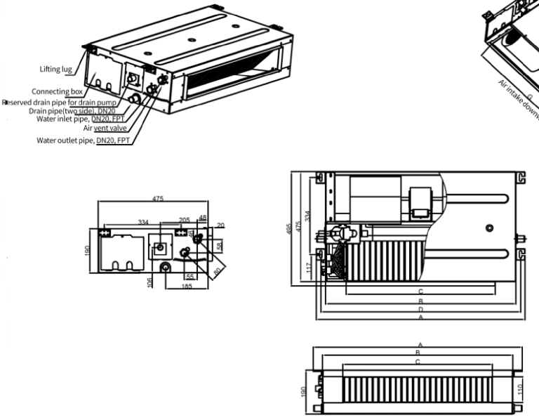

Dave Jones Posted September 17, 2024 Share Posted September 17, 2024 8 hours ago, Crispy75 said: These look quite good: https://theheatpumps.co.uk/4kw-concealed-fan-coil-unit-for-heating-cooling.html - nice and compact. But there's little technical info, and all these guys seem to offer are their own badged units, no big name brands. Has anyone had experience with Megawave? Or recognise these FCUs from their travels on alibaba? would lose a fair bit of space to mount them as they are very deep, could be a solution for hallways/landings though. Just check they have a condensate drain. Link to comment Share on other sites More sharing options...
Ommm Posted September 17, 2024 Share Posted September 17, 2024 (edited) 11 hours ago, Crispy75 said: These look quite good: https://theheatpumps.co.uk/4kw-concealed-fan-coil-unit-for-heating-cooling.html - nice and compact. But there's little technical info, and all these guys seem to offer are their own badged units, no big name brands. Has anyone had experience with Megawave? Or recognise these FCUs from their travels on alibaba? I didn't manage to find a match on a brief look around Alibaba, but Megawave's radiator-style FCUs are a dead ringer for a kind of generic boxy FCU style (Megawave v random Alibaba example), and (for some reason) Chinese heat exchangers are often anodized in blue. So I'd guess they are Chinese, even if I can't pin down the ODM. You could ask Megawave for a datasheet? The thing that would bother me is the noise of the fan, which can vary depending on what kind of motor and controller they have (and is hard to picture the raw dB numbers without listening to it). If it is Chinese, they often have relatively simple electrical connections to the unit (valve on/off/bypass, temperature sensor/thermistor, fan speeds 1/2/3 via mains terminals or 0-10V if an electronically commutated variable-speed DC (EC-DC)) and the wifi module is a drop in third party module. Often on the Tuya smart platform, I wouldn't put a whole lot of store by these units (they are cheap), but at least you have access to the raw connections to do something better if you prefer that. Edited September 17, 2024 by Ommm 1 Link to comment Share on other sites More sharing options...

Crispy75 Posted September 17, 2024 Share Posted September 17, 2024 (edited) 1 hour ago, NCXo82ike said: I've also spotted these recently. I don't love the look personally but appreciate the price and flexible mounting options. I presume these would also give the option for some individual room control of cooling (for examples different preferences for bedroom temperature), although with the small buffer volume issue that's been already mentioned. It also strikes me that the optimal positioning and airflow direction does vary between heating and cooling applications, but I don't know how much difference that would actually make. Yeah I was attracted to them by their simple shape and slim profile. 190mm is very compact. My understanding is that you care more about directed airflow for heating, otherwise all the warm air collects at high level and gets recirculated through the FCU. For cooling, convection does the work for you. Managed to find the Chinese manufacturer via google image search: https://aircolder.com/product/fan-coil-unit/horizontal-concealed-ultra-thin-fan-coil-unit/ power 48W-148W Noise 16dB(A)-51dB(A) Air flow 530m³/h-1750m³/h Cooling capacity 2.95kw-9/0kw Heating capacity 4.4kw-13.5kw Looks like the intake can either be from below or from the rear if you squint carefully. Also worth noting there are no filters, so you'd either need to roll your own or make sure you can acess the heat exchanger for cleaning. Product components Coil Fin 0.105mm thickness aluminum fins, distance between fins is 1.3mm Cooper tube Three rows, 0.28mm thickness, 7mm diameter, 30 tubes in total, FP-136,24tubes Drain Drain pan High density polyurathane material with plastic coating Drain pump Available(Biult-in for advanced, external for standard) Alertor Available( only for advanced) Shell Panel 0.8mm Al-Zn-Si hot-dip galvanized steel sheet Insulation EVA insulation pasted outside and inside the panel, B1 rating Motor Standard Low noise 3 speed fan motor , DC motor available Advanced DC motor with 0-10v thermostat Label Labels: model label, wiring diagram, precautions, fan rotation, logo, etc. Fan ABS material Centrifugal, forward-curved blades Control Standard LCD thermostat available Advanced Equiped with 0-10v thermostat Edited September 17, 2024 by Crispy75 Link to comment Share on other sites More sharing options...

Ommm Posted September 17, 2024 Share Posted September 17, 2024 3 hours ago, Crispy75 said: Yeah I was attracted to them by their simple shape and slim profile. 190mm is very compact. My understanding is that you care more about directed airflow for heating, otherwise all the warm air collects at high level and gets recirculated through the FCU. For cooling, convection does the work for you. Managed to find the Chinese manufacturer via google image search: https://aircolder.com/product/fan-coil-unit/horizontal-concealed-ultra-thin-fan-coil-unit/ Ah, YESNCER have been spamming me every few months ever since I messaged them on Alibaba in 2021 🙂 https://yuexinly.en.alibaba.com/index.html Their horizontal FCUs are between $50-200 depending on the size and options, obviously there's shipping and tax to add to that. Typically they have a basket of options and the price depends on which options you pick and how many units you want, so the price displayed is a bit hypothetical. When I looked they seemed OK - hard to judge quality. If it has the DC motor with 0-10v analogue speed control that's the better quieter motor. Link to comment Share on other sites More sharing options...
