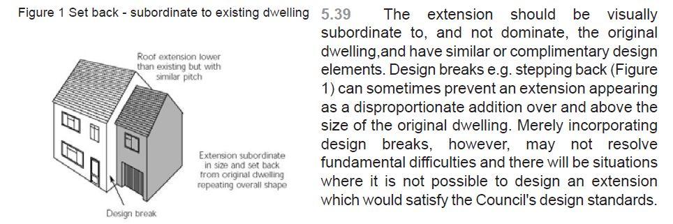

sw879 Posted July 24, 2019 Author Posted July 24, 2019 This is exactly what the council have said: "The proposed extension should be set back from the existing closet wing in order to remain subservient to the existing rear closet wing. It should be set back to allow there to be a clear difference in the original closet wing and the proposed extension, this should be at least 0.2m." and then provided two similar examples of recent permissions.
ProDave Posted July 24, 2019 Posted July 24, 2019 We built a side extension to a 1930's semi. The key thing was they wanted the extension to be clearly an addition rather than trying to look too much like the original building. In our case they insisted on the front and rear walls were stepped in by 100mm from the original walls though we "bent" the rules and tiled the roof without such a step (just a bigger overhang on the extension) If I am reading this right you already have a rear extension and you want to joint up to that but the planners are saying leave a gap? I would argue you can differentiate the extension in other ways, e.g by having the rear wall of the extension stepped in or out with respect to the existing rear annex, or making a clear difference at the roof line. A sketch of what you are planning might make it clearer.

Temp Posted July 25, 2019 Posted July 25, 2019 (edited) I had a look to see if I could find a design guide from Westminster Council. Google found this which includes Policy CM28.4 on page 21. Google says "you" were consulted about it in October last year so it may have been formally adopted by now. Hope link works. http://www.google.co.uk/url?sa=t&rct=j&q=&esrc=s&source=web&cd=3&cad=rja&uact=8&ved=2ahUKEwifirbf28_jAhXwQUEAHeUnDFoQFjACegQIAhAC&url=http%3A%2F%2Ftransact.westminster.gov.uk%2Fdocstores%2Fpublications_store%2FDesign.pdf&usg=AOvVaw1Efq8zD6c4Z4Ik1p9NWxBK Quote In addition, extensions will:1 be confined to the rear in most cases ;2. be clearly subordinate to the existing building in scale and design; and3. incorporate a high standard of thermal performance and appropriate sustainable design features. and Quote Subordinate Overly large extensions can disfigure a building and upset its proportions. To remain architecturally subordinate to the main building, rear extensions should terminate at the penultimate storey level (i.e. one storey below the established parapet level) or lower; not extend rearward beyond the existing general building line on uniform terraces and should not usually occupy the full width of the rear elevation above garden level. Well-detailed, lightweight infill extensions can be appropriate where consistent with other requirements of this policy. I note it does NOT mention they must be setback only "subordinate" in other ways. Edited July 25, 2019 by Temp
sw879 Posted July 25, 2019 Author Posted July 25, 2019 Wow wow wow!!!! You guys are simply amazing. Thank you so much and thank you temp for that link! What an incredible find. I’m sending it all to my architect who will see what the council have to say. Again I’m so very grateful for your help. I will let you know how it turns out. Fingers crossed ?? Best wishes S

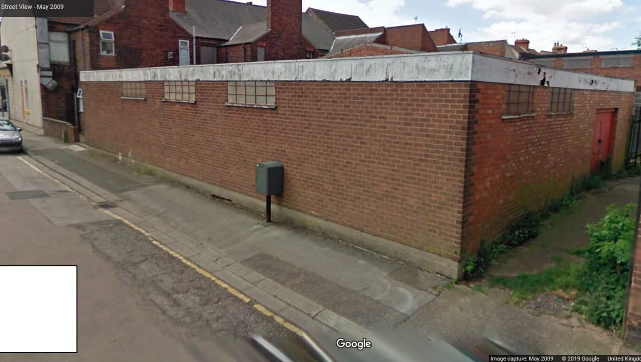

Ferdinand Posted August 12, 2019 Posted August 12, 2019 (edited) You need to choose your battles. Some you can win anyway, sometimes.Soem you might win. Some you may lose. What do you want and what can you live without? Some you can split up. For example, is there any reason why you cannot just replace that garage door with a big window in the same opening now or as a separate project? the whole thing? I do not know the rules and the conservation area rules, which I assume you are in if the CO has weighed in. Can you replace the garage door with another garage door with windows in it now without violating CO regs, and then say in your PP that you are preserving the appearance (with an even bigger window than the one they hate) because of the conservation area ? Or do that as Project 1, and the extension as 2 . Saw one here where County would not change the parking setup because there was no access into the building. So he got a door, and screwed it to the wall, which presumably covered someone’s backside sufficiently to avoid blowback and prevent the inattentive authorities discovering the questionable decision ie they can blame him and claim Nelsonian, because they then changed it. Screwing the door on the wall was suggested by County people verbally... If you get into detailed and open ended arguments you than have to close off all their escape routes t9navoid your proposal or an acceptable alternative. Or you could get a basic pp then go back for a variation etc. How much elapsed time do you have? Can you manipulate the CO to get what you want from the planner? I think the Planner sticking his head down an ostrich hole is unacceptable. Perhaps try via your local councillor or the Planning boss .. “I wondered whether your planning officer Courtov Caractacus was on holiday” etc? That is an escalation, though. But you need to choose your points to dispute or it becomes a game of chess where you can lose sight of the overall thing. I think you will have to give them the smaller 1st Floor window, in exchange for the bigger ones downstairs. An objection to an Appeal just lost here cos the Inspector decided that my temporary close board fence to mitigate the current disturbance for a T was good enough that the Planning Conditioned Acoustic Wall the developer was trying to avoid building would be insufficient improvement over the existing to justify the condition, which has now been erased Win some .. lose some. Now the Dev has got to go back and agree something suitable with the Carncil from scratch, so back into the planning machine it goes. F Edited August 12, 2019 by Ferdinand
Mr Punter Posted August 12, 2019 Posted August 12, 2019 Regarding the materials, if the rest of the house is brick, you could do the extension in render or vice versa. Regarding the windows, the CO makes a reasonable point and I do not think the rear elevation looks well resolved. It is hard to see where floor and ceiling levels are, but I would want a decent ceiling height in the kitchen and the new extension looks a bit squat.
sw879 Posted September 3, 2019 Author Posted September 3, 2019 Thanks everyone for your help and Ferdinand your comment about the door made me laugh! So after weeks and weeks of silence the council have said "the windows need to be smaller and more consistent with the host building and the extension should be set back from the main building, regardless of the materials used". They didn't respond our request for them to visit the site nor did they say why our suggestion to make the extension subservient by using different materials wasn't acceptable. This means we will have to redesign the kitchen, bedroom and bathroom. Since its taken over a month to get this one line answer, i'm thinking of just going ahead with their approval and then submitting new plans to the council and hopefully getting a new planning officer take a look. Do you think this would be better or going straight to appeal? Thanks for all your help so far.
Ferdinand Posted September 3, 2019 Posted September 3, 2019 (edited) 1 hour ago, sw879 said: Ferdinand your comment about the door made me laugh! It's actually exactly the sort of thing that sometimes works and is expedient. Like repairing a wall in 3 sections to get a different wall without engaging awkward bureaucracy. Consider a 3000 sqft workshop somewhere in North Notts I sold to somebody in about 2010 (for 35k!). It has what looks like a drop kerb (probably a swing pavement for bigger lorries) and a yellow line and a post-strorage drop. Bloke wanted parking / waiting / unloading, Council said - can't move the yellow line as there is obviously no unloading point in that wall. If there were access there we could do something maybe. But anyway, a yellow line extinguishing requires a traffic order doodah at County, which takes months and this is low priority. A more recent piccie and what they did a bit later. Edited September 3, 2019 by Ferdinand
