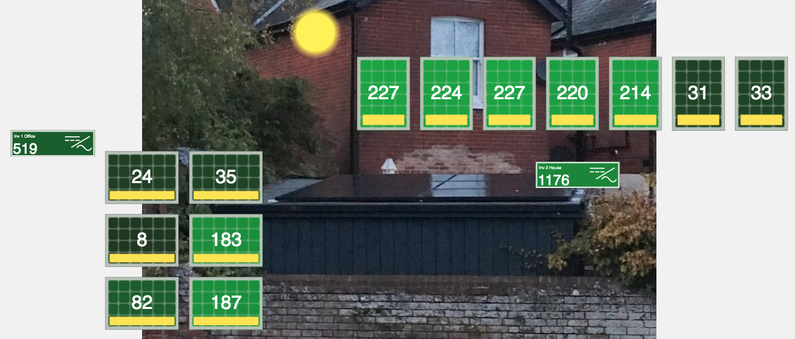

MrMagic Posted July 23, 2019 Posted July 23, 2019 O/T but thought it would be good to share the impact of shading...it really is shocking just how much of a difference it makes.

SteamyTea Posted July 23, 2019 Posted July 23, 2019 1 hour ago, MrMagic said: the impact of shading...it really is shocking just how much of a difference it makes. Not really. Shading, in effect, turns a module into a resistor. I often wonder how shading impacts the longevity of modules, but a decent inverter should minimise that. Individual inverters on shaded modules is the best method.
MrMagic Posted July 23, 2019 Posted July 23, 2019 50 minutes ago, SteamyTea said: Not really. Shading, in effect, turns a module into a resistor. I often wonder how shading impacts the longevity of modules, but a decent inverter should minimise that. Individual inverters on shaded modules is the best method. I guess from a layman/simple-person like me it's surprising! I've got Tigo 'optimisers' on the panels, hence the panel level monitoring, so it's not so much of an issue.
ProDave Posted July 23, 2019 Posted July 23, 2019 3 hours ago, MrMagic said: O/T but thought it would be good to share the impact of shading...it really is shocking just how much of a difference it makes. Sorry to appear dumb, but can you explain what that picture is showing me?
MrMagic Posted July 23, 2019 Posted July 23, 2019 (edited) @ProDave No need to appear dumb... I didn't really give any context! Due to having a small roof I've essentially got two separate PV systems. One on the office (you can see in the background picture) and one on the main house roof. Each inverter is represented by the box with the squiggle on (technical term) - the number being the current output, i.e. 519 watts and 1176 watts. Each of the larger solar panel looking squares represents a solar panel - and the large number being the current watt output of that individual panel, the lighter the green the more output. These are all 300w max output panels. In this setup, due to shading mainly, Wagner installed Tigo optimisers on each panel - this gives the per-panel statistics + helps bypass the panel when shaded by the neighbours silver birch and all kinds of other stuff that I don't pretend to understand. Oh, and the point for posting was to show the difference between the unshaded panels producing ~225w and a shaded panel producing just 31 watts (top row). Hope that helps! Edited July 23, 2019 by MrMagic 1
ProDave Posted July 23, 2019 Posted July 23, 2019 7 minutes ago, MrMagic said: ach inverter is represented by the box with the squiggle on (technical term) - the number being the current output, i.e. 519 watts and 1176 watts. Each of the larger solar panel looking squares represents a solar panel - and the large number being the current watt output of that individual panel, the lighter the green the more output. These are all 300w max output panels. In this setup, due to shading mainly, Wagner installed Tigo optimisers on each panel - this gives the per-panel statistics + helps bypass the panel when shaded by the neighbours silver birch and all kinds of other stuff that I don't pretend to understand. Oh, and the point for posting was to show the difference between the unshaded panels producing ~225w and a shaded panel producing just 31 watts (top row). Hope that helps! Thanks. I thought it was trying to show power Vs time of day or sun elevation but with no scale. That makes a lot more sense now.
SteamyTea Posted July 23, 2019 Posted July 23, 2019 The main thing is that the optimised modules are giving out about the same power. This shows that the system is working as well as it can. 1
