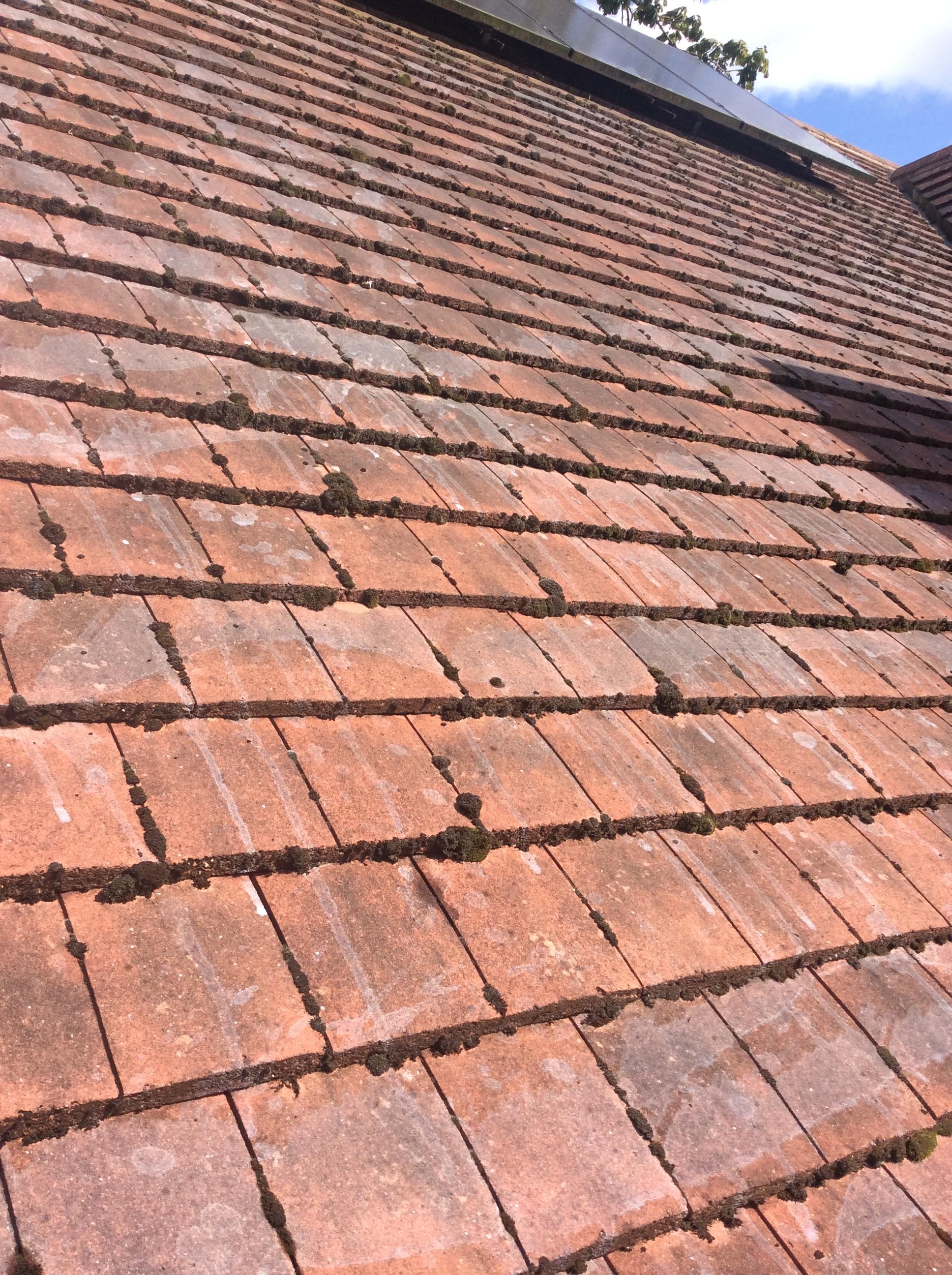

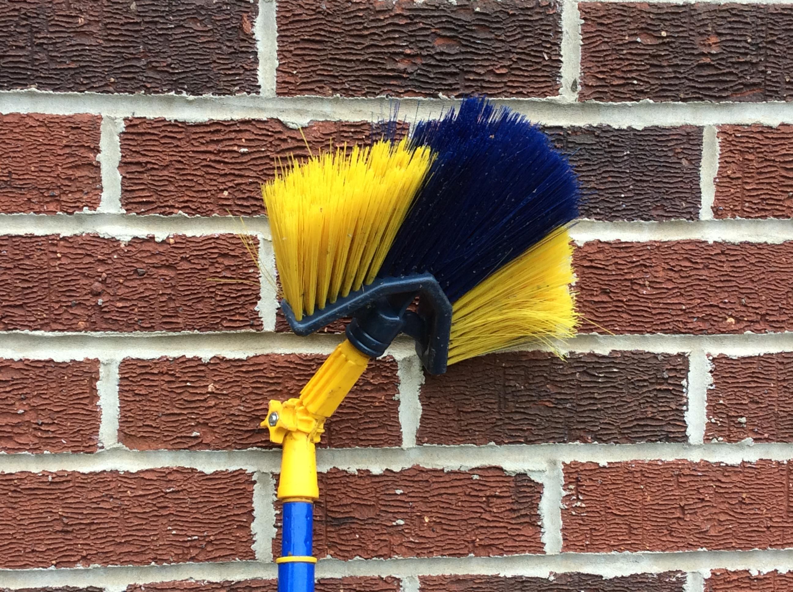

Ferdinand Posted July 21, 2019 Share Posted July 21, 2019 (edited) My chosen weapon for physically removing moss is a gutter brush on a 2x extension pole. No idea where it came from ... parents saw one in a shop once and swooped. It only extends to about 12ft, but that makes 18-20 with me. Should be easy to find online. I did a high bungalow roof with this before selling it. The problem I have now is that I have one storey of wall, then about 7m of roof above that .. which is too much for the brush. So it will be the idea below when I next do it. For the ‘spray with copper sulphate and leave to die for a couple of months’ option I would look for a traditional fruit tree sprayer, which will do anything between 2m and perhaps 5m plus you. Or for more fun get hold of a water soaker of the bicycle pump type, which you can make yourself for tuppence https://www.instructables.com/id/5-Water-Guns/ Or buy one for about £3. They will have a 10m range, get a bucket of CuSO4 solution, and Robert is your relation. Maybe. Just practice frost with water so you do not go over the whole house and kill next door’s cabbages. I got one from the pound shop a couple of years ago which had enough range to discourage the cats and squirrels on my front wall from the front porch and protecting the nesting birds a little. Ferdinand Edited July 21, 2019 by Ferdinand Link to comment Share on other sites More sharing options...

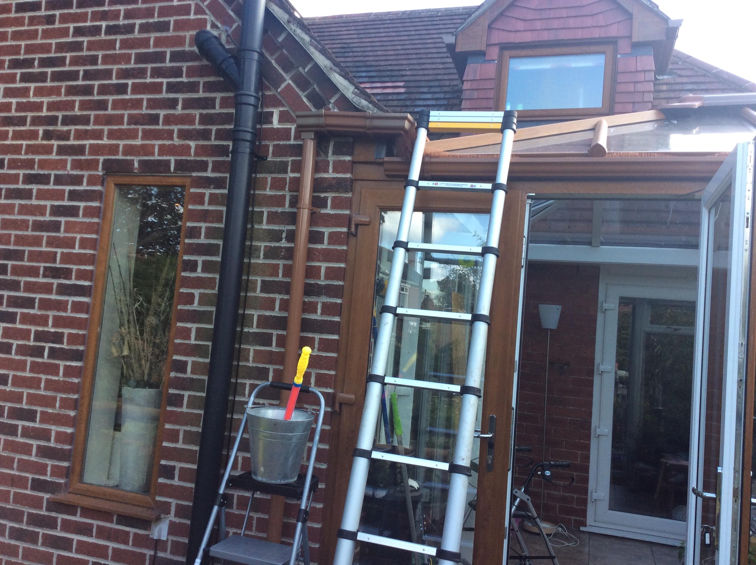

EverHopefull Posted July 24, 2019 Author Share Posted July 24, 2019 As an update I managed to clear 90% of the moss using a combo of ladders and skirting board with a long length a bamboo screwed to it. A bit like dentistry from afar but after the momentus thunder storm overnight I ventured I to the roof space with a torch at 2am and everything was dry as a bone. Bucket still cobwebs, not a drop in it. So moral of the story is get rid of the moss if you can! Copper idea is one I may try tho to keep it at bay in future. Cheers for all the advice as ever! 1 Link to comment Share on other sites More sharing options...

EverHopefull Posted July 29, 2019 Author Share Posted July 29, 2019 It can work in both your favour and against you. My conservatory roof has become more water tight with the increase of moss, opposite of the tiled house roof! ? There was nothing visible lifting the flashing so I am having to assume that the moss was causing some damming of the rainfall sending it sideways and under the flashing. More days of heavy rainfall and bone dry in the original loft zone. Link to comment Share on other sites More sharing options...

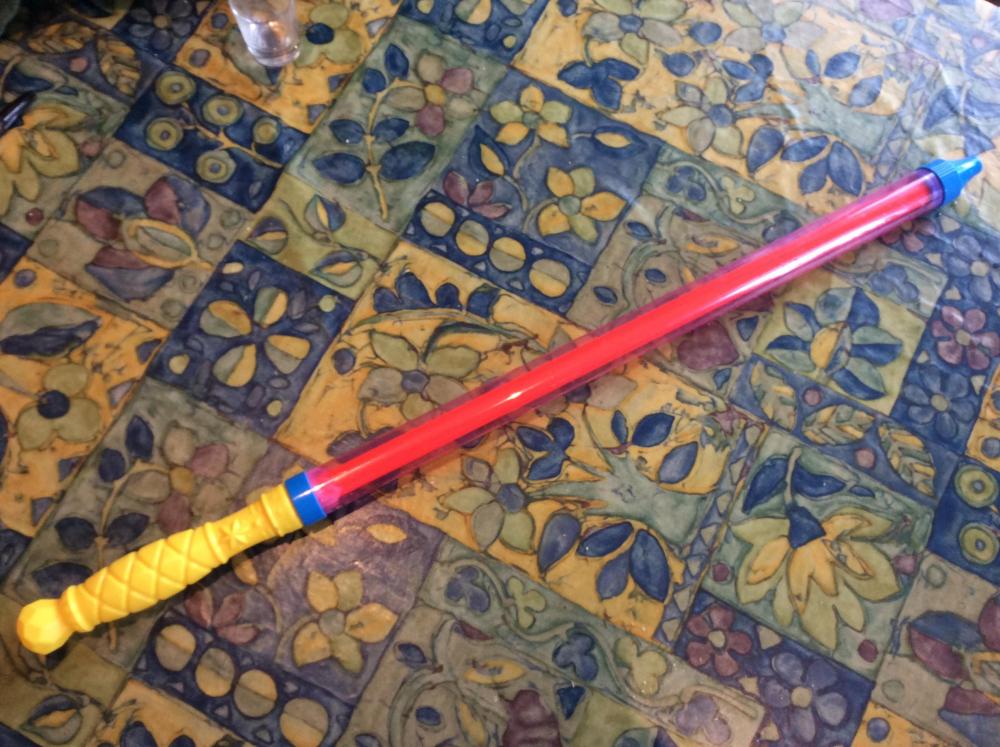

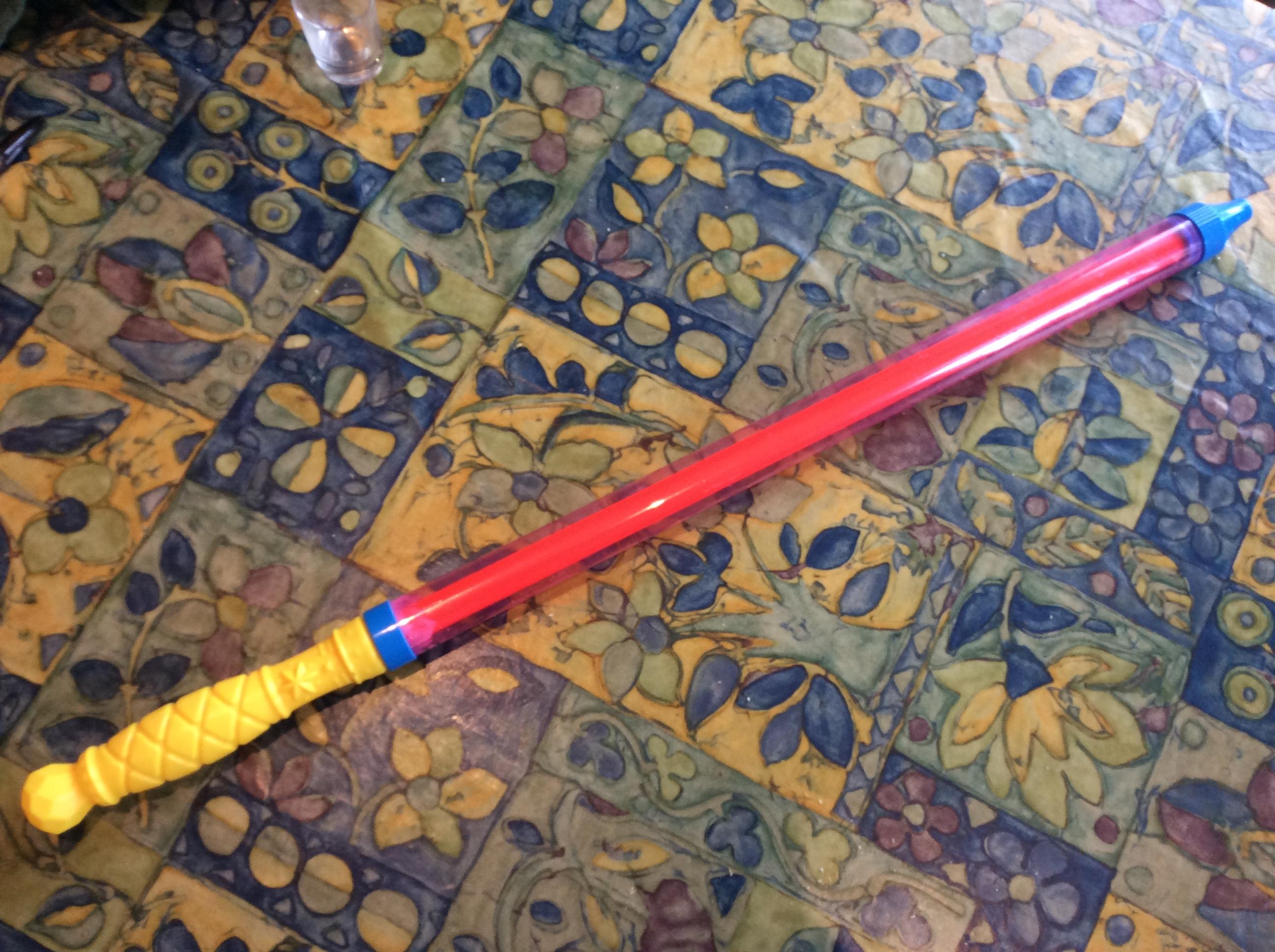

Ferdinand Posted July 31, 2019 Share Posted July 31, 2019 (edited) I have my moss control weapon of choice. £1.29 from Home Bargains. Range is about 12-13m on the flat, and it will reach the top of my roof. One squirt is about a pint, so Jeremy’s 2kg of CuSO4 should do it for starters. Though 15 for 2kg is galling when one can get 25kg for either £50 or £75. Then I need a calm day and some careful and delicate aiming. F Edited July 31, 2019 by Ferdinand Link to comment Share on other sites More sharing options...

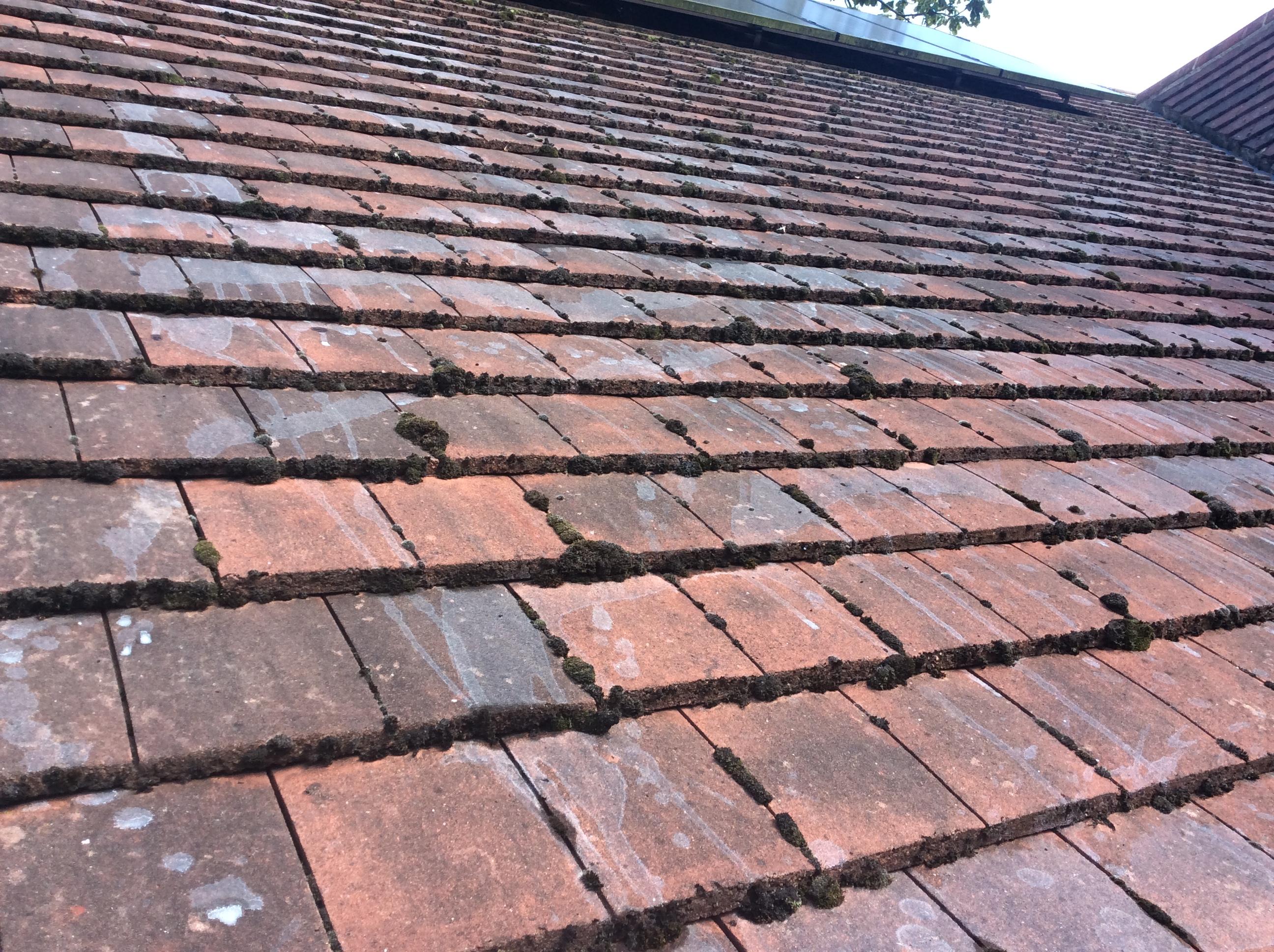

Ferdinand Posted August 16, 2019 Share Posted August 16, 2019 (edited) OK.My Copper Sulphate Pentahydride has arrived from the @JSHarris link. Just a few checks. Precautions: Obvs disconnect any connected water butts, used for the garden, where some may end up. Great care required to avoid contact with water courses / ponds - bad for water plants. Presumably keep the amount going into soakaways as little as possible. Questions: Are there any sensible limits that should be adhered to? Can I use say 500g-1kg at one session, without undue risk? Does this stuff do any damage to reed bed and treatment plant systems? I can see some reaching reed beds, as iirc they are used for surface and grey water, but treatment plants generally are not? (I am on soakways or main drains) but it may affect others. Do I need to keep a separate set of buckets etc for this, or can I simply wash down afterwards? Tangent I ran across Tribasic Copper Sulfate, which I think is the normal version with a different label. The Soil Association approve it for organics at 6kg of copper per Ha per annum, or up to 5 years worth in one go for a perennial crop. Ferdinand Edited August 16, 2019 by Ferdinand Link to comment Share on other sites More sharing options...
Jeremy Harris Posted August 16, 2019 Share Posted August 16, 2019 The stuff is readily soluble in water, so washes away fairly readily. It may stain stuff blue for a time, but this will usually fade/wash away with time. When diluted by rainwater etc it's very unlikely to remain at a concentration that will cause harm, other than to fungal growth. 6kg of copper = 24kg of copper sulphate, and I believe the Soil Association have allowed the use of copper sulphate solution for dealing with fungal disease in crops for some time, which is a reasonably good indicator that it's fairly safe to use. Link to comment Share on other sites More sharing options...
Ferdinand Posted August 17, 2019 Share Posted August 17, 2019 (edited) OK. I made up my first 3l of solution with 500g of CuSO4, and it seems to have semi done about 1/3 of my roof (3 sections this is trial), plus 1l extra water to soak up the undissolved CuSO4. So I am estimating perhaps 3-5kg to do it all row by row which may be good for the first application. 3-4 l was about 15 squirts with the squirter. The blue stain looks distinctly useful in detecting what has been covered. next time I will probably try after rain whilst it is still damp, as the solution dried very quickly done this way. It reached beneath the solar panels relatively easily. Now to wait a week or two. All comments welcome. Edited August 17, 2019 by Ferdinand Link to comment Share on other sites More sharing options...
