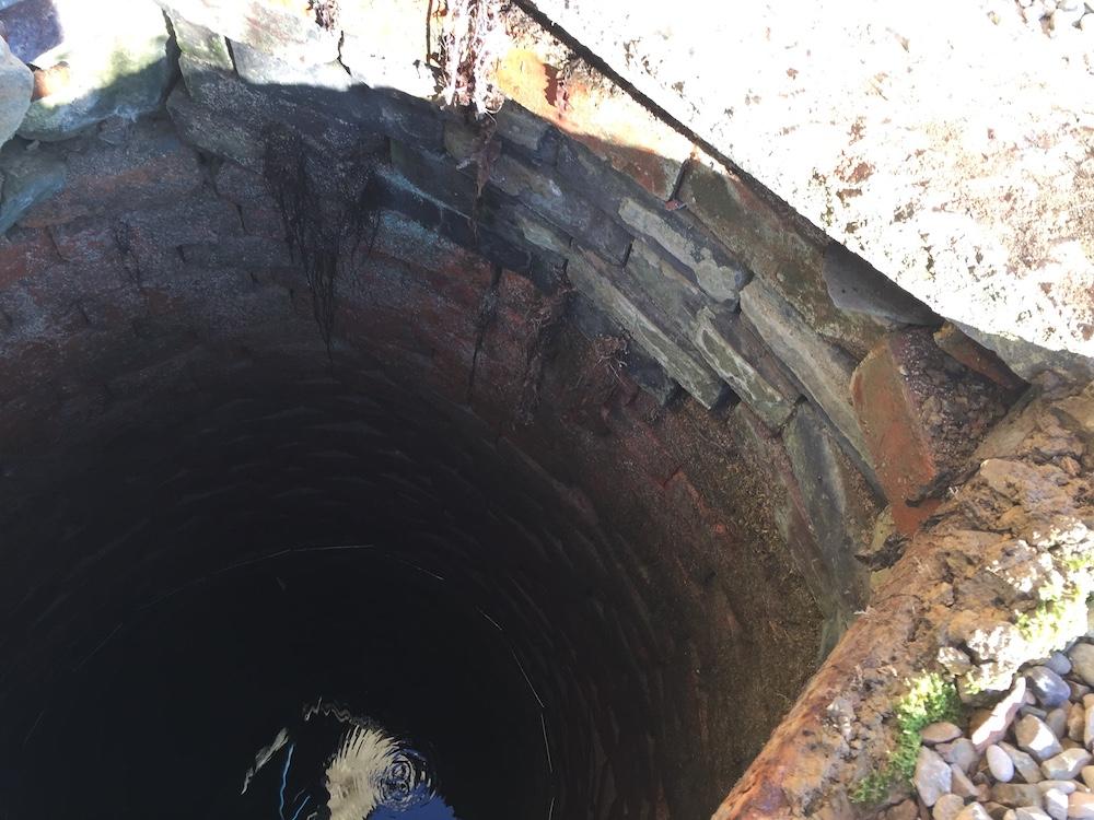

We have a walled well (which probably dates back to the mid-1800s) - the previous owners measured it by dropping a rope down and claim it's 60-feet deep.
We are now ready to try and put this well to good use to water the garden.
We need advice on what the best way would be to approach this and what kind of pump would be best suited.

The snag with the submersible pumps that places like Screwfix sell is that they are all float switch operated, so won't turn on and off when you open a tap, without some playing around and making underwater mains cable connections to the switch cable and adding a pressure switch and small pressure vessel.  To be able to just turn on a tap and have a pump start needs a pump that has a pressure switch that turns the pump on when the pressure drops from opening the tap, plus small pressure vessel to prevent the pump from short cycling.
There are two types of pump, and which you choose depends on how far down the water level is at it's lowest.  No non-submersible pump will draw up more than about 8 to 10m, so if the water never falls this far below the height of the pump, then you can look to use an above water pump set.
If the water level is likely to drop below about 8m from the top, then it would be best to fit a submersible pump with a pressure controller.  Something like this would do the job (again, just picked at random to illustrate the type of system): https://pumpexpress.co.uk/shop/the-peak-bundle/

The way the tap controls the pump is via the pressure switch, in conjunction with the pressure vessel, which allows for the fact that water is incompressible (to all intents and purposes).  What happens is this.
When power is turned on and the tap is closed, the pump operates until the pressure in the pipe to the tap reaches the switch turn off pressure, typically around 3 bar.  The pump then turns off and that pressure is held, as there is a non-return valve in the pipe to the pump.
When the tap is opened water starts to flow, and the pressure drops.  When the pressure drops below the turn on pressure, typically about 2 bar, the pump switches on to continue to supply water.
If the rate at which the pump can supply water is greater than the rate at which it's being used, then the pressure will increase.  When it reaches the turn off pressure the pump will turn off, until the pressure drops back to the turn on point again.
If the tap is turned off, with the pump running, the pressure will increase until it reaches the turn off pressure, when the pump will turn off and the system will just sit pressurised, ready for use.
The advantage of this system is that the pump can be placed low down in the well, so it can always draw water, and there's no need to mess about switching power on and off.  The tap can be treated just like any other tap.  Water will flow when the tap is turned on and stop flowing when the tap is turned off, plus the pressure will stay reasonably constant, between 2 and 3 bar.
An alternative is to not have a tap, and just have a pump down the well with a suitable weatherproof switch to turn it on and off.  This doesn't allow for any flow variation, as the pump will be either producing water at it's maximum capacity when turned on, or not pumping at all when turned off.  Even a small submersible pump will deliver maybe three times or more of the flow rate from a normal size outdoor tap, and so may be a bit difficult to use for delicate watering.
