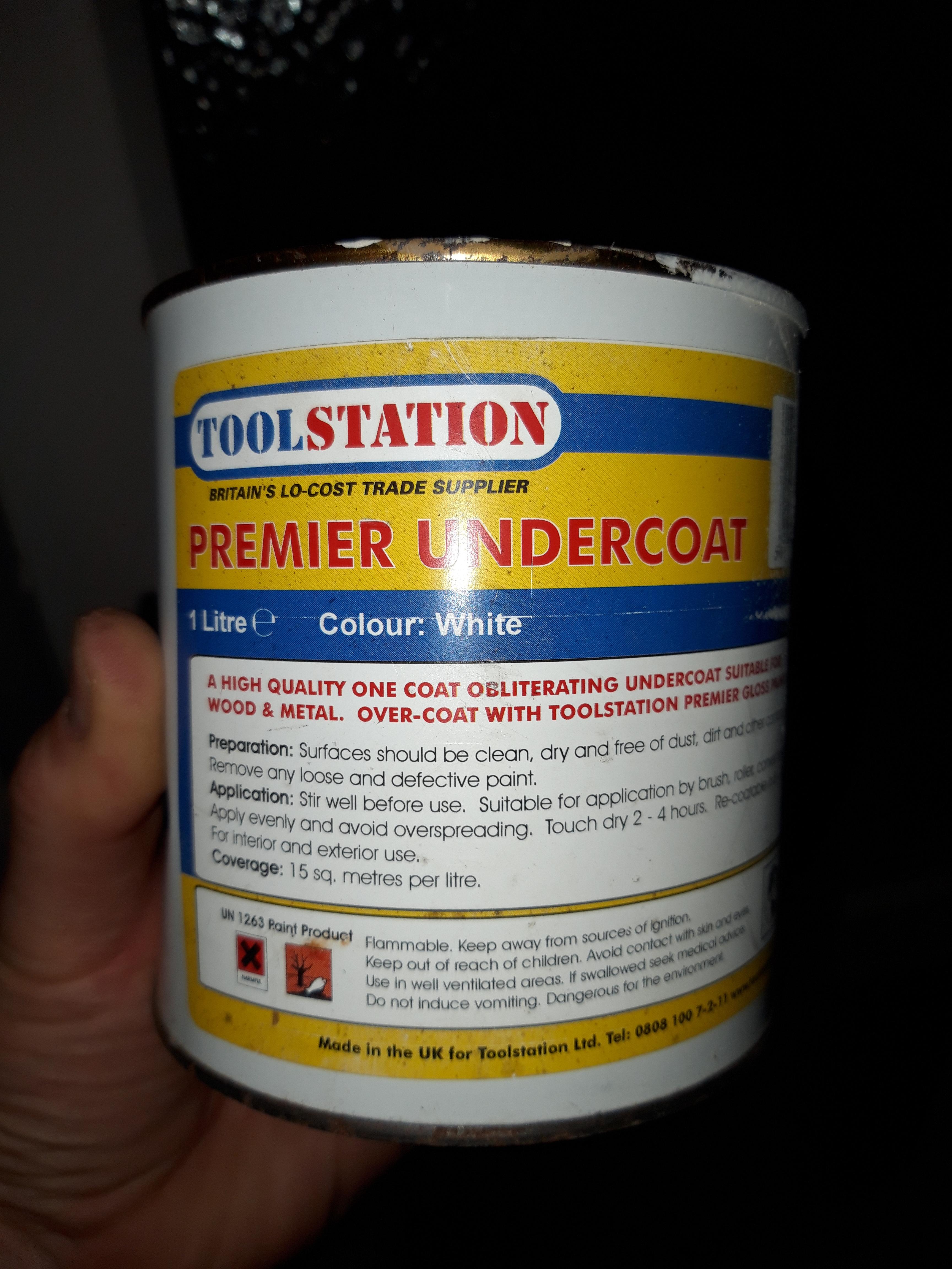

oranjeboom Posted July 2, 2019 Share Posted July 2, 2019 Have read mixed reviews about water-based primers and as I have a large-ish mdf sheet to paint I'd like to get it right first time. I know a few here have used Rustns MDF sealer. I would have thought an oil-based primer would have been better than water-based? I really don't want the 5.5m length bulging/splitting! Any tips @Onoff? Think you have experimented with the TS stuff? Final coat needs to match plastered matt white wall as best as possible, so was simply going to seal the MDF, then use Dulux Diamond white Matt. TIA! Link to comment Share on other sites More sharing options...
bassanclan Posted July 2, 2019 Share Posted July 2, 2019 If you are painting it with water based final coat then use a water based primer. I wouldn't bother with a special MDF primer, I've used Leyland trade acrylic and its been great, but go thinly and use two coats if needed and a light sand before your topcoat 1 Link to comment Share on other sites More sharing options...
Russell griffiths Posted July 2, 2019 Share Posted July 2, 2019 No matter what you paint it with you will get fluffy edges so you will need to sand between coats. Expect to put on more coats than you thought. 1 Link to comment Share on other sites More sharing options...

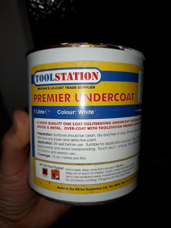

Onoff Posted July 2, 2019 Share Posted July 2, 2019 Used both the TS and No Nonsense water based specific MDF primers before with no issue. Just the other day I had to knock up a quick MDF shelf for the daughter and couldn't find any MDF primer. Found this old but unopened tin and though it had an oil slick on top it soon mixed in. Seemed watery but it was in fact bang on. Applied with a foam roller. Great coverage. Took longer to dry of course than the water based ones. 1 Link to comment Share on other sites More sharing options...
